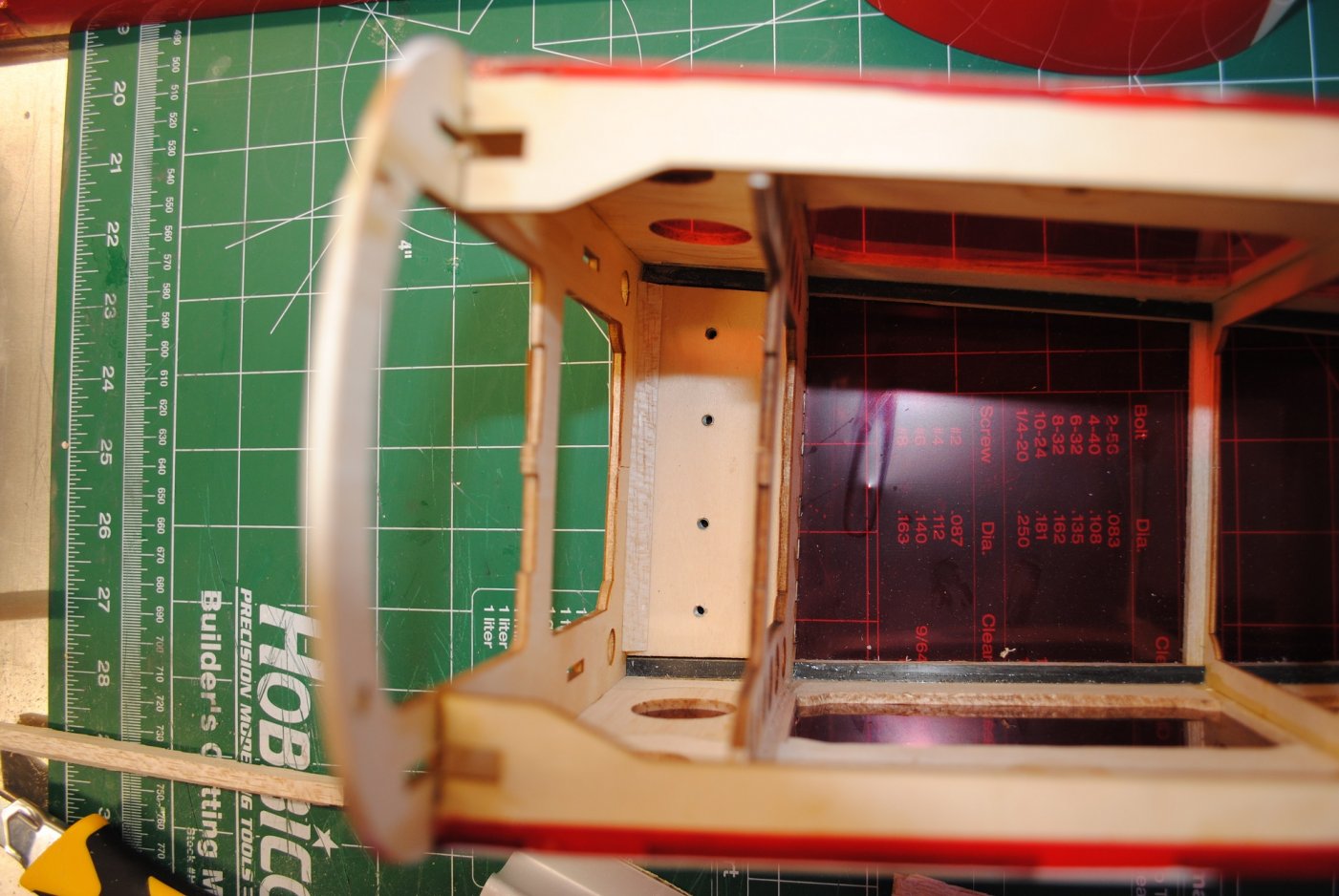

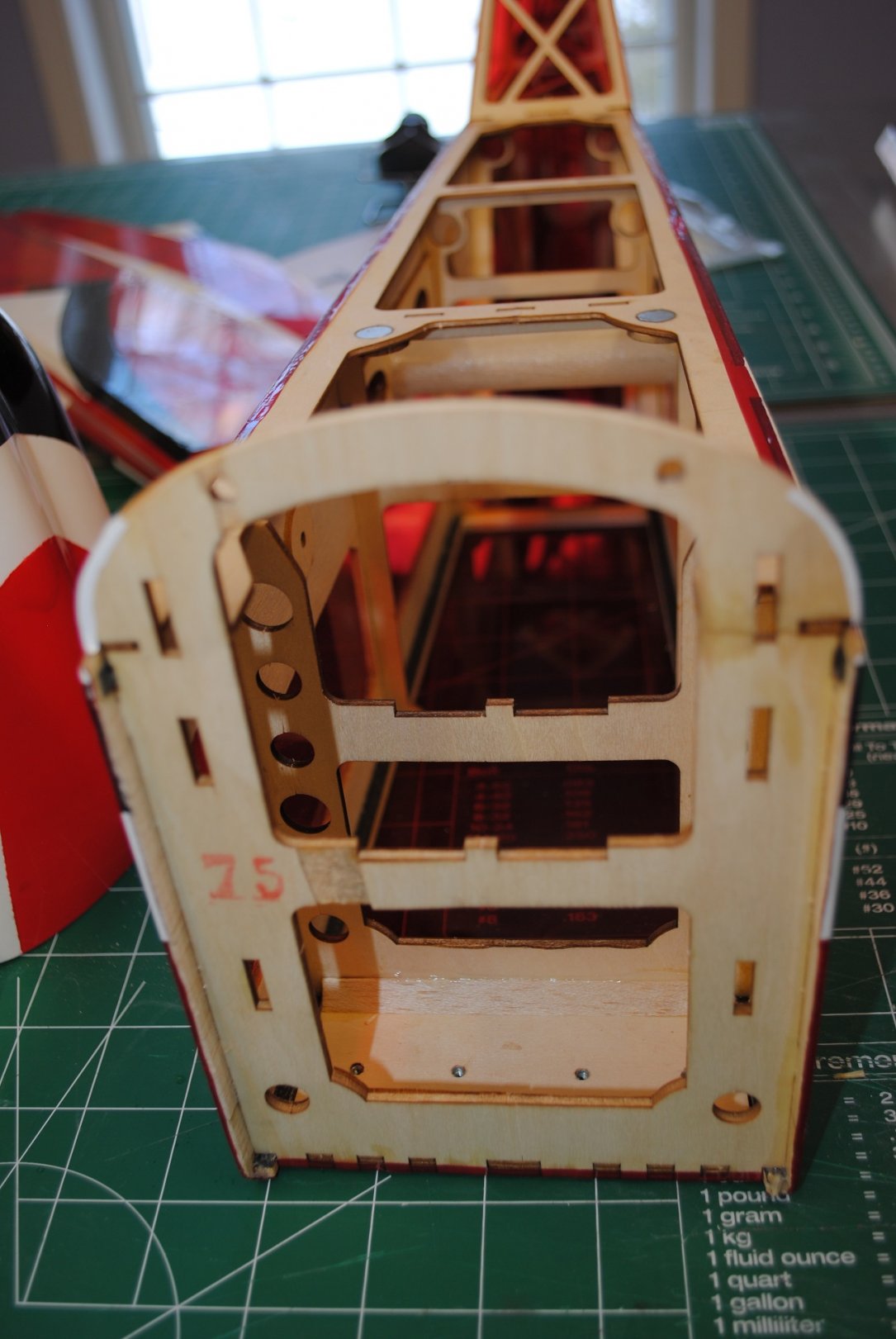

How the ARF came out the box

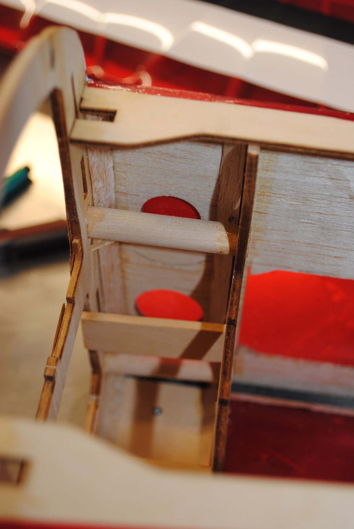

First I added triangle stock.

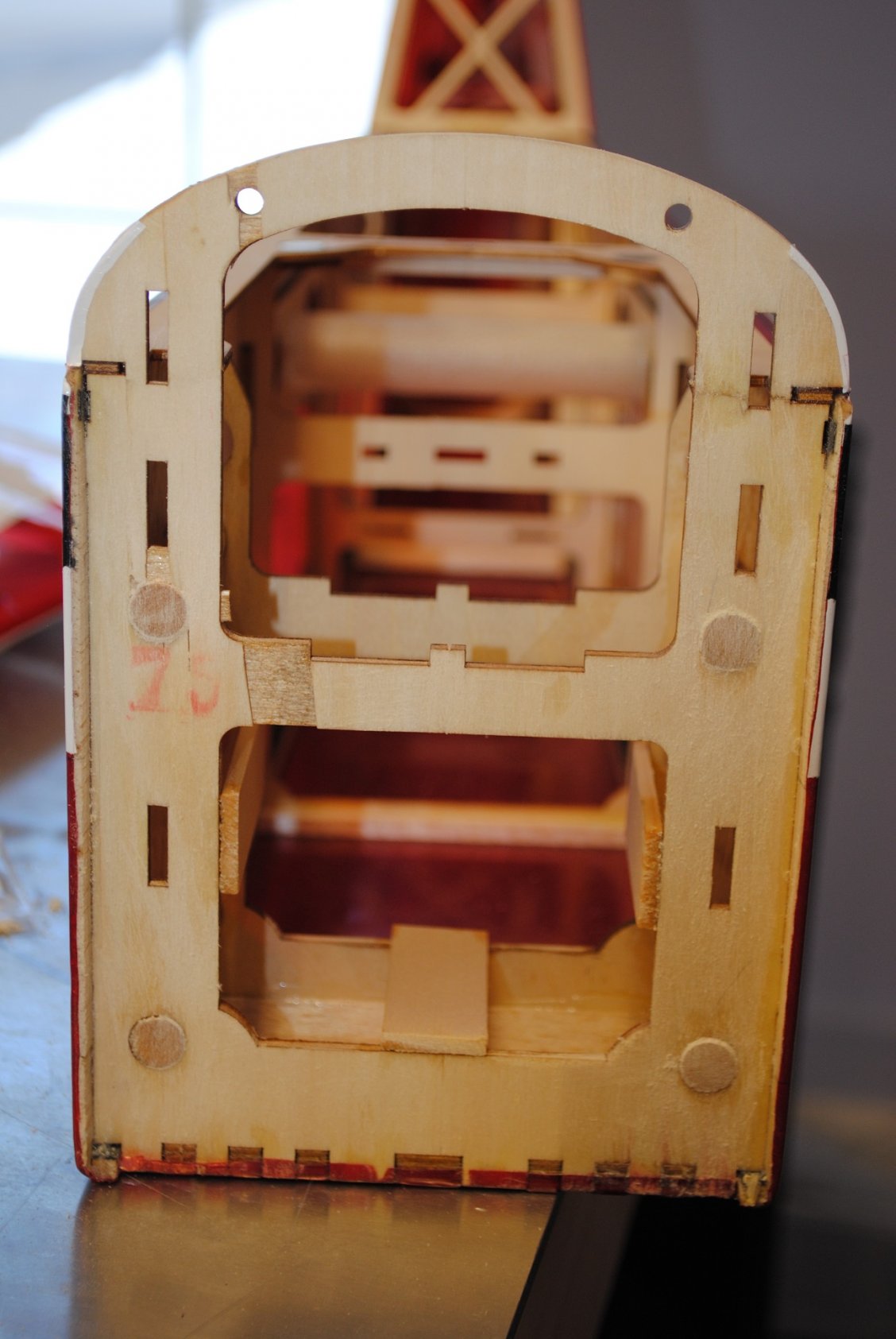

then I added dowel and some bracing pieces.

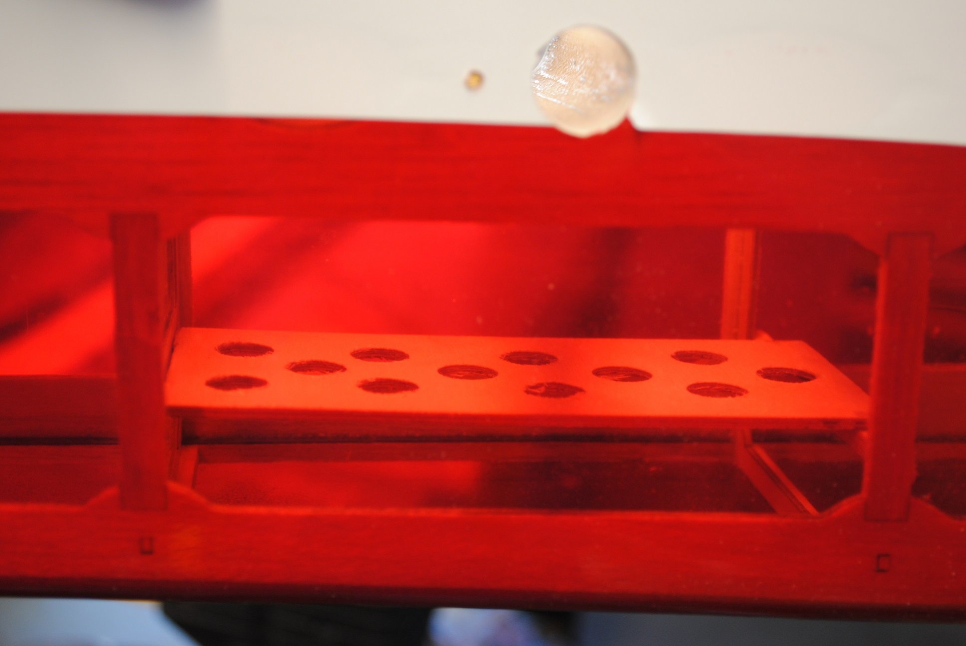

I had to build a platform for the ignition box after. This is mainly a balance decision. I drilled lightening holes to save some weight.

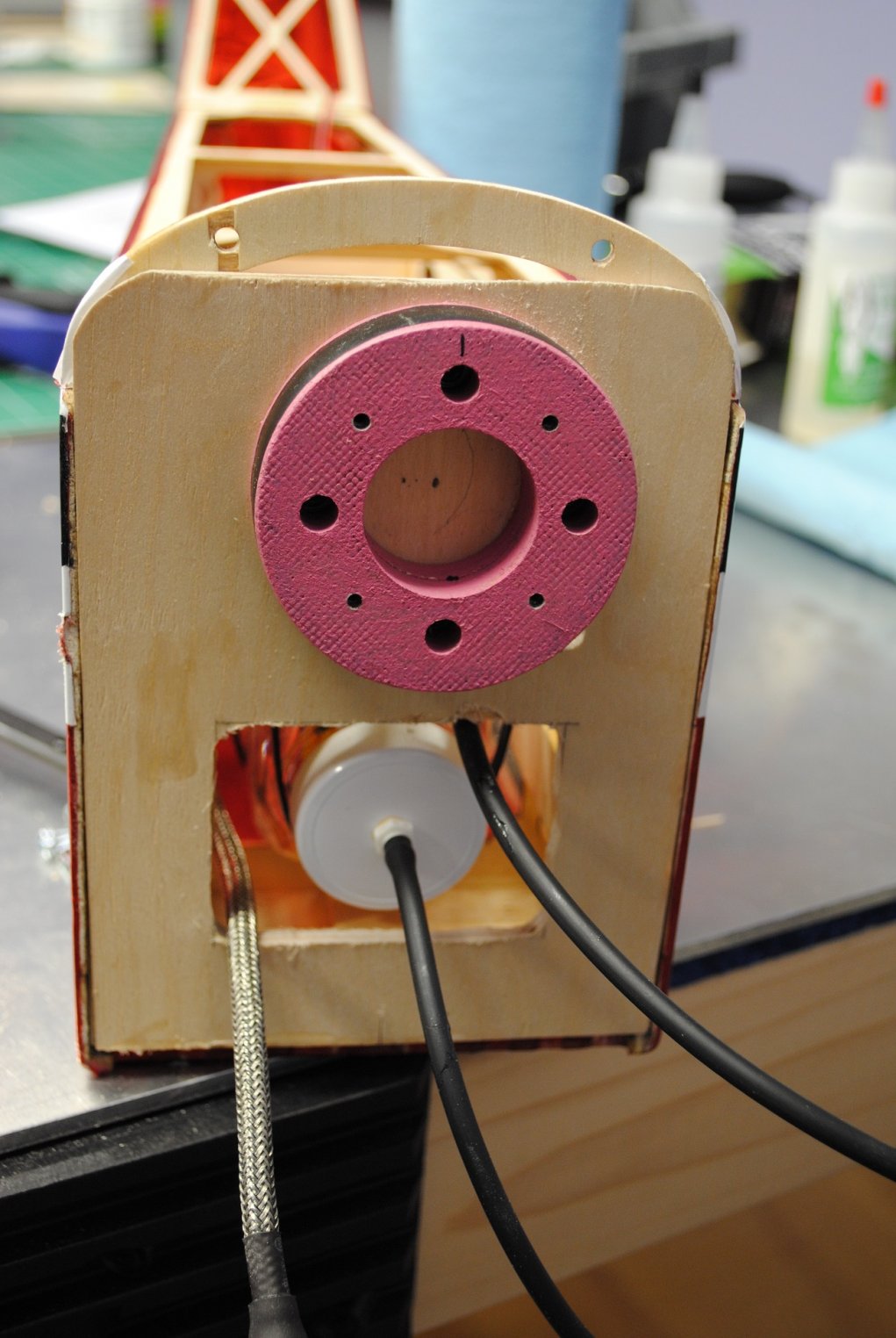

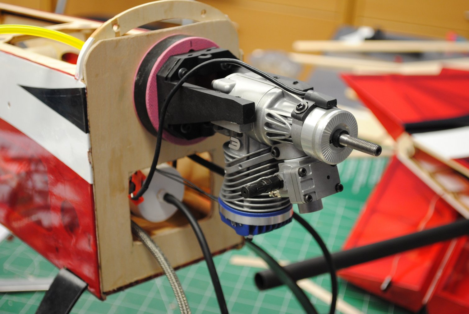

Here it is with the Hyde mount on. The fuel tank will be detailed later. I made the firewall by laminating two sheet together to get the thickness for the M3 blindnuts used in the mount. I epoxied it onto the front seen earlier in the dowel shot.

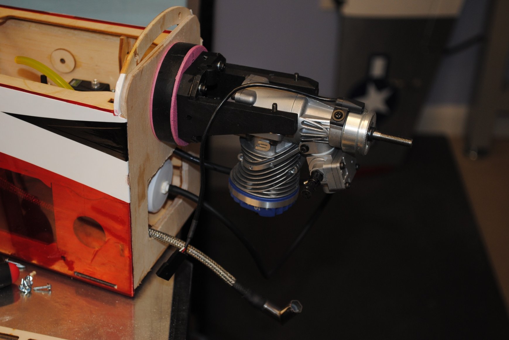

All mocked up. I used some washers to get the right and down thrust. It appears to be 2 degrees right and down from the electric mount, but that will have to be a tuning item later.

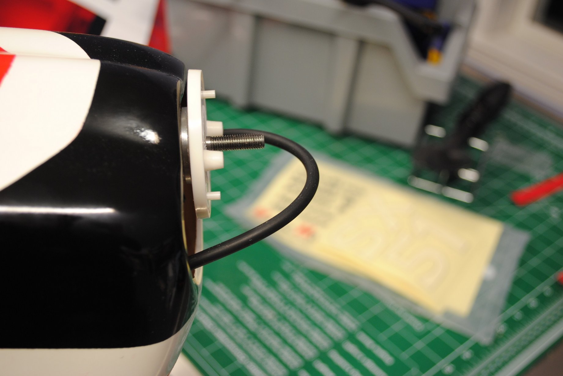

Installed with new beam mount for additional spacing. Hall sensor is routed back to the ignition box. Also I hooked up the temp sensor like Pete from horizon showed, looped around the spark plug.

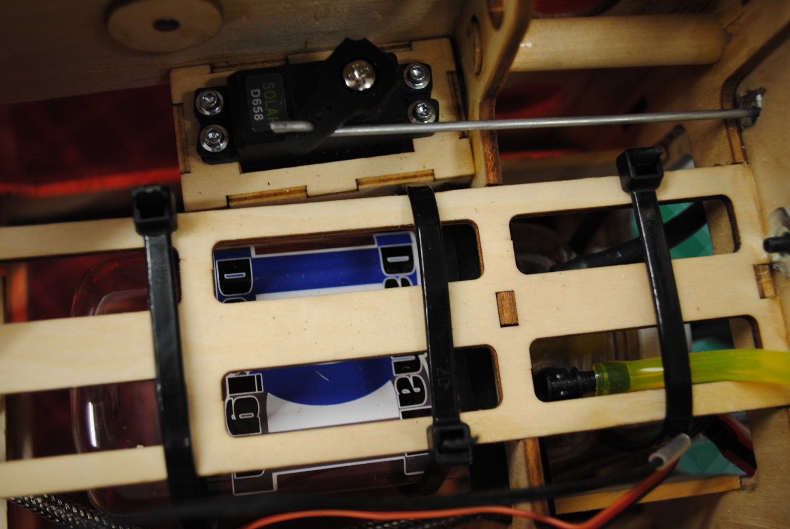

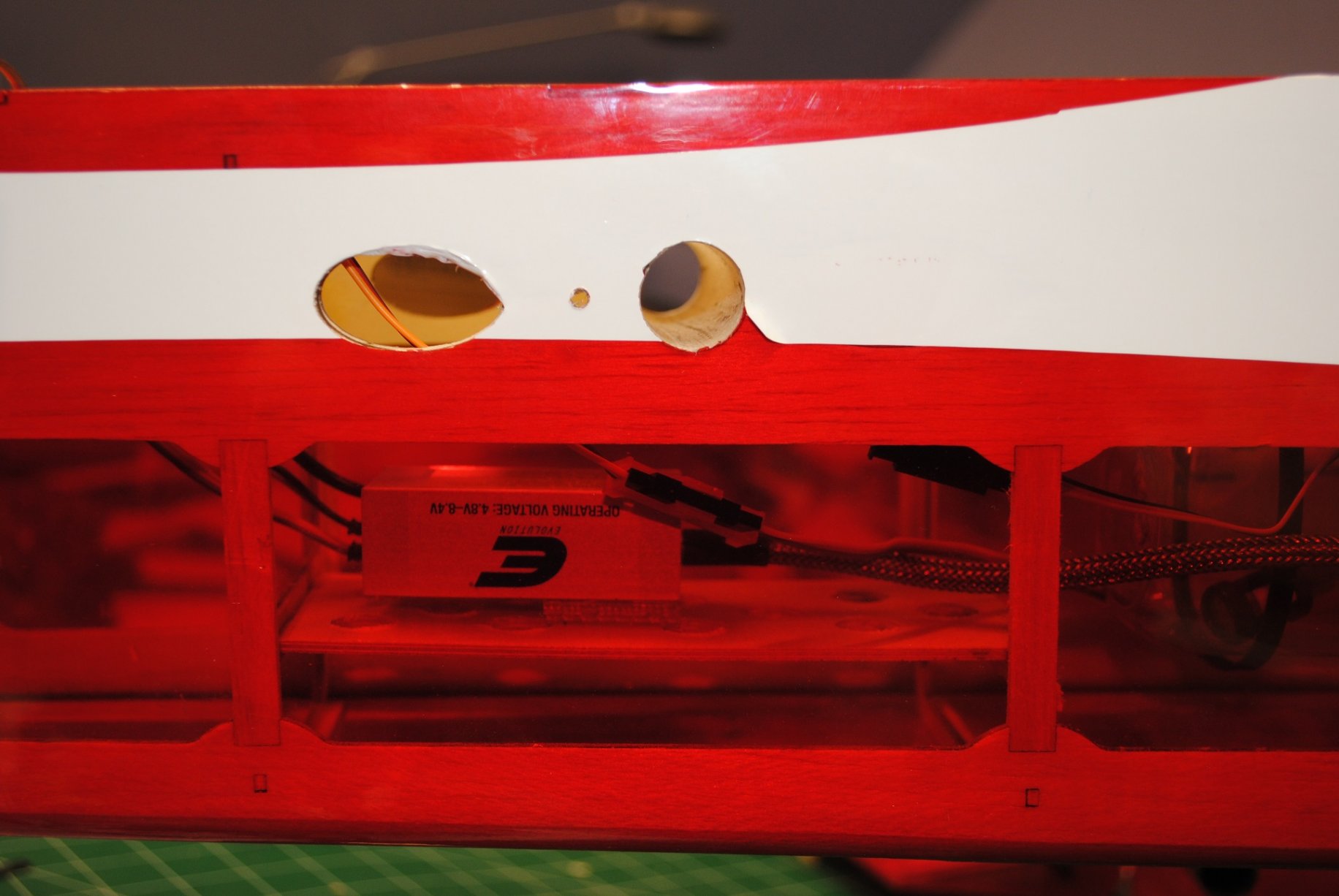

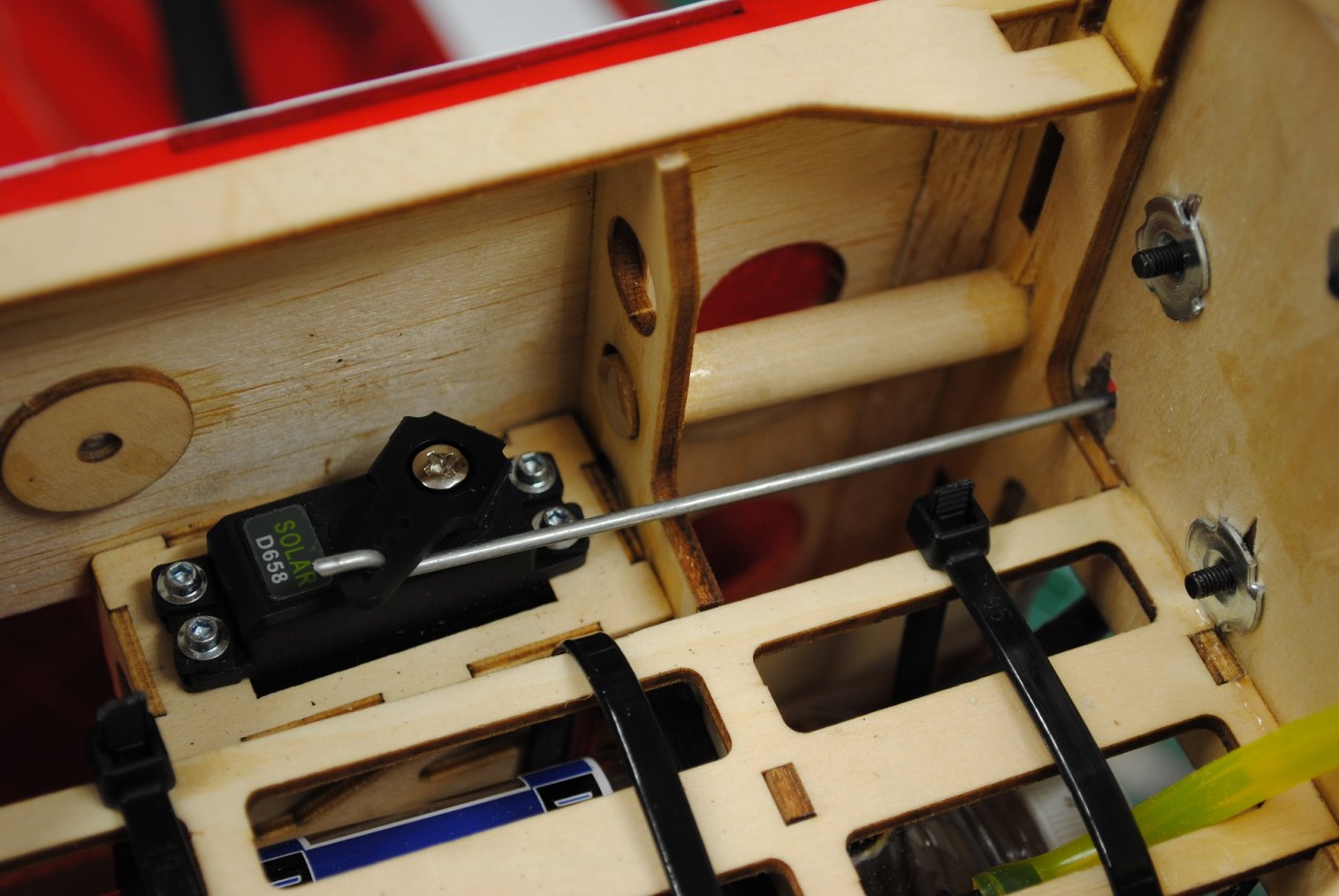

Throttle instillation. I had to go in one notch on the arm to get end points to be close to 100.
I hung the fuel tank from the battery tray. This way I can see the fuel level from the outside and also I can route the fuel lines better. It is possible to put it on top, but it is very tight. Another benefit is having this mass more centered on vertical CG

Cowl spacing. I think this will enough to allow the Hyde mount to work.

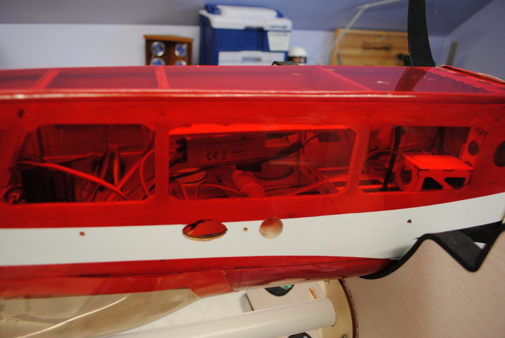

This a picture of the fuse inverted to show the ignition, wiring, and throttle box.

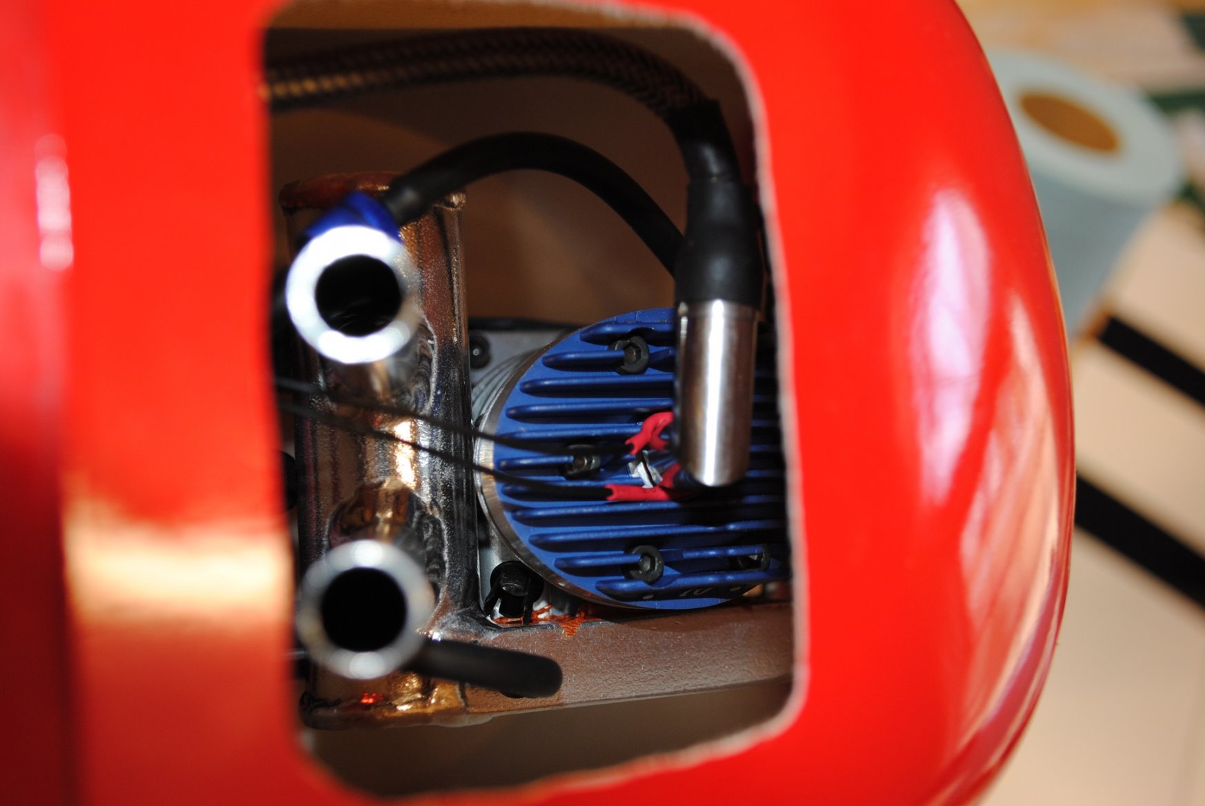

Final Engine installation from the bottom of the cowl. You can see the temp sensor and the Jtec pitts.

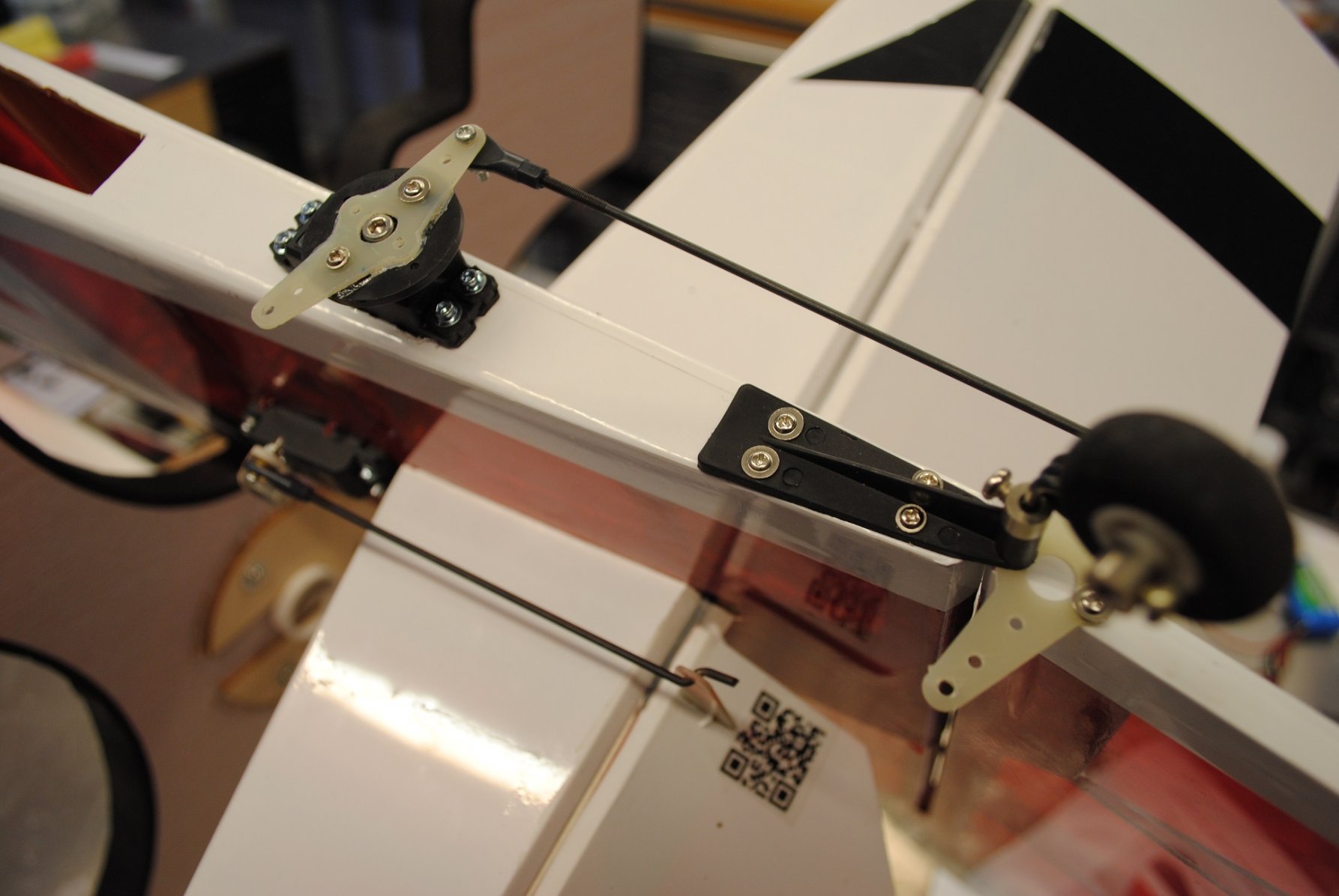

I did z bends instead of the EZ connectors on the push rods and only did one one the rudder as I had binging over a certain amount of rudder throw.

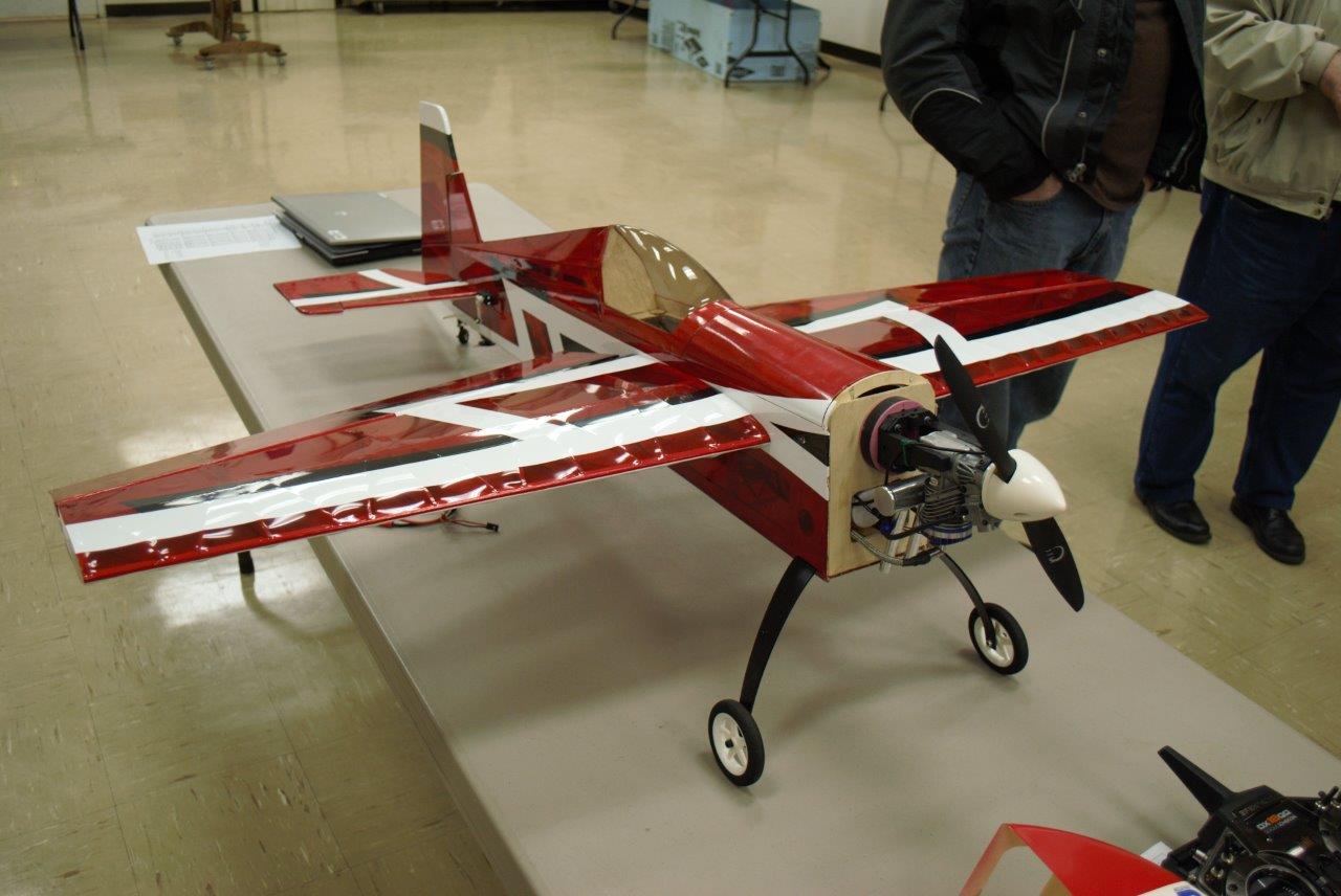

Finished plane at the club's show and tell night.

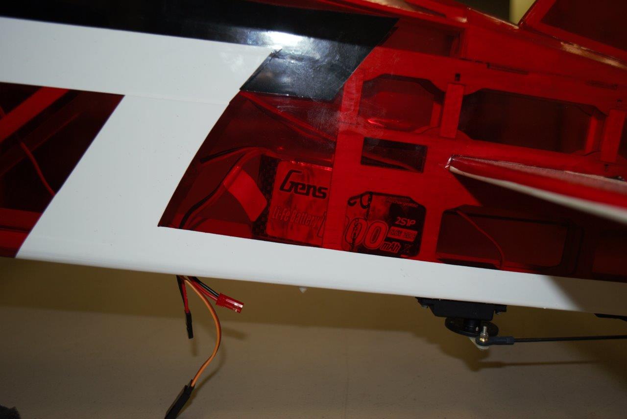

Here is where I had to install the battery in the tail. 1900 LiFe and it balances with no fuel. I might redo the tail wheel which will add a little weight and hopefully it will have a good 3D C of G.
