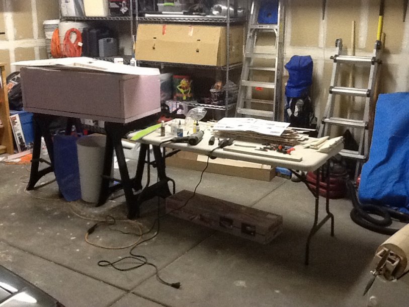

I currently do no thave a building table good enough for this build so I will need to make one of those as well. I am planning a hollow core door with ceiling tiles as the building surface. The last week of the month, I plan on actually building the table. Pictures to follow. Here is the progress so far on this project...

Attached are pictures of of my current work station and of what I have ready for this build. image.jpg image.jpg

Just a suggestion....Get some sheet rock "gypsum board" to cut to size and lay it over the hollow core door. Makes a nice flat surface that wont sag and you can still push pins in it. Best with your build. I love the EDGE.

49Dimes, I will keep that in mind. I will try these ceiling tiles out to see how they do. They were dirt cheap and looks like pins will hold well with them. If they don't work out, I will check out the gypsum.
