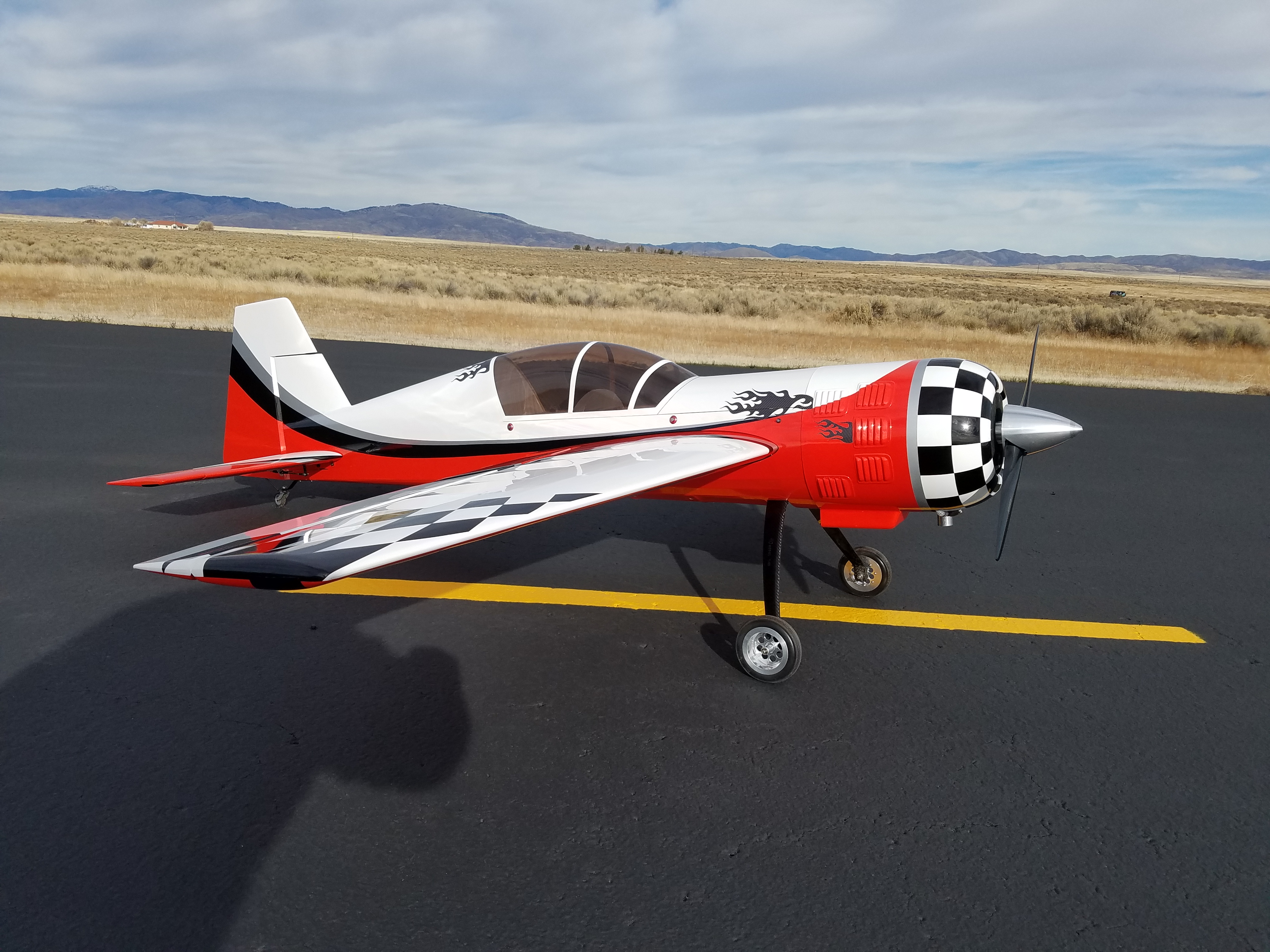

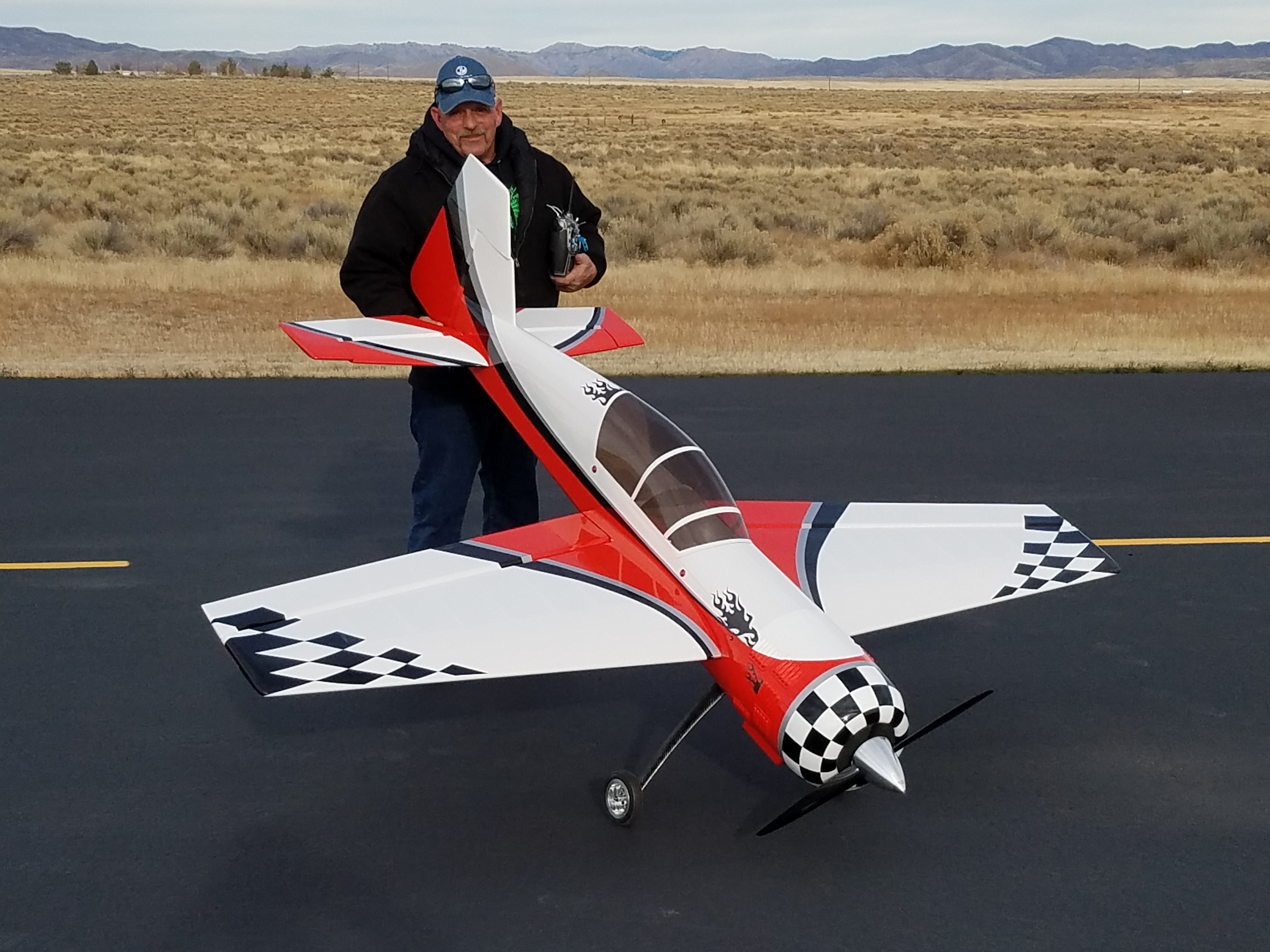

    Can't say for sure but have heard the Pilot was a good flying plane. The SD on the other hand is amazing.
    As for cg? I never checked my SD. I flipped the prop, warmed the 62 and blasted off. What a thrill. But... from all my other Pilot RC airframes, cg is usually on or aft of wing tube centerline. Depending on your flying style. I likes mine neutral to slightly tail heavy.
