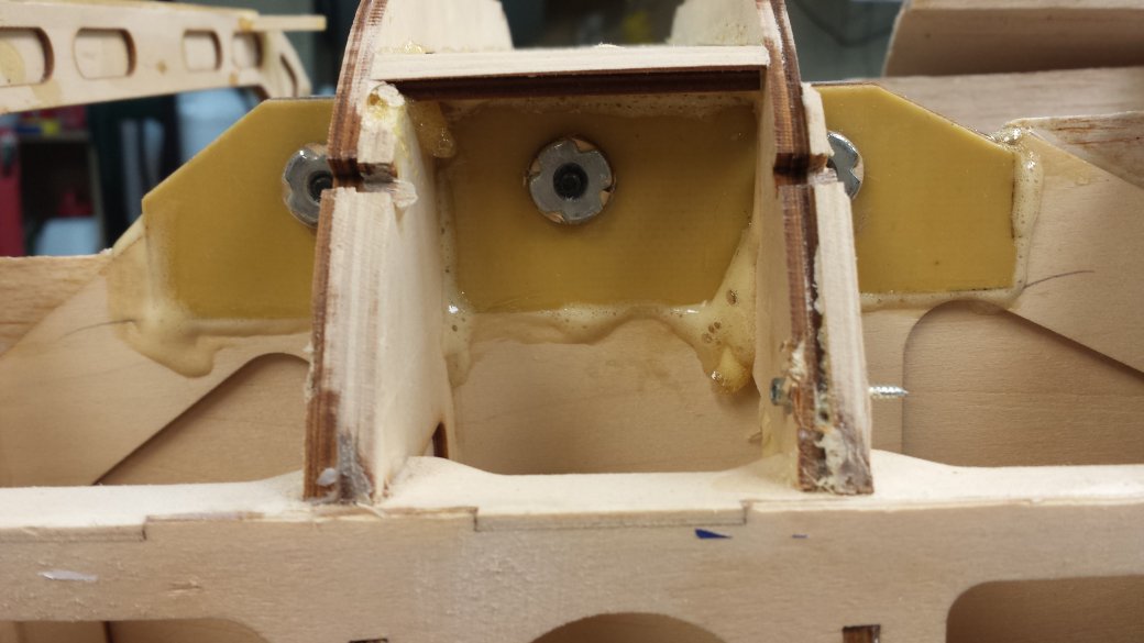

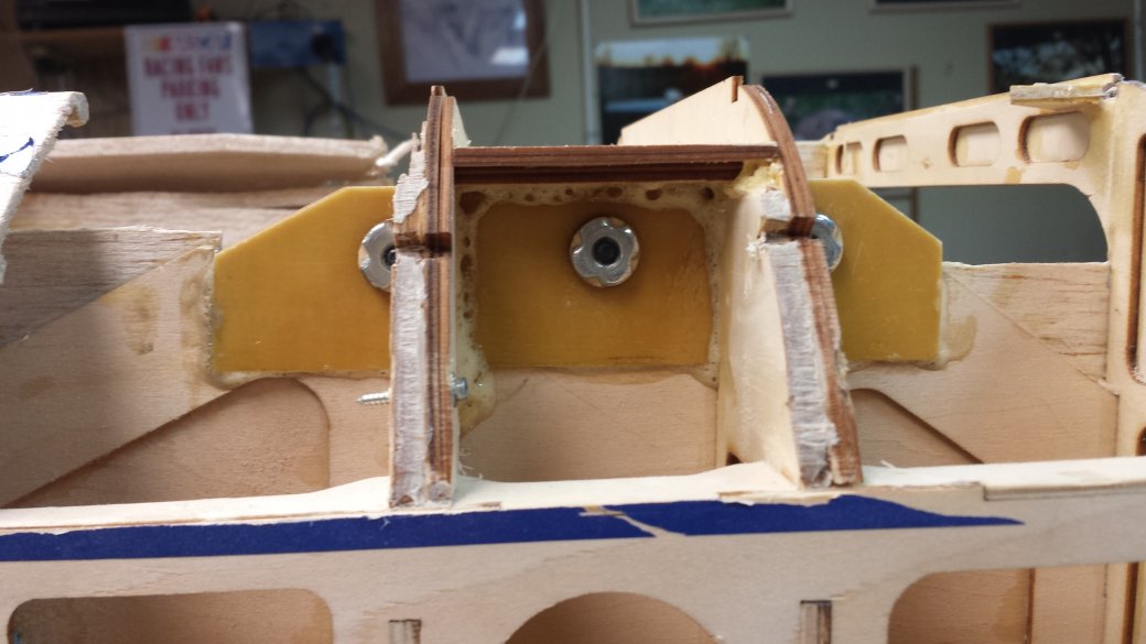

thurmma

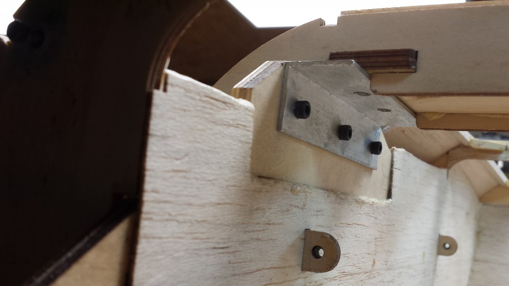

Here is one side of the landing gear repaired. I found out that the newer model engine box kits are more structurally sound than the original. This is why there is fiberglass over the top of the piece I replaced

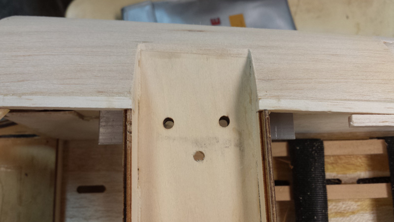

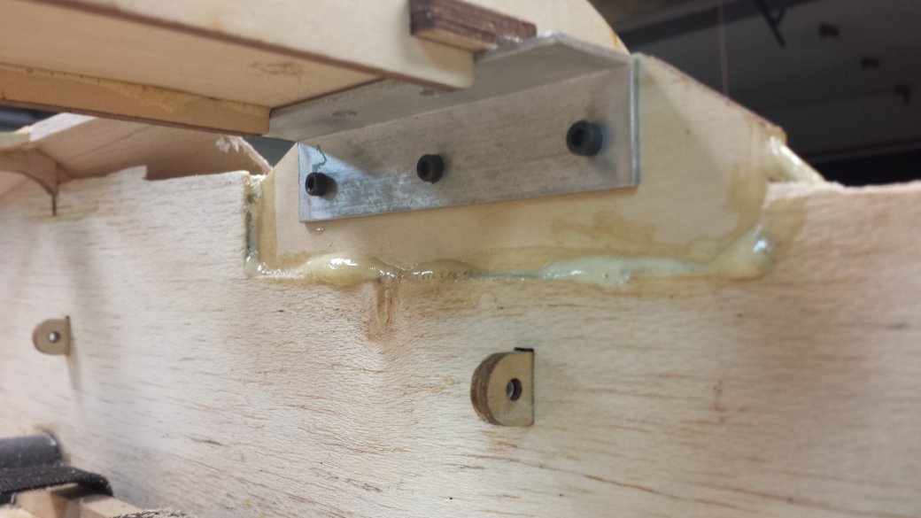

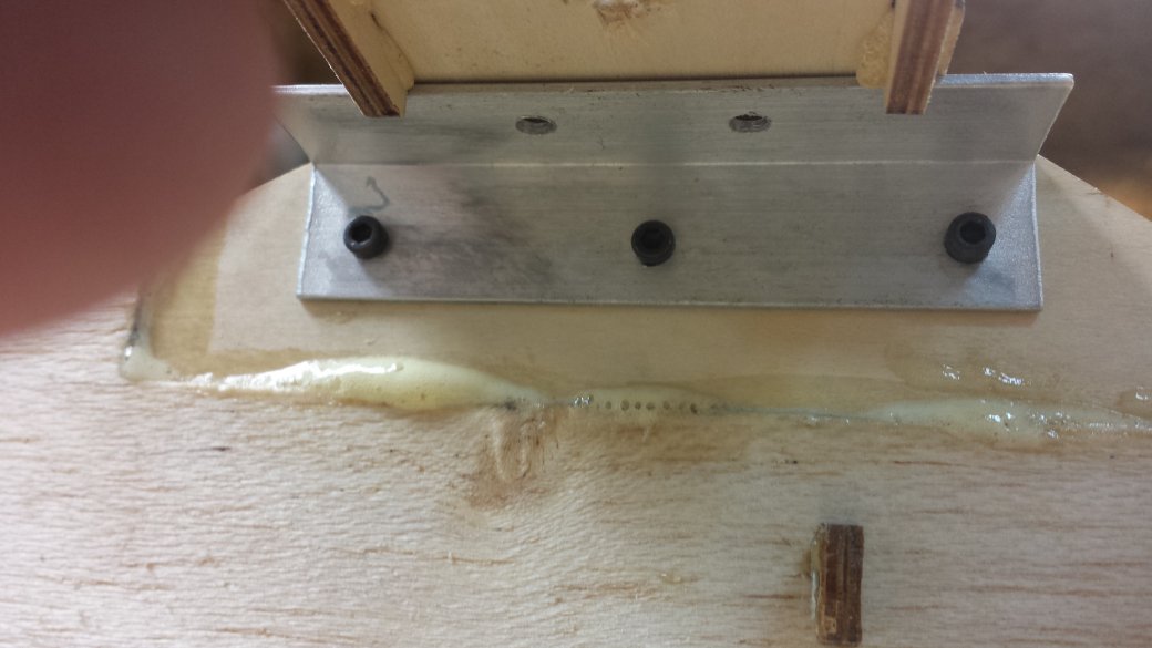

thurmma

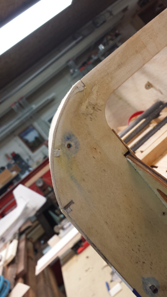

Well, I got to other side of the landing gear block finished last night and re-glued a few other spot in the fuse while I was at it. I will be double checking all of the joints and then adding the missing stringers and sheeting that had to be removed for the repairs or was tore up during the crash. Will also be removing the rudder and replacing the hinges once they get here.

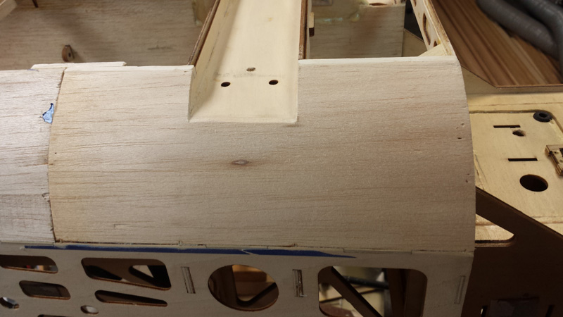

thurmma

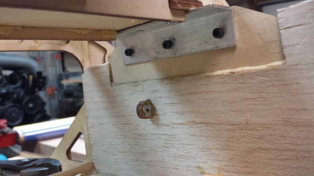

Have completed one side sheeting and all. Now to add some filler to make things a little smoother where the pieces meet and then to the other side for sheeting
