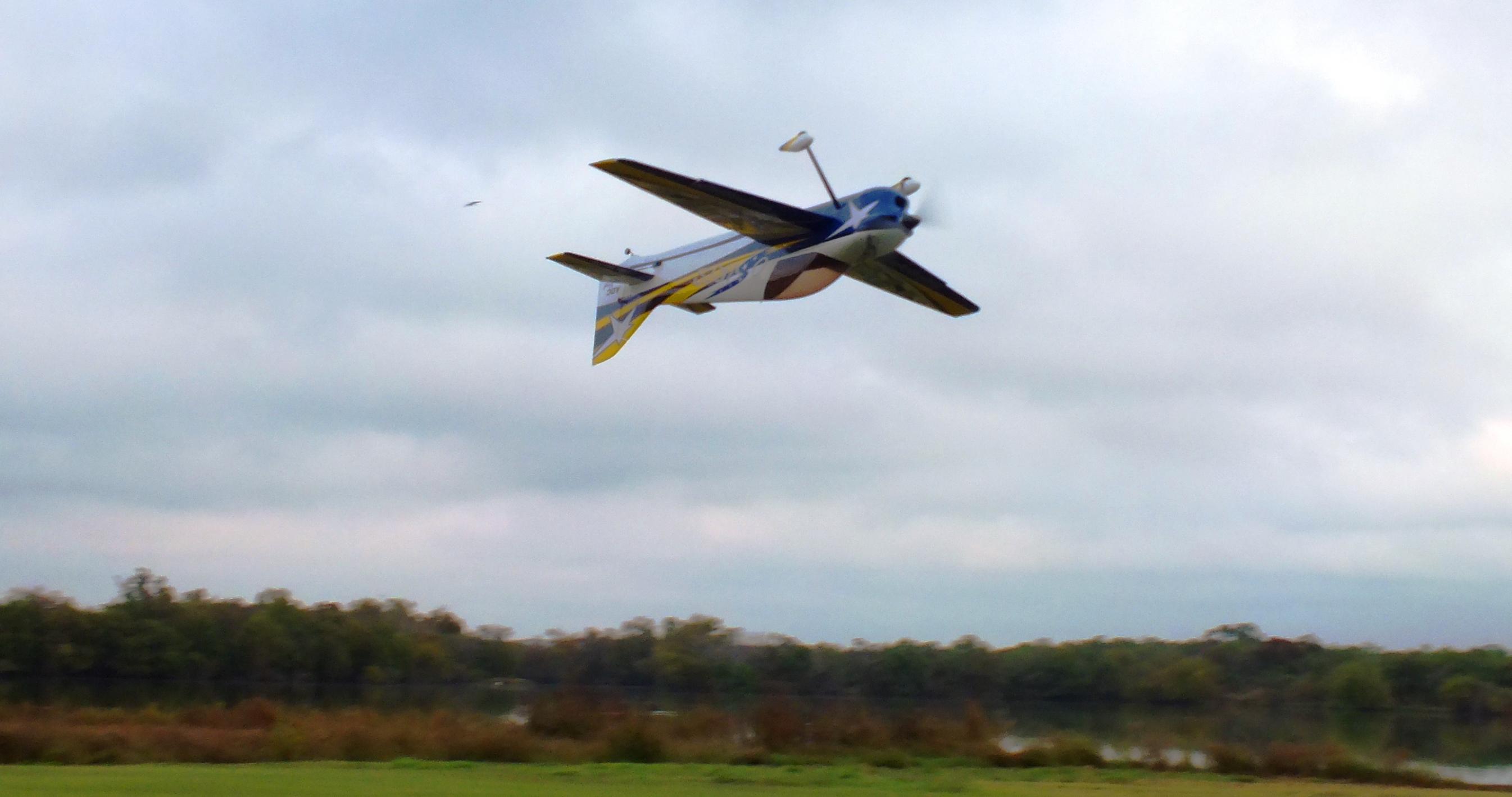

This plane is fast, precise, and looks amazing in the air! Here are two pics I snapped of one flown by Twistedgrim today.

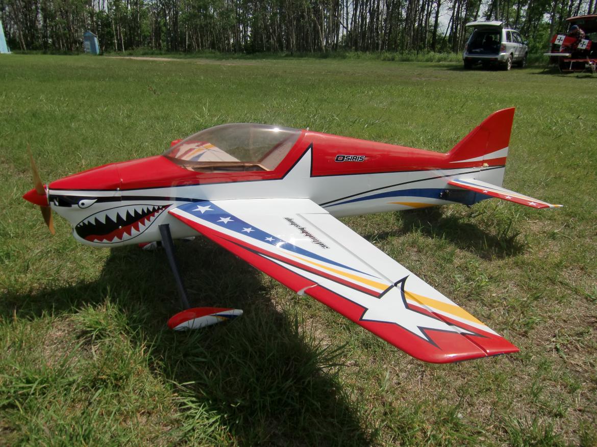

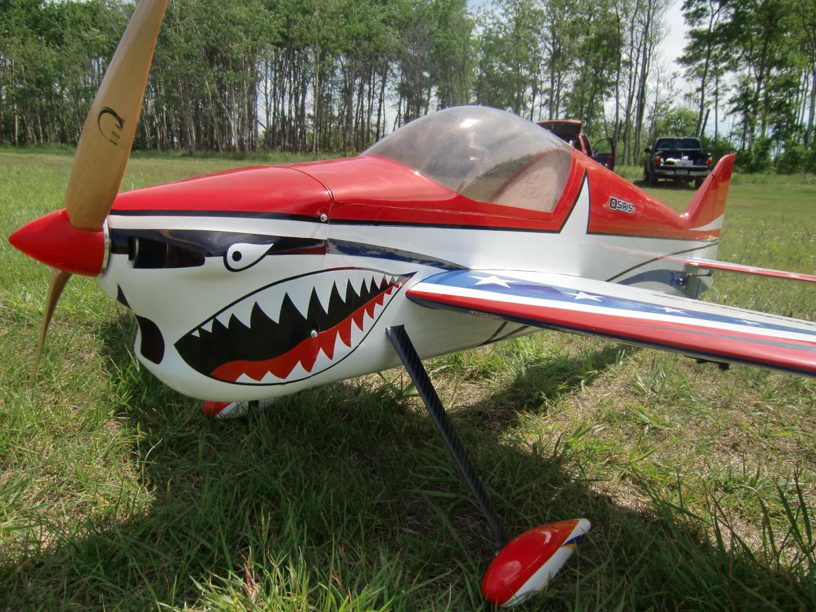

Doesn't seem to be much love for the 62" Osiris here. I bought one for windy days after being impressed with the smaller Aspera and how well it handled the wind. The Oris is amazing in the wind, and tackles it like nothing else I have ever flown. When the rest of the field is grounded, I'm still burning holes in the sky with little effort. I've flown it in such strong winds cross winds that I haven't even been able to taxi it back after the flight. Full down elevator and full rudder and it would still just weather vane into the wind.
Even though I fly mostly 3D and just got the Osiris for those times when it's too windy for my 3D airframes, I've been pleasently surprised that I really enjoy flying the Osiris all the time. It seems to work it's way into the truck even when there isn't any wind in the forcast. It's a really enjoyable flying such perfect (for me) lines, slow rolls, rolling circles, and rolling loops, ect, with such little effort. A big plus is that it has really improved the precision flying with all of my 3D airframes.

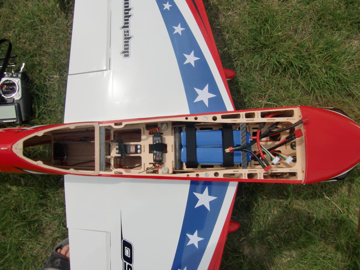

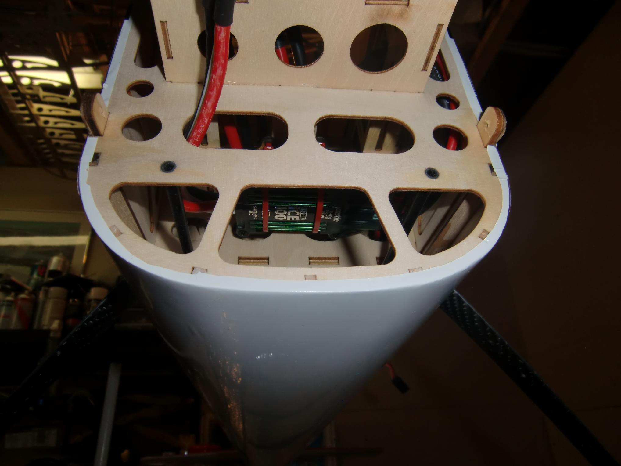

I went a different route with the power system in mine because I wanted to use my 4s packs. I went with 4s 4000 (x2) packs in series, and a Motrofly 4315-380. The packs are slightly heavier than recommended (motor is lighter), but the Osiris has held up to the extra weight without issue for several seasons now. With the packs almost all the way back at the wing tube it balanced with just a slight push inverted. I used to like hands off inverted, but after flying the Osiris like this I have changed all of my airframes to the slight push inverted. AJ designs his airframes to balance like this, and it really improves the precision side of things. I haven't noticed any negative effects to the 3D either with this CG.
Notes:

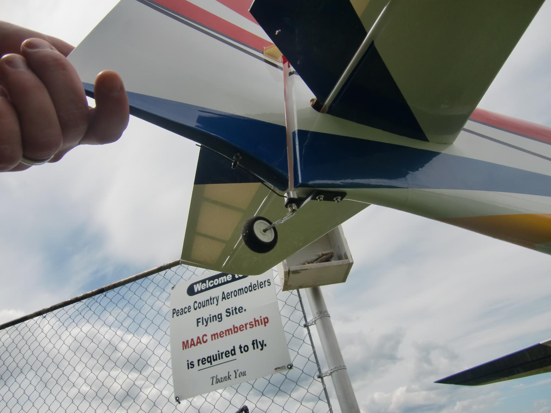

-51" Slick tailwheel - slightly heavier but less servo shock than standard set up
-Bec Pro in the tail for balance
-Ice 100 just ahead of the landing gear block for balance
-shark mouth decal from ADC Hobby Store
