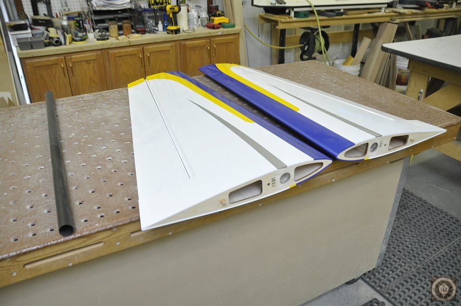

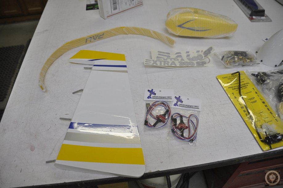

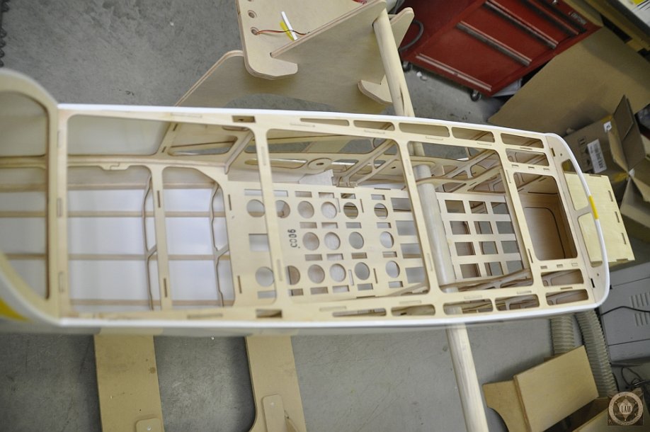

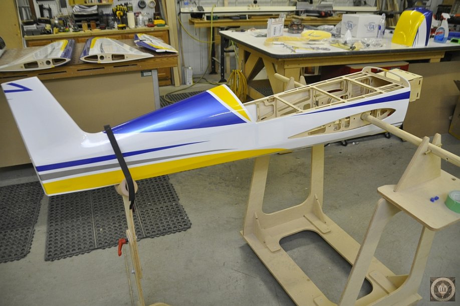

Some pics and details from the un-boxing:
Note, parts come all wrapped and neatly packed but I unwrapped this after receiving it to inspect and also let it acclimate.
Some of the items I'm using are up for debate, but the main components are all set.

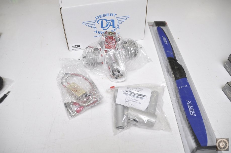

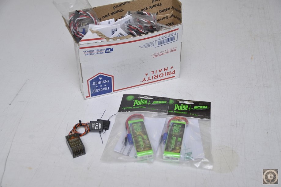

- First is the DA70 (why not). J&A mufflers are the best (IMHO), so they are a must. And through my own observations I prefer the Falcon 25x8W prop for the type of flying that I enjoy.

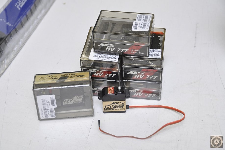

- Next MKS servos, I through the beating I put on my others this summer I have yet to find anything that centers as well and and equal quality in such a reasonably priced servo. 777's and 1250 on throttle for this bird. Herve has MKS products on his site so check them out while you are there! www.flypau.com

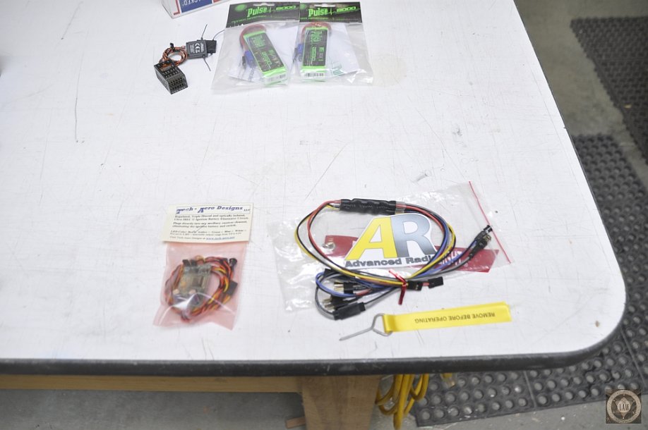

- I'm a Spektrum flyer so I'm using the standard 9ch RX, I'm using Pulse 2S Lipos which I've been really having great luck with. I'm using a Booma hidden switch, that is basically a dual lead in / out with a built in batt share, pin/flag switch with an LED indicator (https://duraliteflightsystems.com/index.php?route=product/product&path=154_158&product_id=455)
My HD extensions, Tech Aero IBEC and Falcon prop are from www.flyboysrc.com, check them out! New and expanding inventory and amazing service, they will be an up and coming company to keep your eye on.

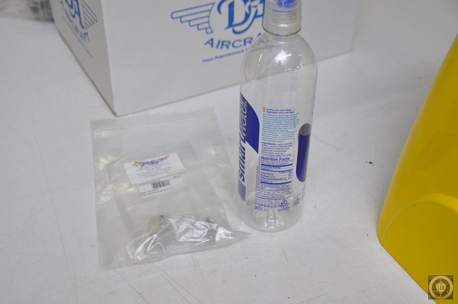

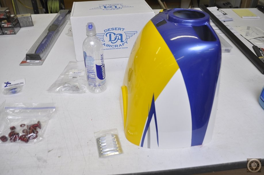

- I'm up in the air on fuel system, I got this plane before Herve started including fuel tanks, but I do have one from him. I'm pondering a 32oz tank like I used in my old EF Extra or going to a more sensible 24" which I had planned for this plane (smart water bottle with PSP cap and fittings).

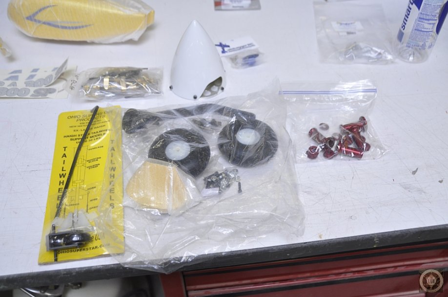

I also had a tailwheel on hand but Herve's new carbon tail wheels are really nice. I'm going to use whichever gives me adequate rudder dragging protection for the rudder.
I will be using a no-limitz spinner from PAU, that I may paint to match the plane.

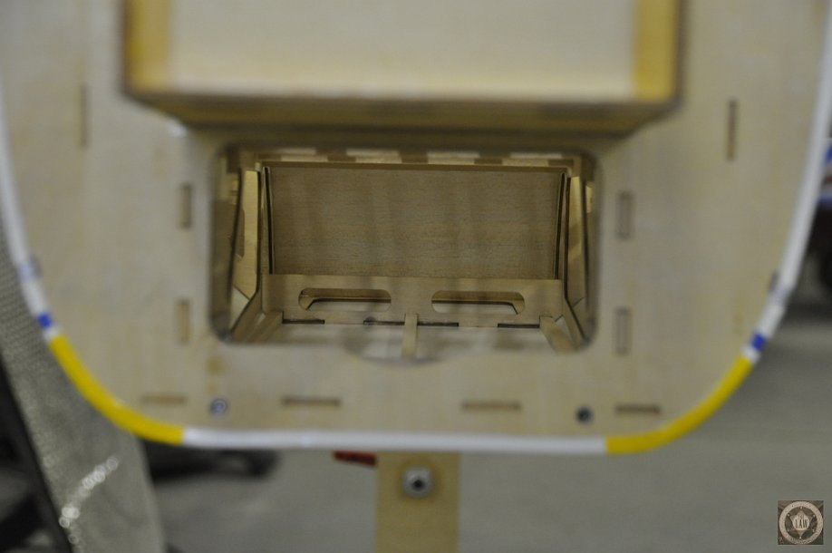

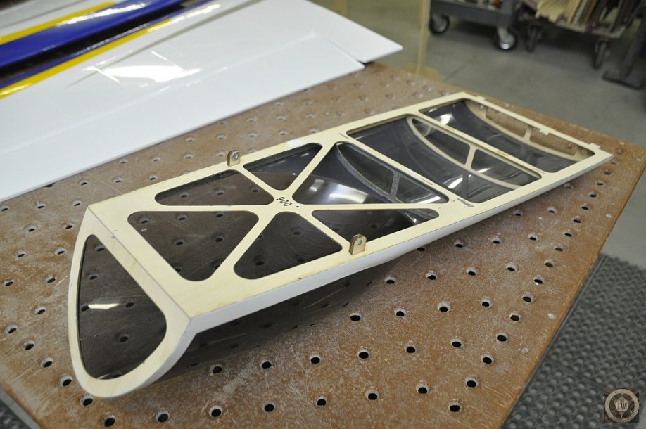

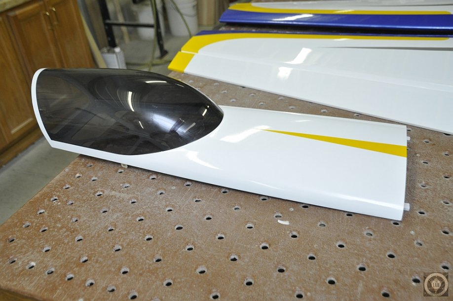

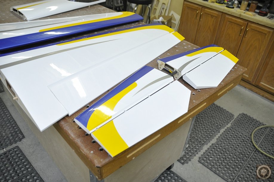

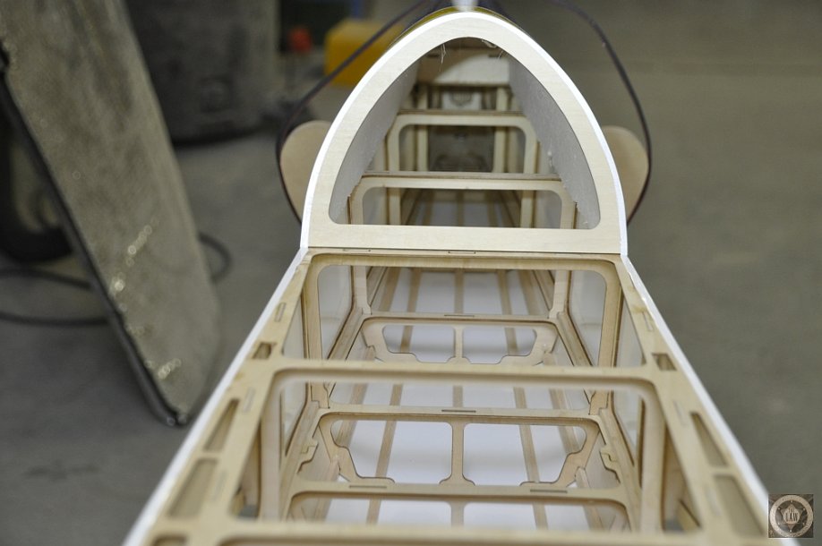

- Rest is pretty standard PAU quality. Dubro style pin hinges, medium to dense balsa longerons (9 of them in this plane), canister ready "open" tunnel to keep weight down. If you choose canister(s) it's super easy to close this area in if you choose. The canopy is light weight and one piece because it's a little small to have the removable canopy shell.

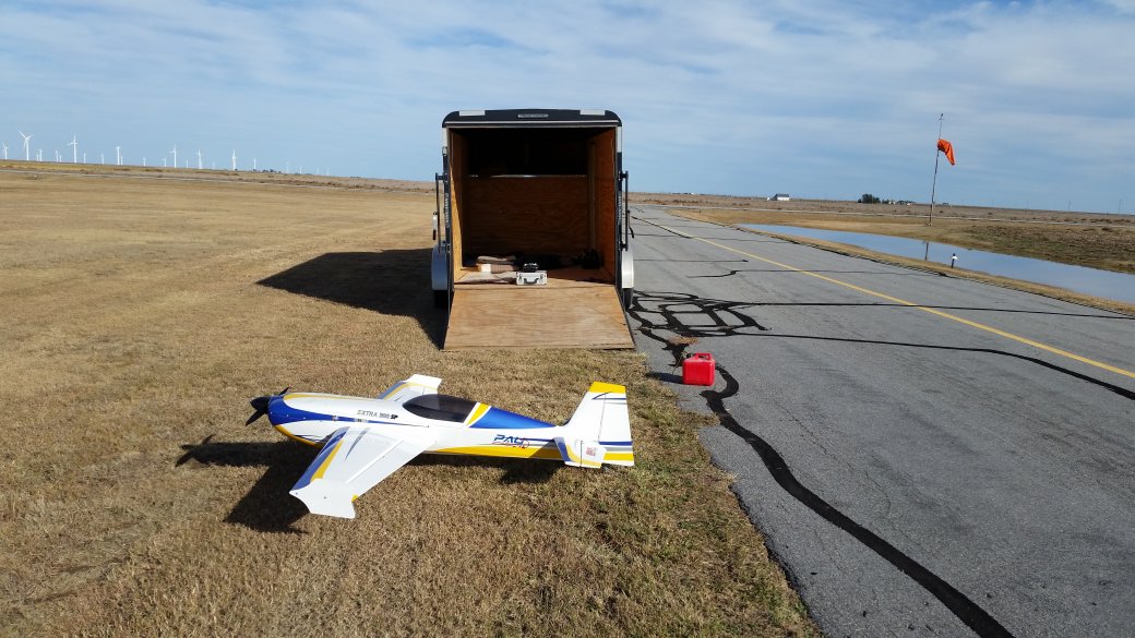

I've been flying mine this past year. Got 50 flights on it so far. I'm running that EME 70 that I got from you, Terry. I just cannot complain how that motor runs. Not one bit of trouble, just fuel it up and fly! :D Its not as much power as a DA 70 but it pulls it around just fine.
