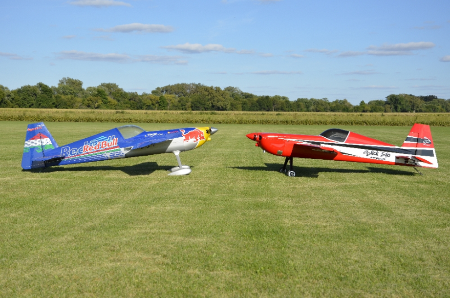

When we introduced the 100cc 42% HyperLITE earlier this year I had lots of PM’s on if there was going to be a 35% version. So this is the going to be the proto build of the 35% HyperLITE. I’m going to be using a DA70cc for the Engine with stock exhaust on this one and Savox servo’s. To save some time in the future I am going to kind of do this build as a manual format so there will be a lot of pics of detail and some video. If you haven’t fallowed any of the past builds of the 42% there is one being done know by Bipenut here on GSN http://giantscalenews.com/threads/fibertech-hyperlite-slick-540-build-thread.1447/page-2#post-33027

Just a couple pics of the 42% to start with. The 35% will look the same just a bit smaller

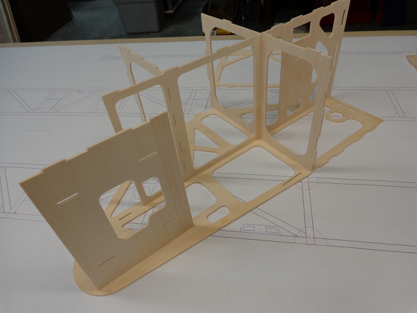

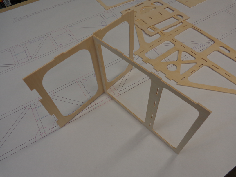

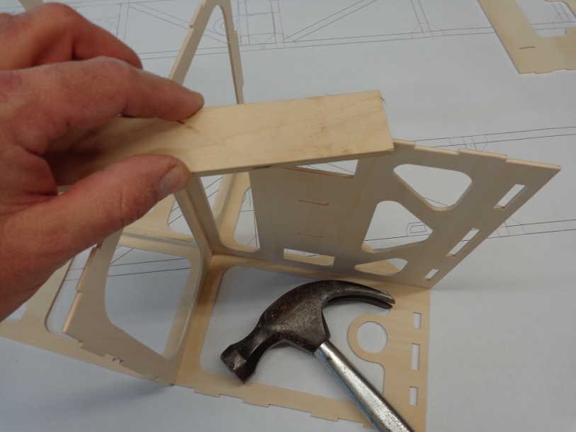

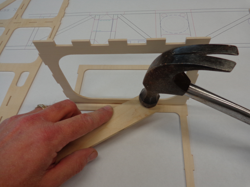

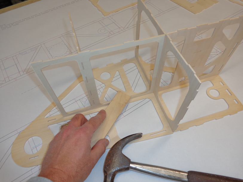

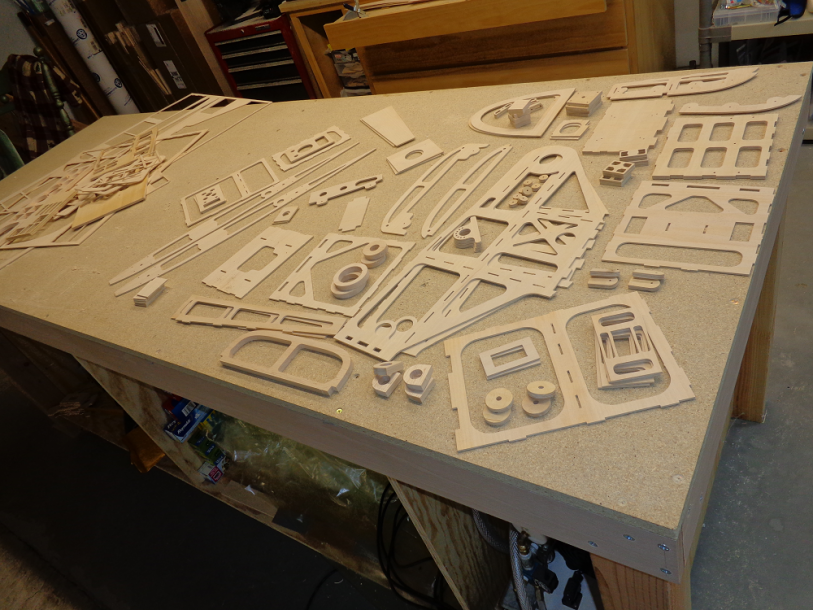

After removing all the CNC cut parts and some light sanding I started with the center portion of the engine box. I’ll build the engine box complete before any glue is used. As pic 2 shows I start with TG1 and F2C 3/32”Ply paying attention to each part position. The parts will fit very tight and will need to be forced together. This is to allow very good glue joint with CA You need some light tapping with a small hammer and block to force each tab in mating part. Again this tight fit is done on purpose for a good glue joint.

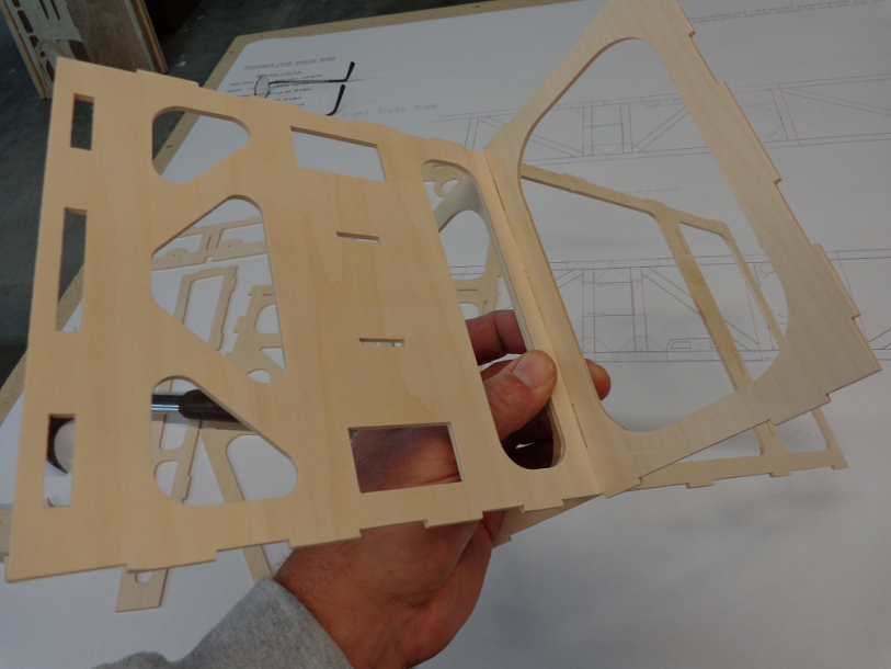

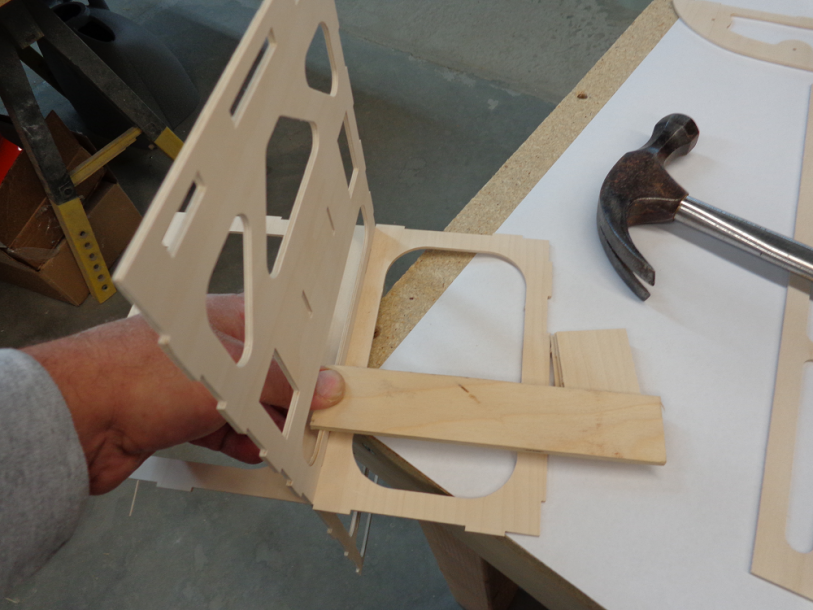

Next will be the lower MB that has cut outs for throttle/choke servos.

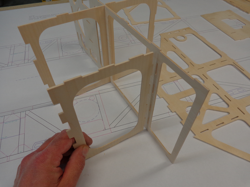

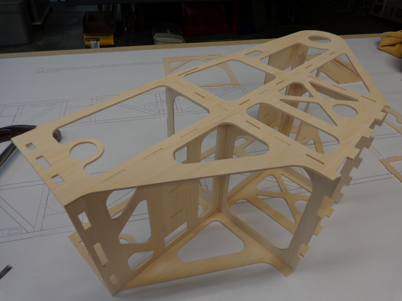

Know the RH side of engine box.
Then the LH engine side in place
