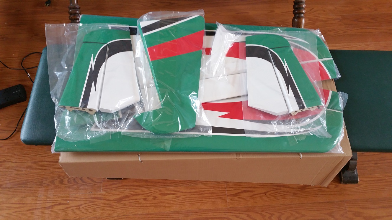

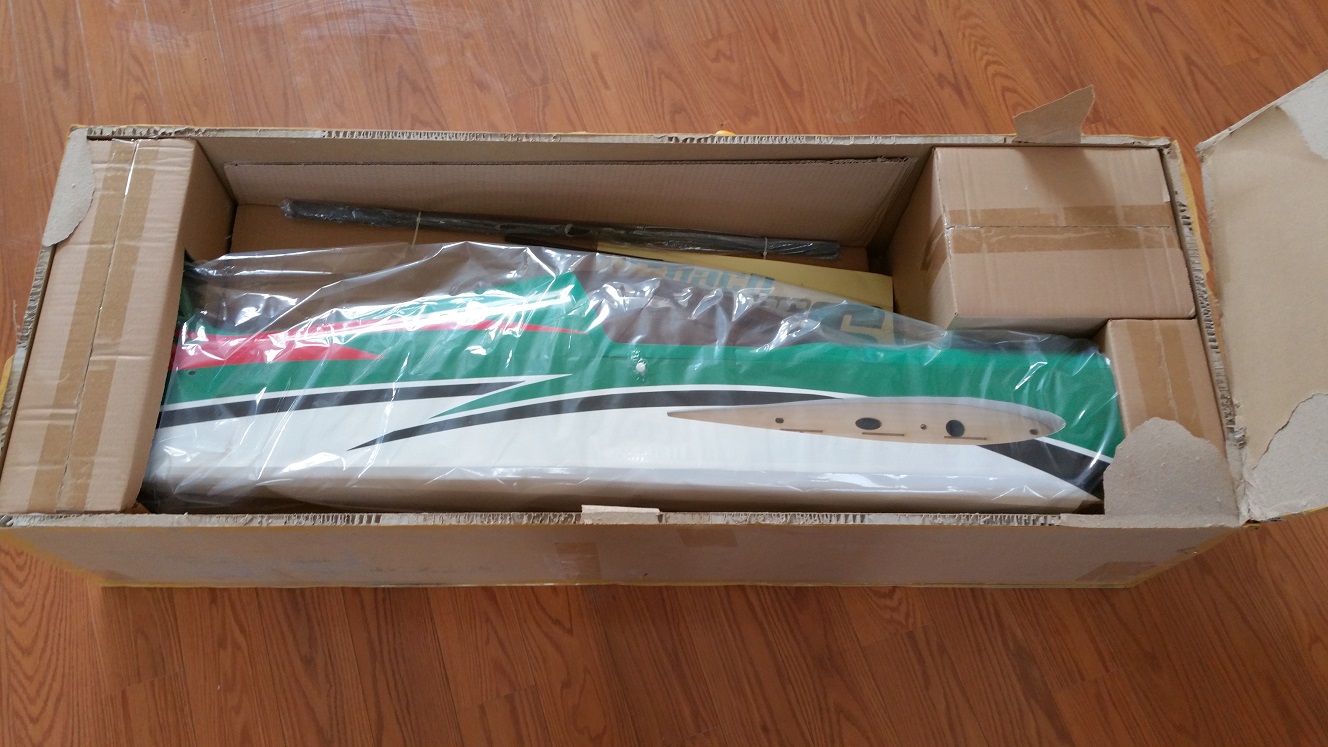

It came packed very well -- no complains there. Thick cardboard, everything wrapped and tape suspended nicely.

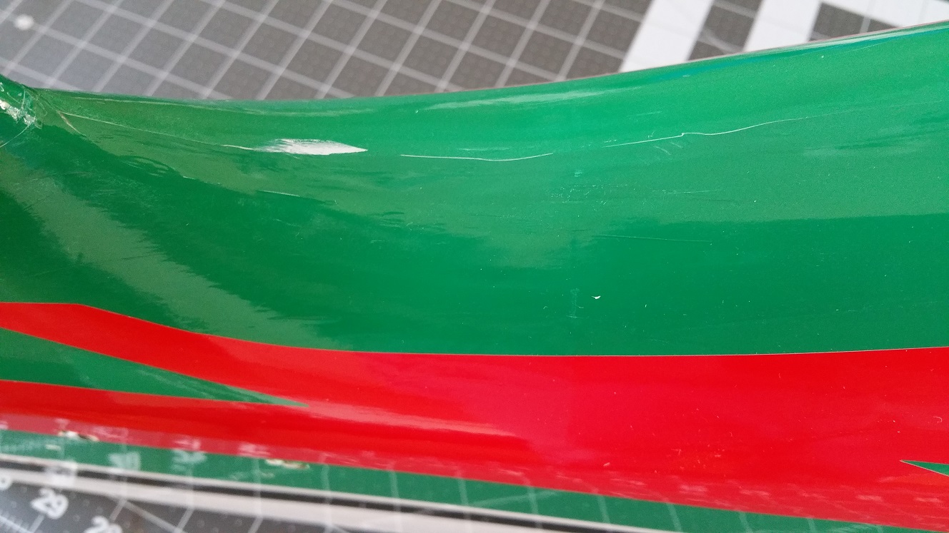

The only blemish was some white gunk in front of the stab. The sticker sheet had curled up and separated too, but meh I probably wouldn't use them anyway.

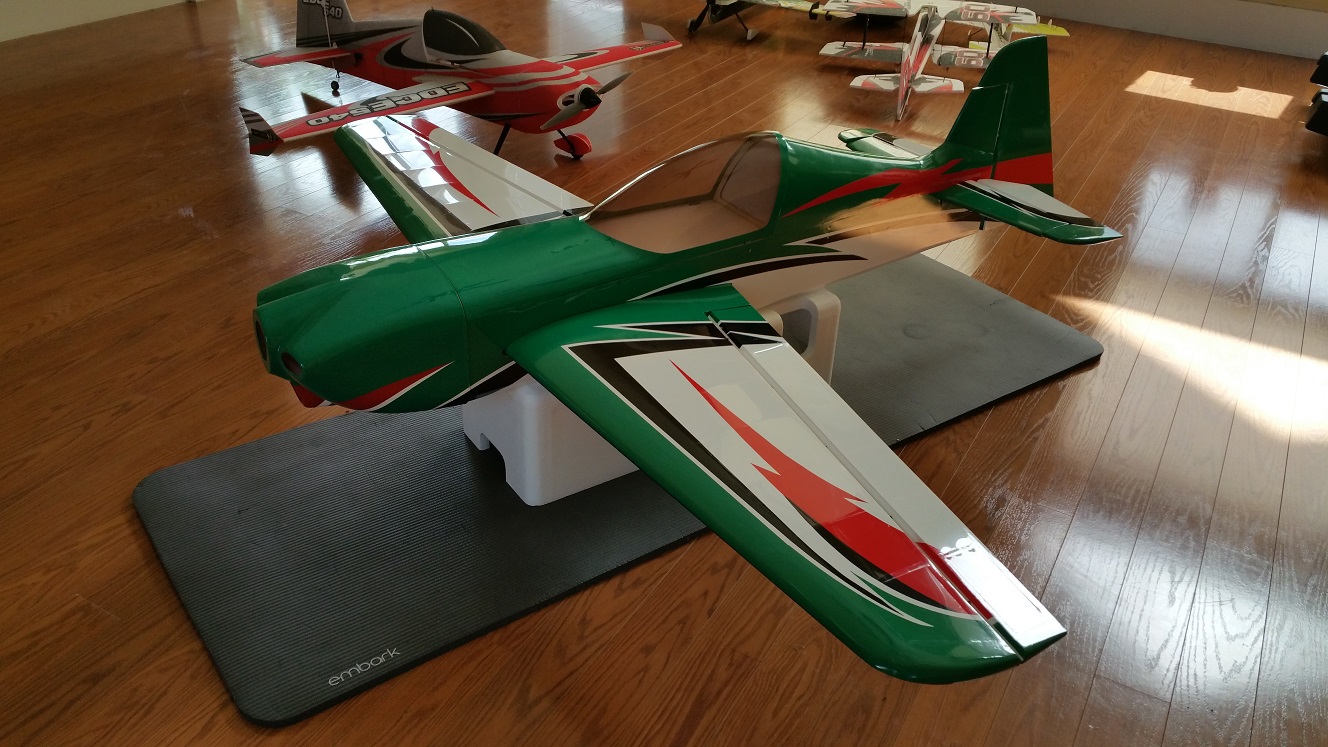

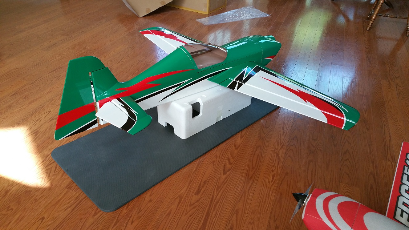

A quick test fit of everything -- I loooove this color scheme.

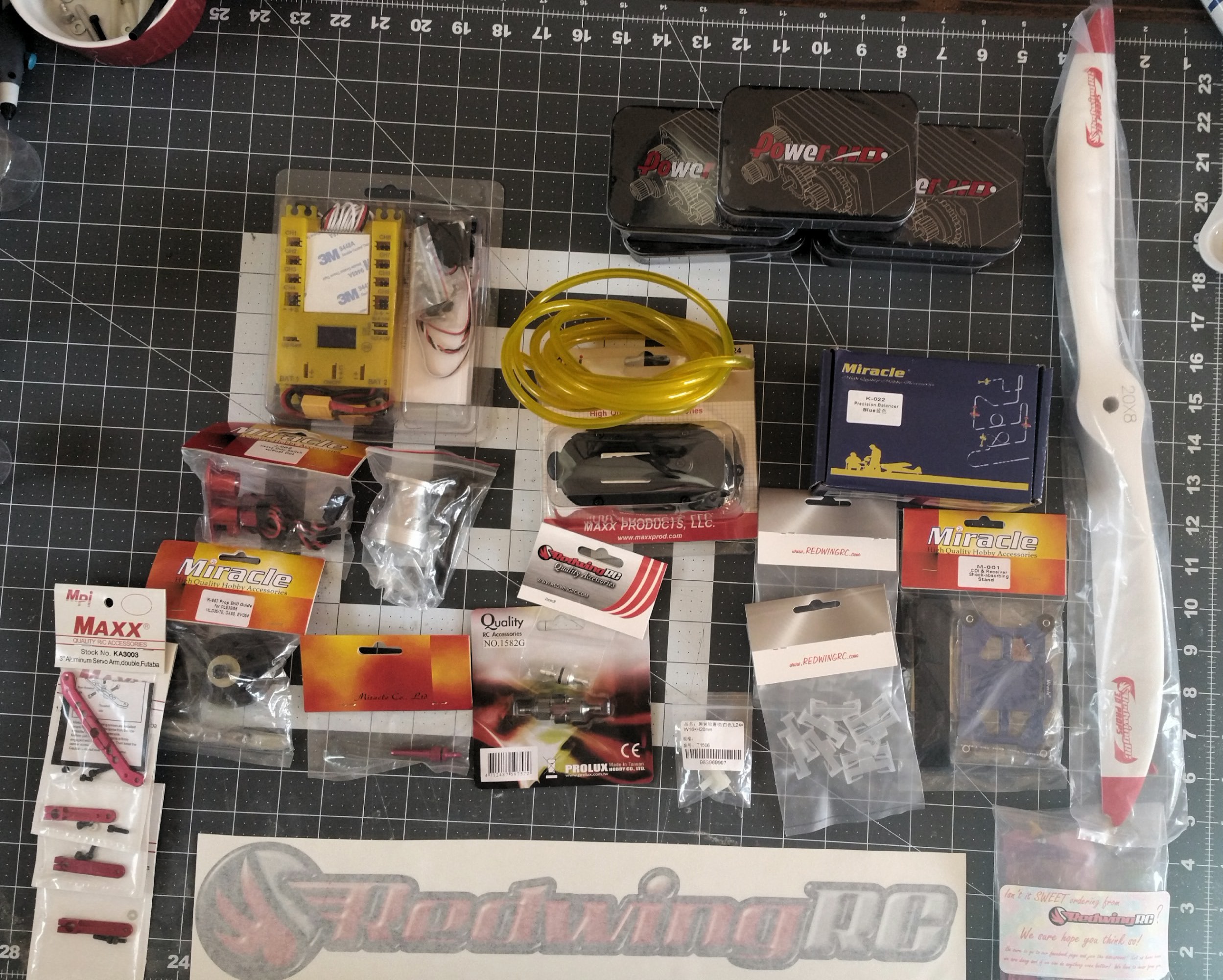

The first of a few boxes from @RedwingRC arrived today! They had everything I needed to get started building this bird in stock ... and Tim and Kaitlin are pretty darn awesome. Highly recommended (but you all know that).
Plus they gave me candy. I cannot stress enough how cool that is.
:ecstatic:
I'll go over this stuff as I start installing/testing/playing.

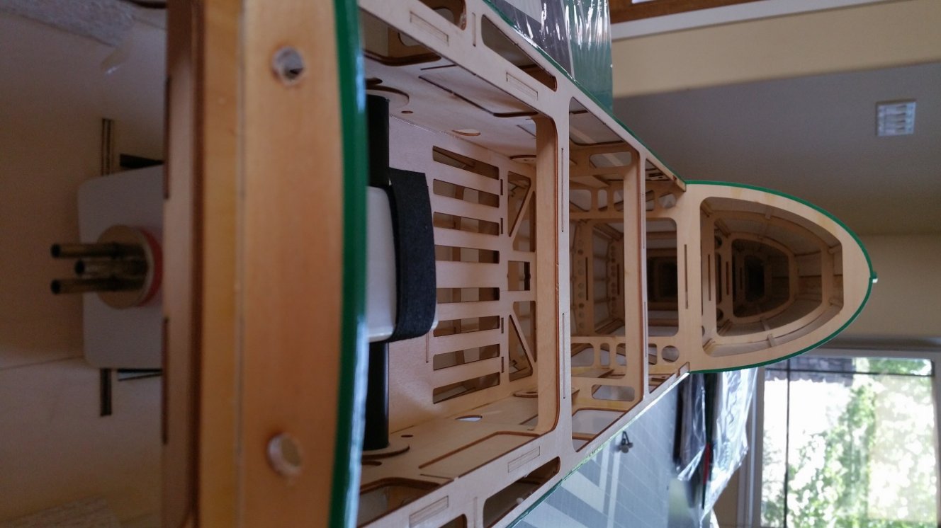

* Laid a very diluted epoxy in the motor box and around the tank just to keep fuel spillage out. Also put it on the exposed wood under the gear and over the covering edges to keep it from coming up (a Chris Jewett tip)

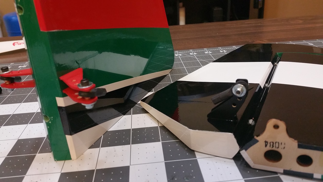

* Painted and installed all the control horns. I couldn't find the same green in my pile of paint but the red contrasts great.

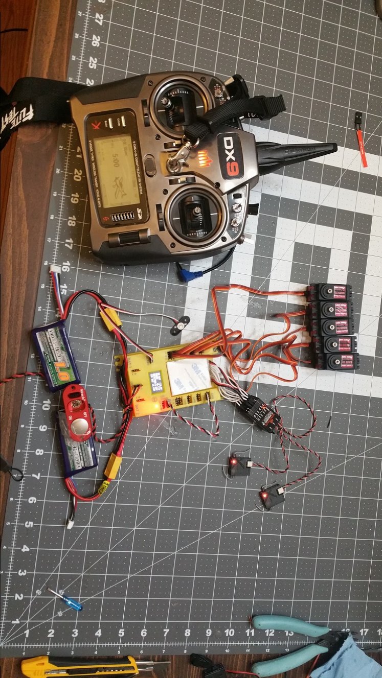

Tested out the electronics. I forgot this plane has 2 elevator servos so there is one more on the way. I chose PowerHD DS8309TG's all around -- they are right at the 9kg/cm recommendation from Aerobeez and are nice and light (and RedwingRC loves them for this size plane .. thanks for the comparison/testing vids guys!).
Also -- this power board is kind of great. Set the servos for 6v and loaded them all down and the voltage barely dipped on the dual 3S Lipo. I'll be running LiFe's in the final setup. Re-configured the Miracle switch+fuel dot to work the way the power box expects (shorted is off). The charge port on the switch is extra in this configuration but I may find find a use for it. I grabbed an AR9020 for under $90 by stacking coupons on top of sales on HorizonHobby ... aught to do the trick.

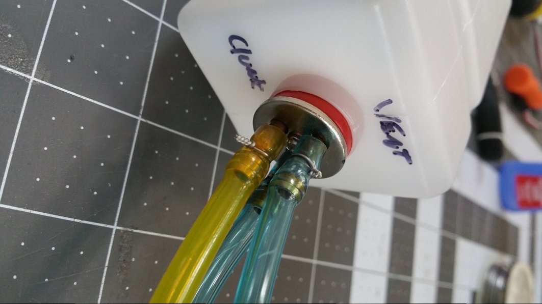

Been busy busy busy =( I accomplished a few things today finally!

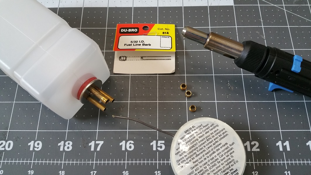

First off I built the fuel tank. The airframe came with the tank and 3-port stopper with the vent, clunk, and fill already done up. I took it apart and gave it a peek and it was well built. Only complaint is no barbs on the outputs ... so I took care of that

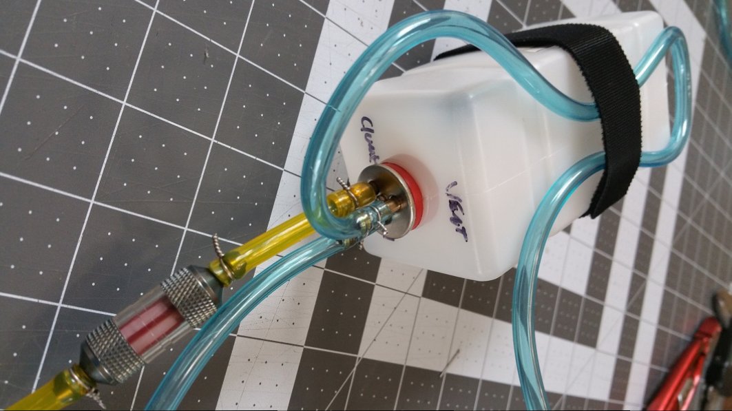

Then put on the fuel lines and secured them with wire. I used blue just to differentiate a little bit ... I get fuel without ethanol so the poly line should be fine (and I have a ton of it sitting around from motorcycle maintenance). Also wrote which is which so my feeble brain doesn't get confuzzled if I have to rebuild this later.
Add a filter and I think we're done until I get the engine.
