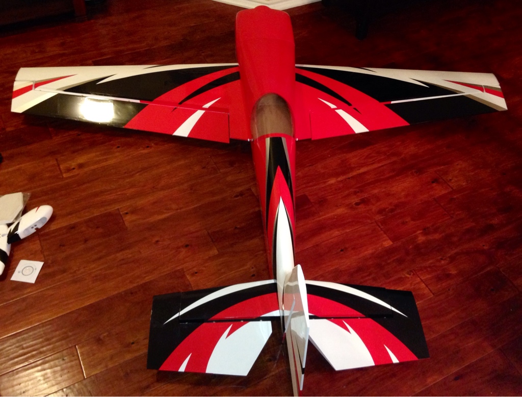

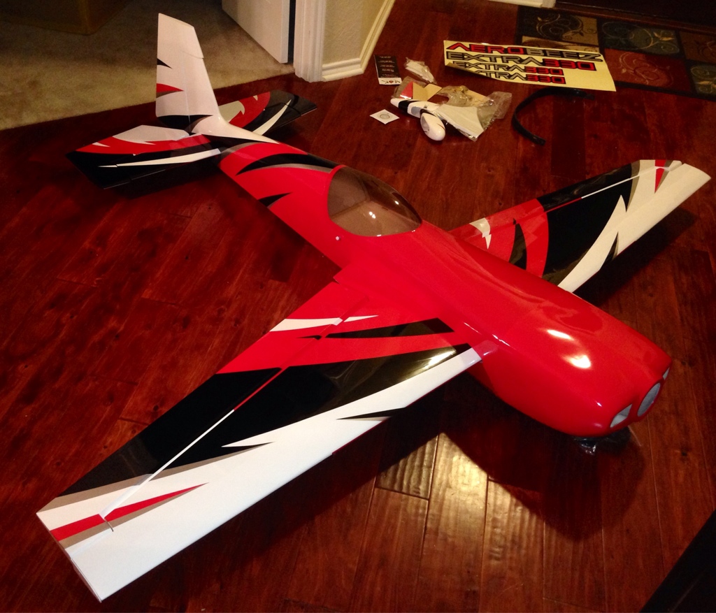

I agree gentlemen, she does look beautiful, and FAST!
I'm gathering the necessary stuff together to start the build today.

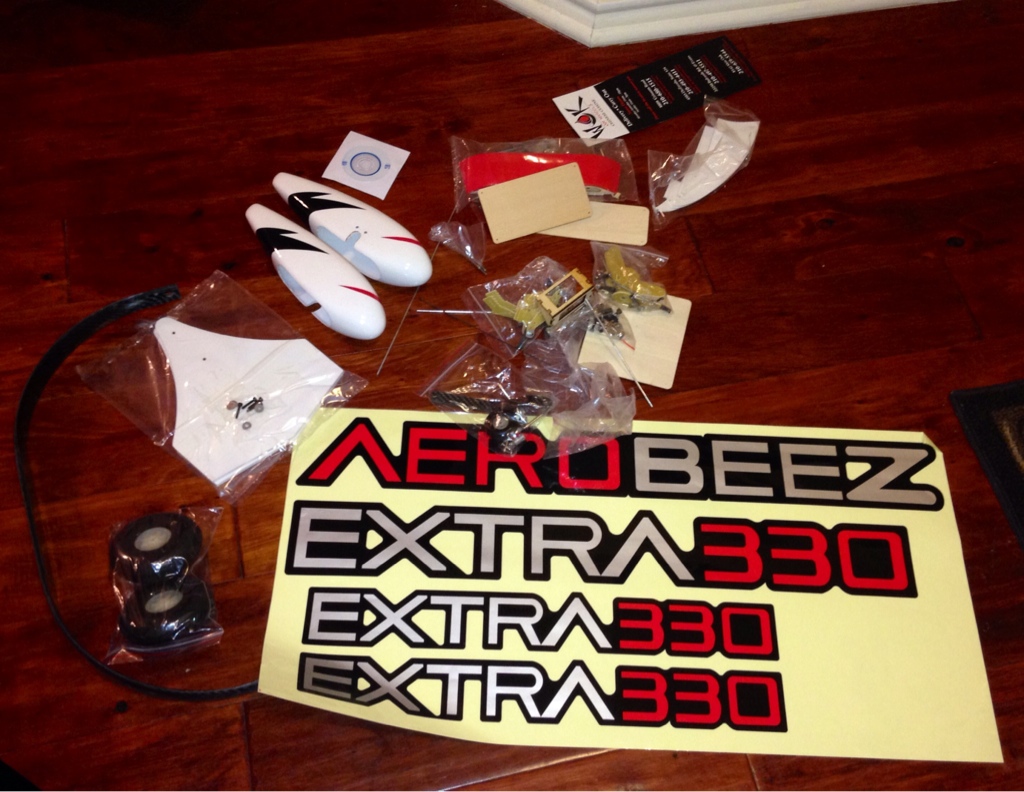

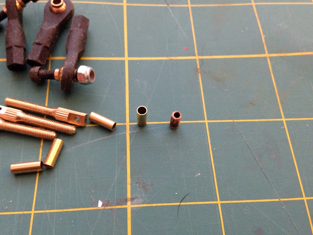

The hardware package as mentioned previously contains everything you need, and I noticed another small detail but nice improvement... The brass crimps. You can see on the right one of the crimps from my pervious 3 Aerobeez planes, and the new longer, thin walled brass on the left, which is MUCH better.
It's little things like that which make builds easier and cleaner...

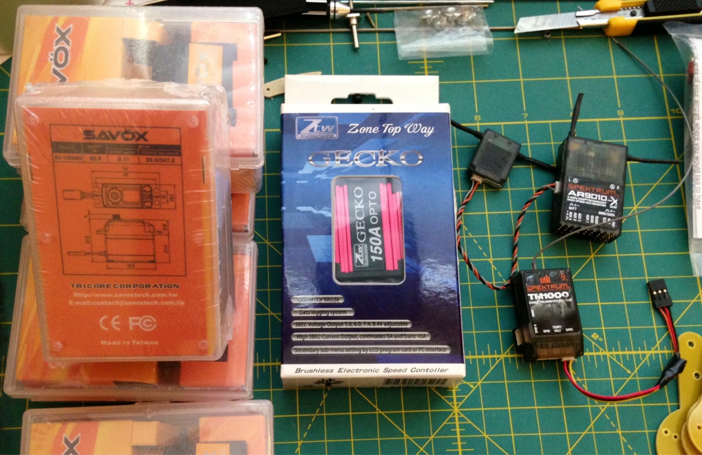

For electronics, we're going with a Spektrum 9 channel and telemetry setup for main battery voltage and electric motor temps in real time.
Motor Power will be channeled through a ZTW 150A Gecko HV ESC.
Servos will be Savox SC-1268SG, for 347 oz/in and blistering .11 transit time on 7.4v!

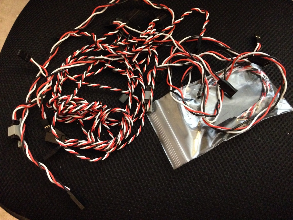

We're going with some Miracle extensions from AeroBeez on all our servos.

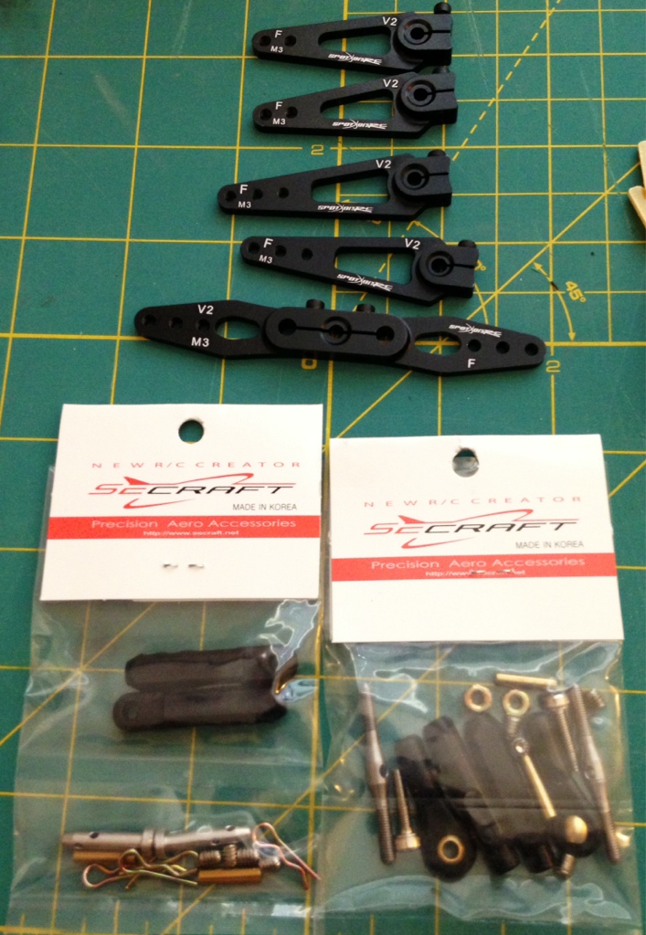

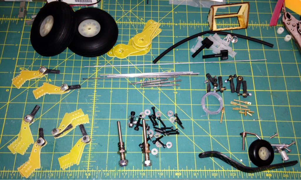

Connecting these servos to the flight controls will be hardware from Aztechaeromodels, the Spot-On v2 aluminum arms and Secraft pull-pull tensioner and coupler

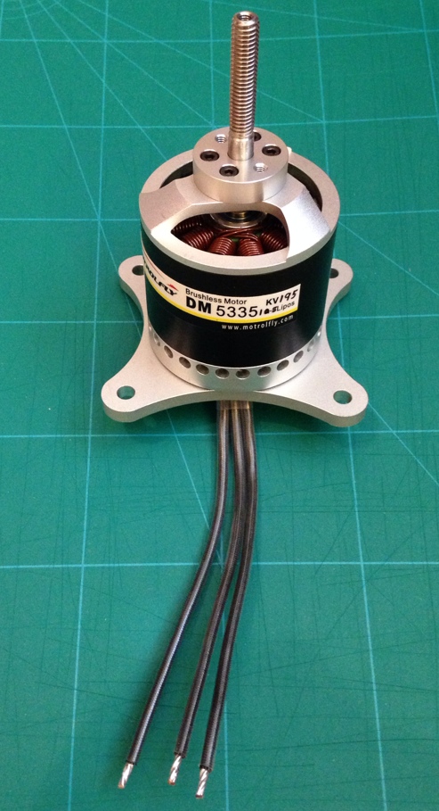

She's getting a brand new Motrolfly DM-5330 from Subsonic planes... 5000+ watts of instant power!

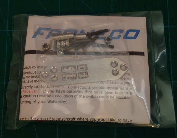

Also going to use the bulletproof Fromeco Wolverine switch for the receiver packs.
