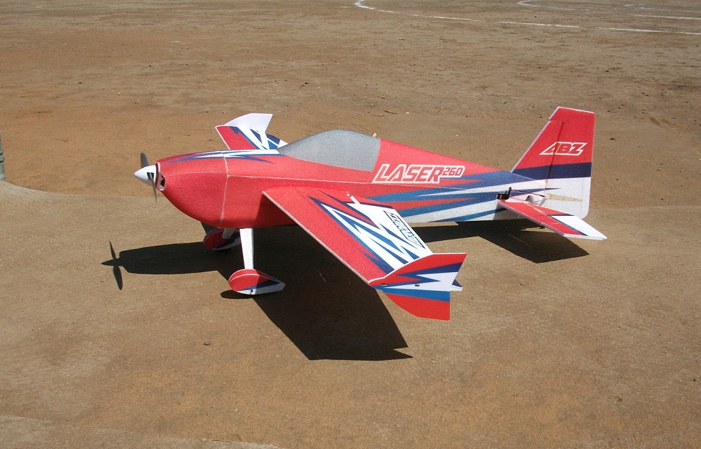

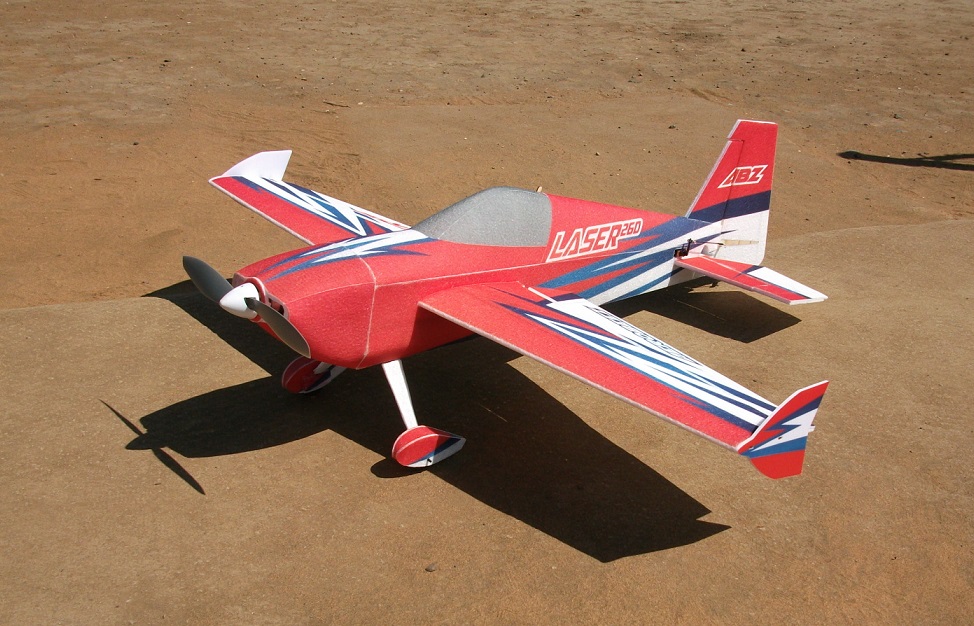

Brand new model from Aerobeez, a great looking, great flying little Laser. http://aerobeez.com/38-Laser-260-EPP...ne-Orange.html I'm flying mine on an Omega 73 gram motor with an APC 11x4.7 SF, 40A Hobbywing plantinum ESC and a set of Emax 8g ESO8 sub micro servos. I'm using a mix of 3S 1300's, 1600's and 1800's, the plane can handle all with ease. When the winds are dead calm I love to fly the 1300's as the plane becomes an absolute floater. It's very easy to build, goes together in 2-3 hours, can easily be built in a single evening depending on your choice of adhesives. The SFGs are made of Depron and rather fragile but fortunately Aerobeez stocks a full set of spare parts, or just get some depron sheets and make your own spares, or better yet, just land level and don't break them
