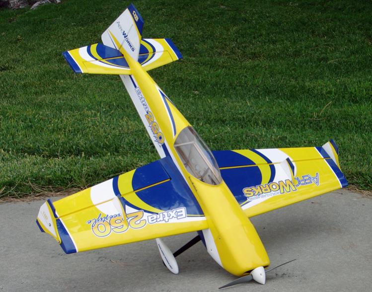

I have a 52" one of these being delivered today. I plan to fly this with an Extreme Flight Power System in it- Torque 2812 / Airboss 60A 6v ESC. Very excited about this plane- can't wait to put up some video of my own!
Anyone own one of these? I have a few questions, if so.

Box arrived today- it was in good shape from shipping- no visible damage upon quick inspection- detailed unpacking and build report to follow.

Thanks John. I was curious if you used HS-65MG's in the wings, or if you stepped up to HS-85MG's by chance? With either the Hacker option or the power system I am using (Torque 2812 / Airboss 60A), this plane will move quickly- and accelerate like a dragster! I was curious if blowback in the ailerons was something you might have observed. I do much more slow speed maneuvering, but the Extra loves speed, I know, so I'll be flying this in a more mixed style of high and low speed.

Hey Luv3d
The set up I use is the hacker A30 -12 XL and the X-55SB hacker esc.
13x6.5 prop,
HS65 on aileron and HS85 on elevator and rudder.
Spektrum AR600 RX
Thunder power 2700 MA G6 Pro Performance 45C pack. The only issue I have with the 45 C pack is the discharge rate is equal but dies without any warning. A 25C or 30C pack would probably work better unless you use a timer. Most guys like to fly the plane with the inner side force generators on and the outers left off. I am your average 3D pilot but my son Johnathan is a Team Aeroworks sponsored pilot and pushes the limits of his planes really hard at times. I do not notice any blow back on the HS 65 while he is flying. You caught my attention when you mentioned a mix of flying, I think a mix of precision and 3D always portrays a better looking flight. I will post a video of the extra in action, nothing extreme in this video but does display some precision characteristics. It is a great and fun plane to fly, the knife edges are a breeze.

Very nice video! Great high speed aileron rolls to KE, and nice inverted harrier as well! It looks like a blast- can't wait to get this airborne.
I've seen Jonathan fly the big one at the Austin Huckfest, it was awesome to watch in person! This is truly a nice airplane if it flies anything like the 30cc version.

I have one of these and really like it. I'm running the recommended Hacker A30-12xl just for the sake of easy setup since the mount was pre-drilled for it. I running Airtronics 94809's on the wing and Hitec HS-5085MGs on the tail (as recommended). Combined with Airtronics FH3 RX's, the speed of these servos is amazing! I'm definitely glad I went digital all around...it is worth it on this plane. I'm running a Nanotech 2650 4s for power -- the performance is great.

Very cool! I had the Extreme Flight Power system for another project- and thought it was similar to the Hacker, so I'd try it. This will spin a 14x7 on 4S without breaking a sweat! I just got the wings built- moving on to the fuselage now....
