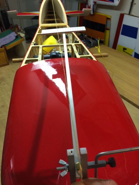

Anyone Remeber/Have this tool -->
bob_nj
It's from 1996
Brainerd Products out of Saint Louis.
One of the best tools I ever bought.
$21.95 at the time.

I was looking at my engine today wondering about how I could accurately check thrust
bob_nj
Yes, it's to check right thrust, and it's the bomb!

could you post the design pics, close up pics etc, so that community could DIY, if they want to (within IPR restrictions of course) That's one cool tool

It has a triangular fork of sorts that sits on the prop shaft.
It then attaches to the plane by securing that fork over the prop shaft with the
prop washer and nut.

bob_nj
I've attached the instructions and illustration.
If any part of it isn't clear, maybe I can clarify.

WMcNabb
Looks simple and extremely easy to use! KISS principle at its finest.
I assume most, if not all, GS aircraft firewalls are built at zero, and the desired thrust setting made in the engine mount.
