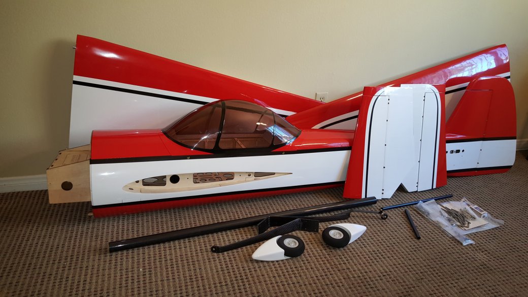

  1. This showed up at my place Monday, and I'm dying to fly it! It is pretty sexy, I must say. I mean it really looks good. Even better in person than in the photos on AW websites, and the photos looked great to me:

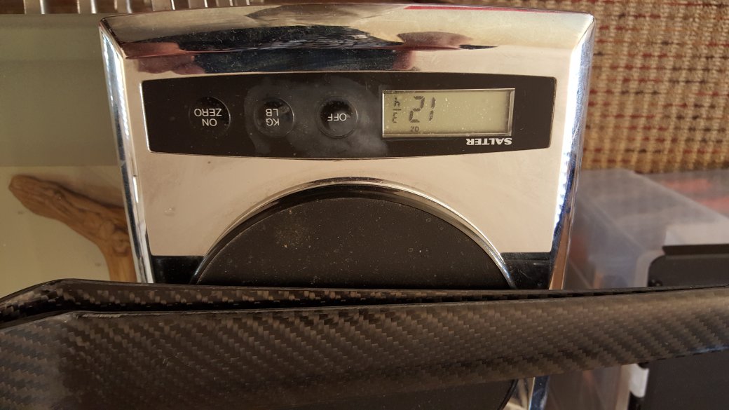

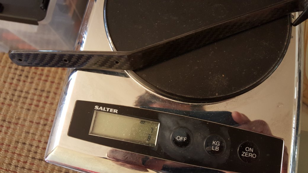

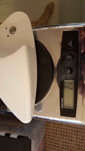

  4. I don't have fuse comparison weights, but might be able to work that out because my friend is just starting a Sukhoi. But, for now let's say the AW fuse weighs a pound more, because it does feel heavier (there appears to be more wood in there). That's 16oz, then 5oz more for the wings... that's 21oz. But here's where it gets interesting. I had a feeling that the Yak 55M main landing gear was going to be light. It is.
    It weighs 12-3/4 oz. Compare that to 31 ounces on the Sukhoi. The main gear alone makes up for 18 of those 21 ounces.

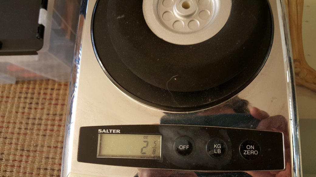

    Then there is the tailwheel, and Aeroworks has always had super light tailwheels. It weighs less than an ounce:
    SleepyC likes this.

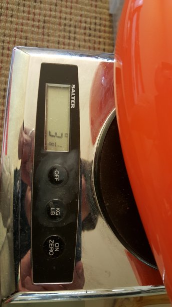

  5. The wheel pants are a 1/2 oz each lighter. The Tires are about 3 oz lighter each. That's another 7 oz. So, stock to stock, I could easily see the Yak 55m coming in exactly the same weight as the Suhkoi. Which I would be very happy about. I'll weigh them both RTF when the Yak 55m is assembled.

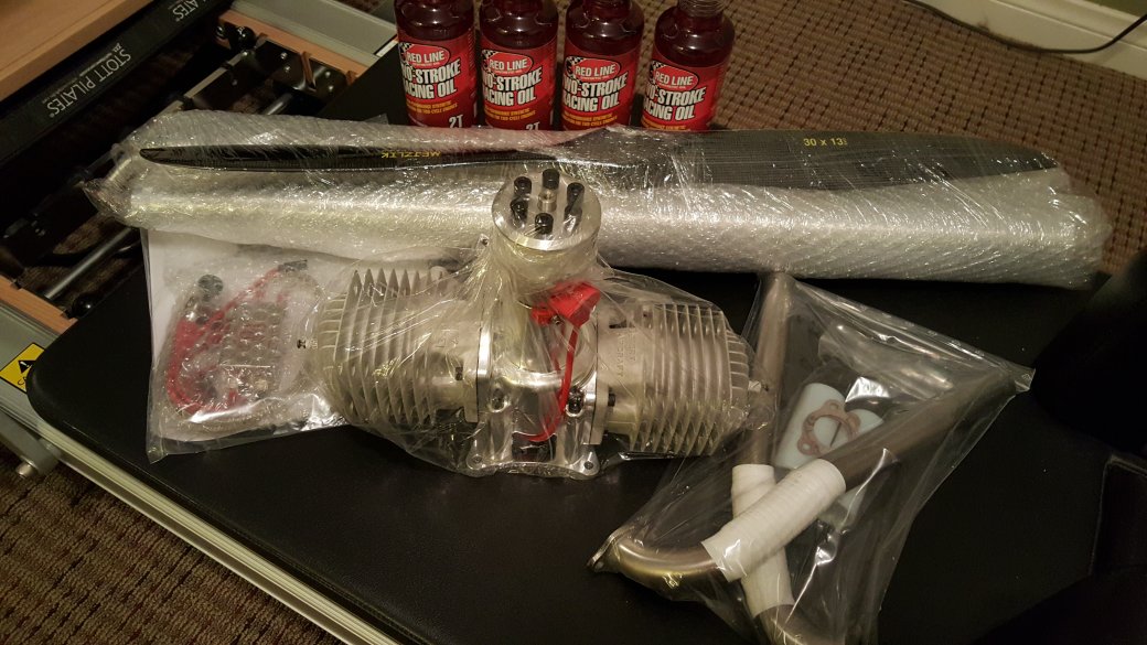

  6. I'm going with a DA-170 on RE3 tune pipes like I did with the Sukhoi because... well?... the engine makes tons of power but what I love is the sound of those pipes! So sophisticated! [​IMG] I do like the sound of the 3W 170 on Pefa cans, too. And, I hear a lot about ZDZ, DLE, and GP, but I have not tried those yet. Of course, DA is USA made, which is cool. I need to check and see how much of the engine is made here for general interest. I saw a video where they are making the cranks right there in the shop. I know they get the ignitions from Australia. But I can't believe, after all these years, I don't know if the rest of the motor is made in-house, or not. Either way, I'm very happy with my DA 170 on RE3s. It has been a runner from the first start and it just sounds so good!
