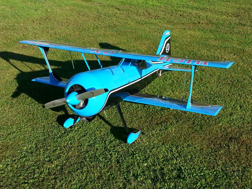

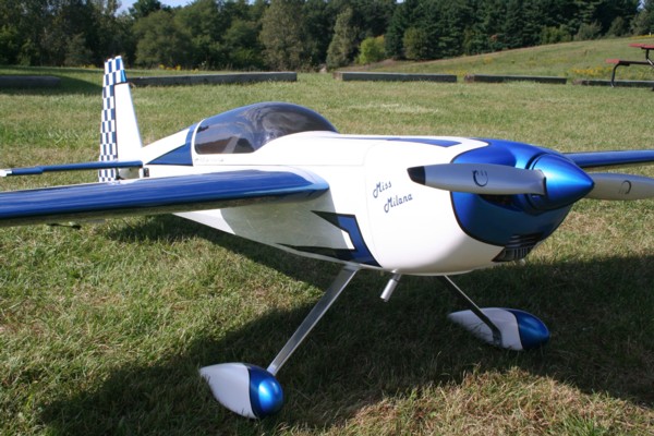

  1. Looking for anyone else using this paint system and any tricks or tips they would like to share. I find it to be an incredibly easy paint system to use and will accept more clear coats on the market. It's also extremely easy to mix colors as well. below is a pic of my Great Planes Pitts M12. I covered the plane with sky blue and black monokote. there wasn't a color that matched so I had to mix it myself and it came out closer than I had ever thought I would get. also is a pic of my Edge 540 where I used pearl Blue to match the metallic blue monokote, again another very close match straight out of the bottle.
