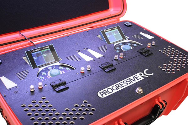

    Some of us are lucky enough to have power at the field but some are not or if you will be traveling you can't be dependent on other rc fields... So show us what you use whether it looks like this beautiful ProgressiveRC.com case to the below or not!

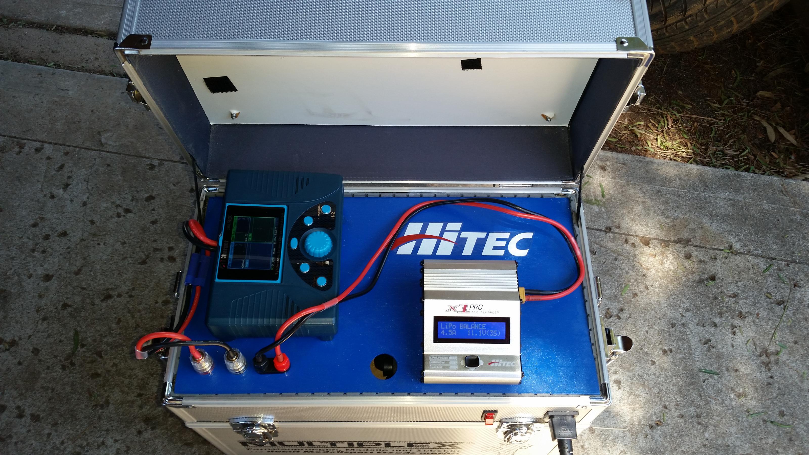

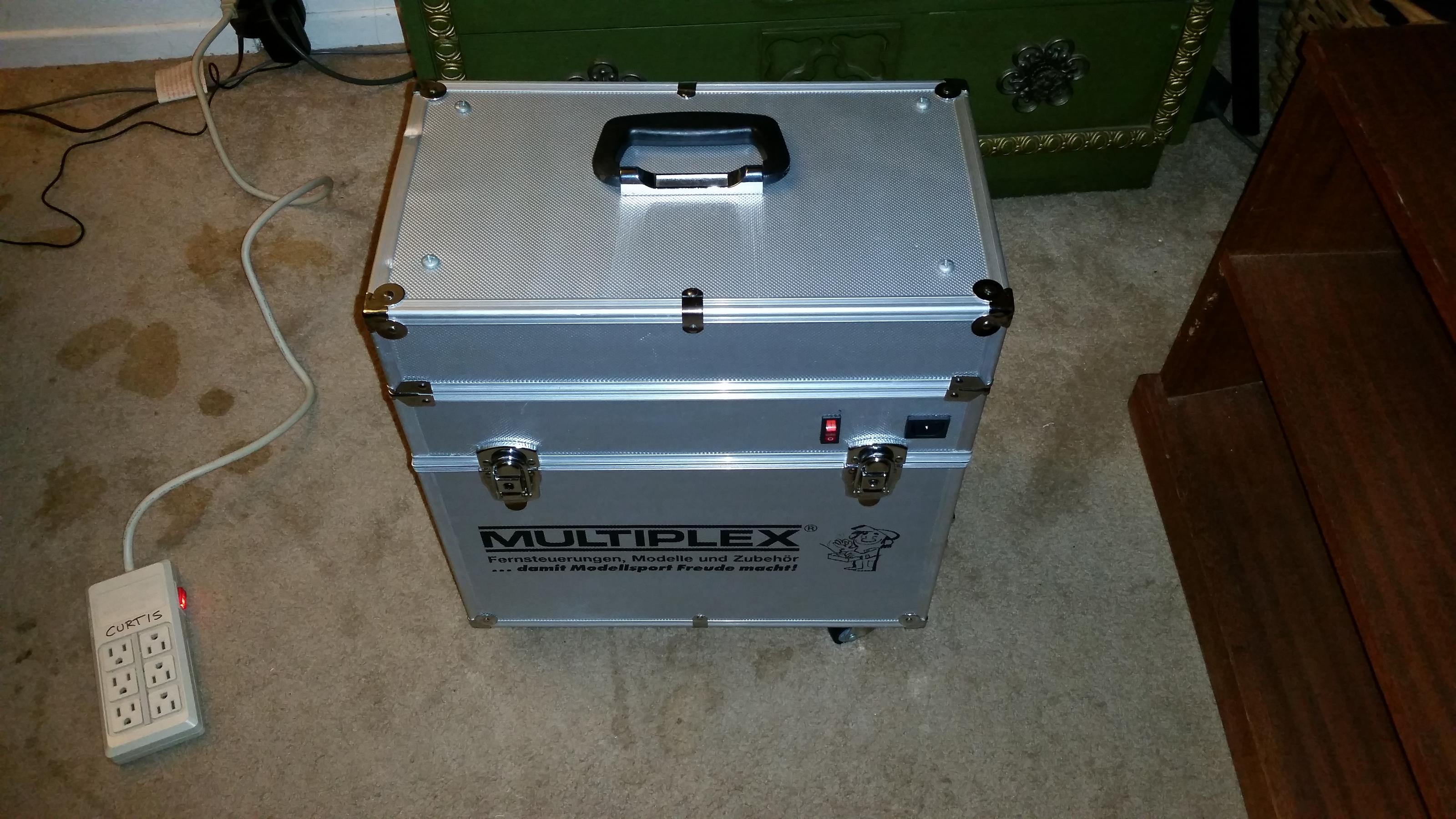

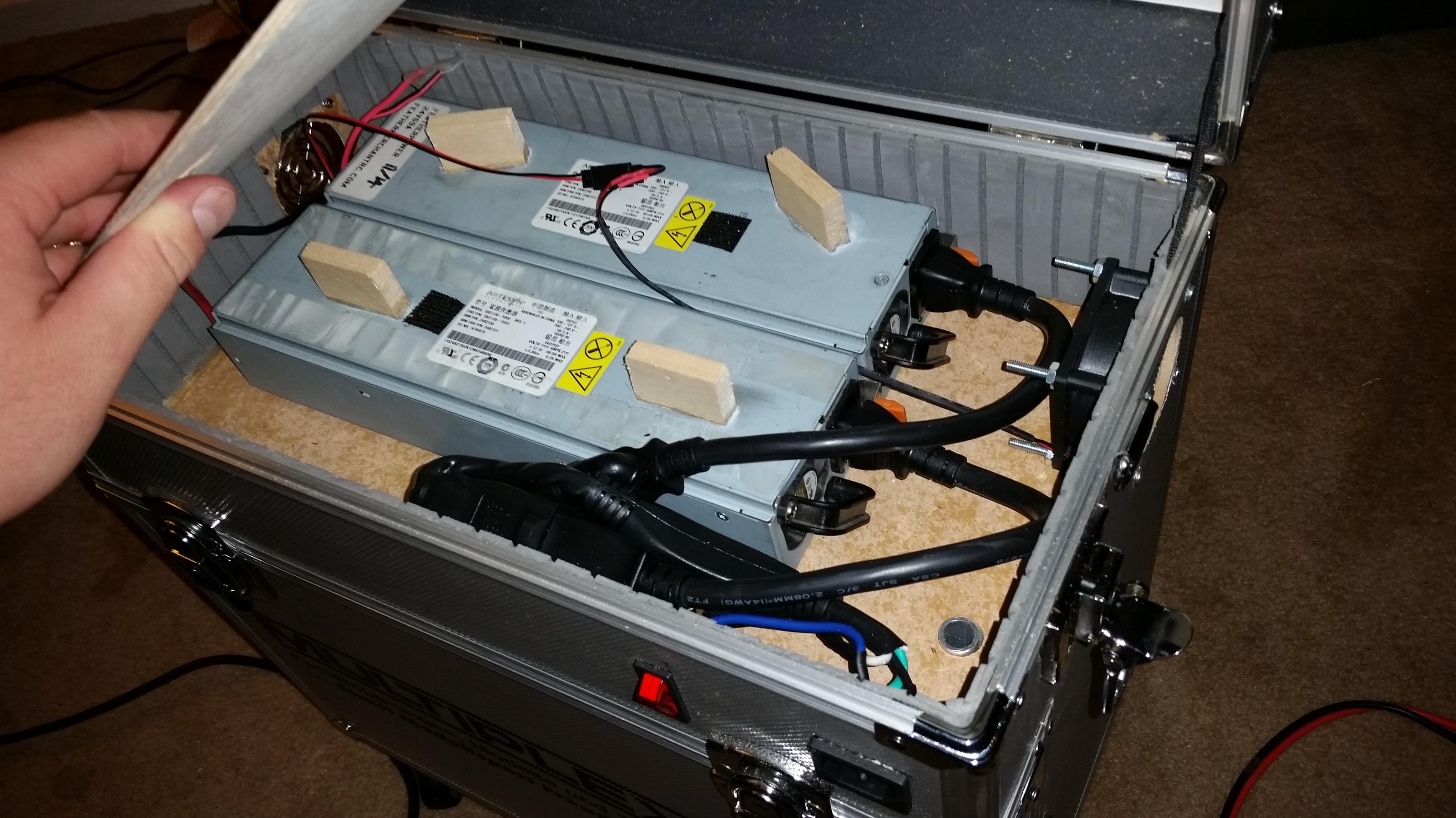

    This is one I put together last year. It has provisions for both 12v and 24v power outputs and is capable of 69 amps of current.
    Has 2, 12v 69a PC supplies inside of it that have a series connection to make 24 volts, plus a high velocity fan on the side to suck out the warm air. I would like to fit a 2nd high velocity fan but haven't had the time to do it lately. The box is an old Multiplex hardware box that I had lying around from years ago.
    Can charge 2, 6s 5000 packs at 10 amps each comfortably. All of this is powered by an older Honda EM650 generator that was retired from fire service that still fires up first pull and runs like an ox. 650 watts of generator power is plenty for my needs.

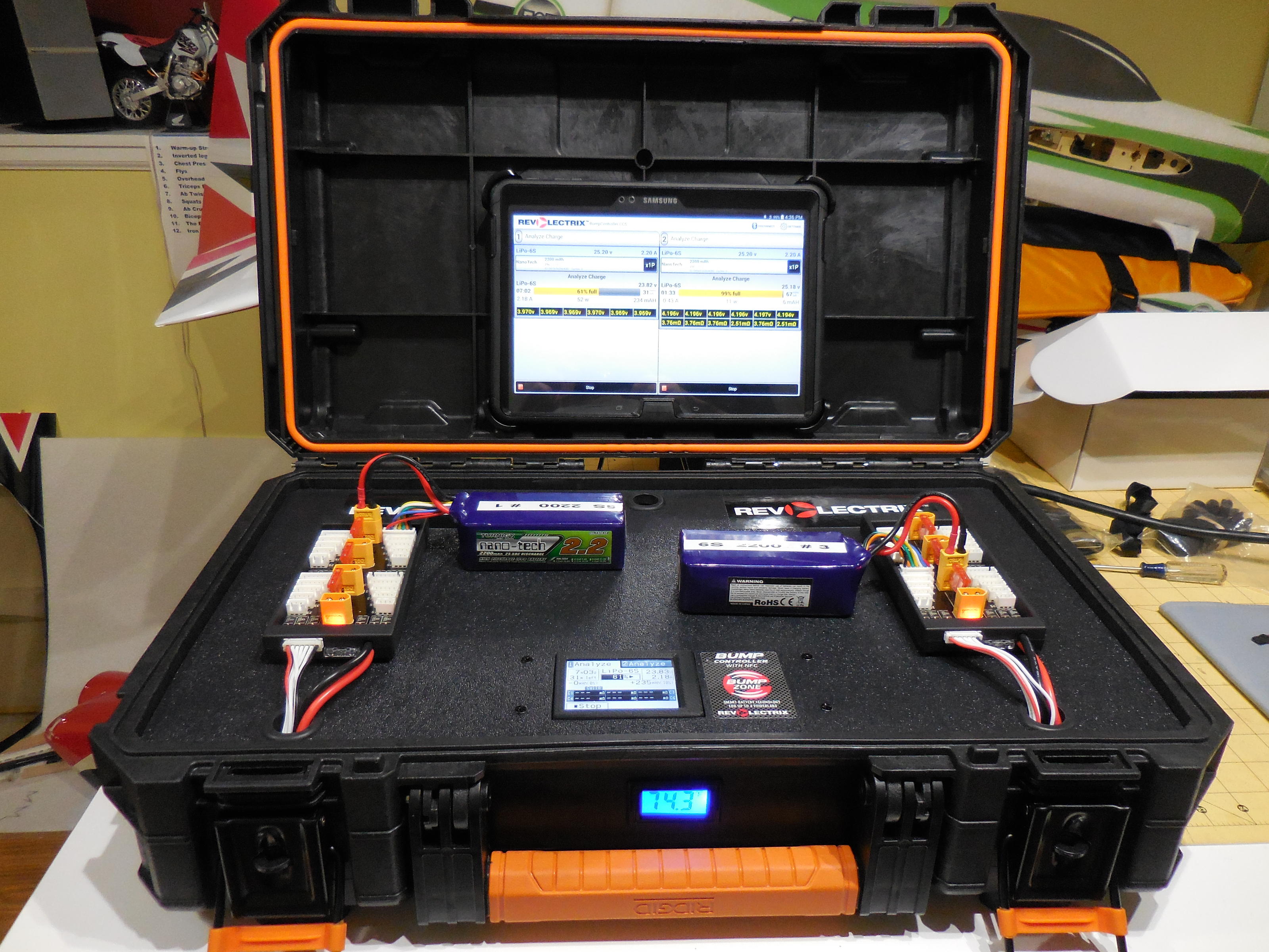

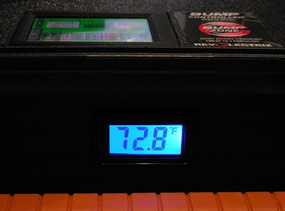

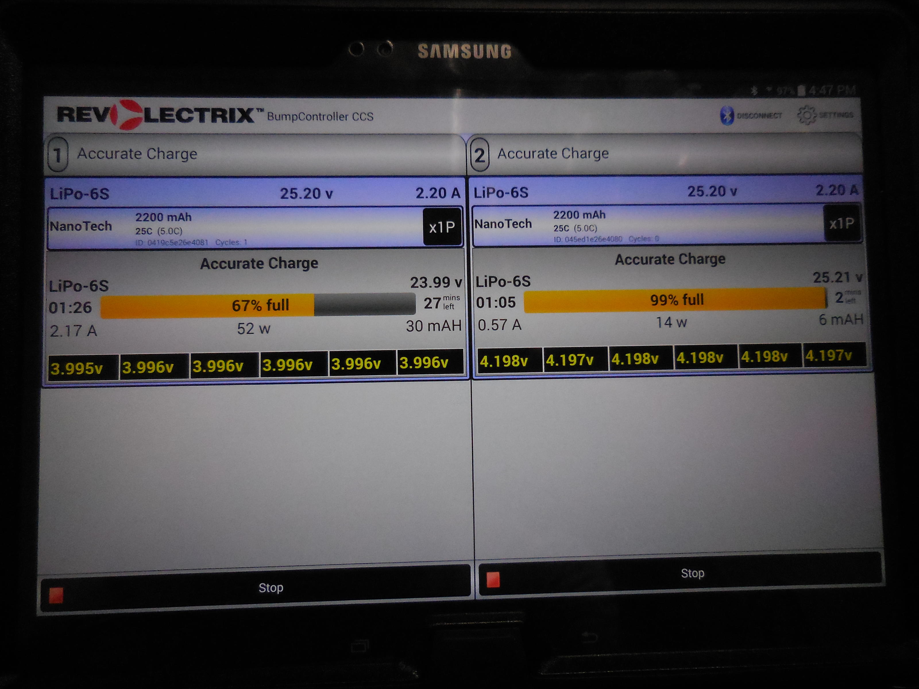

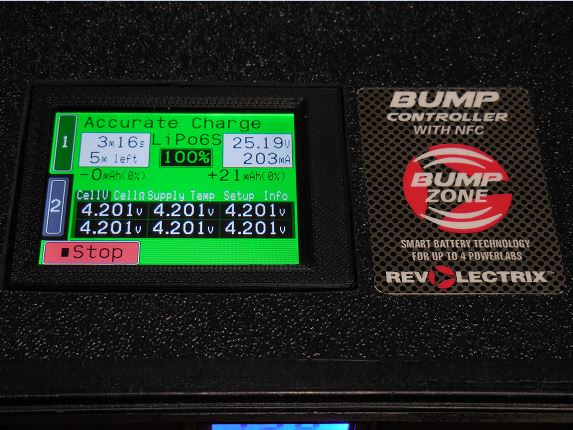

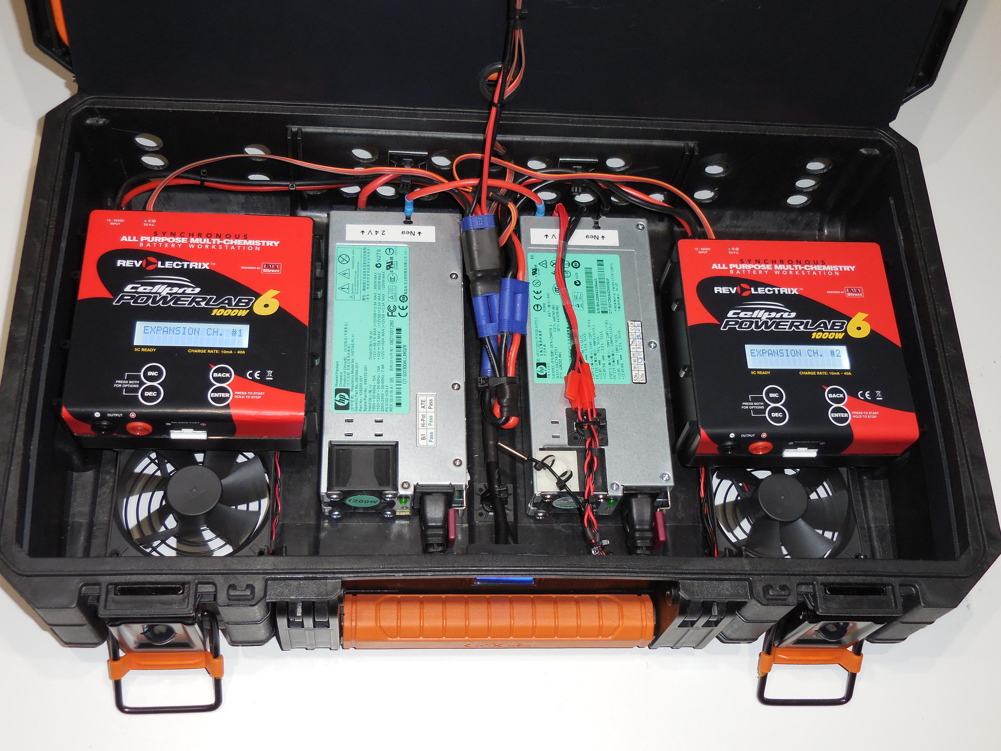

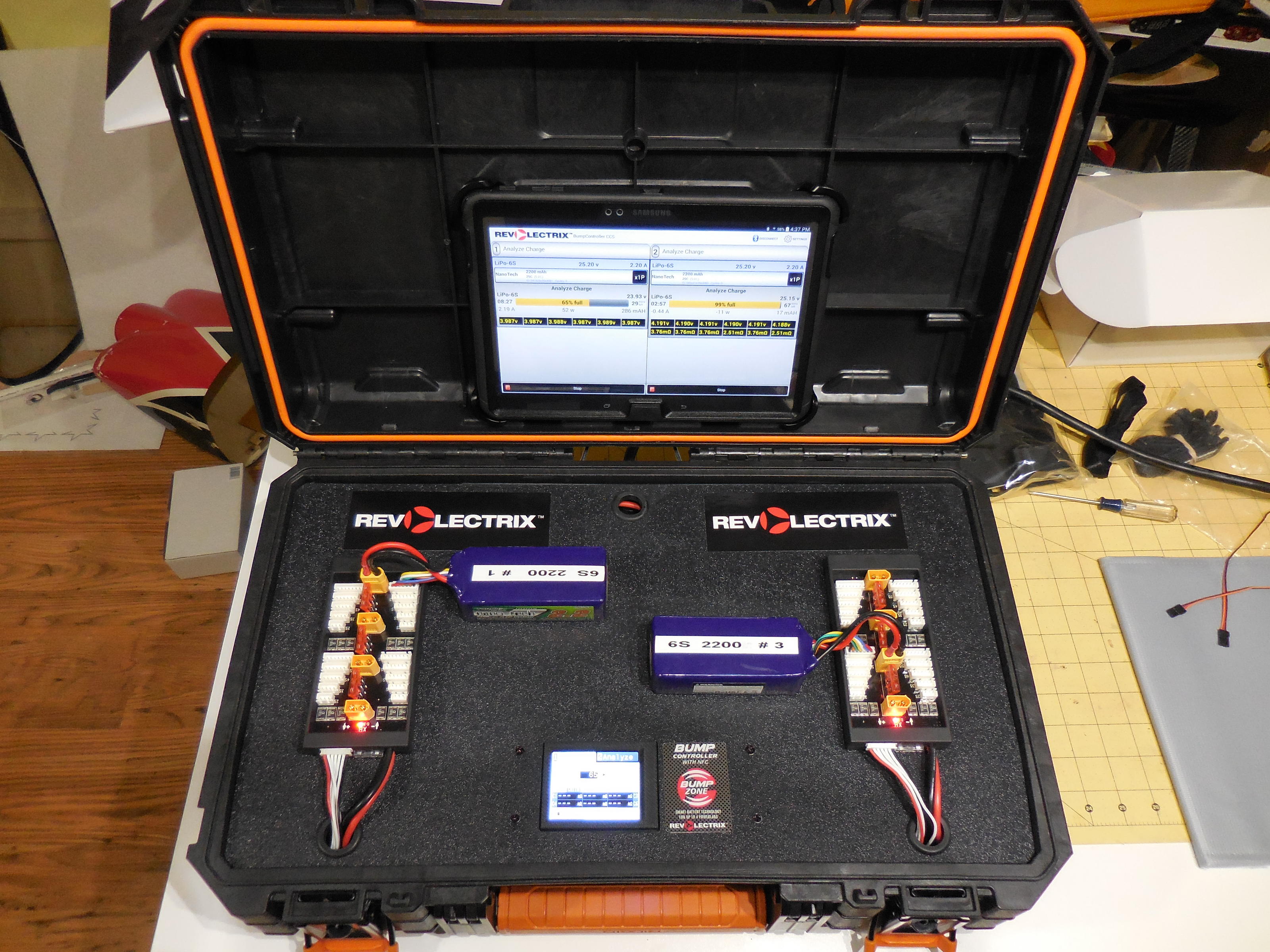

    Hey everyone,
    I'm one of the Beta testers of the new Revolectrix Bump Controller that was released in January 2016. I put up a build log of my new Dual PL6 w/ Bump Controller portable charge station on another forum but glad to share it here with my 3D brothers and sisters.

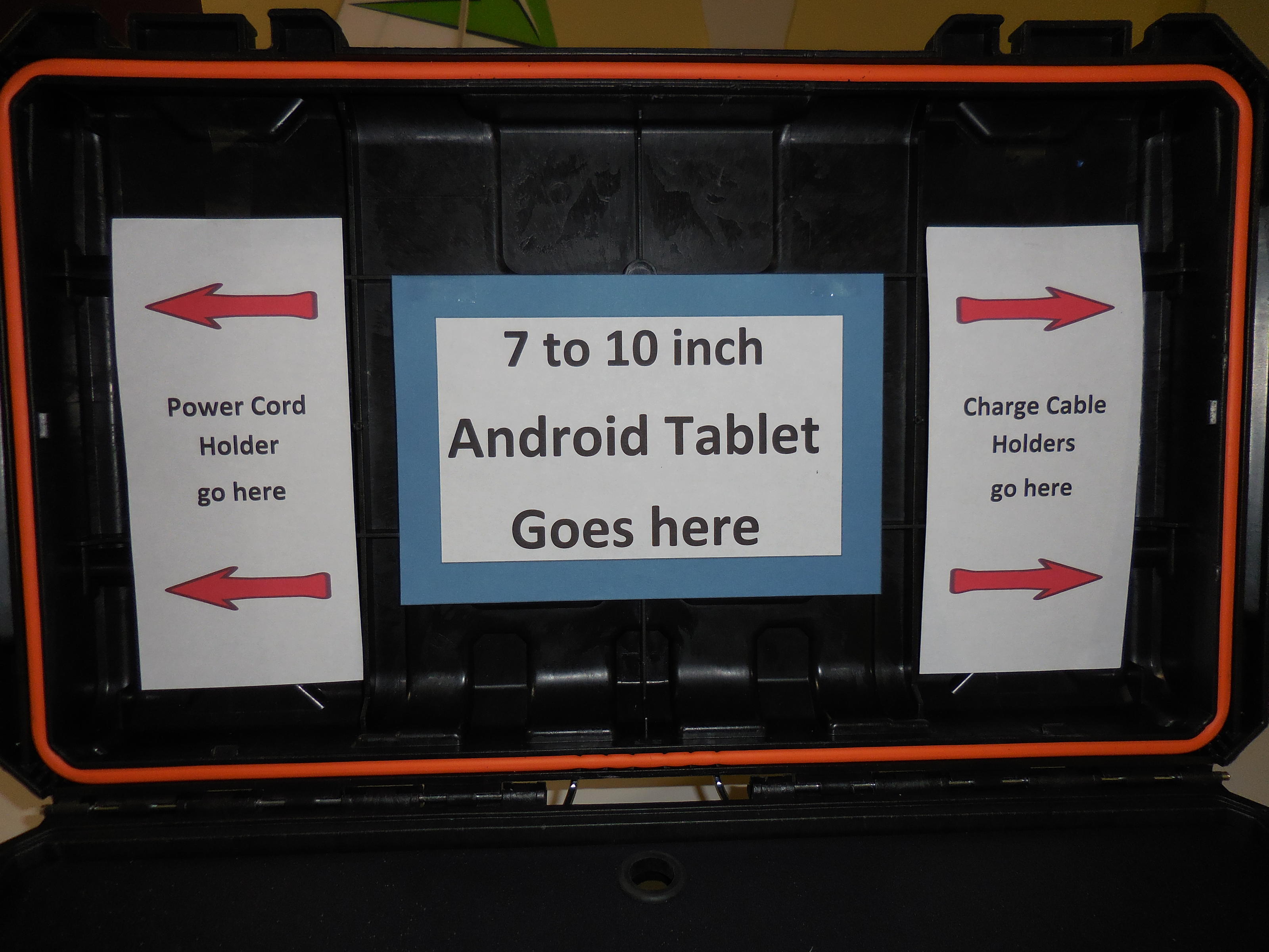

    At the time these were taken, I had not mounted my 10" Samsung Tab Pro or cable holders in the lid so I added some place holders to better show the setup in the last photo.
    Best,
    Chris
    ps - The new Android app was just released last week and it looks vaguely similar to the prototype app shown in the photos below. It's 10x better now.
    Revo Bump Controller Charge Station 1.jpg Revo Bump Controller Charge Station 2.jpg Revo Bump Controller Charge Station 3.JPG Revo Bump Controller Charge Station 4.JPG Revo Bump Controller Charge Station 5.jpg Revo Bump Controller Charge Station 6.jpg Revo Bump Controller Charge Station 7.jpg

    Is this available on the market?
  8. Snoopy1 likes this.
  9. Yes - check out bumpcharger.com and revolectrix.com
