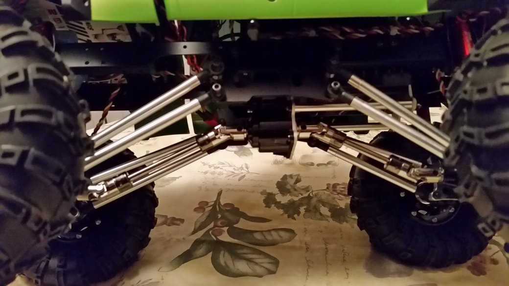

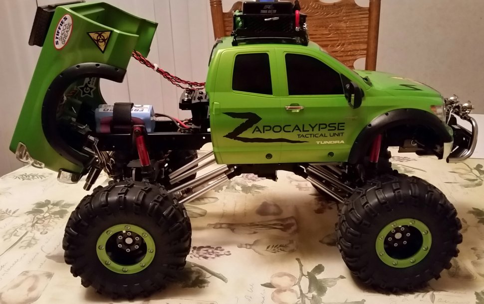

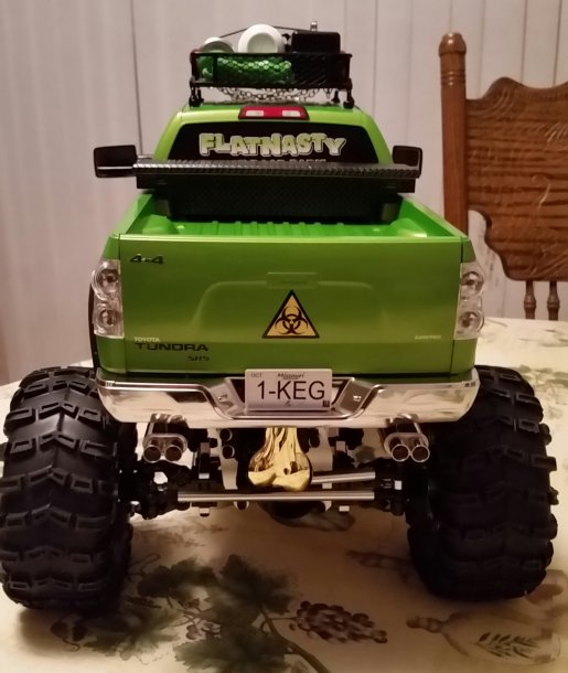

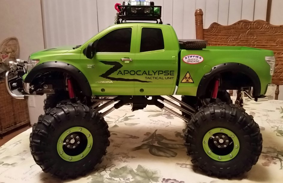

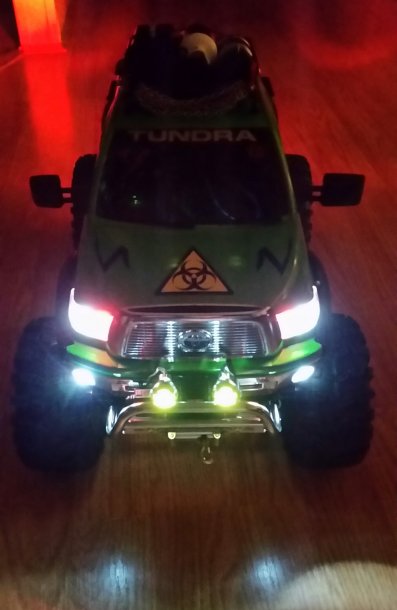

So one day I was searching the ol interwebs for an alternative light setup for my Tamiya Toyota Tundra high-lift that I built for G6 Recon (pictured). (keep on reading for the airplane related part)
Tamiya does make a light kit for my particular truck, but at $350-$400 :confused:I decided to look elsewhere. In my search, I ran across mytrickrc.com, I watched their promo video and was hooked right then! So I ordered up a basic off-road kit, got it in the mail, as I was installing it, I learned it would do a lot more than I originally thought:big-grin: So I called up Dan and My Trick RC and got a few more things, like blinkers.

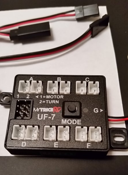

Oh and one cool thing I forgot to mention.....one light controller does the cars, trucks, planes, etc. All 11 modes

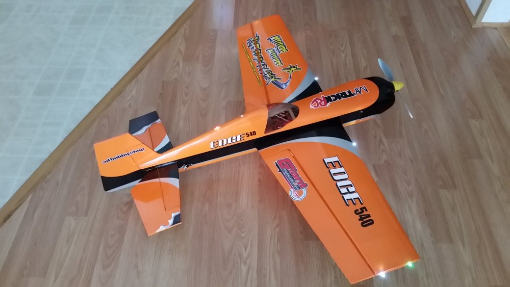

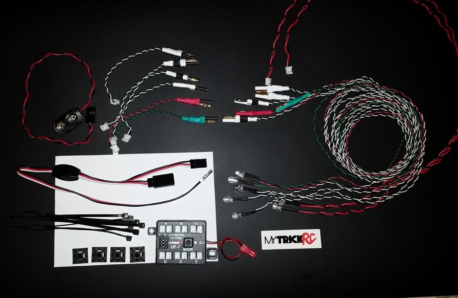

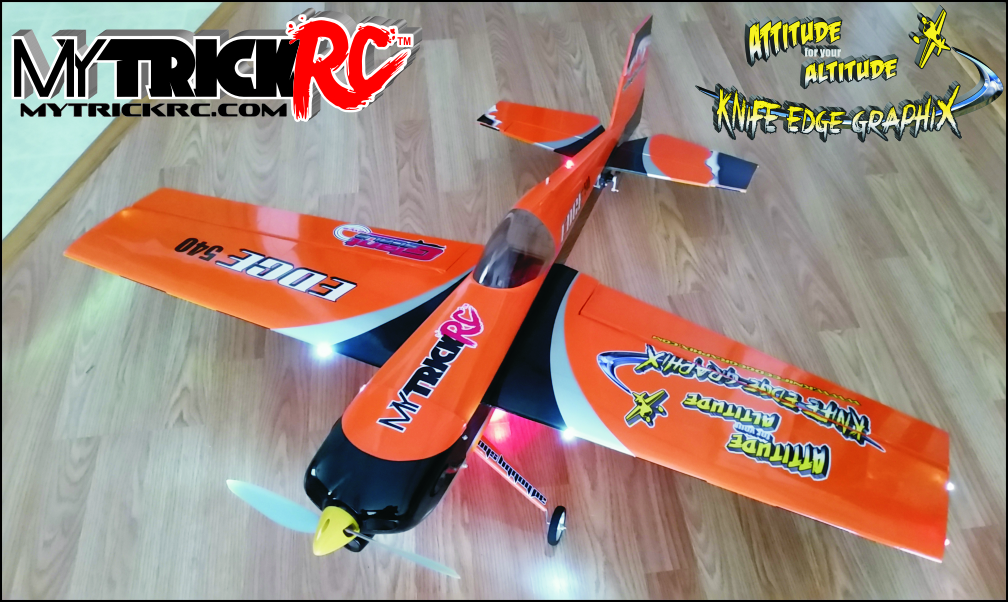

I decided to install it on my 41"ish 3DHS Edge 540, so I laid out the kit to see what I got...........
NICE!!....here's a close up of the controller
The controller can be powered via a 9 volt battery, lipo or if you use the receiver to control the landing light, power from the receiver is back fed to the controller, no extra batteries needed.

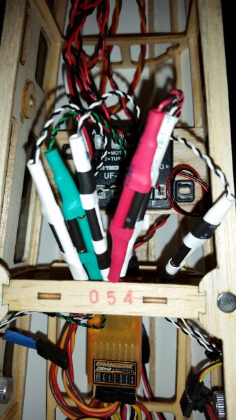

The Kit is already setup for detachable wings, so the install is easy and clean.

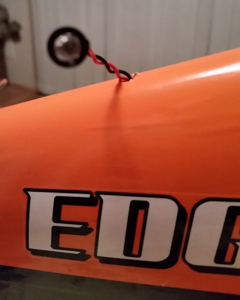

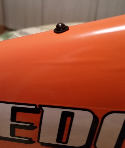

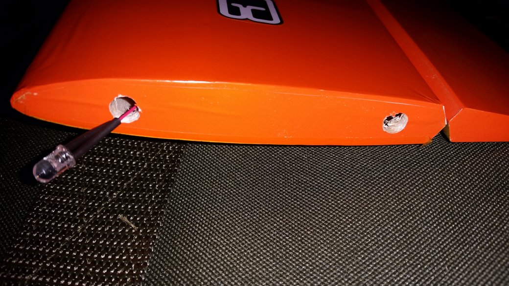

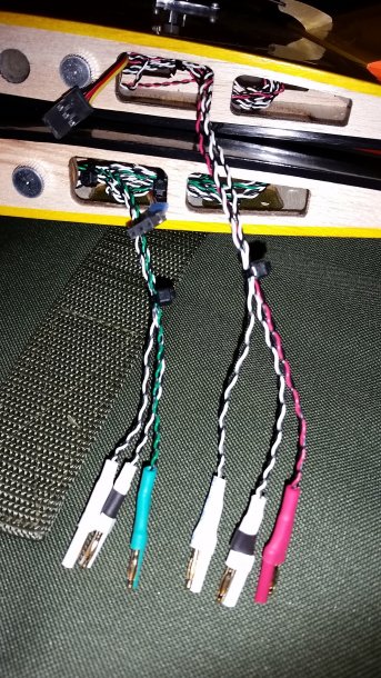

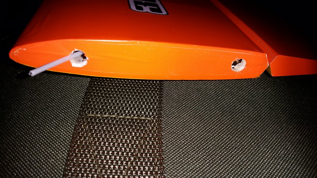

Here I drilled holes where I wanted the wing strobes and red/green nav lights

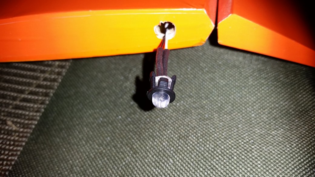

I used some push rod to snake the wiring thru the wing

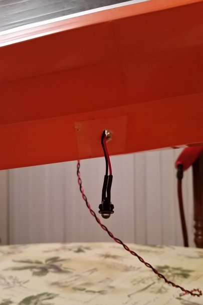

I also followed the same procedure to install the landing lights, I can turn them on or off via a switch on the radio.

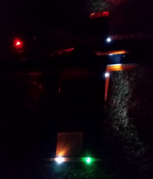

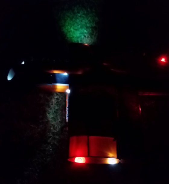

More pics of the lights in action......again in solid burn mode for picture purposes.
Phone takes awesome 16mp pics in the daylight, doesn't take very good night pics
