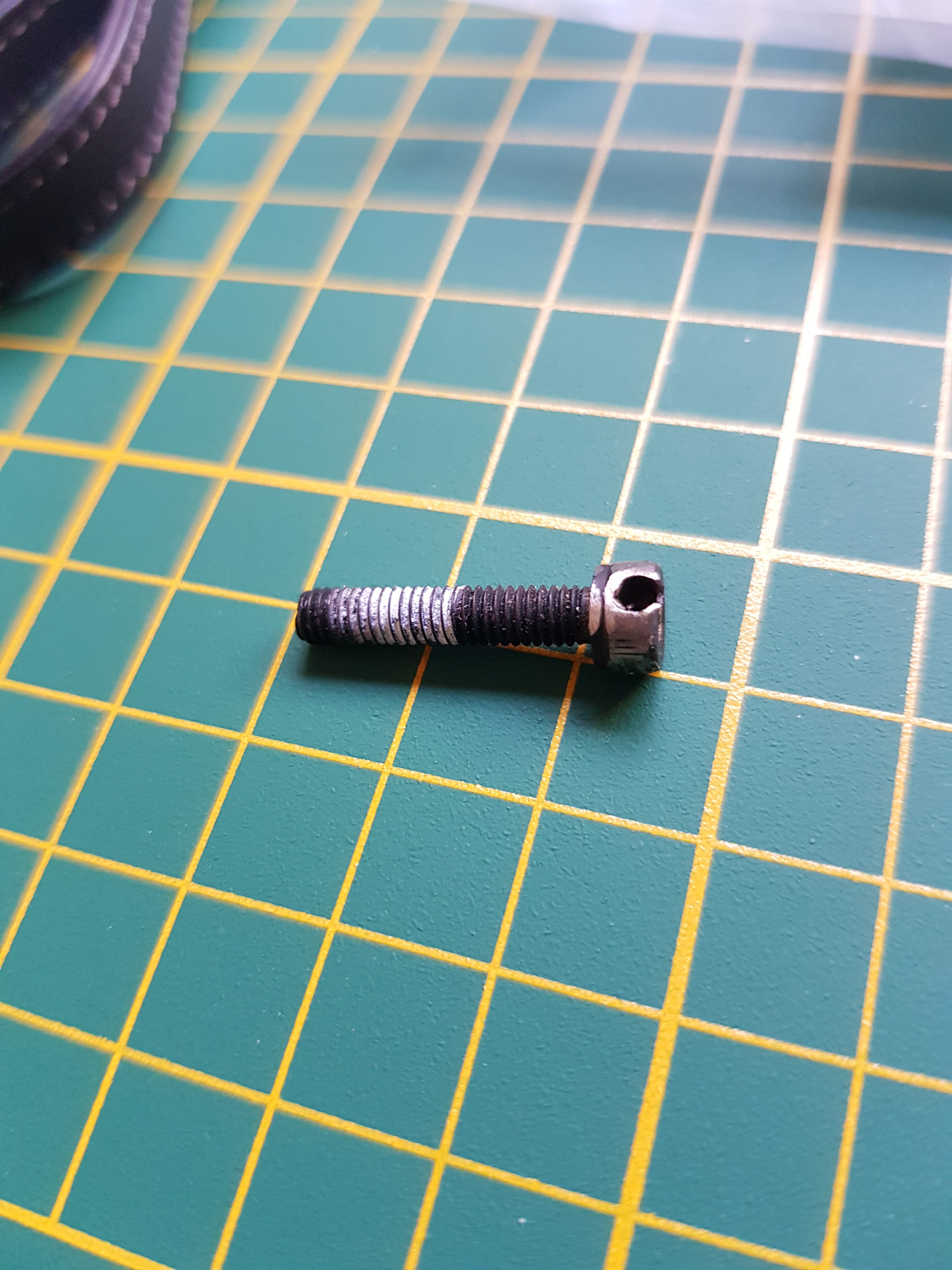

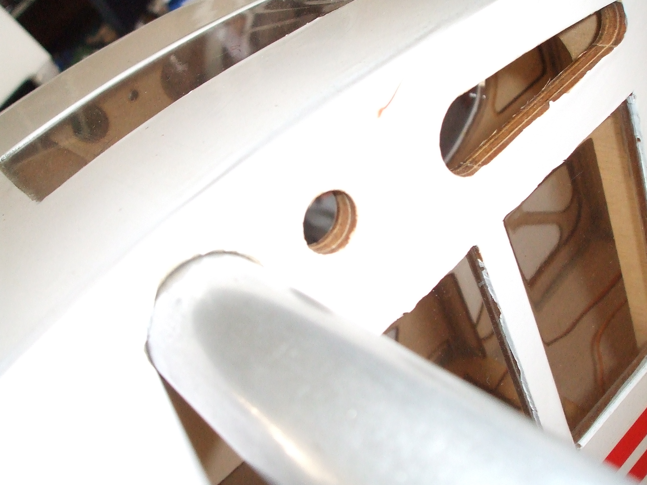

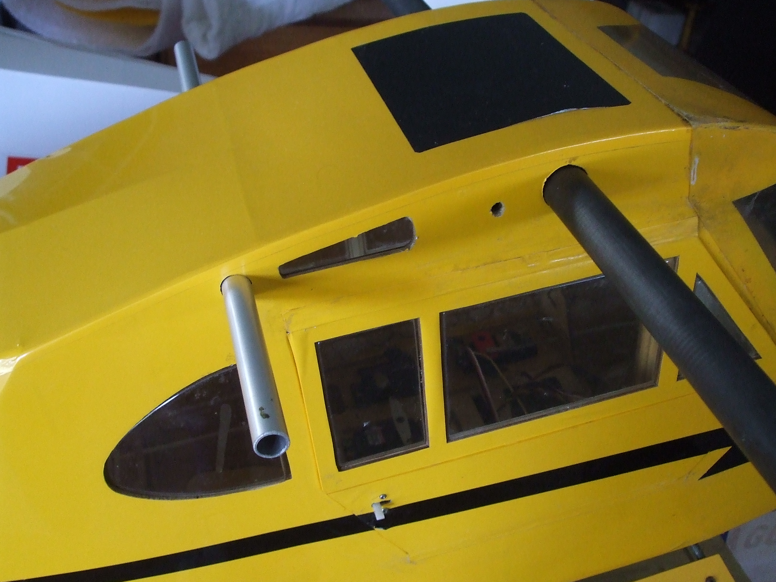

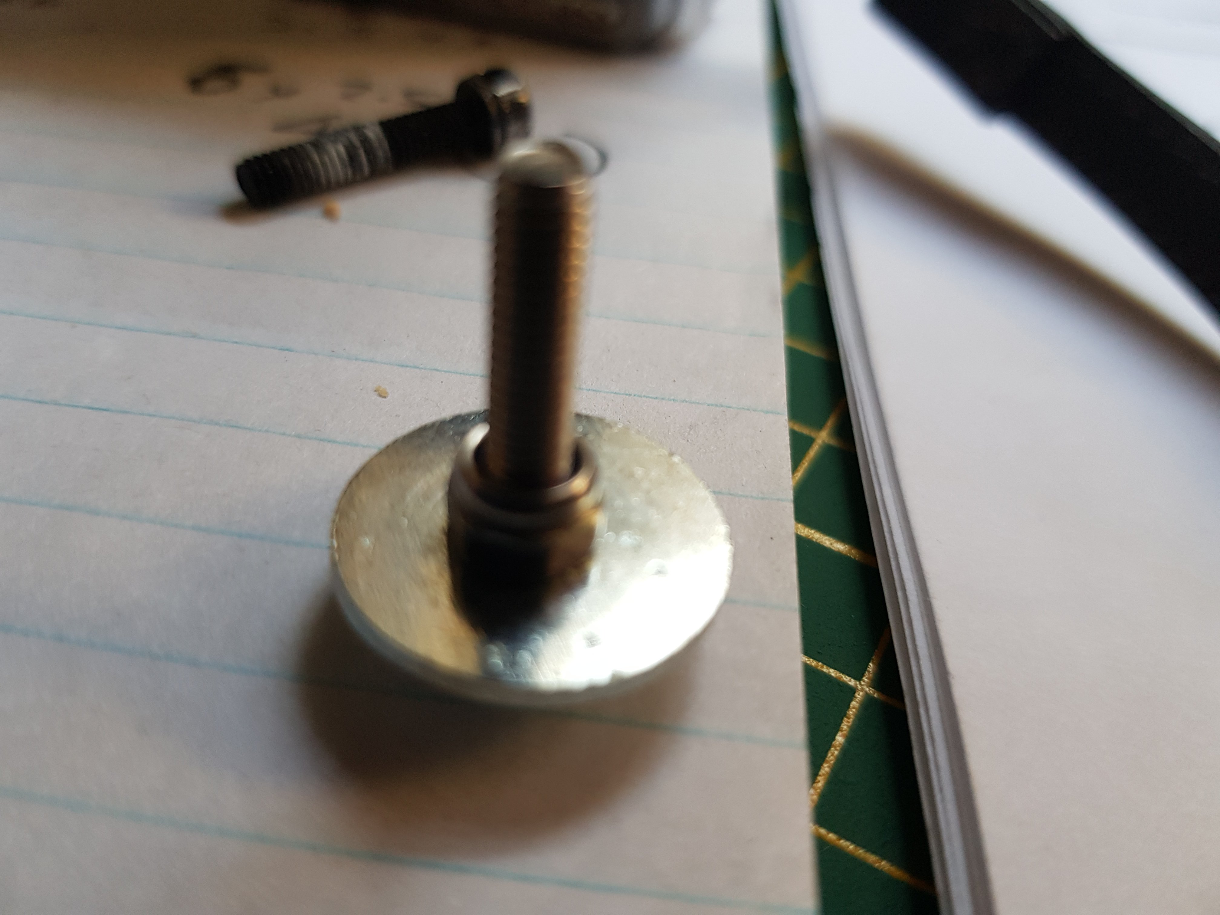

    Hi All..Actually, you guys have partially answered my question. One of my models has Nylon wing nuts holding the wing in place...on the larger one..unidentified ...there were 2 Allen key bolts that had wire joining them together and Loctite on the thread...see photos attached. As can be seen, the hole behind the main spar is fairly large..18mm or 7/16ths..and the bolts going into the wing are M4..but while sorting out my login problems I delivered a lateral thinking solution..see photos 2 and 3 ...all ok now nice and snug...my last question on my smaller CUB2.2m WS..the builder added a second Wing Brace...do you think that I should do that on my larger CU 2.9m WS...I am not going to do aerobatics... it's nearly all going to be a level flight plane. Sorry, but I am a bit nervous about the wings...they are like you guys are aware, quite large and I have suffered a couple of wing breakage in my smaller WSpan RC planes. Thanks for listening to me..I have just got back into the flying addiction in the past 2 years after a 50+ year break...so a lot of this is new.
