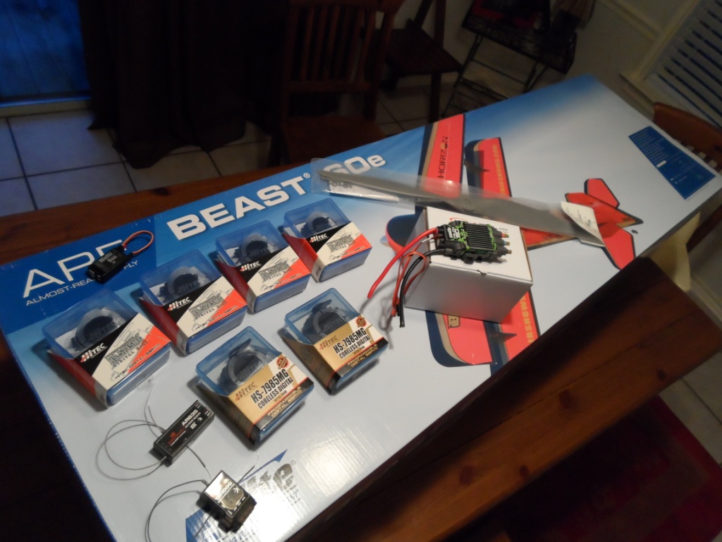

The setup:
Motrolfly 4320-450kv with 18x8 APC prop
Castle Creations Talon 90 ESC
Glacier 45c 5000mah batteries
Hitec HS-5245mg servos on ailerons
Hitec HS-7945mg servos on elevator/rudder
JR matchbox for the 4 ailerons
Spektrum AR635 AS3X Gyro Receiver
Spektrum TM1000 telemetry system for fight pack voltage and motor temp

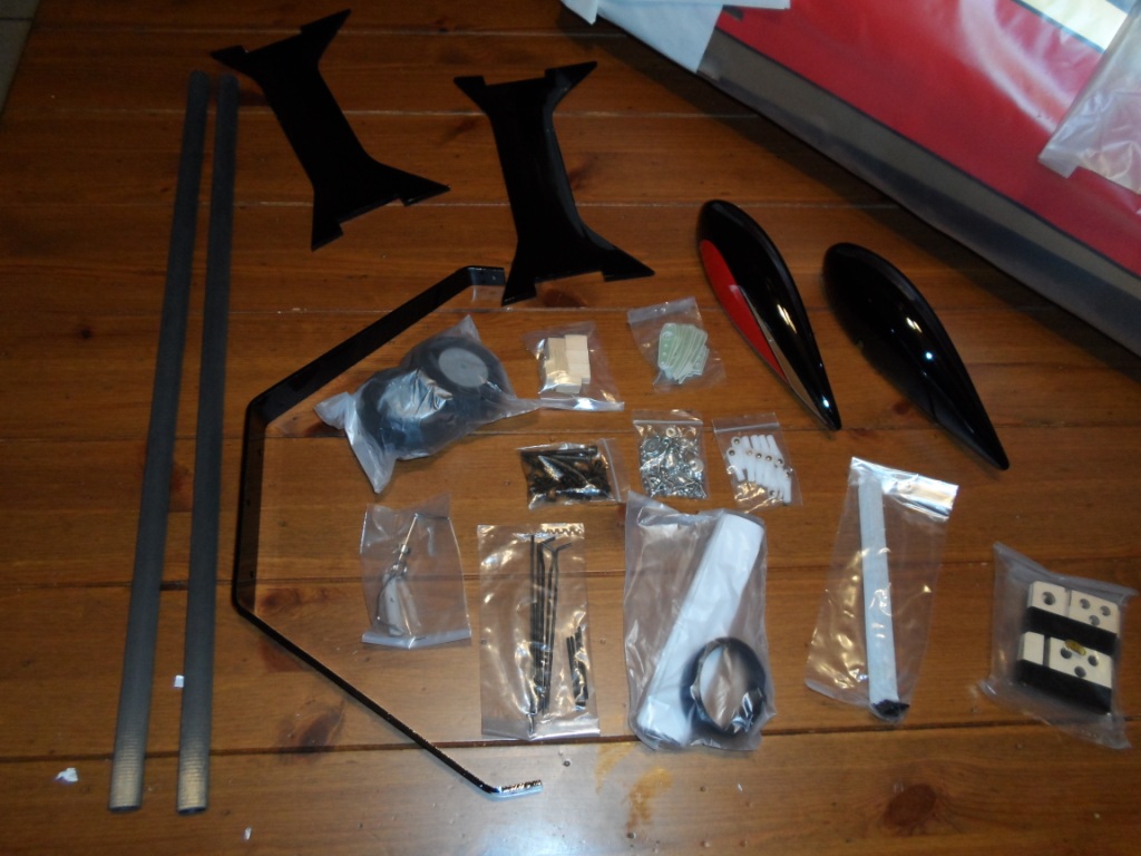

So, lets have a look at whats in the kit.

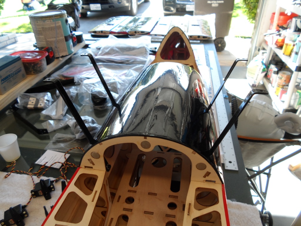

Fuse and all contents are nicely packed and protected
Little addendum included on a motor and ESC NOT to use.

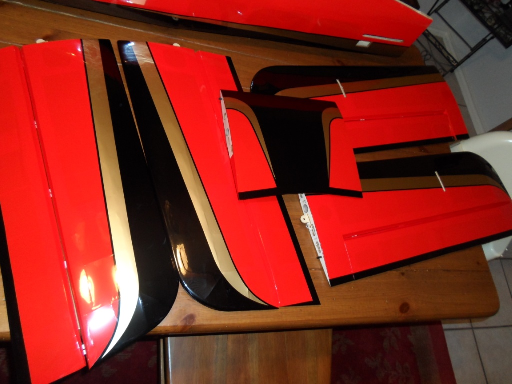

Nice CF wing tubes, but painted aluminum main gear. Feels pretty light and very strong. Also, the wheel pants in this kit are surprisingly strong and thick for this size kit. Should hold up well for those harrier landings. :D

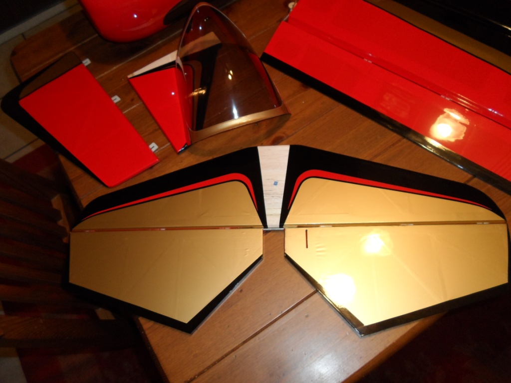

Nice graphics package and detailed instructions.

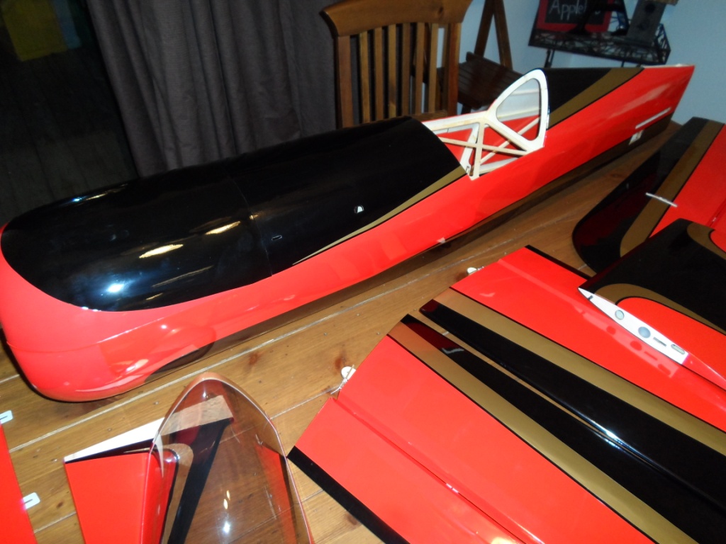

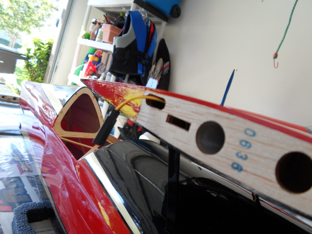

Covering and paint looks top notch, but canopy will need to be glued on or screwed on. Was hoping this was installed and done, but I'm sure its off for a pilot to be installed.

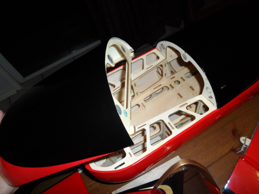

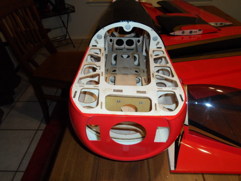

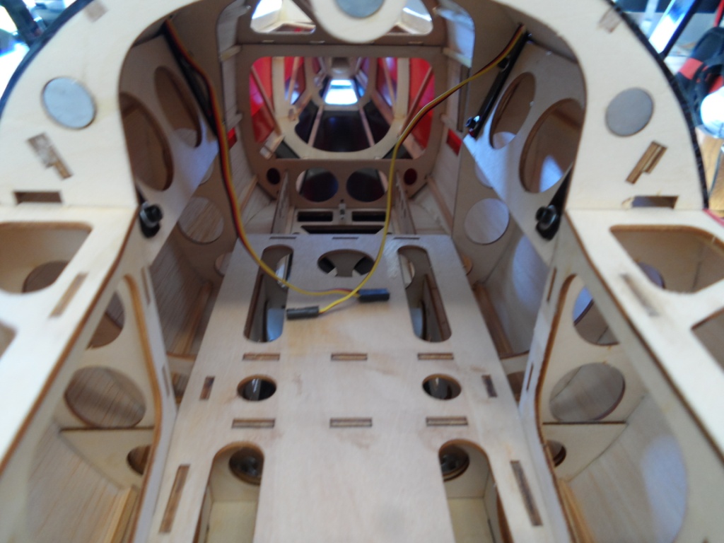

Nice strong magnetic front upper cowl for battery placement.

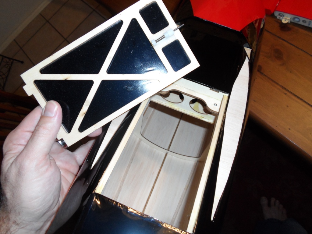

Spring loaded removable hatch area under fuse.

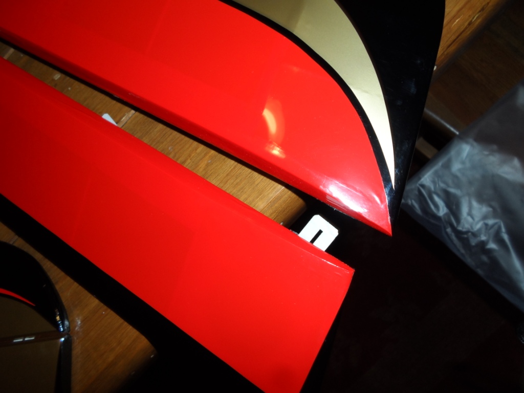

And final pic shows the CA type hinges that need to be glued on all surfaces. I typically don't like these but Horizon tends to know what there doing on designing these planes. These are the fastest way to get you flying ASAP....

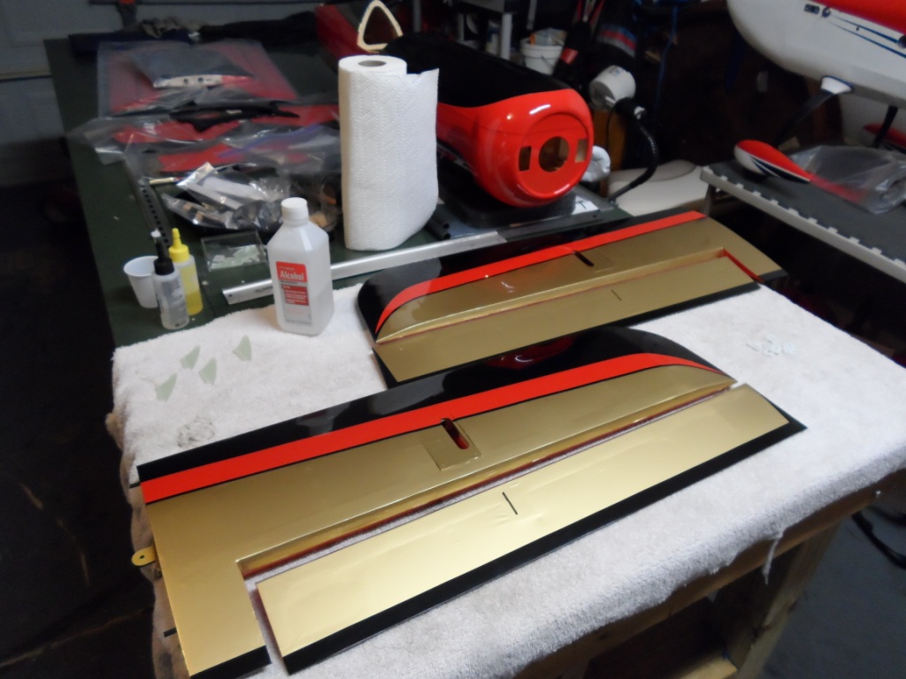

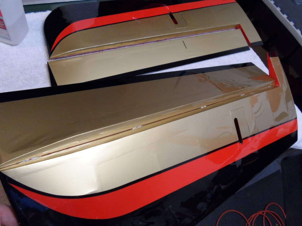

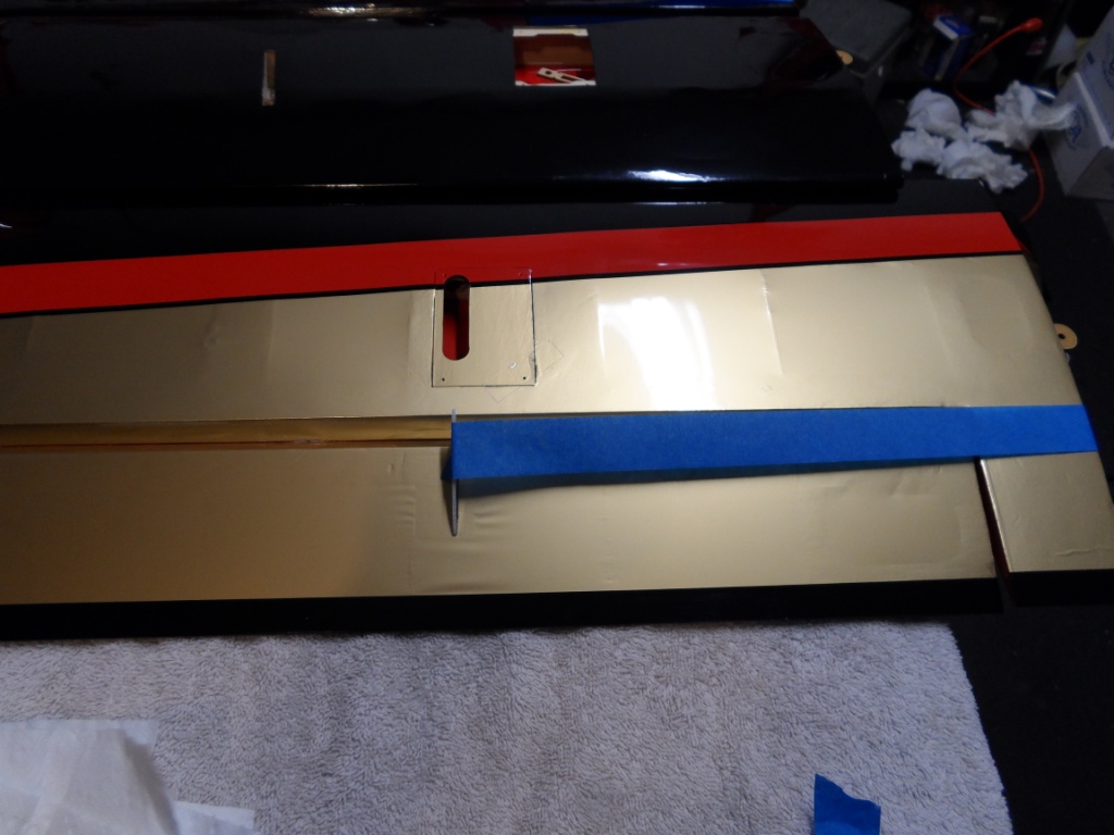

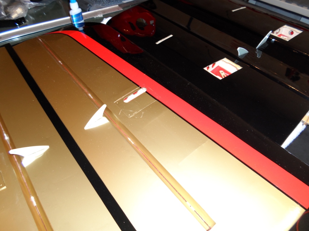

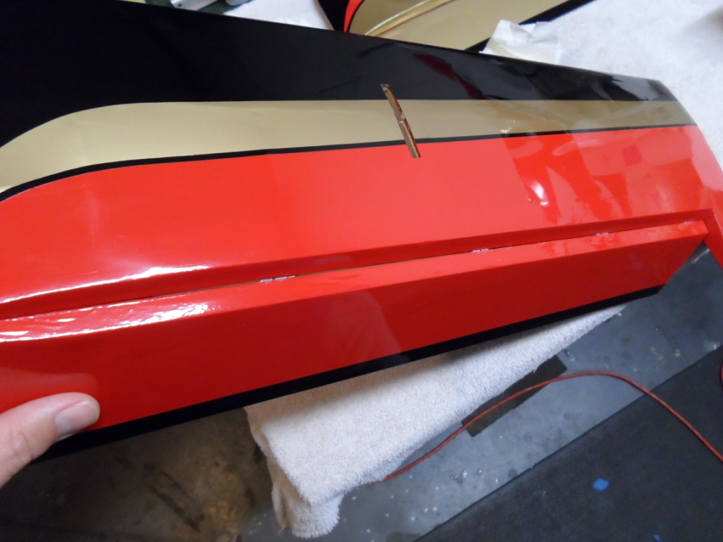

Alright, got a little more done. Would have done more, but my AC went out last night. Good thing its cool at night. Anyways, got the wing hinging done and control horns epoxied in.

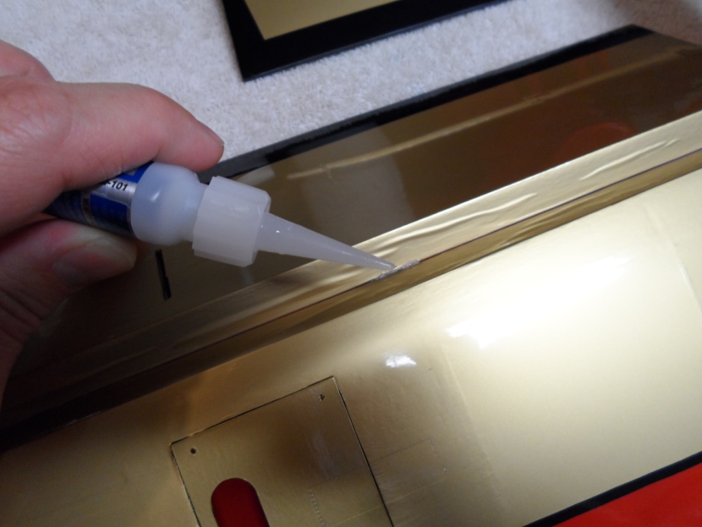

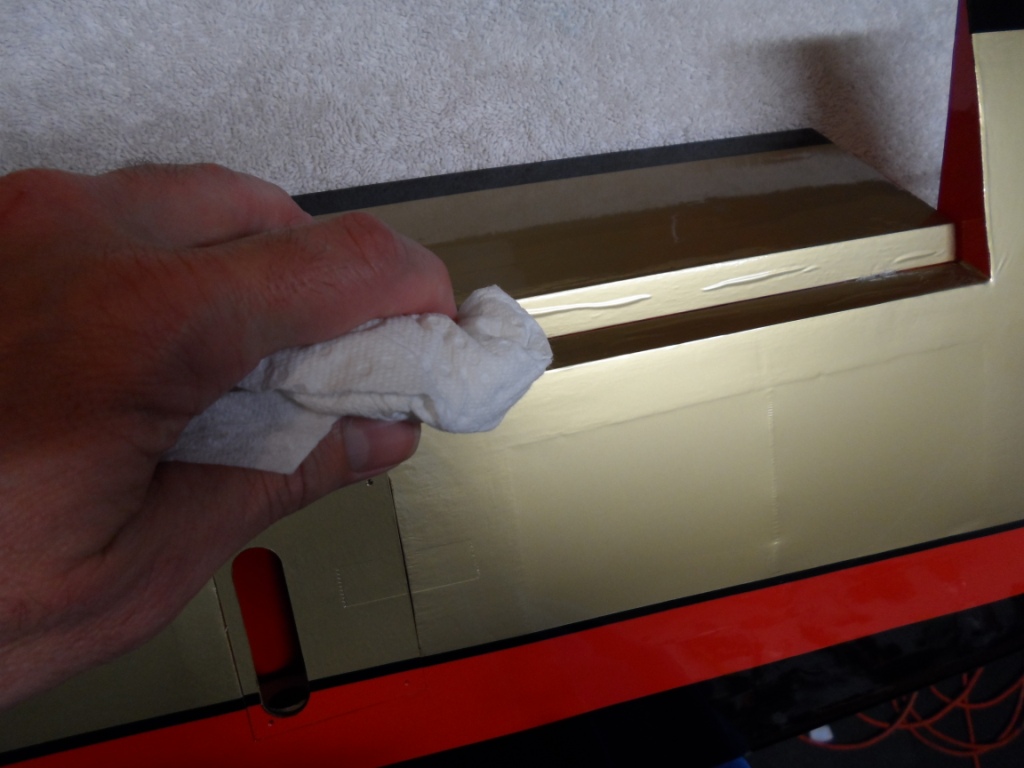

Pretty simple on these CA hinges, line it all up, find your hinge gap, and slowly flow in the CA.

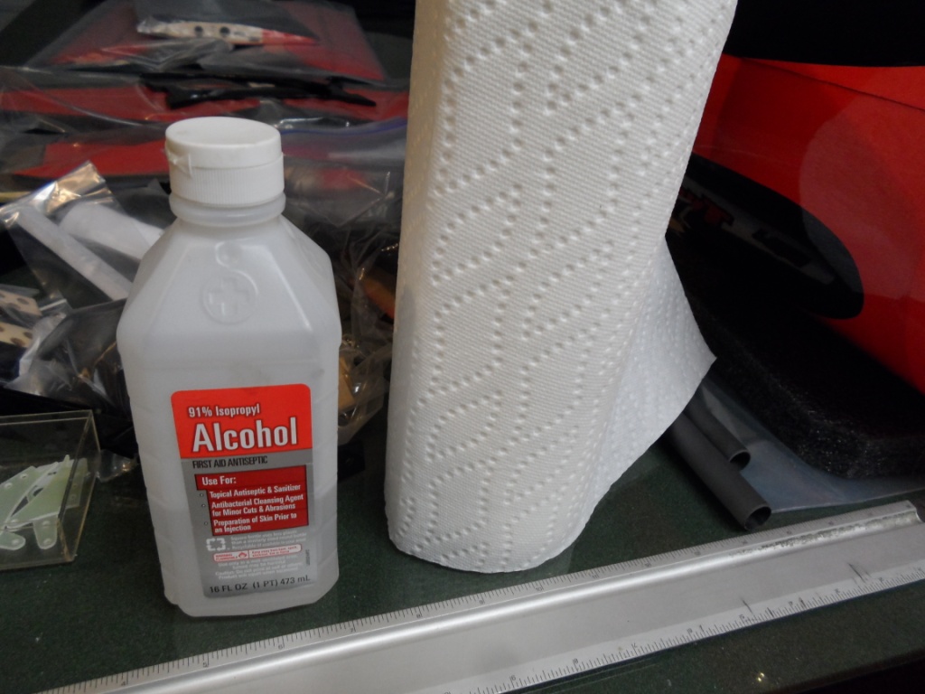

Have your alcohol ready and acetone if needed
I do one hinge at a time and clean real well with the alcohol. If it runs bad, get the acetone and rub it off.
Keep an eye out for bad CA hinges, I had 2 do this and once it happens, there no good.

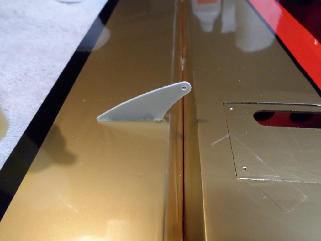

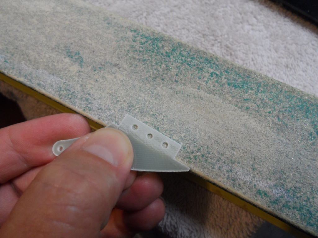

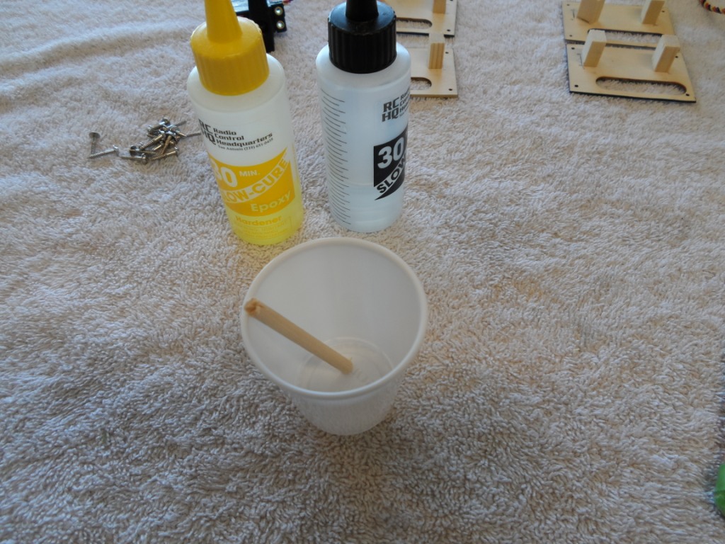

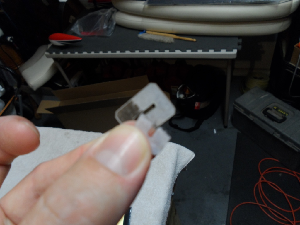

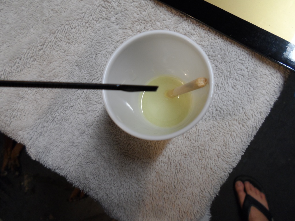

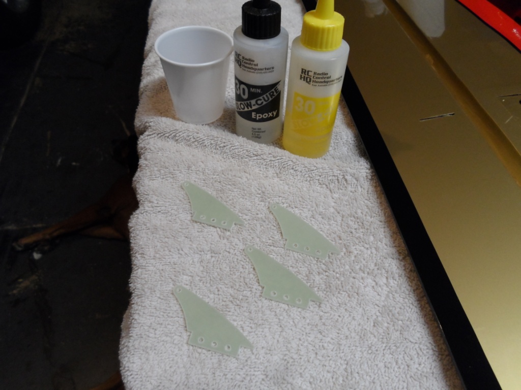

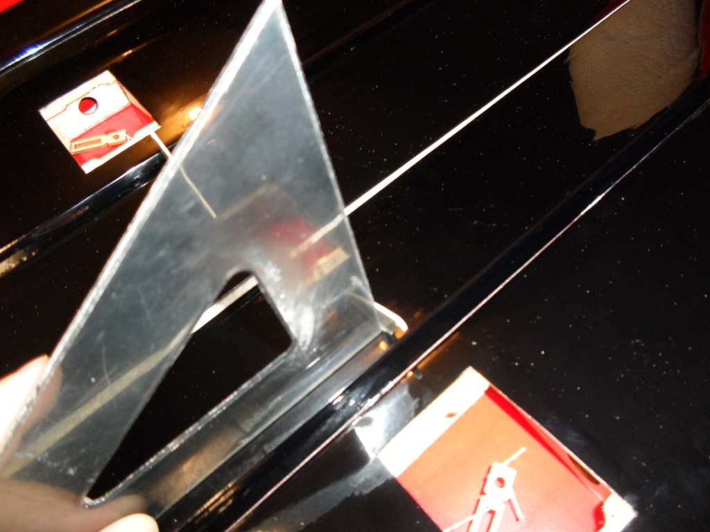

4 aileron control horns ready to install with epoxy.
I use a tie wrap end to get the epoxy down into the slot in the aileron.
Make sure they sit 90 degree and straight.
Scuff the area to be glued so it bonds better, use heavy grit sandpaper.
Make sure your right over the hinge line.
2 out of the 4 control horns were not 90 to the surface, so i use tape to hold in correct position till it dries.

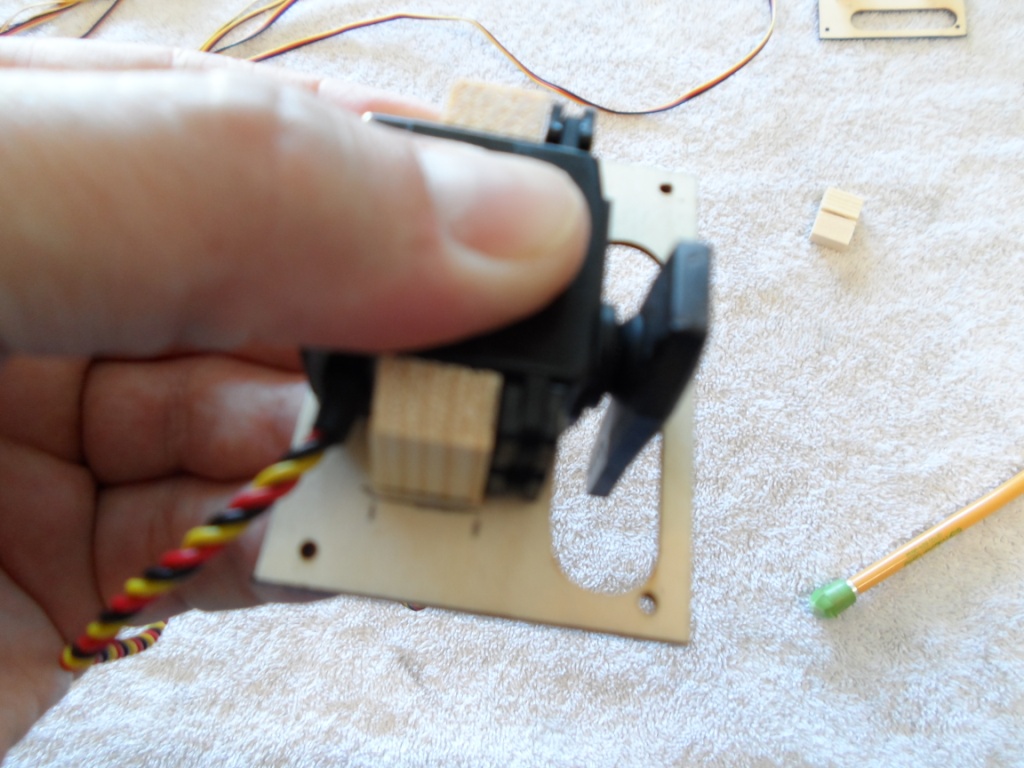

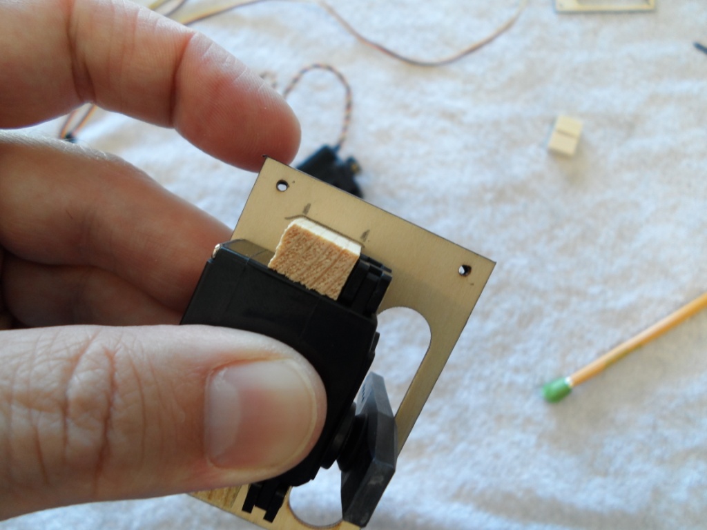

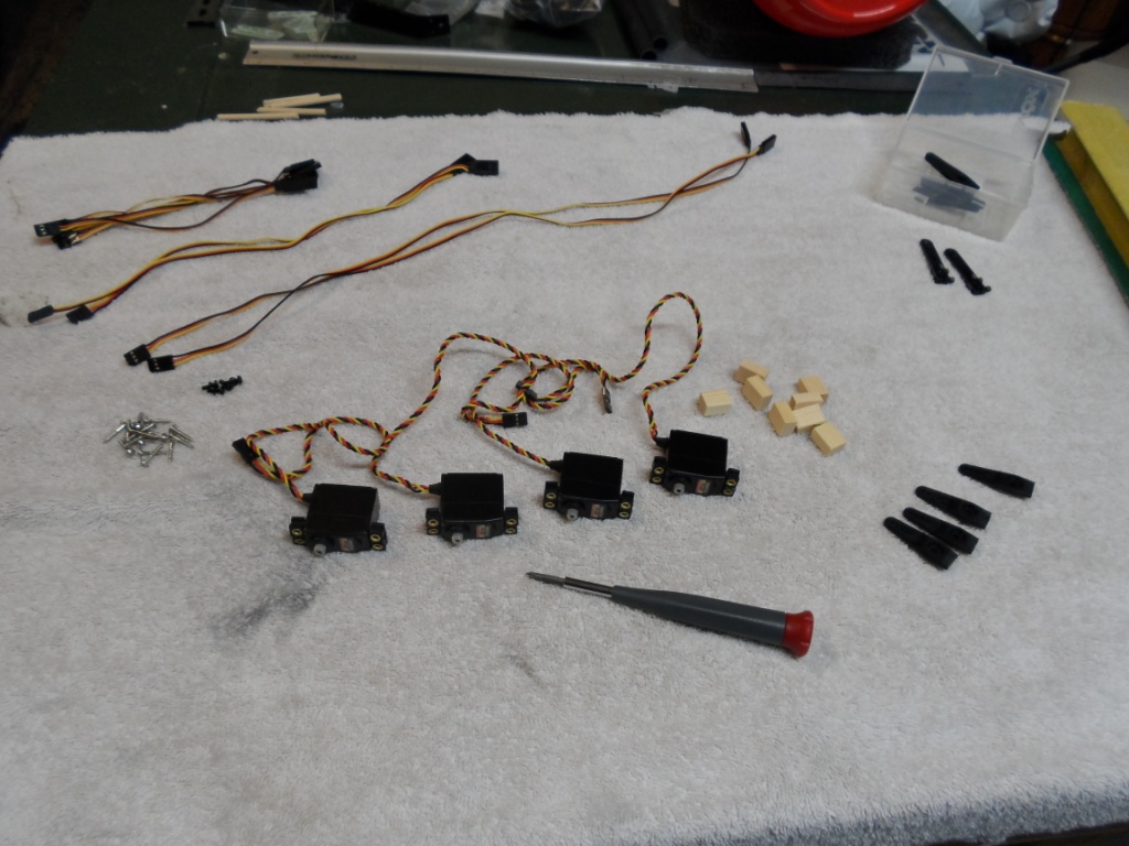

Also got the servo mounts done. Make sure you go with the mini size servos, standard wouldn't fit in these trays without major modifying.

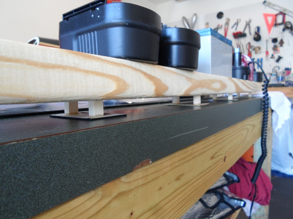

Line up the blocks, mark position to glue
I put a 2x4 onto the block with weight till they dried.
