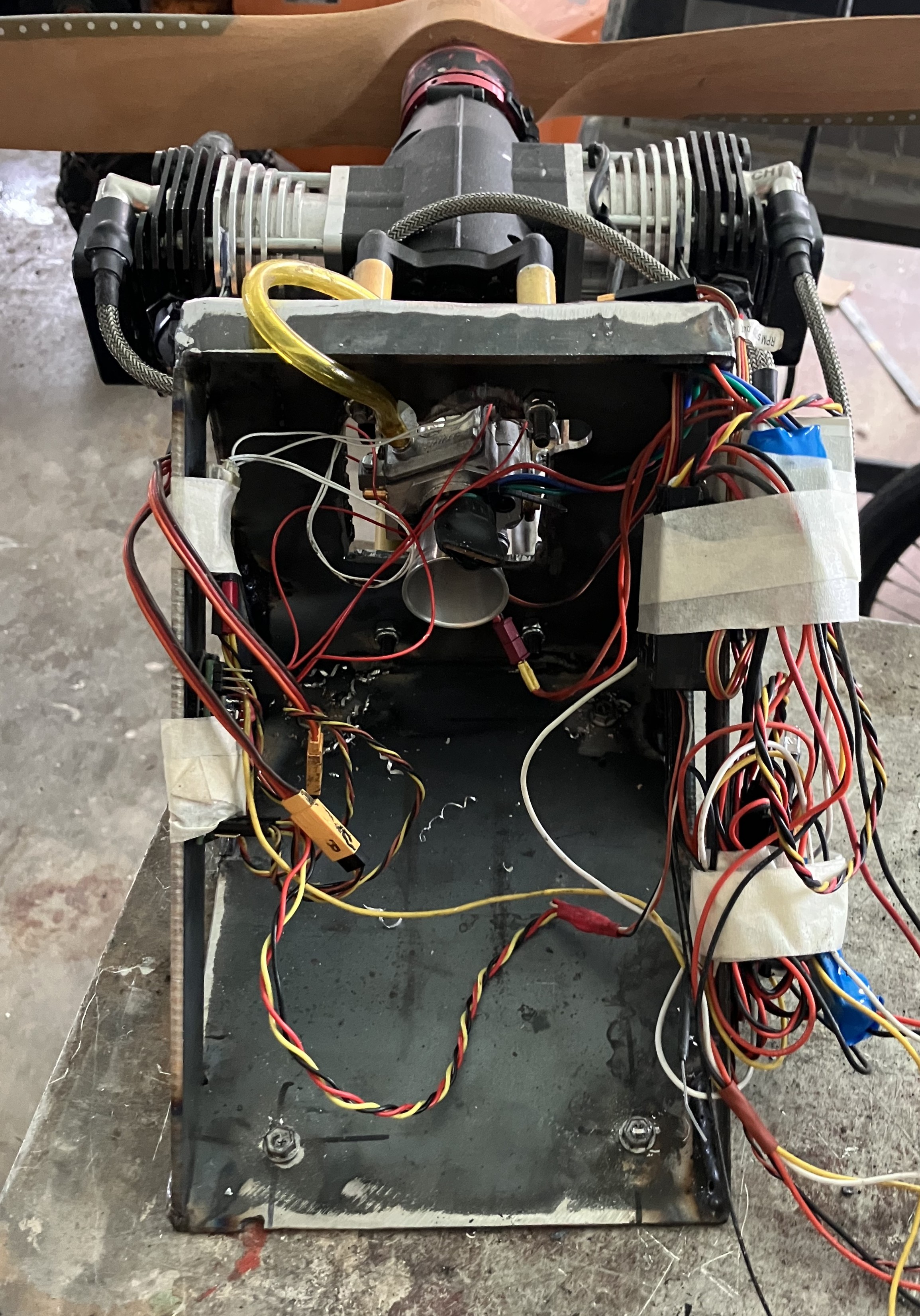

I had to cut a rather large hole in the engine stand used for the Saito FG61 to get the Roto mounted. When I ran the engine it had quite a bit or vibration in the 3000 - 4000 rpm range. Decided to make a stand for the engine and increase the stiffness. It's mounted and ready for testing.

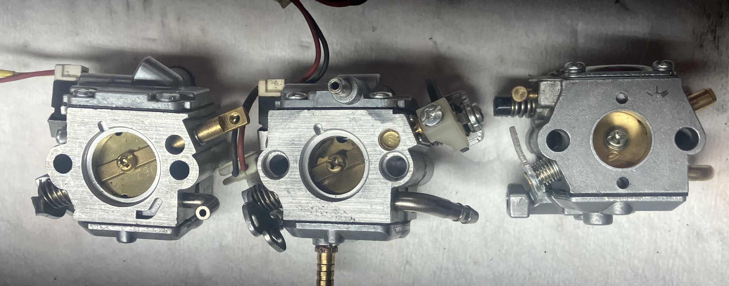

As far as the engine goes, the carb in the photo above was off a 55 cc Stihl chain saw, on the initial runs it would only idle as low as 1600 rpm, a smaller electronic carb was purchased from a 35 CC Stihl saw, this was run and achieved an idle of 1200 RPM. The engine would purr at 1000 RPM with the original WT962 carb so I wasn't satisfied with 1200 RPM.
For reference the original WT962 bore is 14 mm, the 35 CC saw is 15 mm, and the 55 CC is 18 mm. The carbs are shown below.

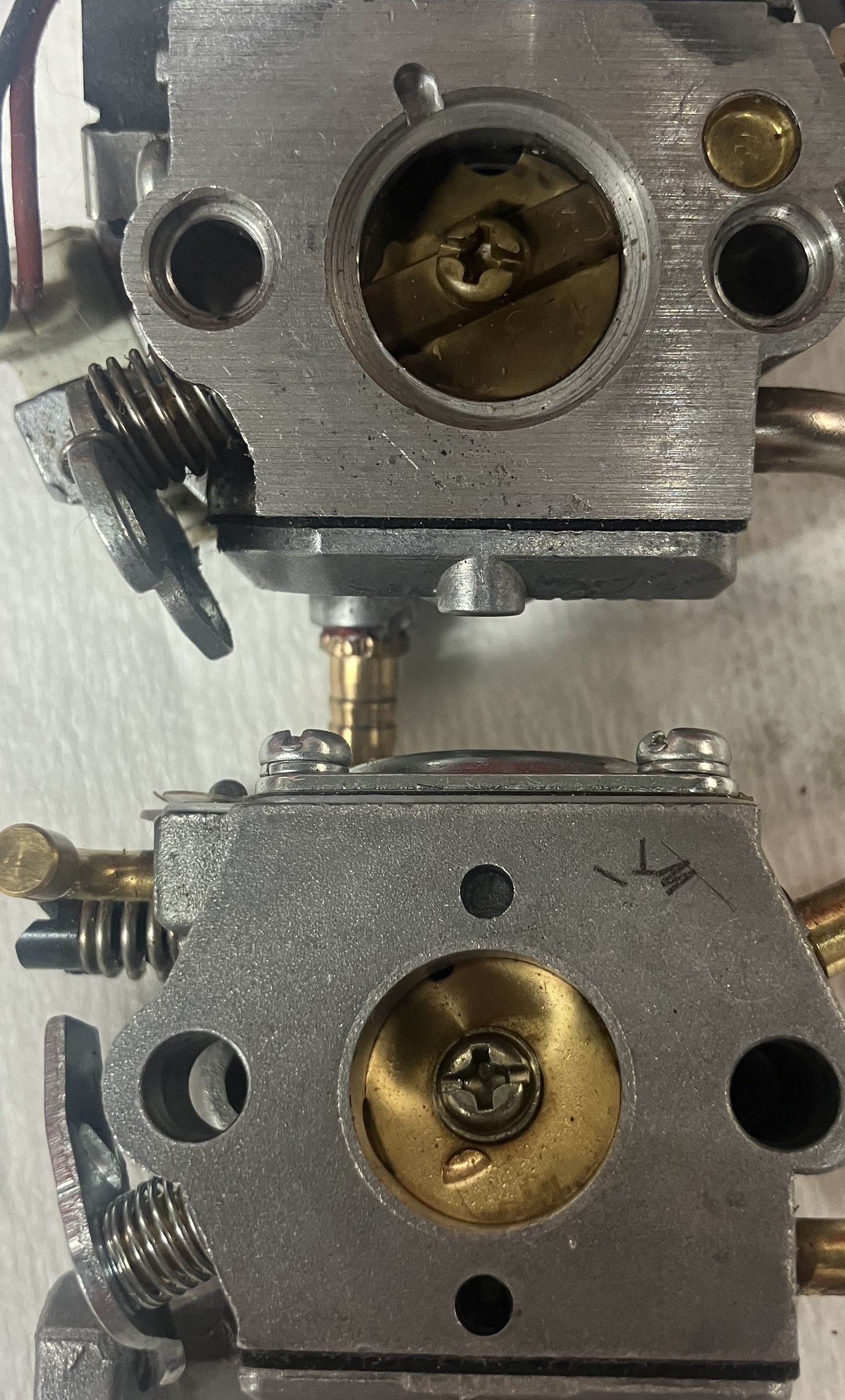

Additionally the bleed passage on the 35 CC throttle plate is much larger than that of the WT962. I suspect this has to do with the fact that saw must be running to power the controller in the saw, there is no battery. The solenoid is a normally open device to allow fuel to flow while starting, once started the fuel controller takes over. Note the difference below.
The throttle plate was removed and the passage was filled in with Harris stay bright solder. That where it stands today, once the new controller is built, tuning will continue.
