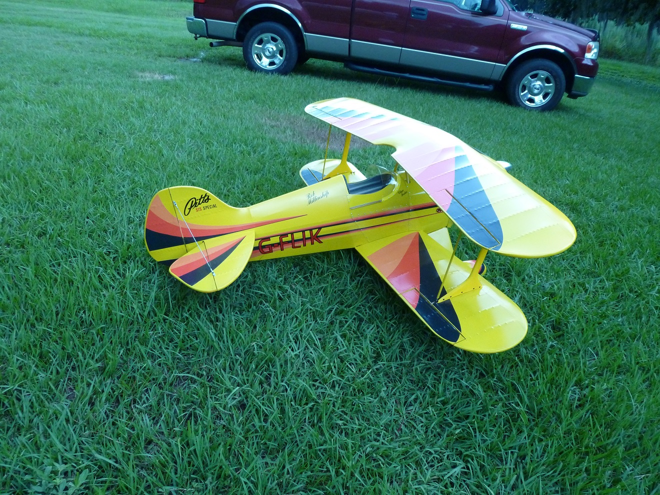

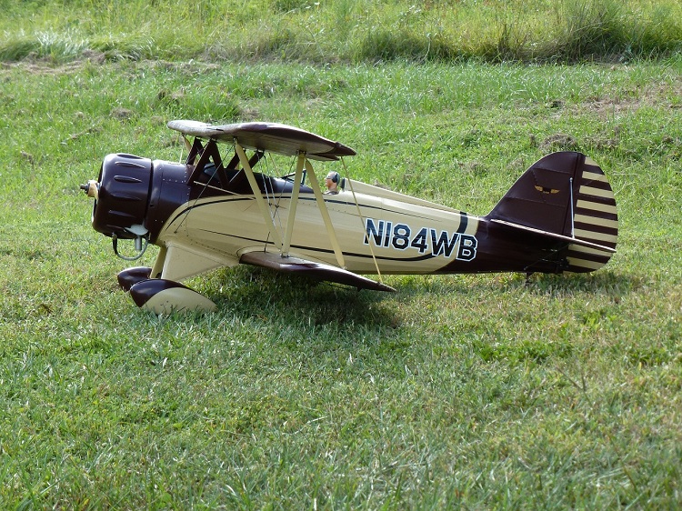

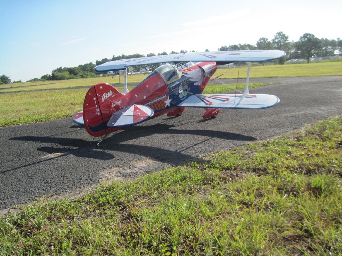

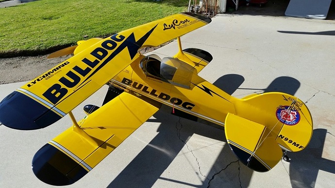

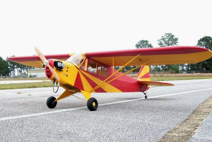

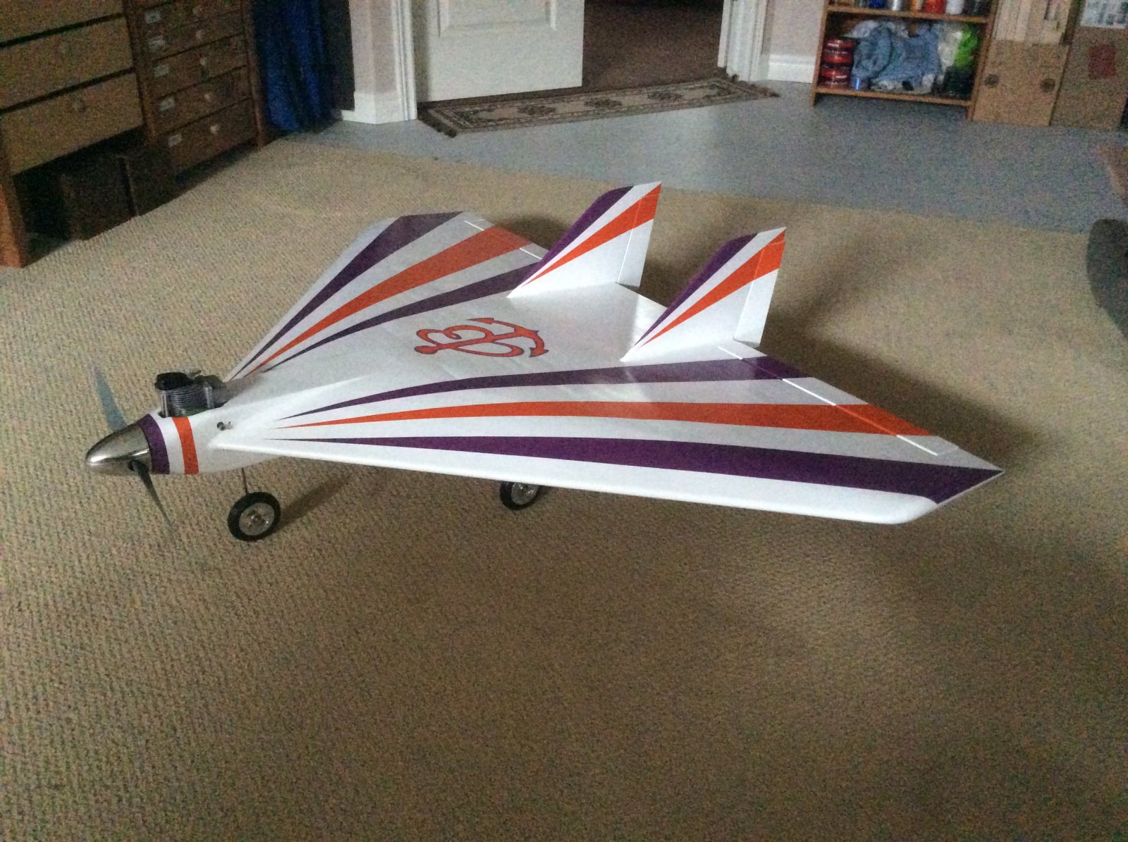

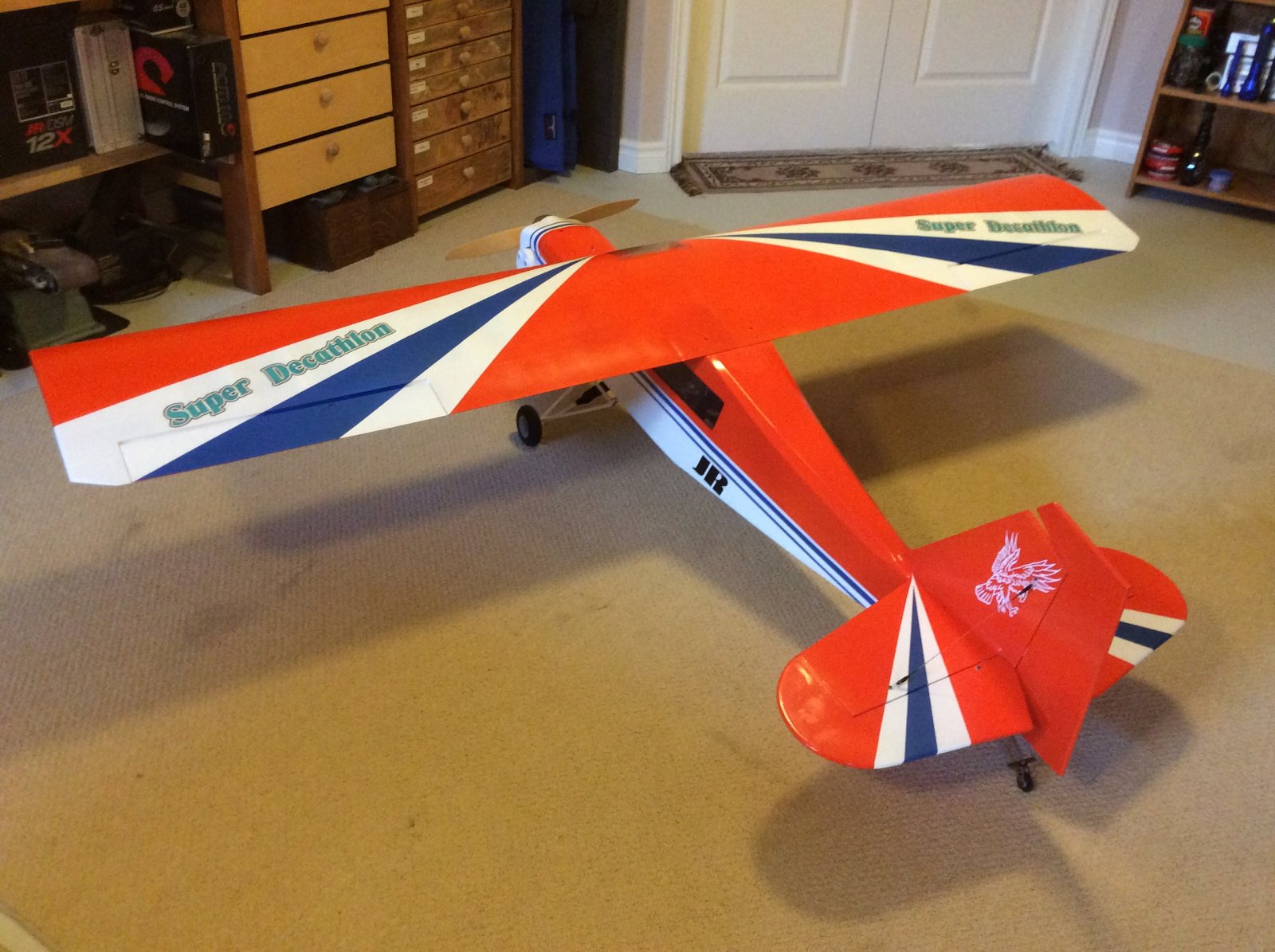

I have been using the Stits system for years and it is simply the most user friendly product out there. I do not use their Poly-Tak, I use Sigs Stix-it as it is much simpler. Here are a few I have done with the Stits.
Love the stuff use to use dope but once you try this you will never look back. Done 11 planes up to now and very successful. Use all there product and follow it as recommended. Only thing I do use is the aluminum uv protection coat heavy and not needed. And spray all the coats do not brush.

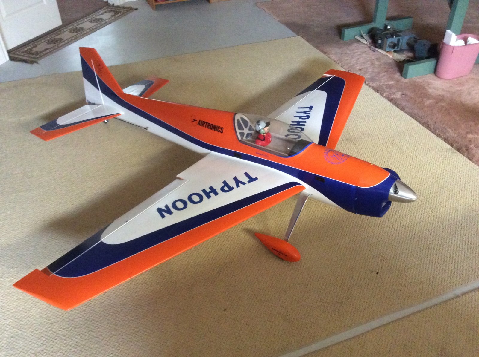

@Snoopy1 Nice planes! I see that you have a color scheme going there with the orange white and blue! I like the pin stripe lines between the blue and orange on the typhoon.
@acerc I agree with you with the humidity. Its the hardest part with the whole system, even in SE Alaska! The Stewart sprays on pretty blotty compared to the Stits.
Sorry to say but yes I love those colours. And they are easy to see in the sky. And the price of paint it gets expensive in hurry if like to many colours.
