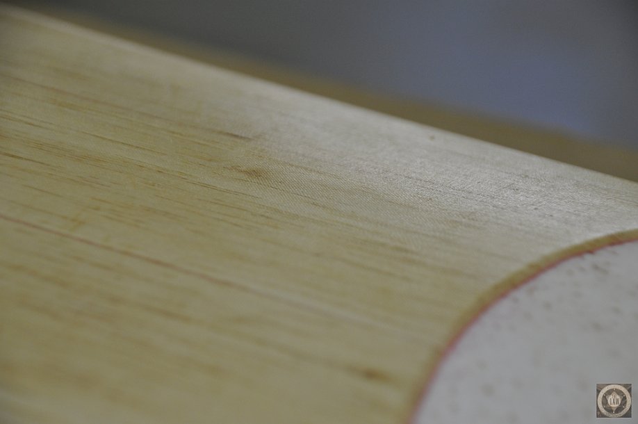

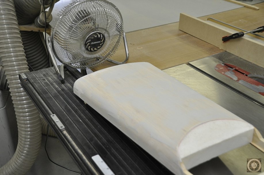

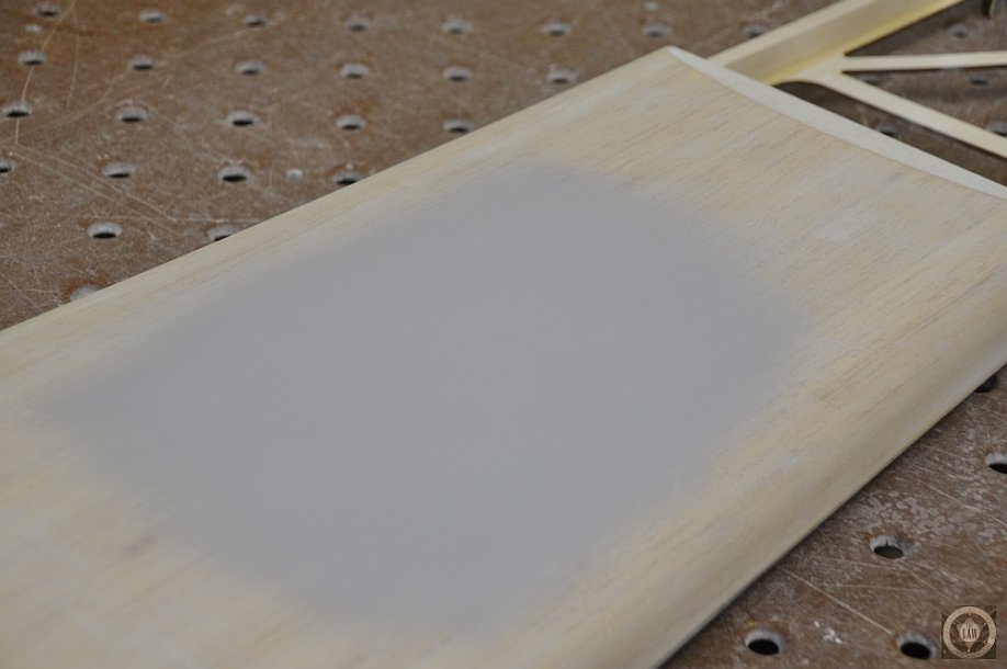

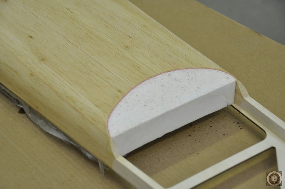

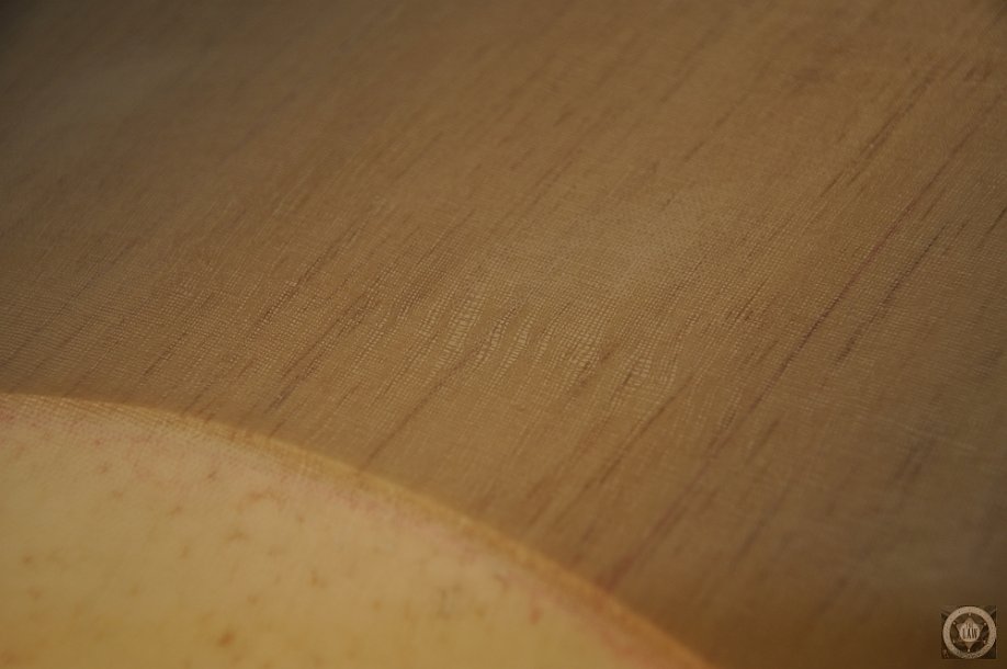

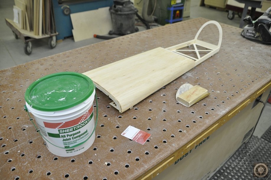

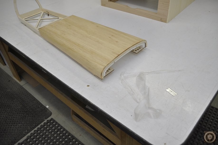

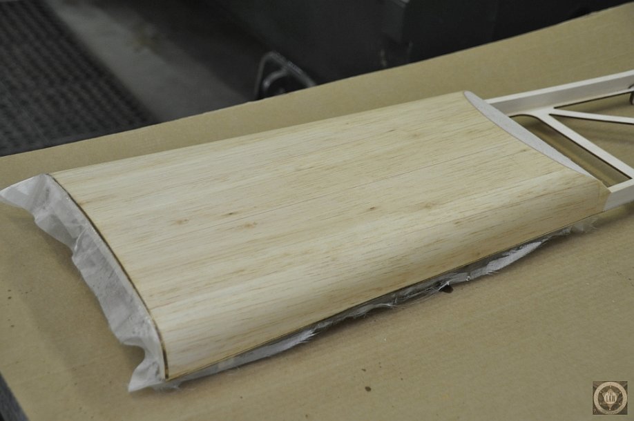

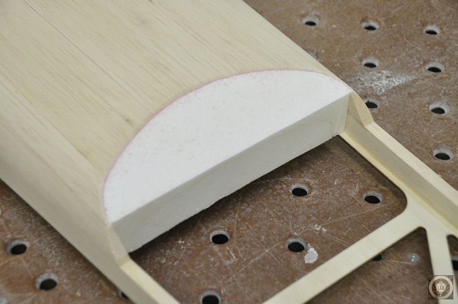

This is how we kinda got started on this subject. @Jetpainter is working on a project that will be painted and I am looking at doing a fully sheeted build that will be painted as well. We are experimenting with a few different types of fillers to fill the weave of the fabric to prep for painting with the least amount of weight and work.
Here are a couple pics of mine that I did with drywall compound after glassing. A test patch of primer shows a completely flat surface with no weave ghosting through. Jetpainter is working on some test panels as well. After seeing what we have so far I'm looking more forward to this than ever!!
