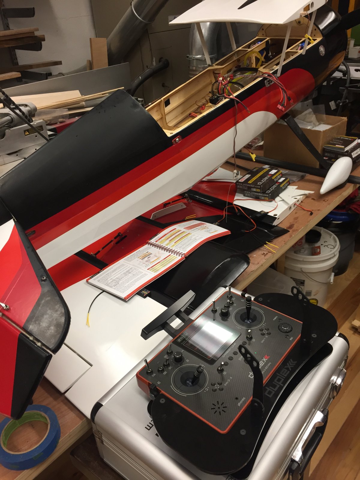

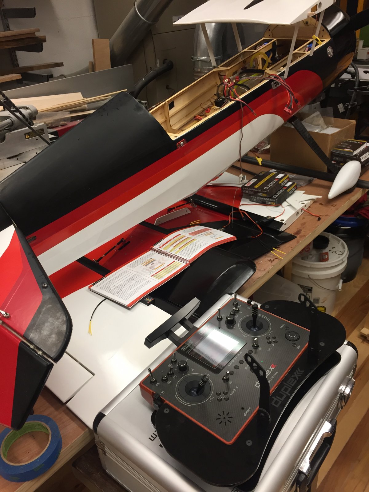

After much delay on my part the Pitts is having it's JR heart ripped out and a Jeti DC-24 transplant in the form of a Central Box 200 with receiver switch is going in!

What is the little red square with a silver button near the back of the canopy opening? Just curious.

Will do...Initial setup was ridiculously easy...hit some snags a bit later tonight but I'm also distressed over the Indians debacle in the World Series tonight so not the best environment to be working on something new...
Wacobipe
So the snags were getting the Central box and the RC switch working correctly as I've never had either before. Once I got a little assist from James at Esprit Model...it took about 2 hours to set up all servos, throws, rates, etc... that would have taken me 2 days on my JR. this system is just stunningly logical and simple to understand....I haven't even cracked the manual more than a couple times.
The simplicity of programming this radio should terrify the likes of JR and Futaba...Jeti blows those difficult to understand systems out of the ballpark!
