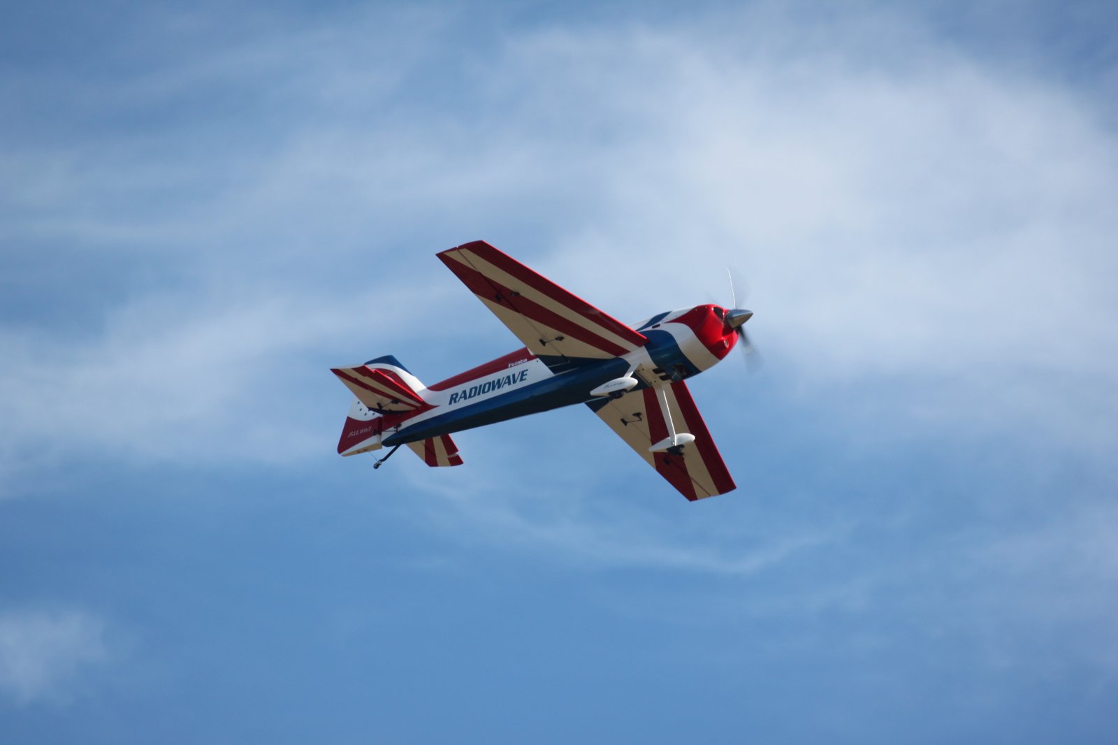

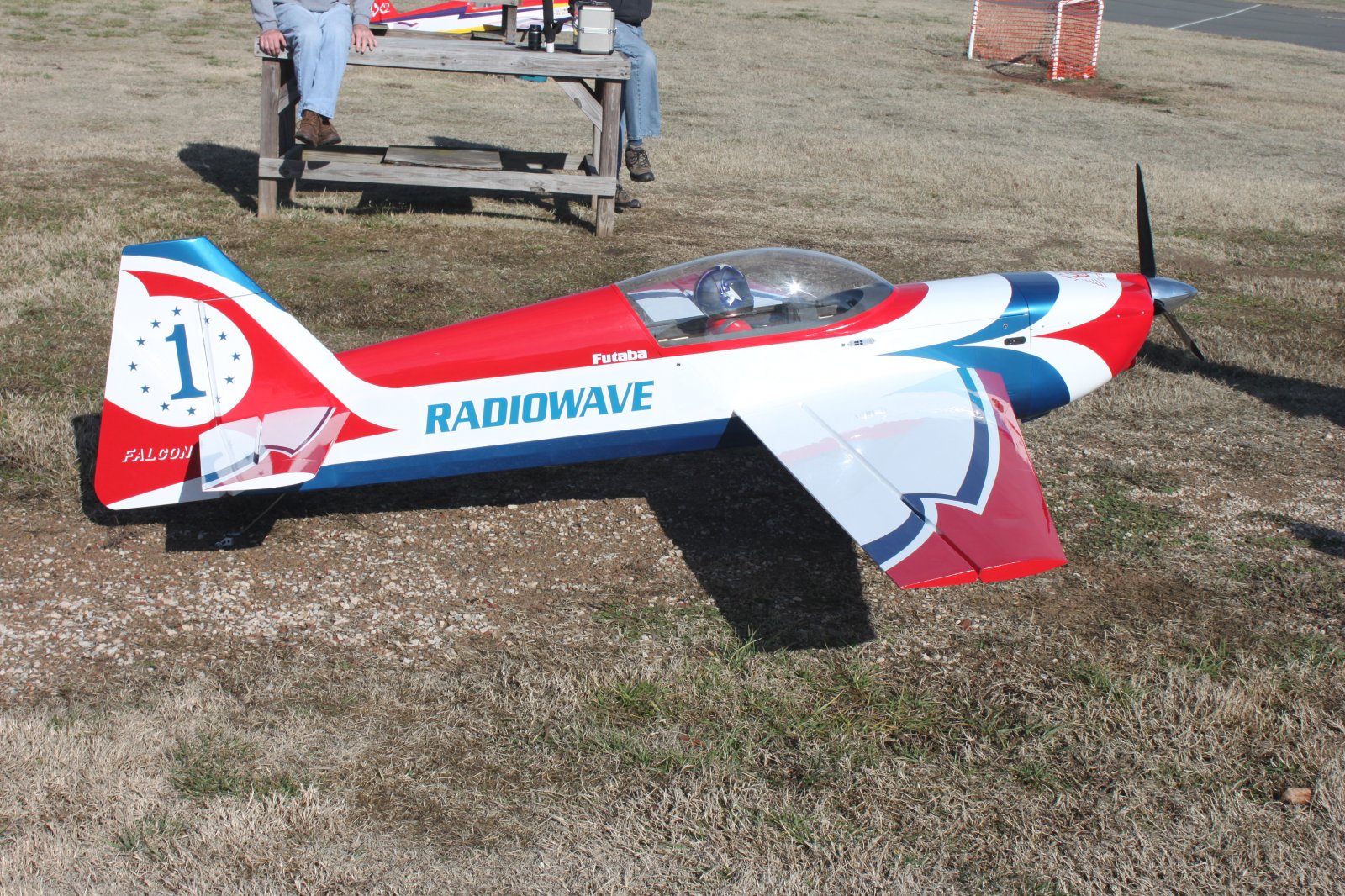

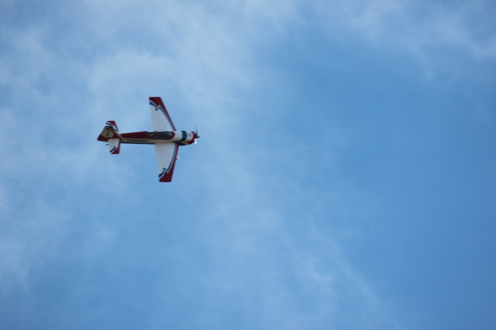

  1. We have been working on a new Giles 202 and finally got a chance to test fly it last week after the snow melted. Kevin did most of the design work. I did most of the building and Jason did most of the flying. Jason said if Clover Creek or the Shootout were a week from now he wouldn't hesitate to fly it.

  5. Between myself and Jason Shulman we really could not feel much of a difference between the Giles and the MX2 which to be honest was a bit of a surprise to us. While I have always been a fan of the G202 I will admit that I did expect it to be not quite as good as the MX2 because of the difference in the wing. I know after 5 flights Jason could not decide which he would like better. The other surprise was the mixing, the MX had 0% left and 1% right rudder to aileron and Giles has 1% both ways.
