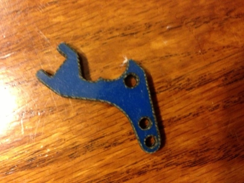

Vital-Rc
If you keep experimenting you can get some decent results , the wj71 throttle arm I designed is actually cut out on a laser . The edges have burn marks but it still produced usable results .
If you're looking for near perfect results for carbon and g10 the Cnc router is the best method, at least it is on my Cnc . :)
