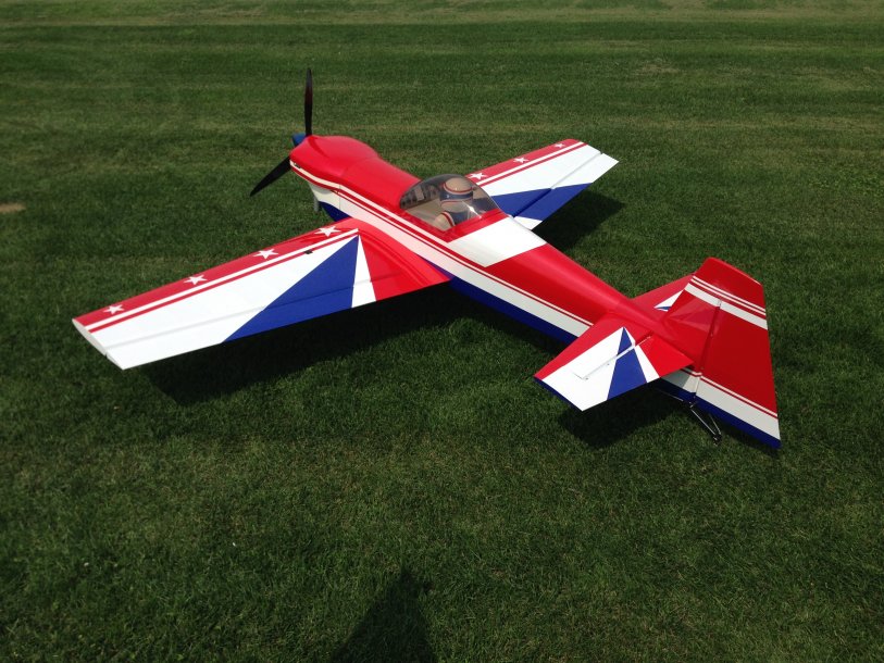

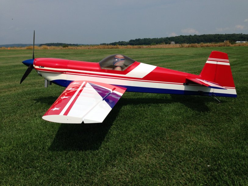

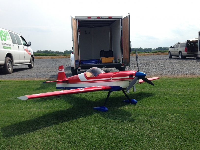

I finally got the Cap in the air, it's been a while, I know. I'm slow when preparing a plane and have been traveling a lot for work. I have a couple questions, I am hoping the knowledge on the site could help me solve a nagging issue. I hope you don't mind and I'm looking for any and all feedback, so please help if you can. I've flown the plane about 5 flights, pretty awesome plane! The issue which is currently nagging me is final approach, I'm having a hard time getting the plane down due to some porposing (ballooning) issue. I thought it could be a few different things, I thought it could be CG, elevator throw or engine thrust angle. Am I missing anything? Below is what I've done so far.
  1. I've looked at CG first, I've checked the CG in the air a few times and it's about neutral, it needs a slight touch of down elevator to keep inverted level or 45 up-line flight. It may need additional tuning as I become more used to the model, but it feels comfortable in the air inverted. I had to add a little weight, i may move a battery if I stick with this balance point. It flies fine, but did not solve the issue.
  2. Thought it might be too much elevator on final. I added 10% more negative expo (futaba) to the elevator. I feel I have good control of the elevator throw, flies comfortably and I don't feel I'm fighting the elevator in the air.
  3. Now I'm considering engine thrust (more up thrust). I think it could be engine thrust as I feel it tries to climb (balloon) a bit on final when I cut the throttle, I need to push on the elevator stick a bit to get it down, when I let off the elevator it porposses. sucks...
  4. Are spoilerons an option? It would feel like a workaround instead of a fix.
I don't feel comfortable having to push the elevator to land, I always set my planes up so I can hold slight UP elevator to control a decent with a final flare. This model is a balancing act to get it down and a fight on the elevator, push - pull - push - pull - ugh.... I have not made any thrust changes yet, I figured I should stop at this point and consult with you before I begin to make additional adjustments.
Also, I'm using a 3 blade prop, could it be possible that the prop may require me to have to do anything different on final? I hear 3-blade props produce a braking effect, especially at idle, and additional right-thrust than a 2-blade.
Thank you in advance.
I added a couple pics for you, hope you enjoy them...
Regards,
sc
