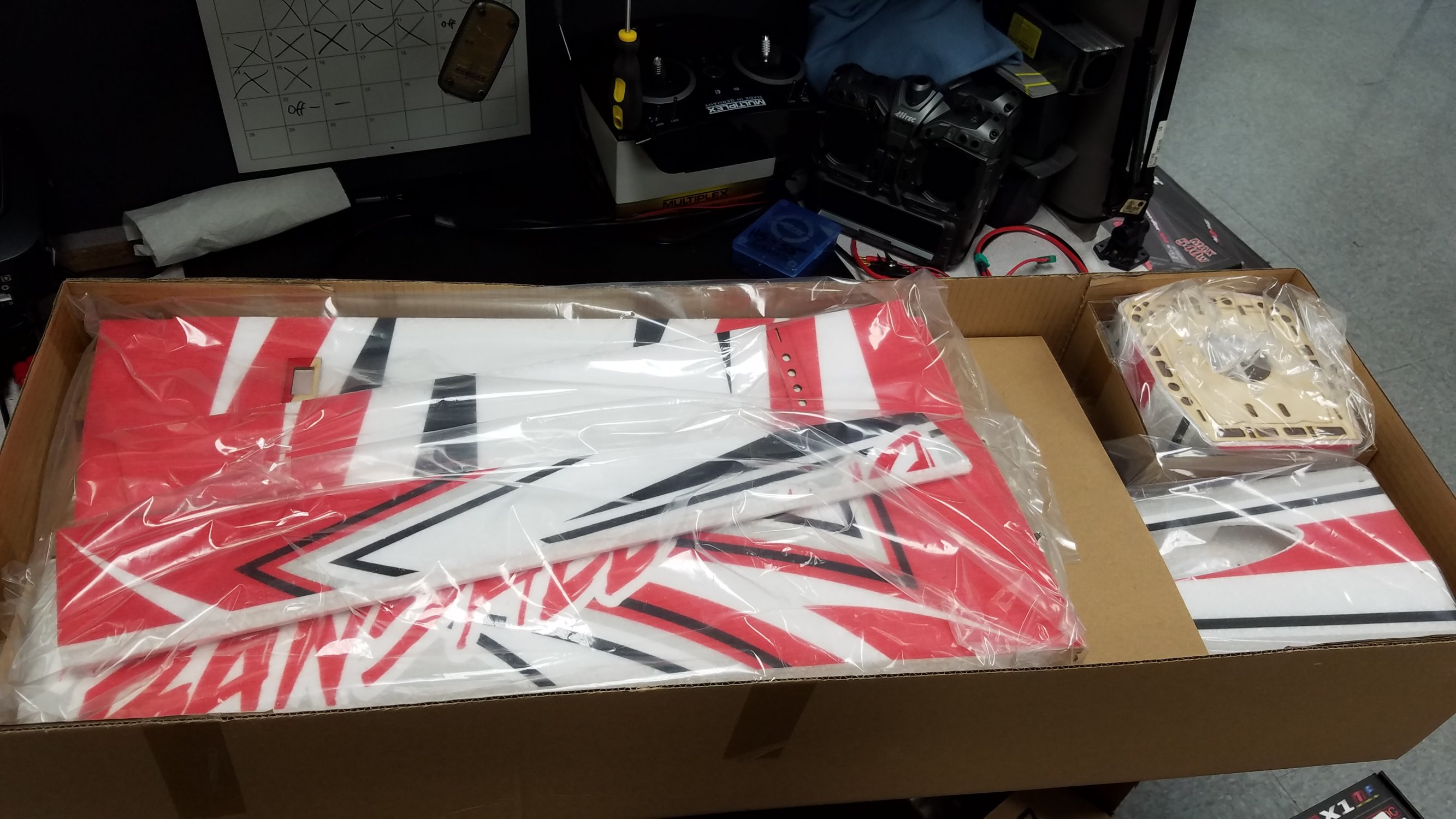

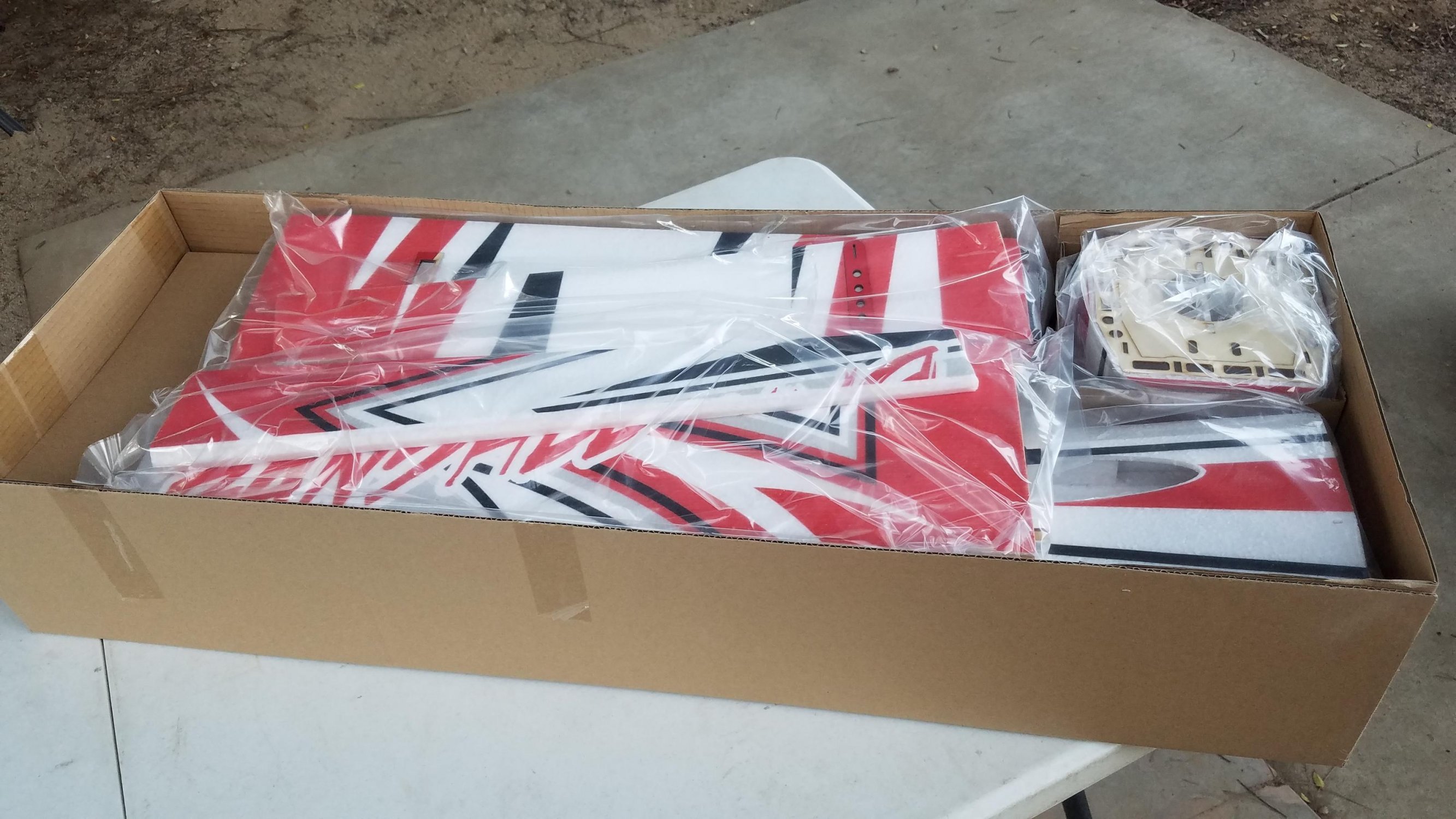

Spent some time laying the parts out last night and doing some initial prepping for assembly. The first thing you always want to do with a new airplane is lay out all of the parts to make sure you have everything. If you find something is missing then please give a call or send an email to Aerobeez and they will help get you straightened out.
The parts all come double boxed for protection and sealed inside of their own bags and taped in place. Very secure for shipping!
Lay everything out on a table and inspect all of the parts to ensure nothing is damaged. My airplane was pretty much damage free so I could move straight onto parts inventory.

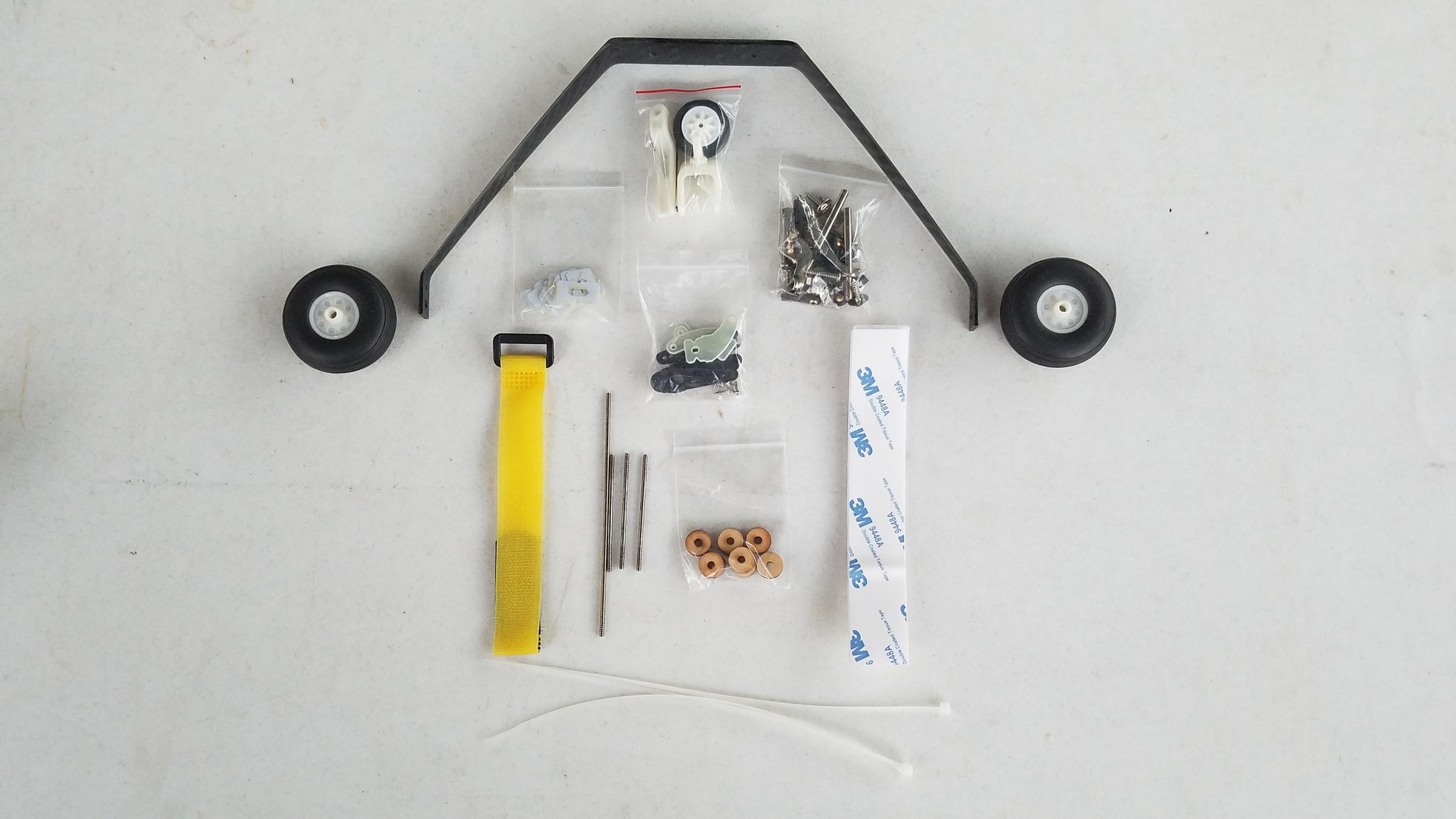

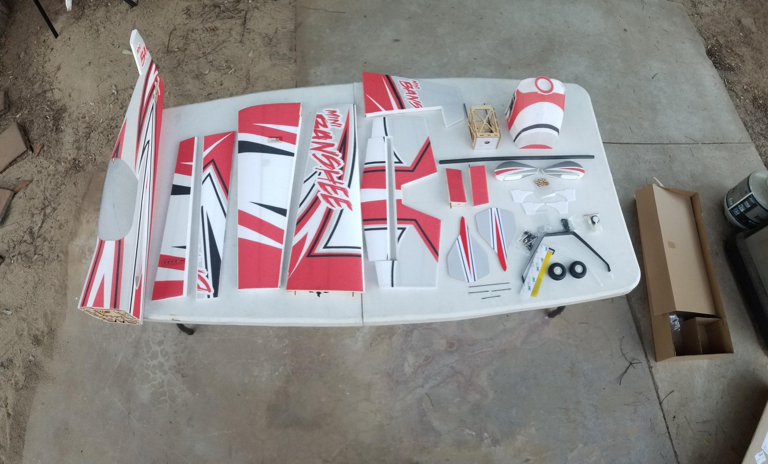

The hardware package is very complete with this airplane. Carbon fiber main landing gear legs, lightweight foam main wheels, axles, complete tailwheel assembly, ball links, turnbuckles, assorted screws for misc. parts, CA hinges, carbon control horns with carbon servo horn extensions, velcro with adhesive backing, a velcro strap, some zip ties and plywood inserts for the wheel pants.
Cowl and firewall. Note that the firewall comes with thrust alignments built in and can only mount one way.

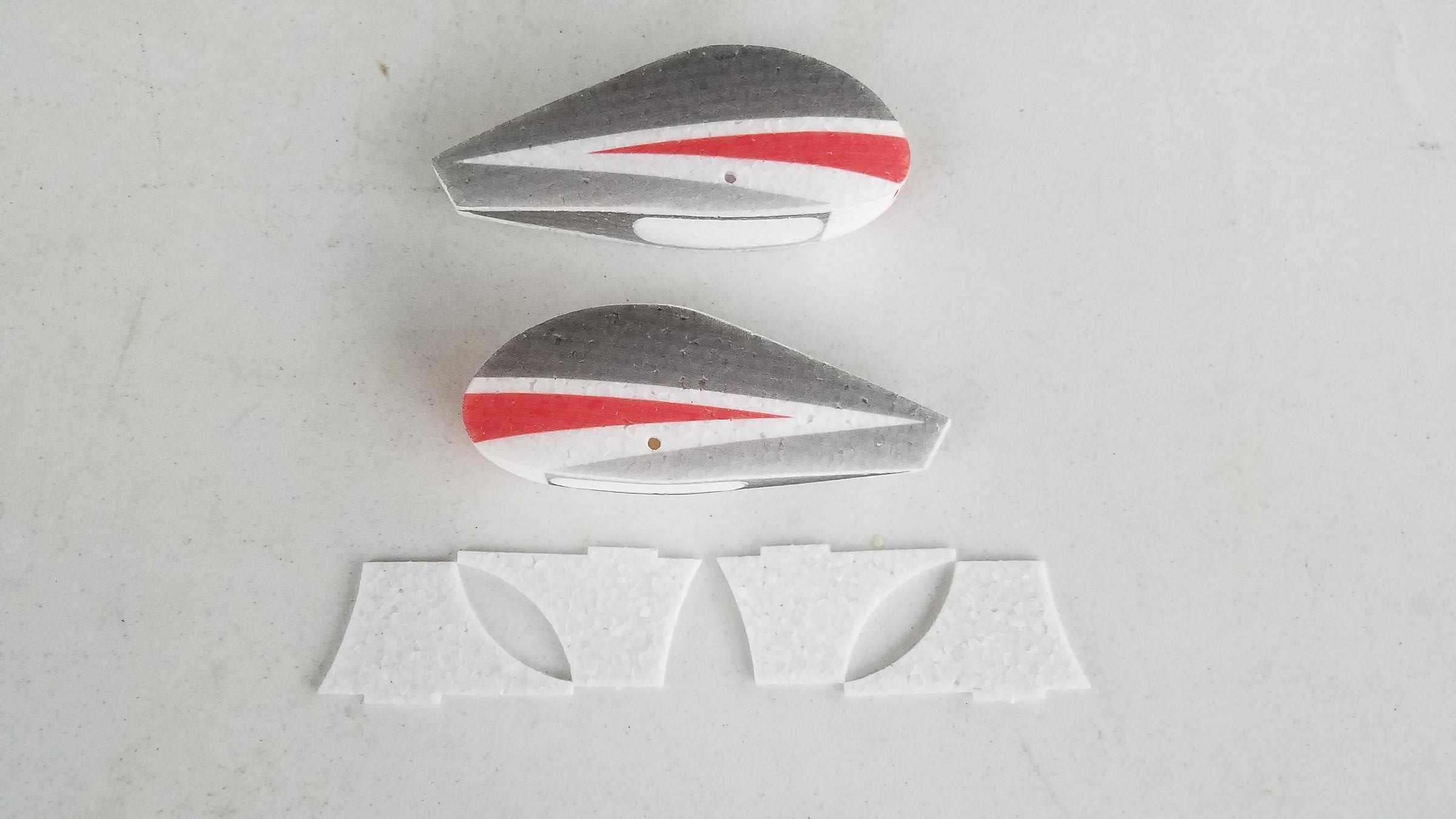

Wheel pants and landing gear cuffs.

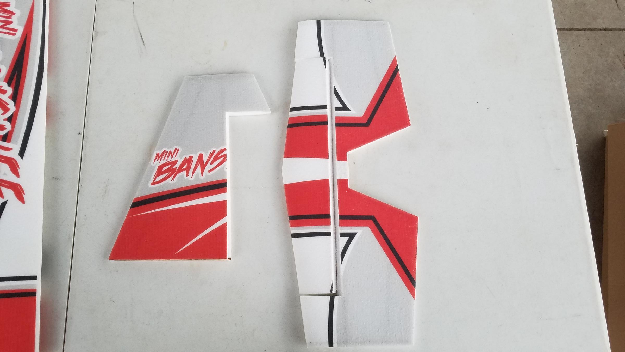

Rudder, elevator, and horizontal stab.

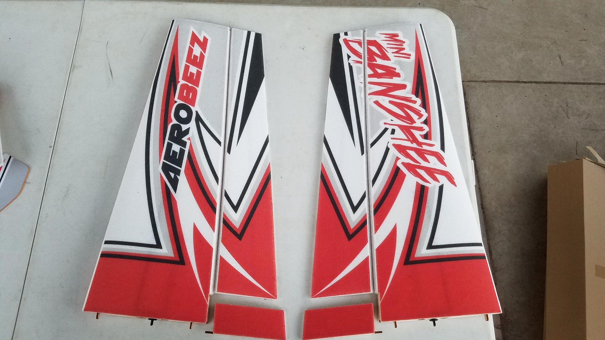

Left and right wing panels and ailerons as well as root extensions for the wings. Please note that the thumb bolts for securing the wing panels to the fuselage are already threaded into the wing at the root.

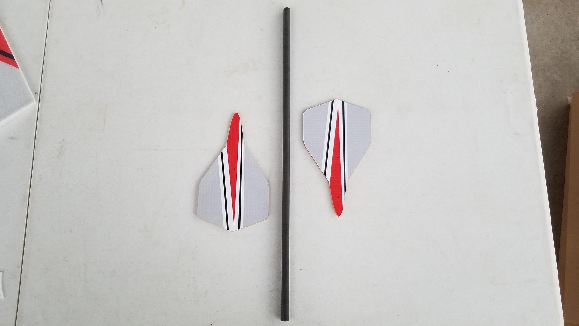

SFG's and carbon wing spar.
Last but not least, the fuselage with removable canopy.

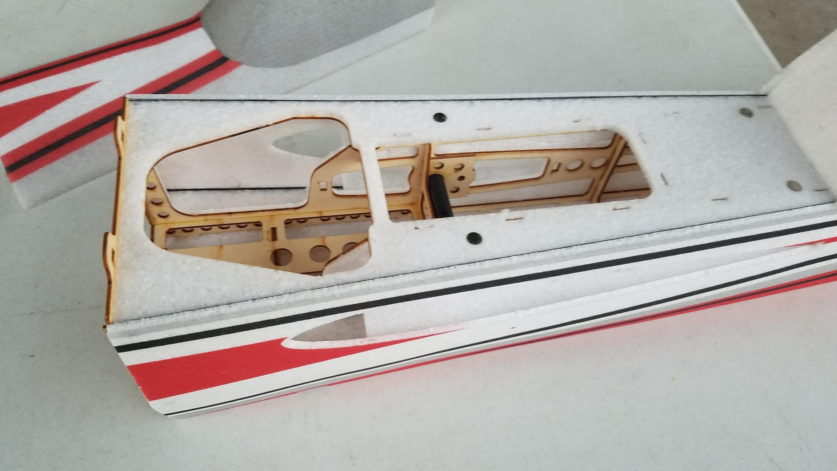

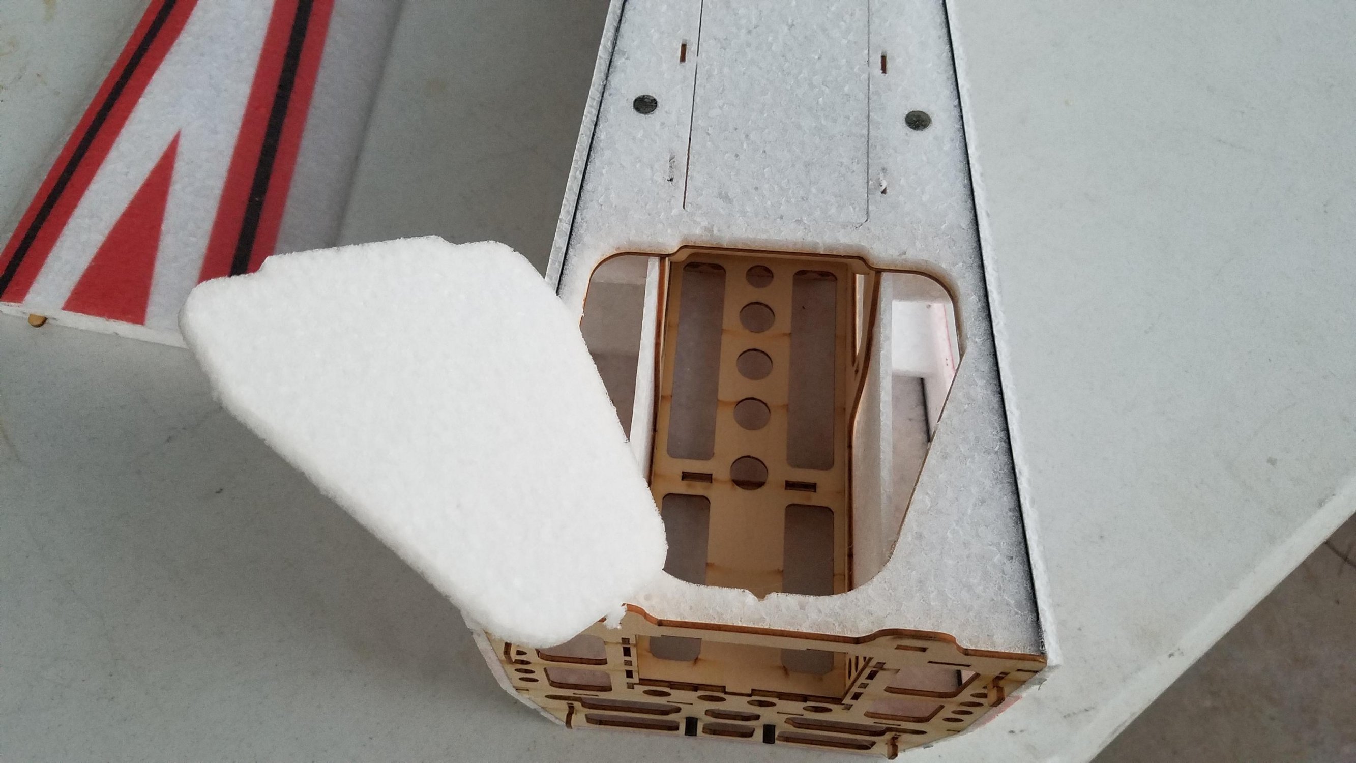

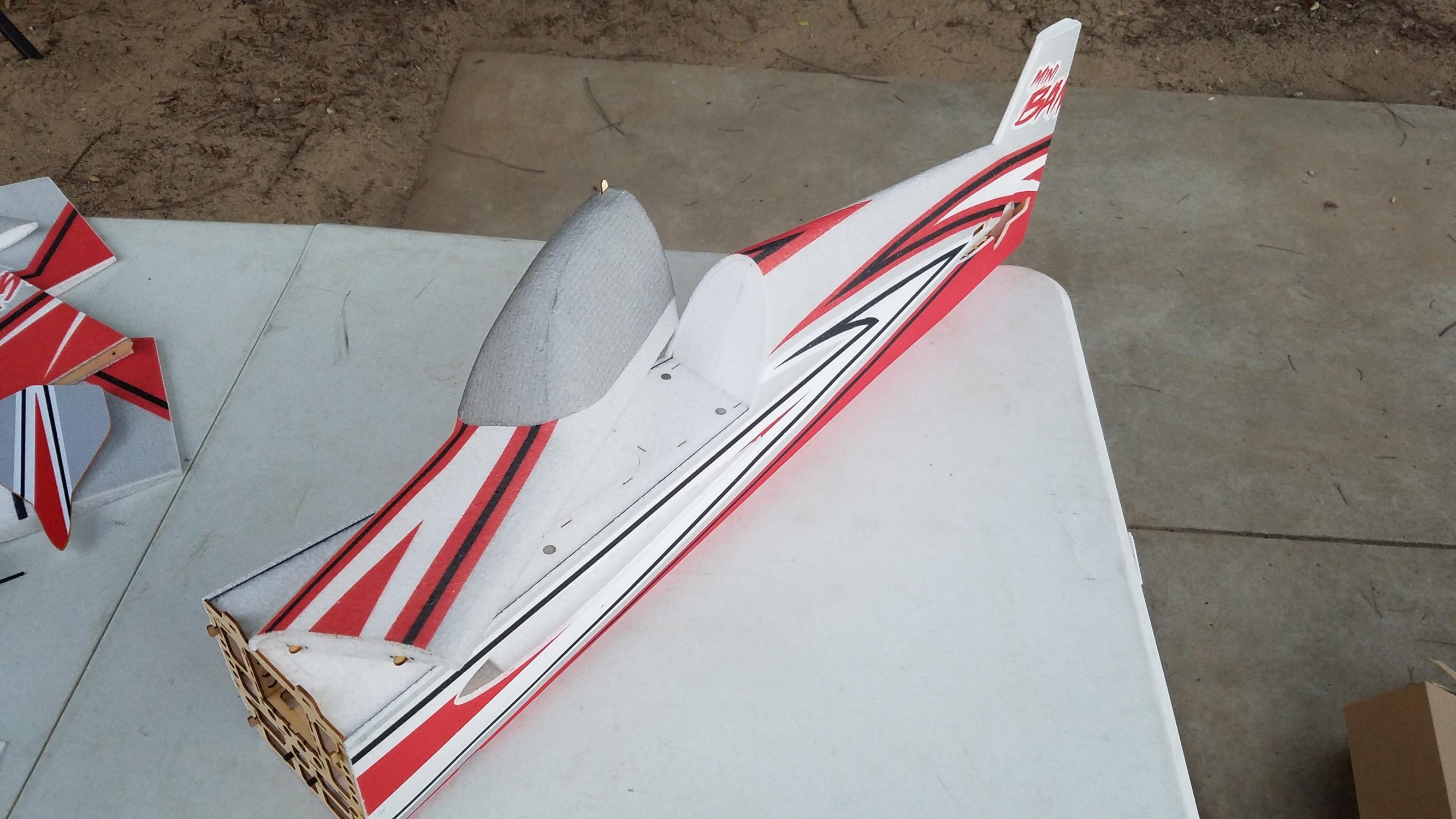

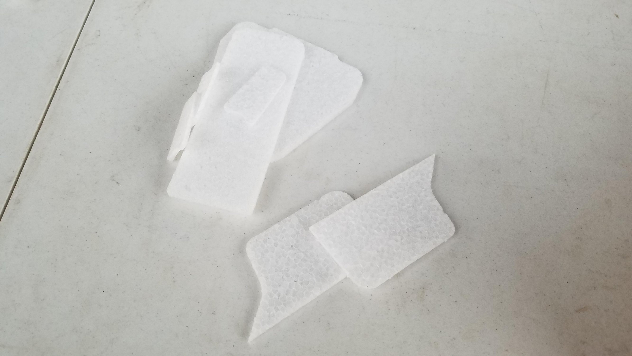

The very first part of the actual assembly is to punch out some of the excess EPP from the fuselage and cowl (they will punch out by hand easily enough, if you would like you can use a hobby knife to do this process). The excess is there to help factory workers assemble the parts as well as to help stiffen everything up for shipping. They are not needed otherwise and actually prevent you from installing your electronics so go ahead and remove them. They just punch right out.

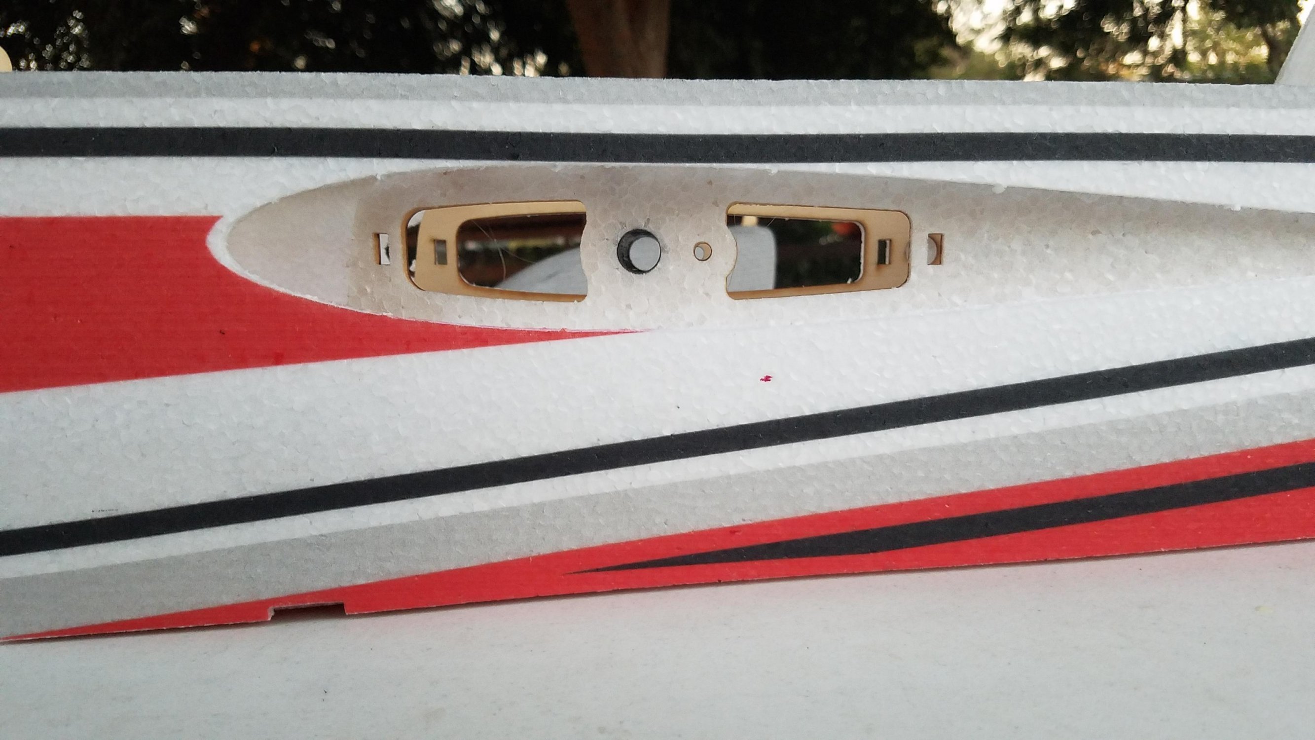

In total, there are 8 pieces that need to be removed from the fuselage.
Don't forget the 4 down here (2 on each side).
When you're done, you will have a small pile of scrap EPP. I advise keeping it incase you need to patch a hole or make repairs down the road.

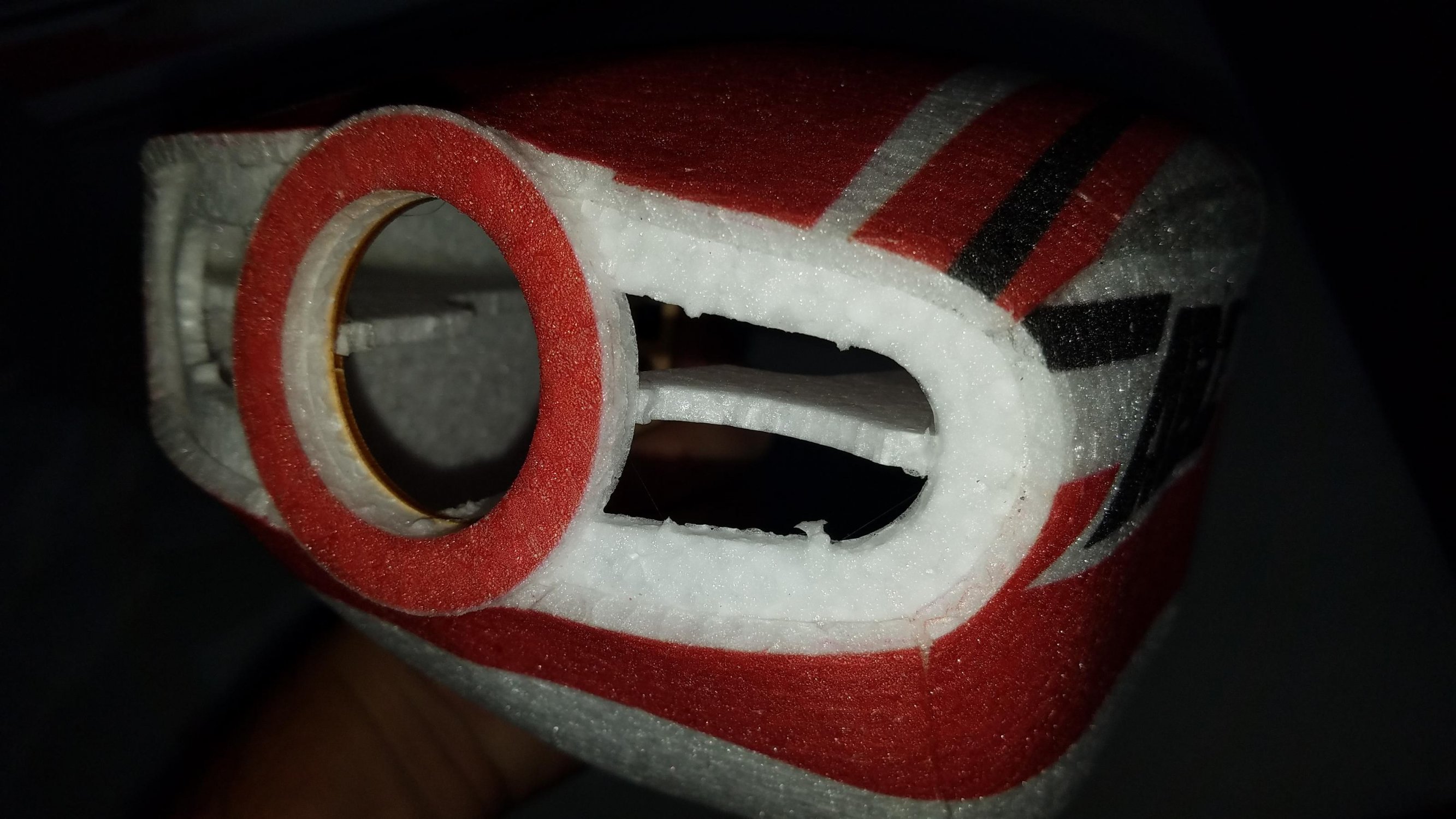

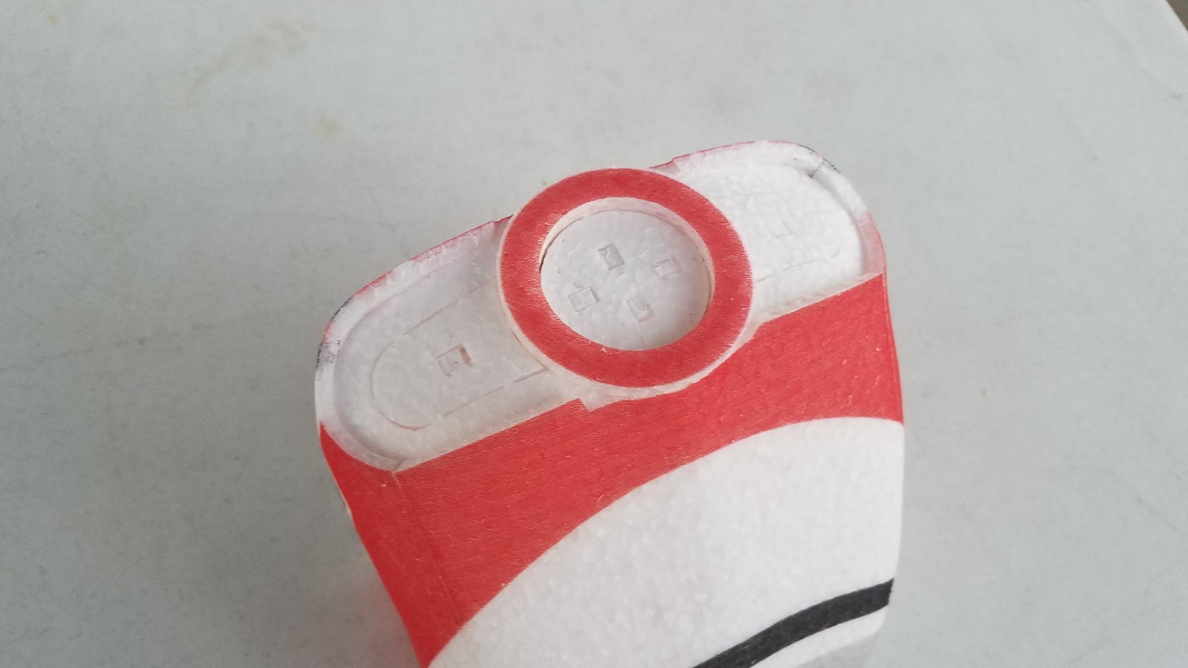

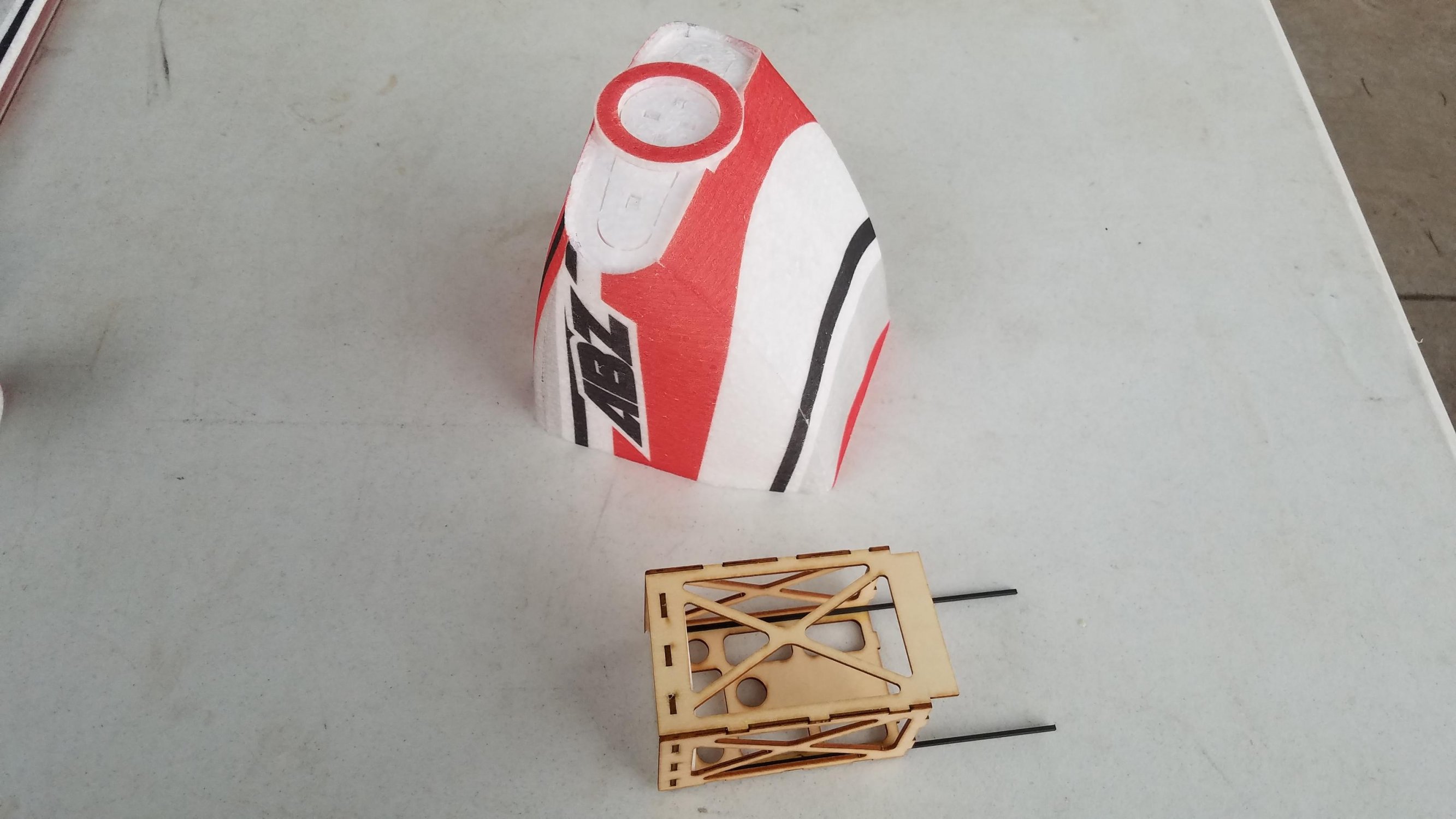

The cowl needs the same treatment.

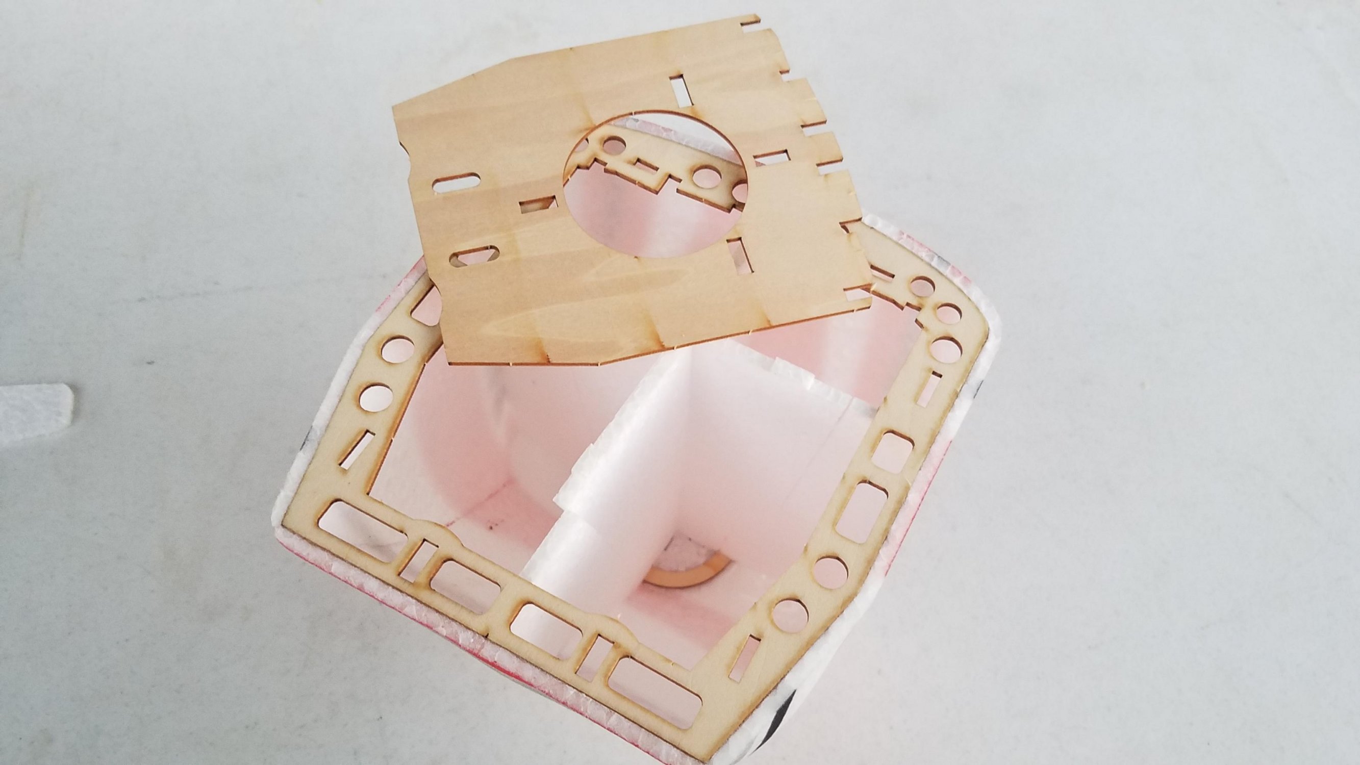

This plywood plate also needs to be removed from the cowl.

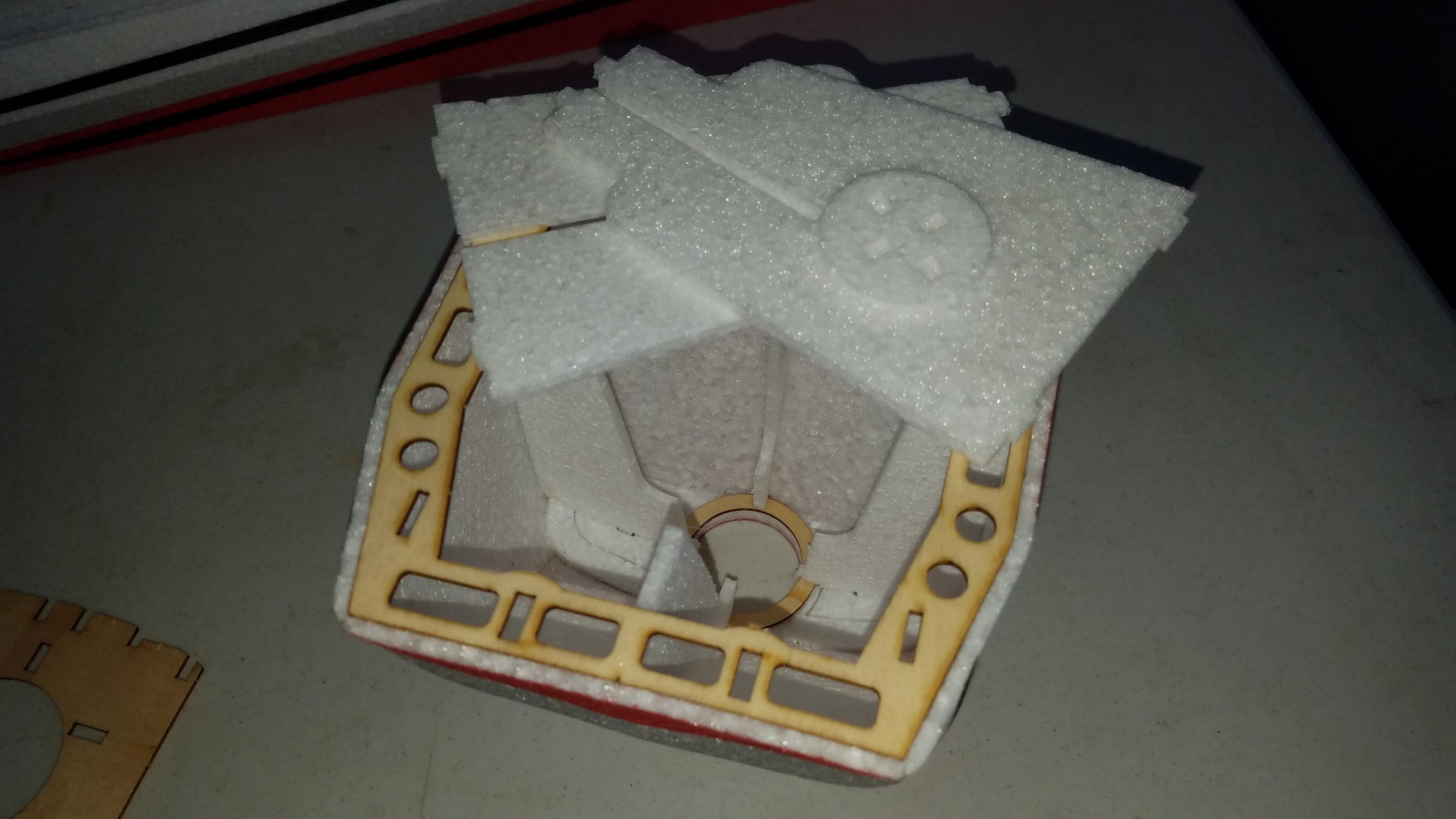

Punch out the internal structure- USE CAUTION here, not all of the internal structure is removed, only the center sections! There will be cutouts that you can feel. It should look exactly like the following picture:
Once you remove the punchouts from inside, you will also have to remove the center hole and air intake punchouts as well.
Save all of the scrap pieces, you can use them for repairs or to make baffling in the cowl to direct airflow over electronics.

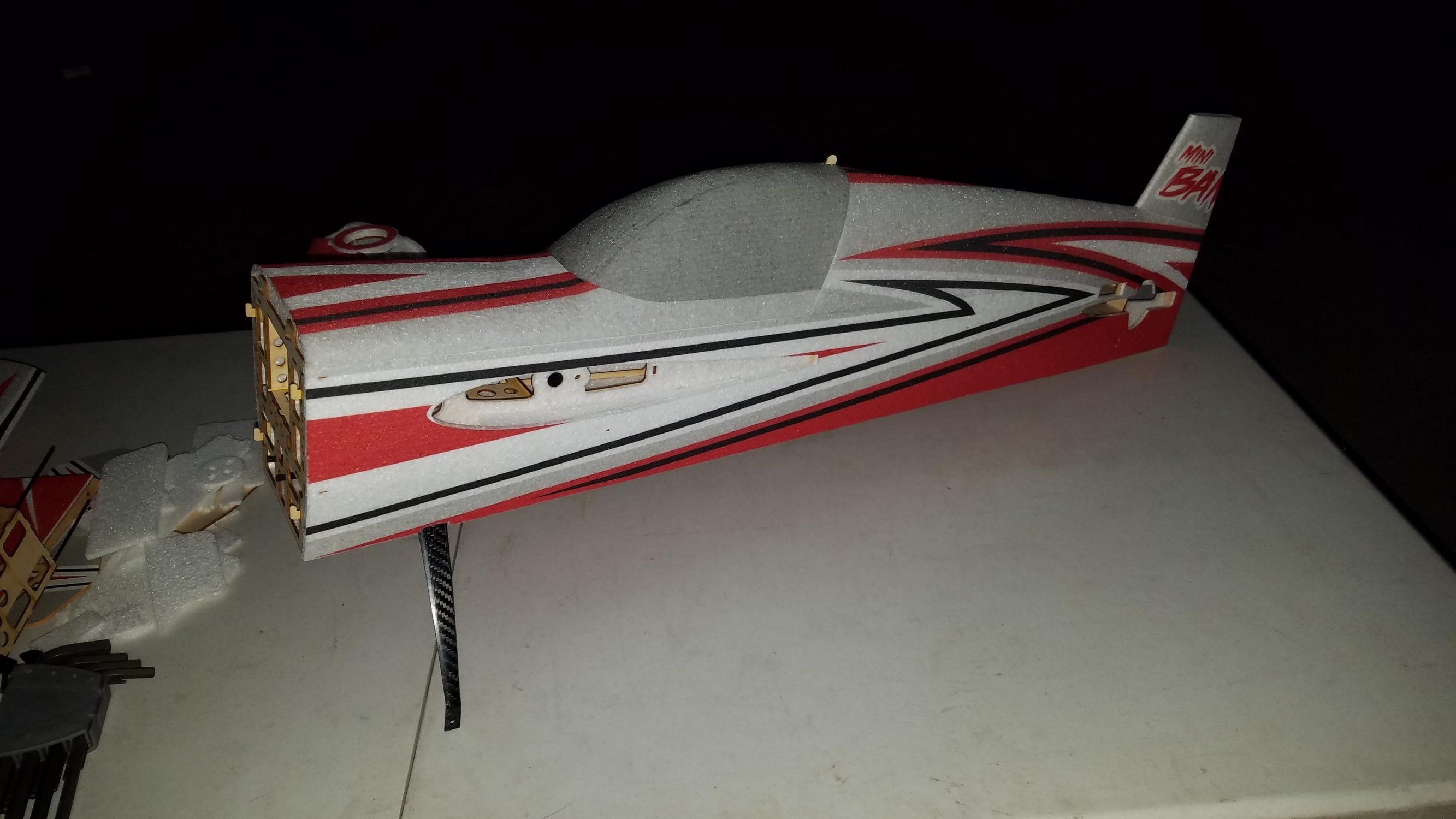

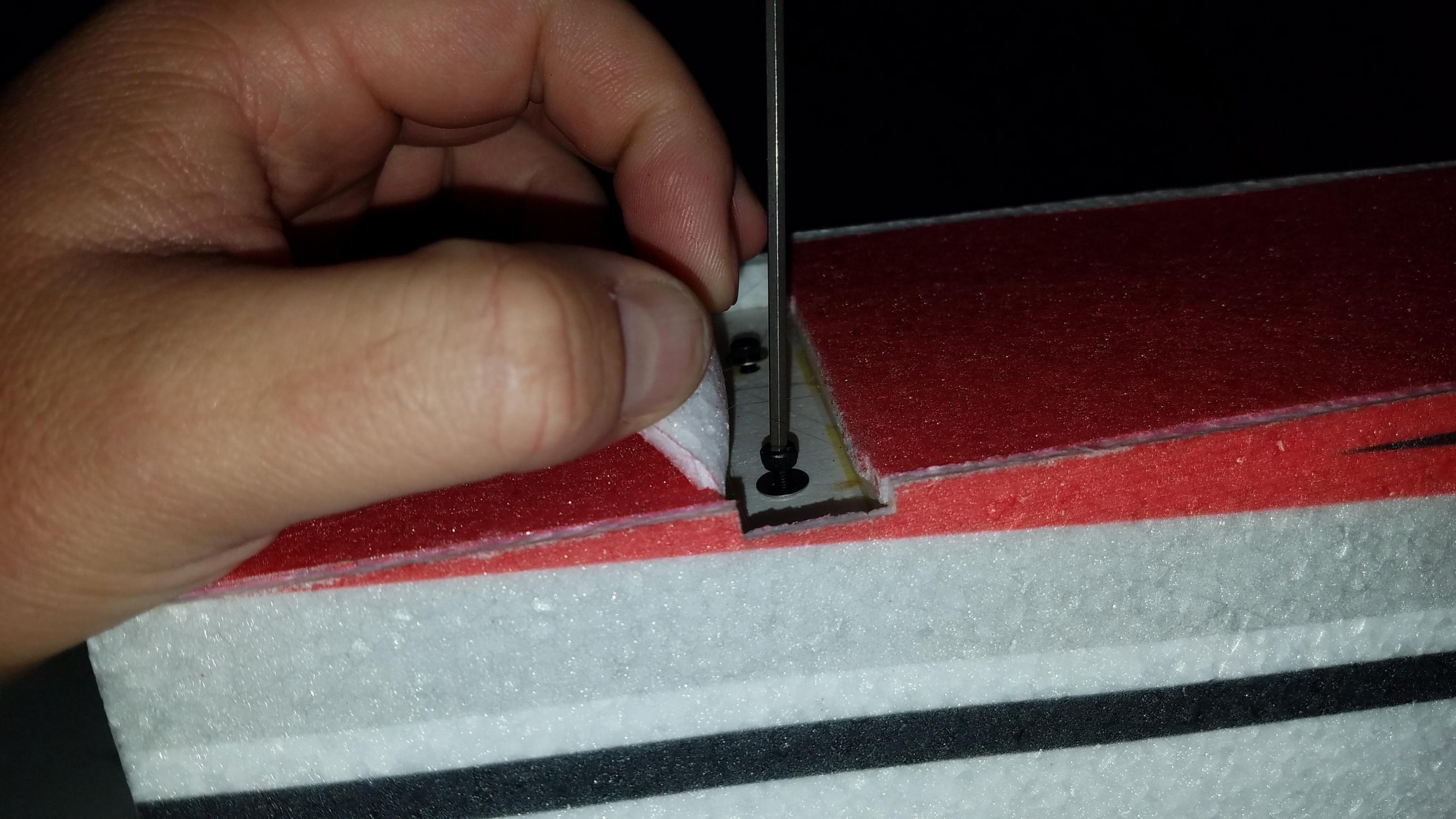

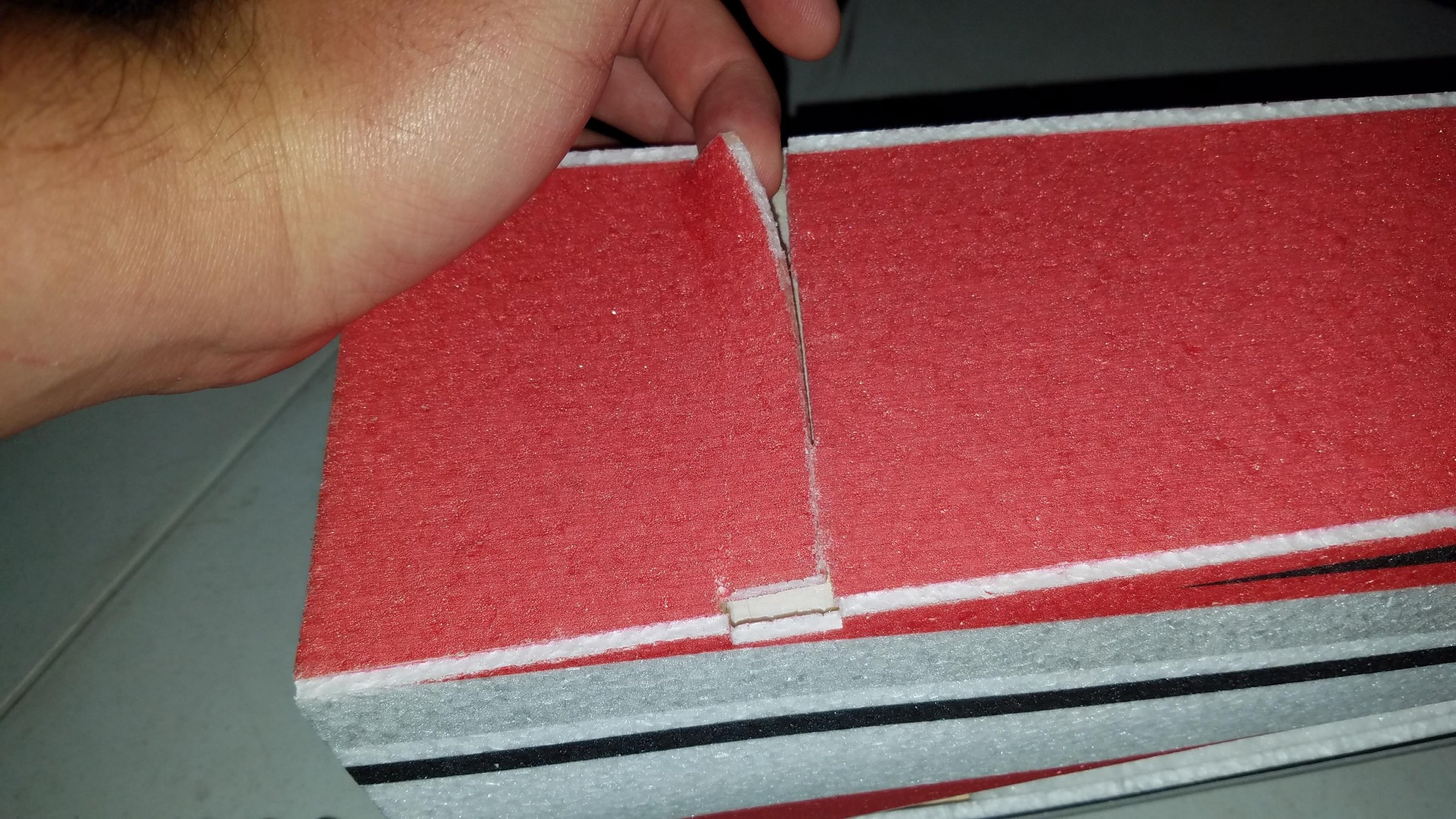

Okay onto assembly. The first step here is to slip the fuselage over so it's on its back (you may want to use an airplane stand of sorts) so we can work on the landing gear mount. The fuselage has a small slot cut already, you will need to finish cutting the slot open. Cut only one side to give it a cleaner appearance.

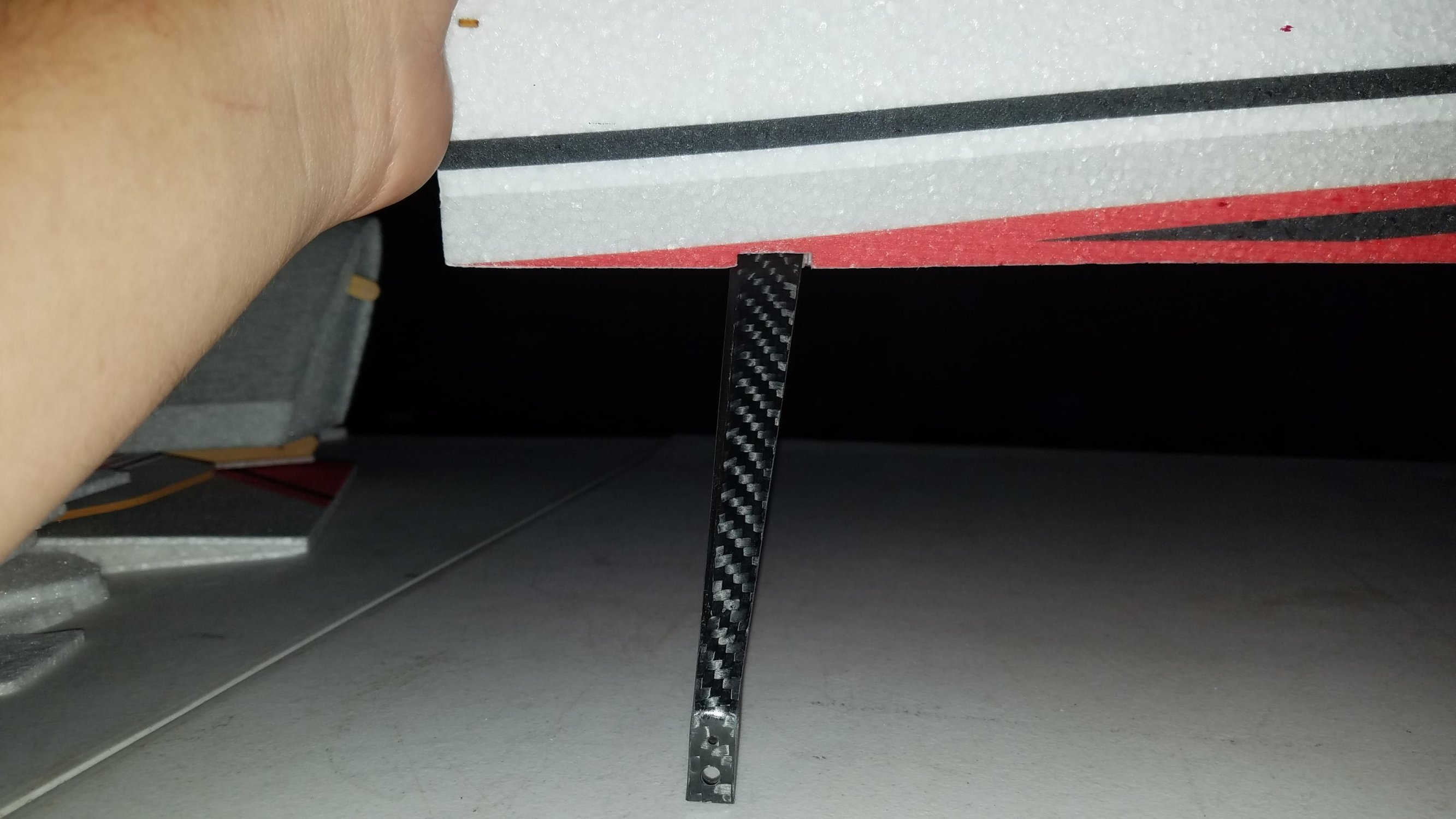

Fold this flap back and you will find 2 allen head bolts already fitted in place underneath. These are the 2 bolts that secure the main gear legs to the fuselage. Remove them, and then slide in your CF main landing gear legs. Once the gear is in, reinstall the bolts and tighten them down. You can use a small drop of blue threadlocker here if you would like to ensure the bolts don't back out.
Pay close attention here, the gear legs have a forward swept motion to them. Make sure this sweep is actually towards the front of the fuselage, otherwise you will run into ground handling issues.
