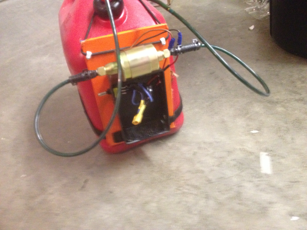

ImageUploadedByTapatalk1393724801.328175.jpg old pump broke ordered this 15 dollar pump off eBay and man she pumps fast

That price says free shipping, not bad. Is there any metal between the 1/4 short gas line and the tygon tube?
no there is a little screw in Nipple that the black line fits over and the opening in it the tygon will slide right in it,, so what I did was Slide the tygon in, then cover the nipple with Seal All and then slide over the 1/4 fuel line and place the clamps on and it works perfect

I just bit and bought one, one question though. Will this pump also empty the tank, or is it fill only?
it will empty the tank also.. but it will only run one way.. and I like it this way cause you never back wash your Filter. so here is how you do it.. where you tygon comes out of the can... you need to make a splice here. When it is time to defuel. You undo the splice and hook it up to the plane. Leave the fuel line that you would have used to fill the Tank. in the Cap of the fuel can and it will put the fuel back in the can
