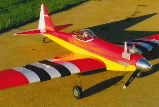

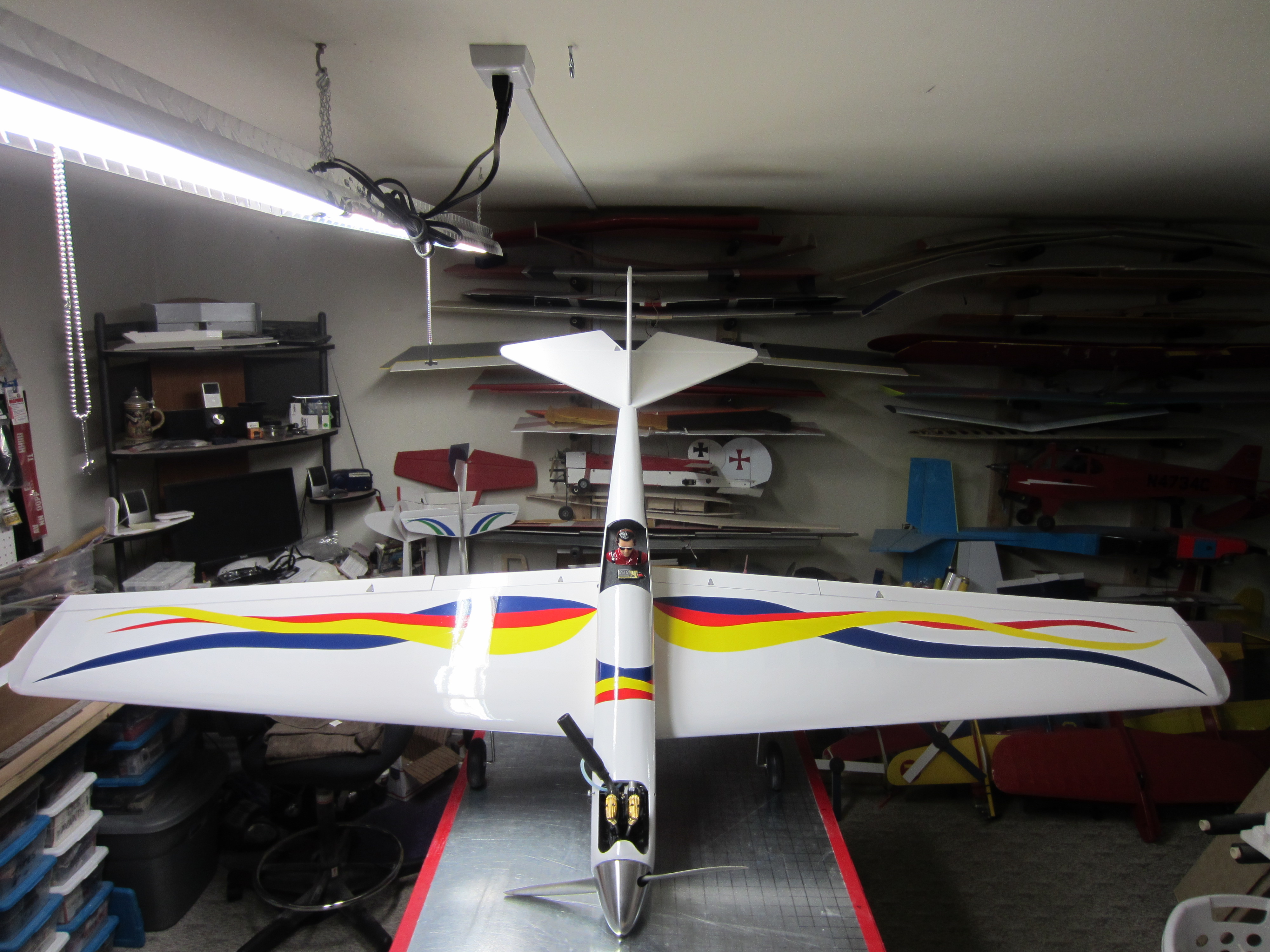

Following the commentof Snoopy, i think you should look for a more stable platform that fits the parameters.
I would suggest the Cloud dancer 120, it's stable and nice to fly while making all the loops and rolls you need.
