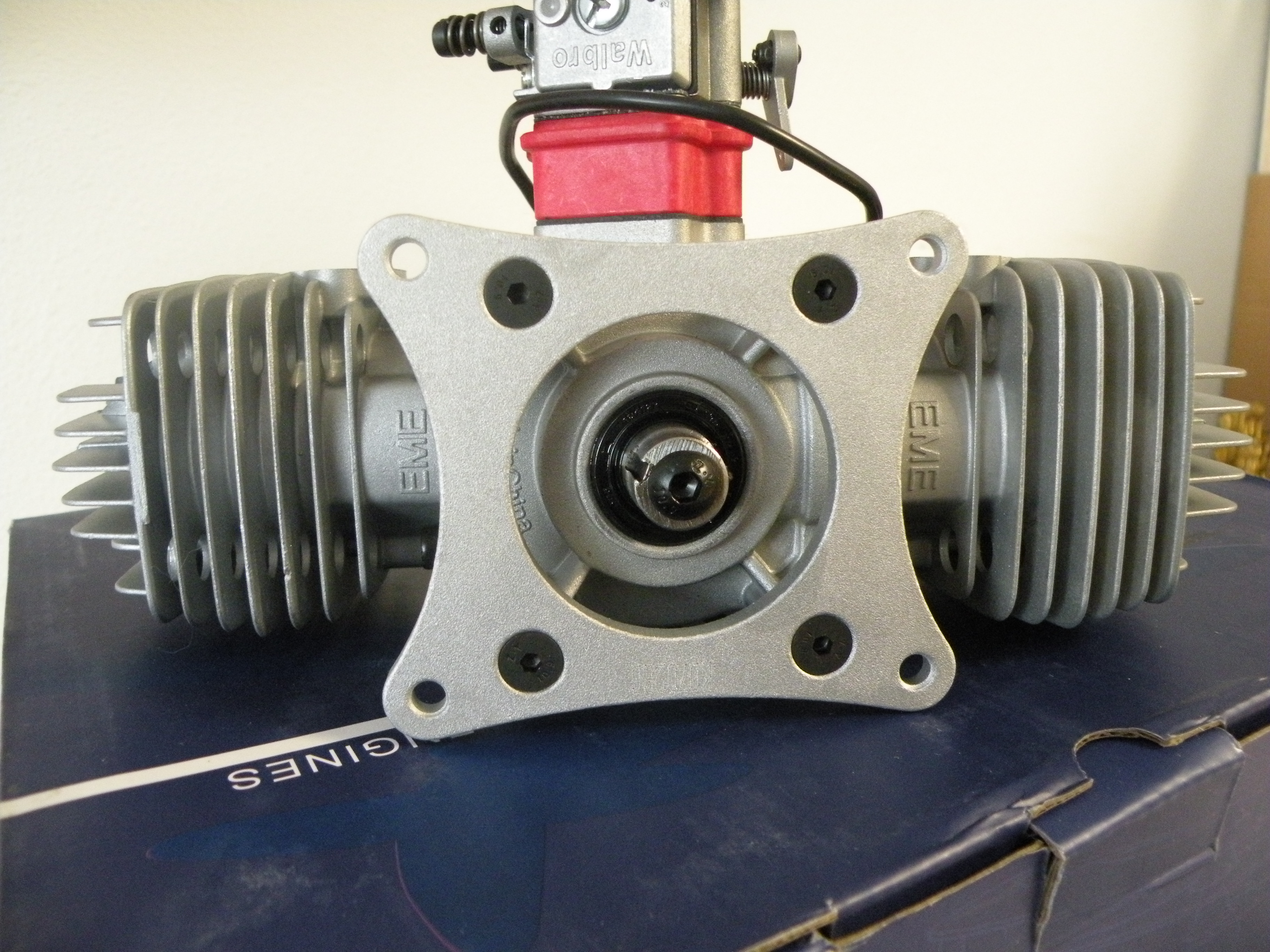

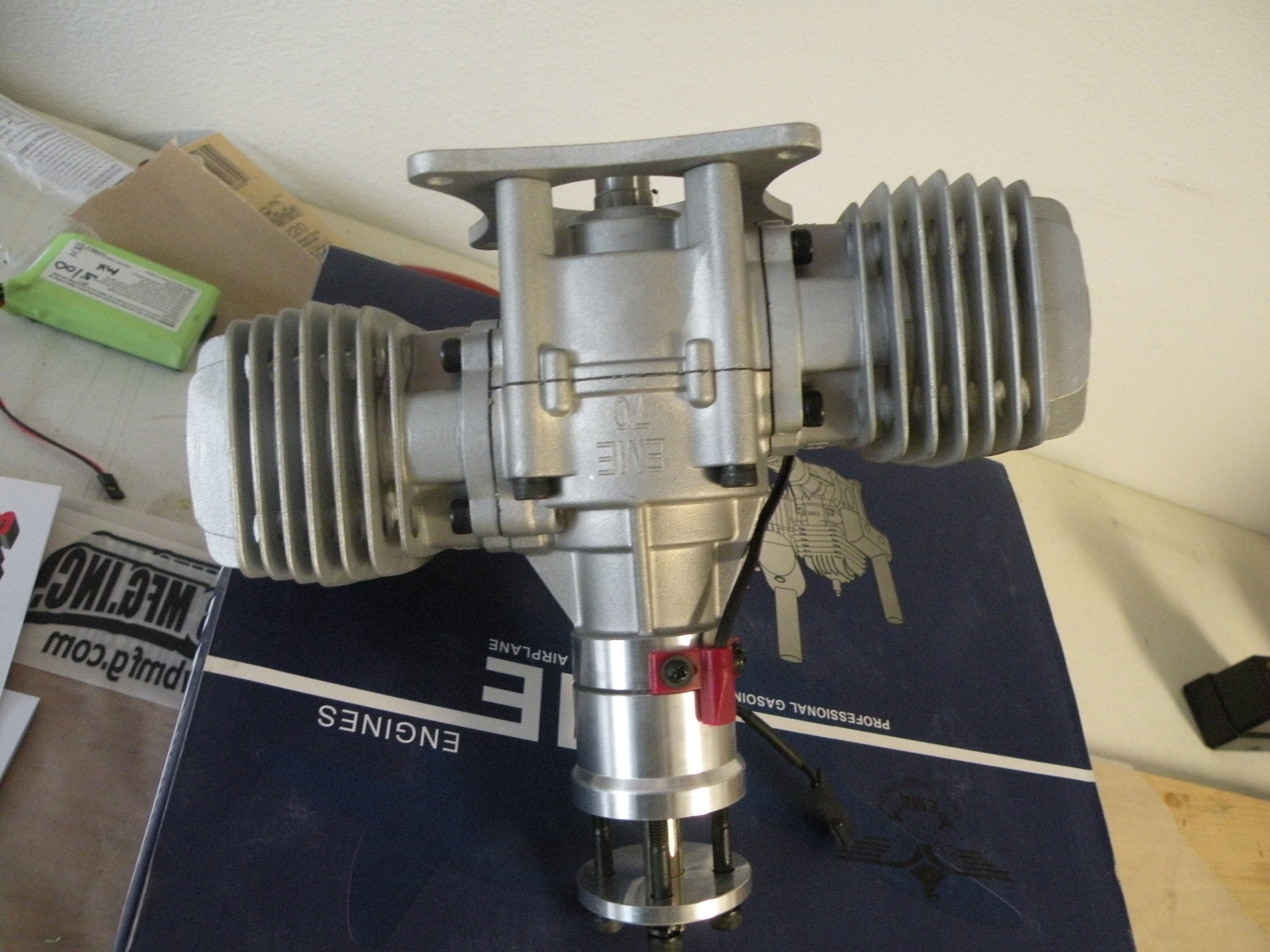

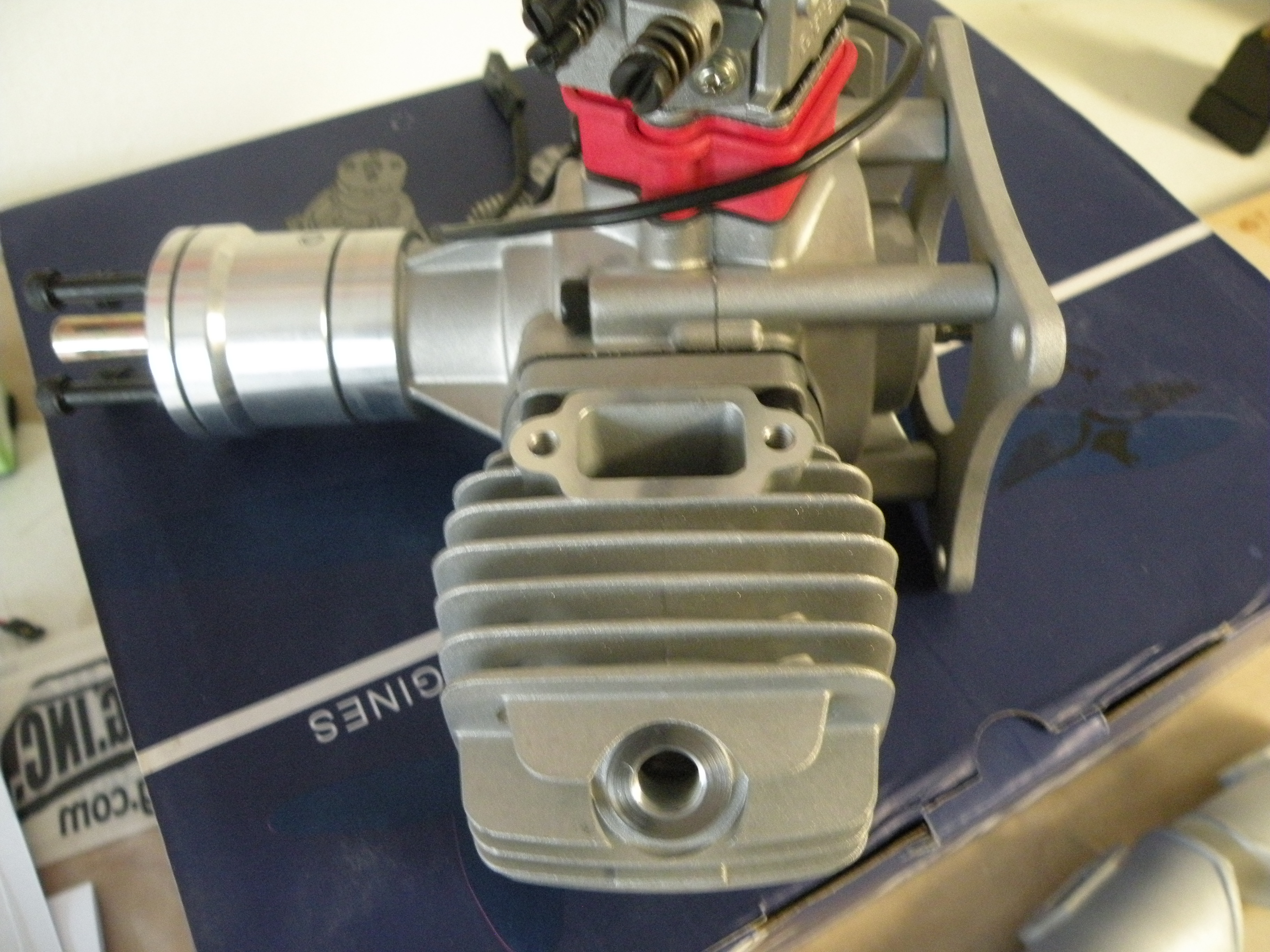

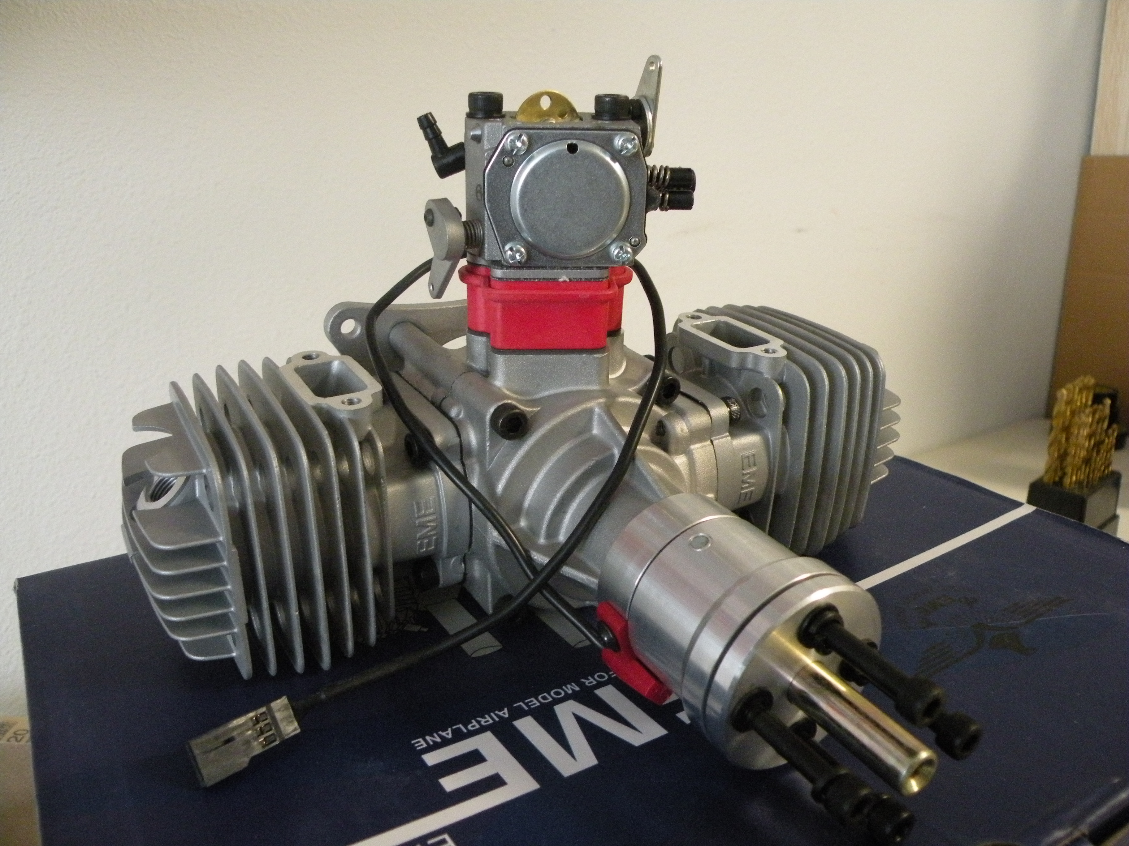

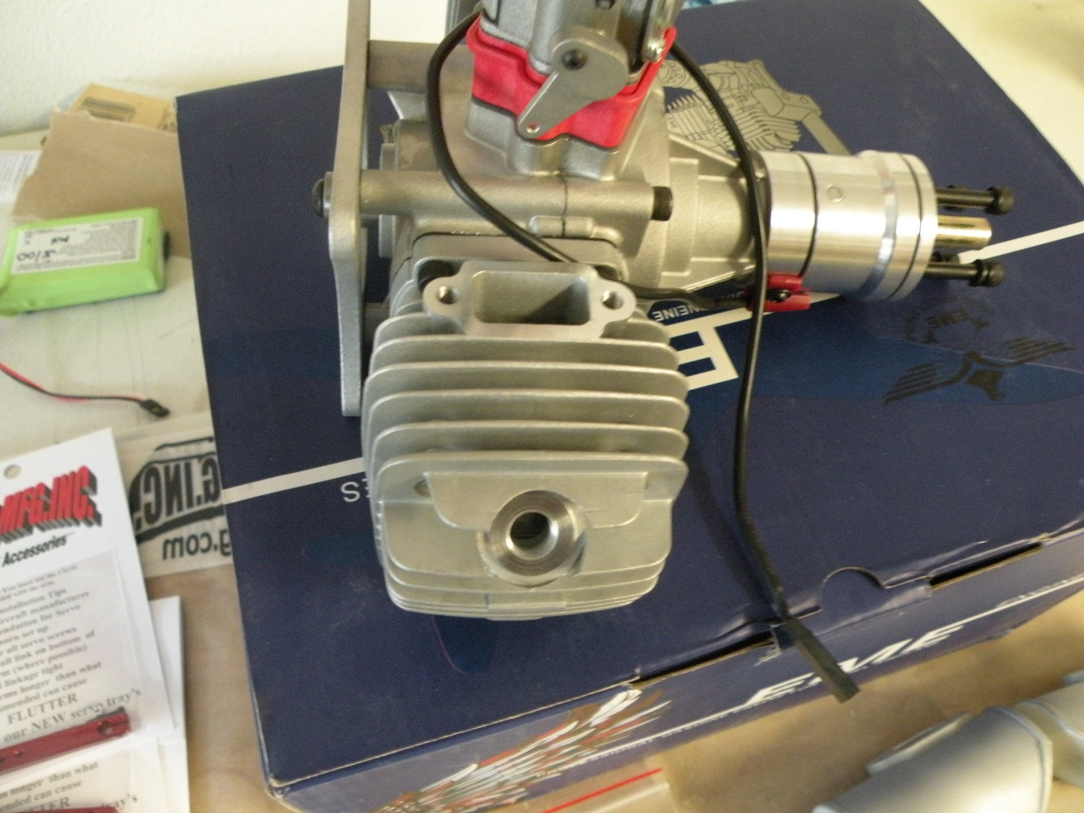

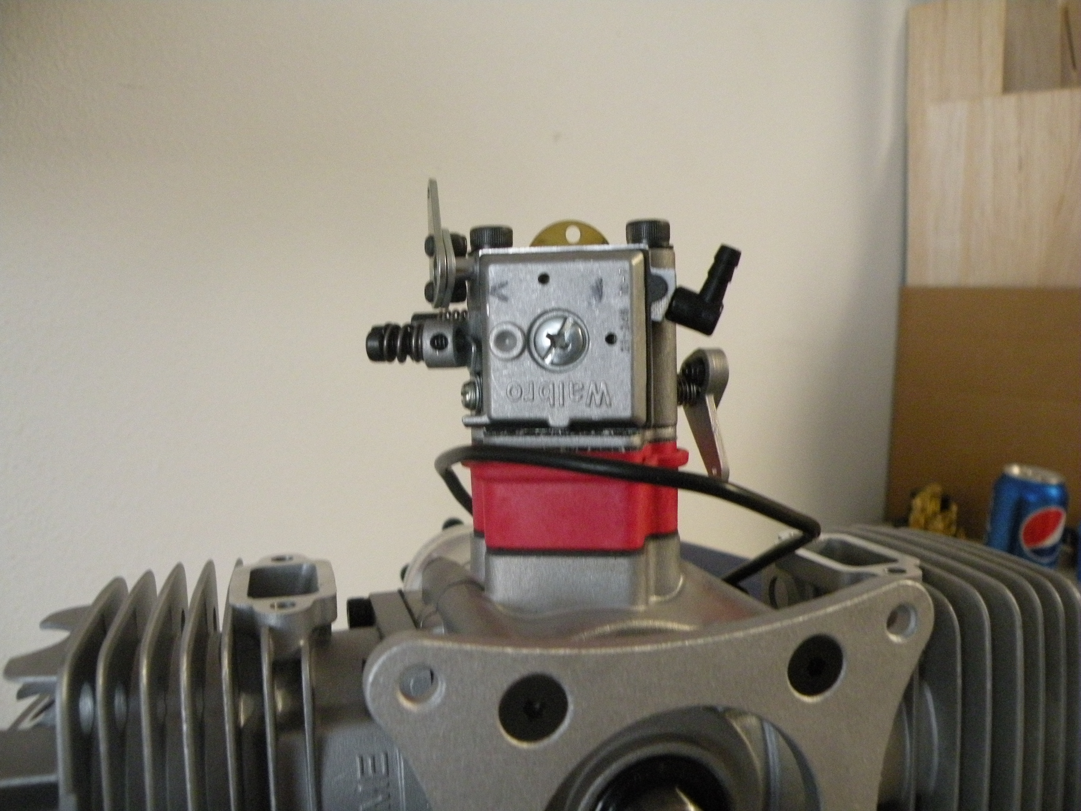

    So here are the pictures I took of the engine before mounting

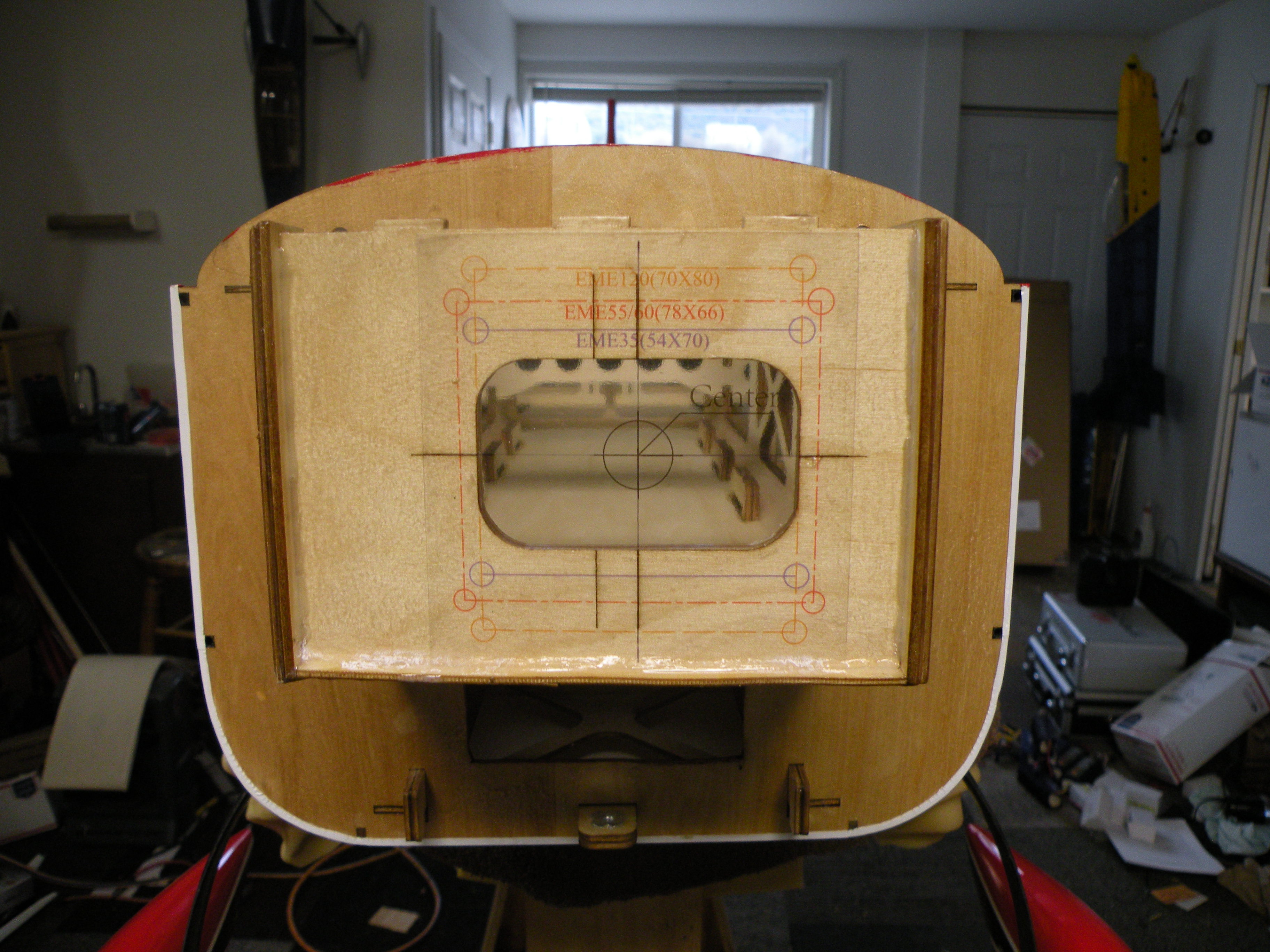

    The EME engine comes with a stick on template that had a circle and cross hair for proper alignment on the firewall, I took a ruler and extended the cross hairs to run the length and width of the template which made it much easier to get proper alignment, I stuck on the template decal and drilled the proper holes and they lined up perfectly. With the EME 70cc engine were included 13mm spacers (approx. 1/2"). Those proved to be too much and I found that it took approx. 1/4" spacing to get proper clearance for the cowl. Here is a picture of the decal on my firewall ready for drilling

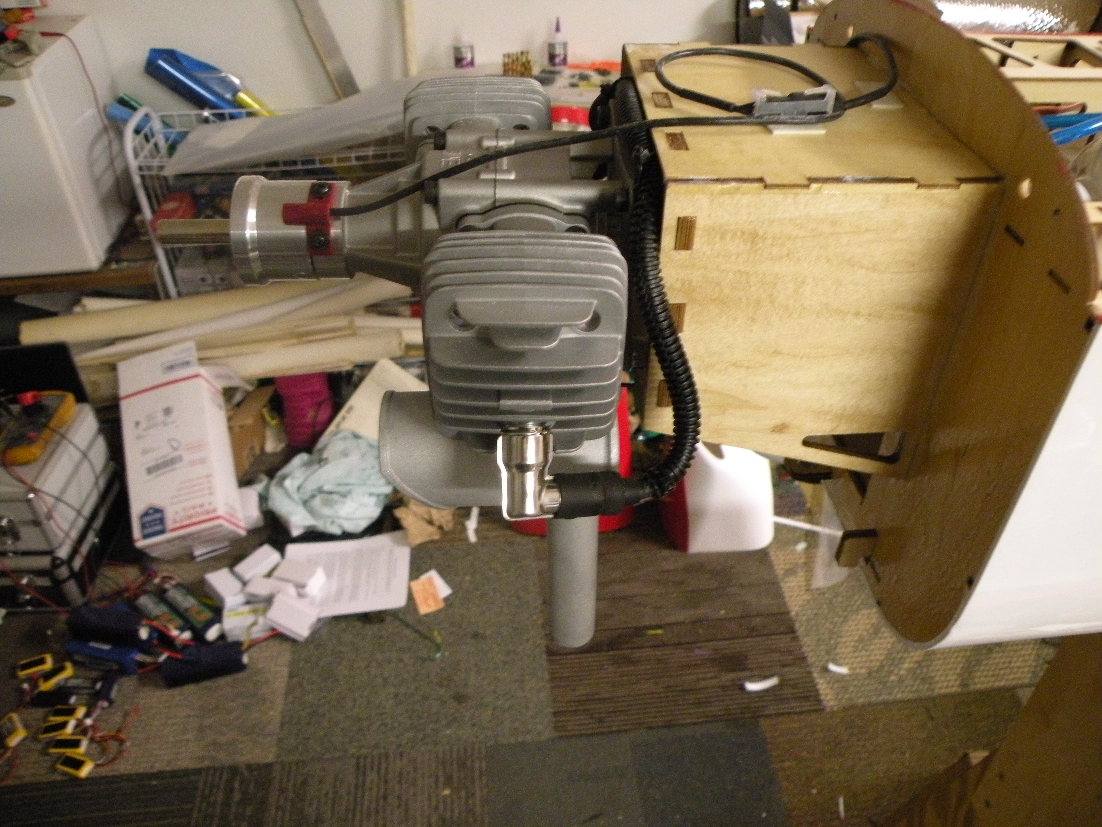

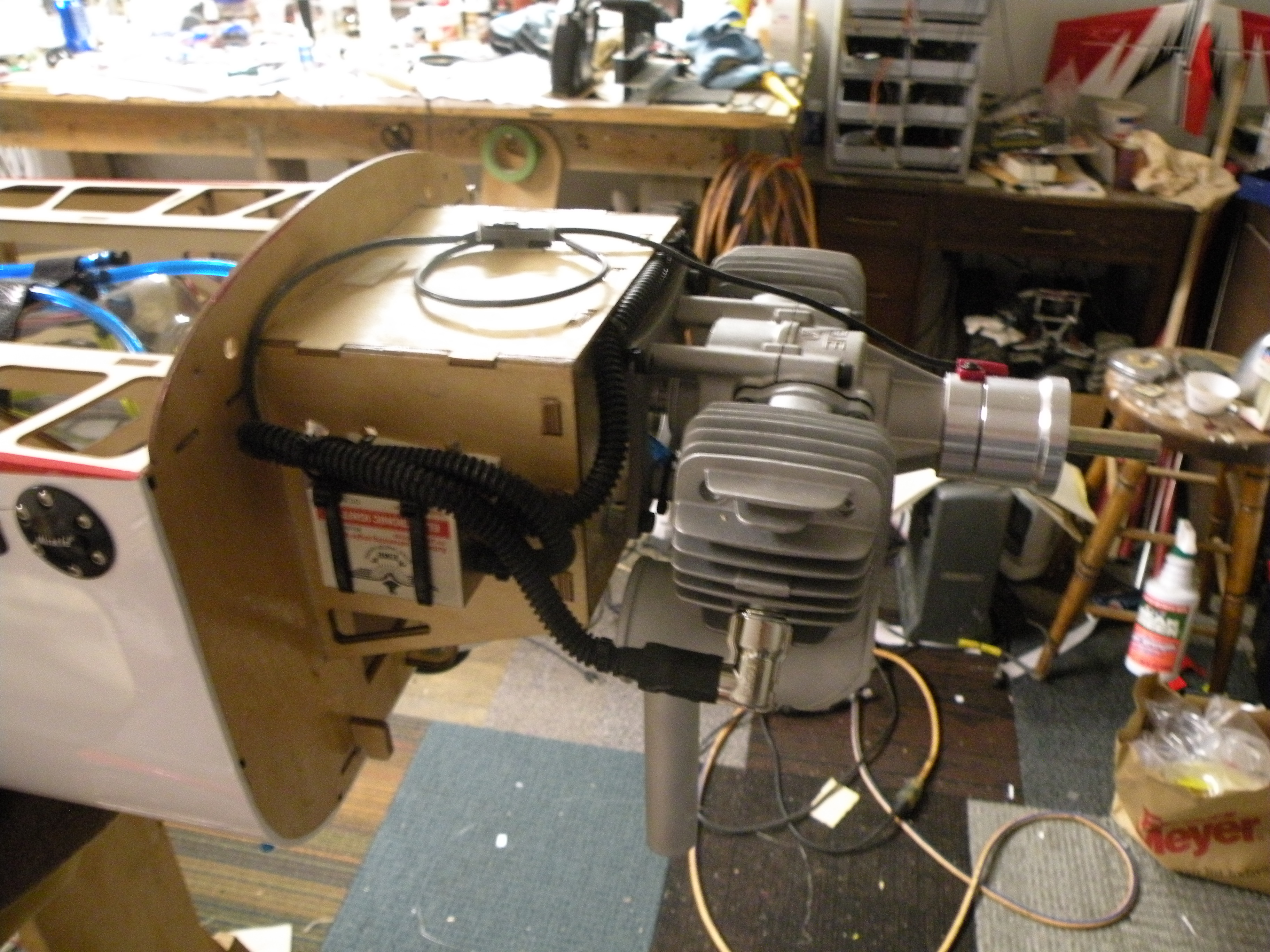

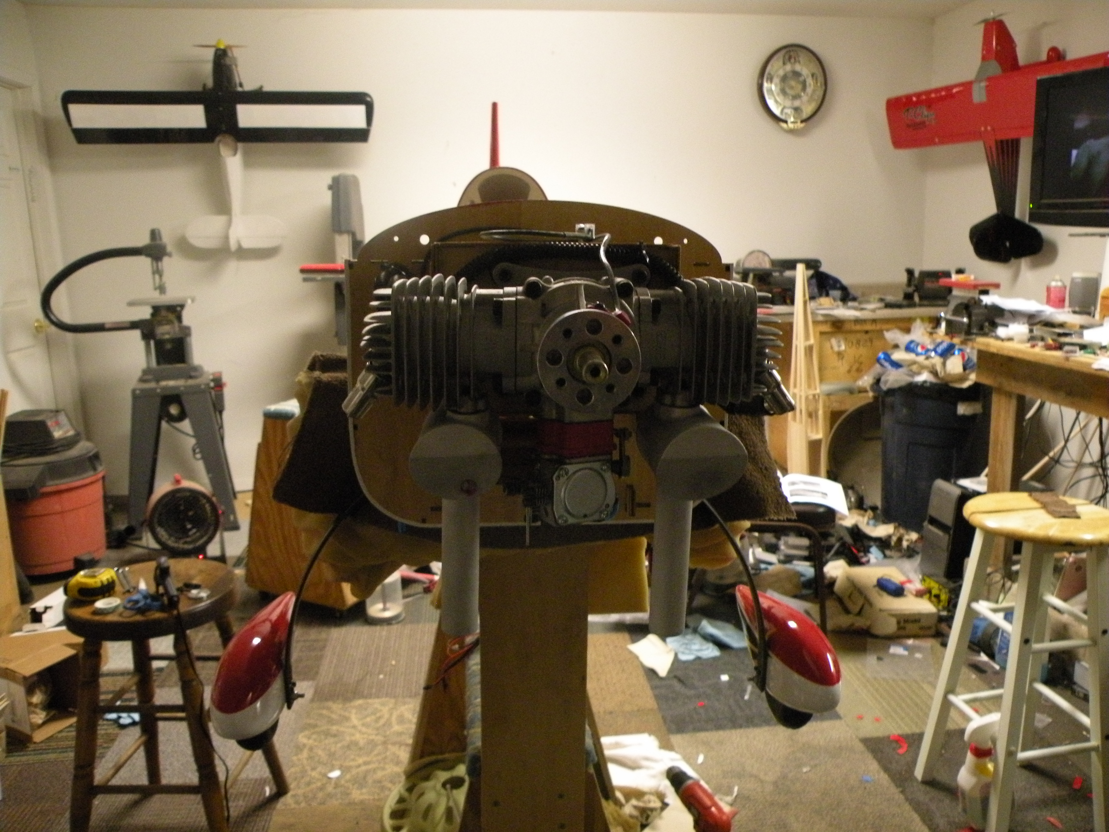

    Here is a few pictures of the engine mounted to the firewall

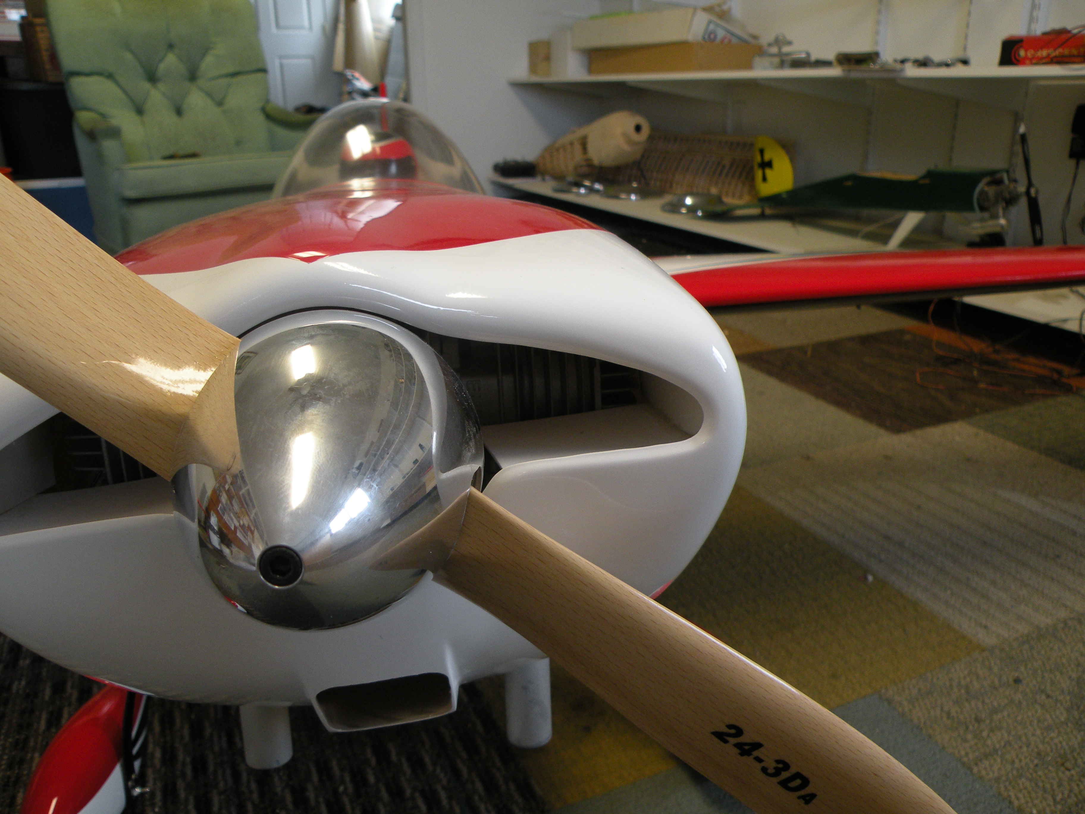

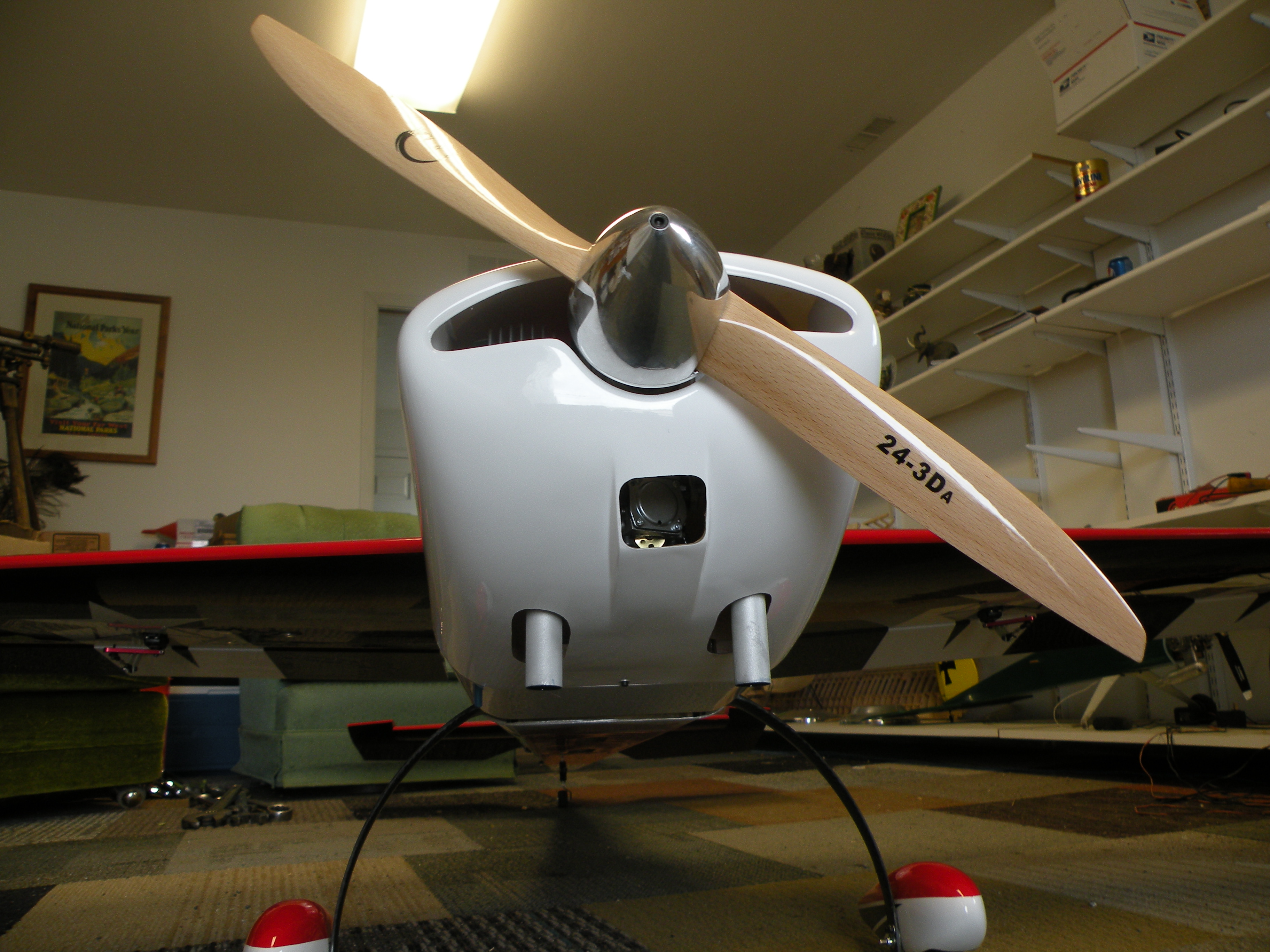

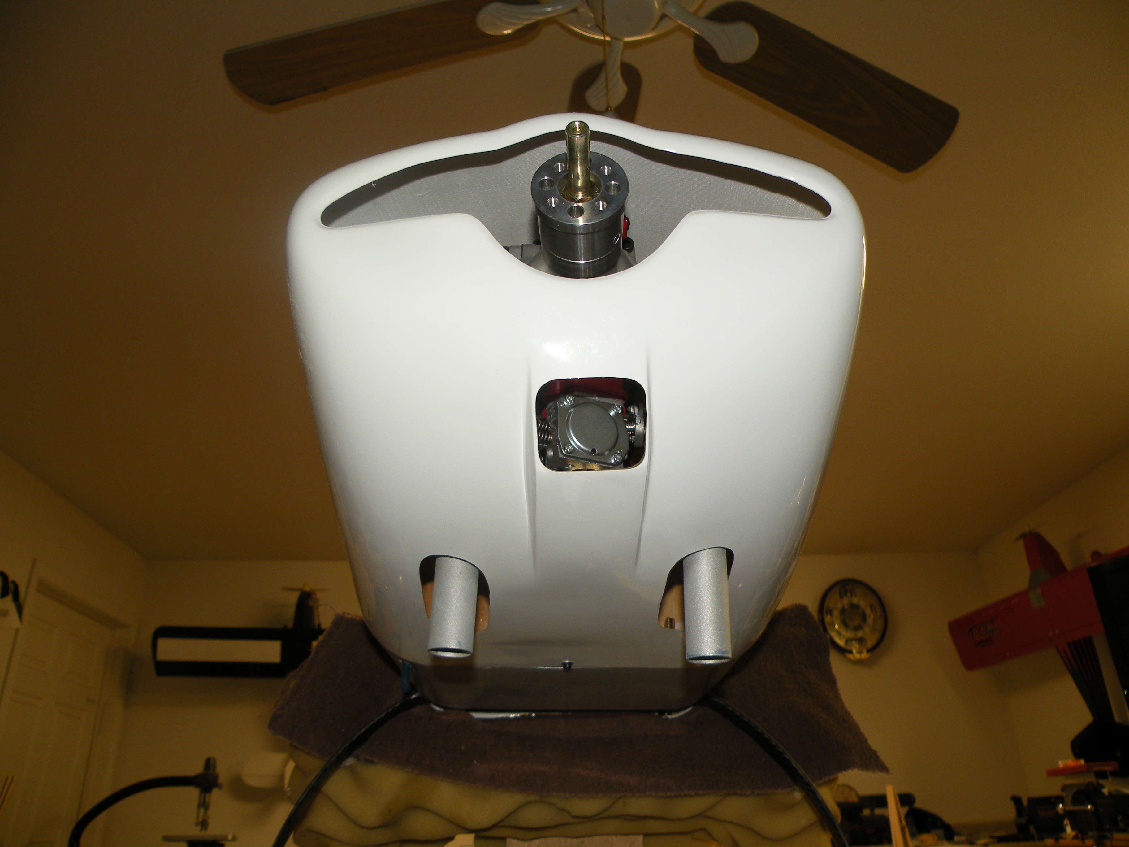

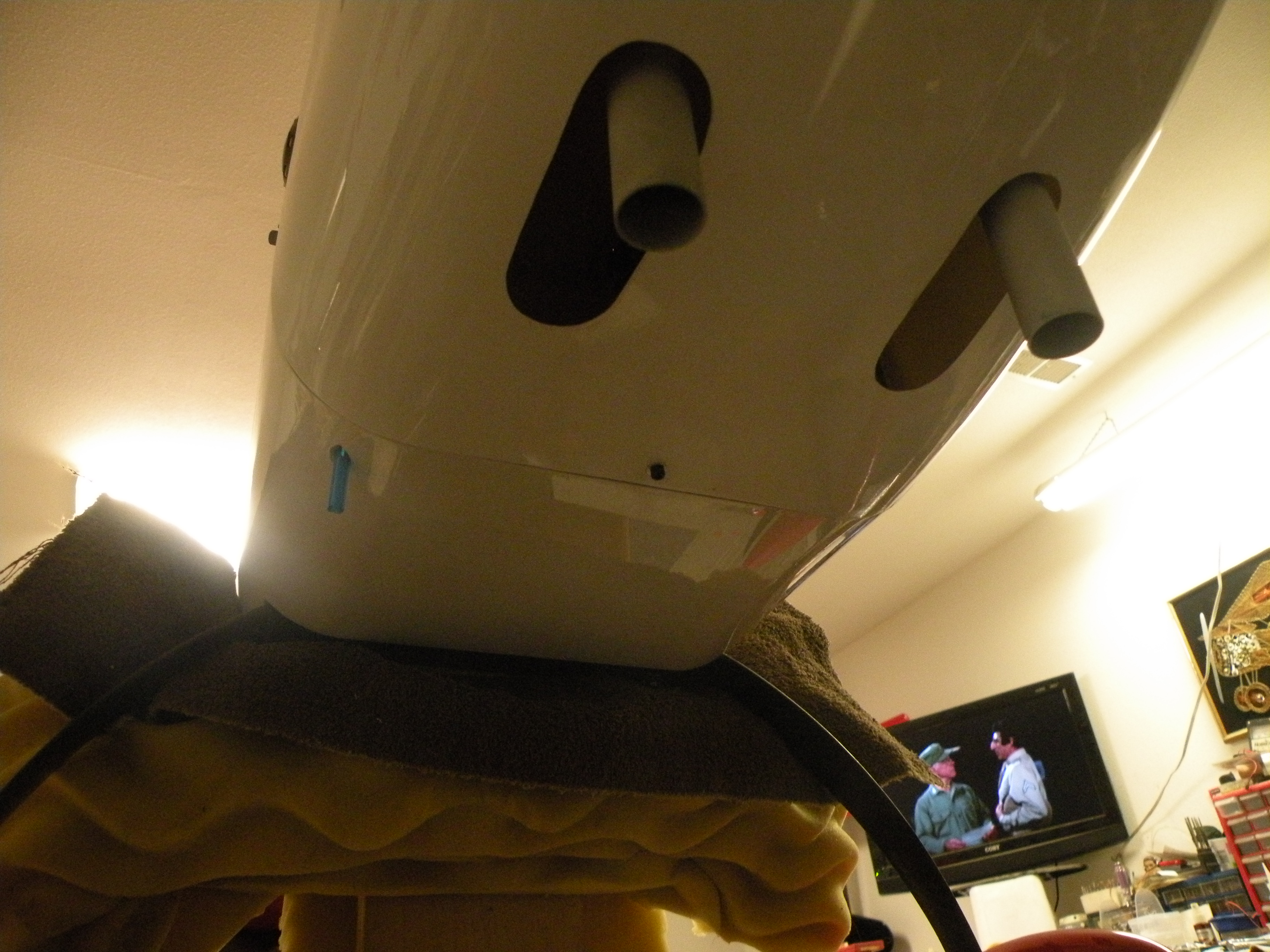

    Here are a few pictures of the engine with the cowl installed. I did make baffling out of some hobby foam from the local craft store. It glues into the cowl easily with CA and keeps the airflow over the cylinders. I have never had a heating issue with it this way.
    I did open up the canister tunnel and covers so I get airflow through the engine and still keep a nice clean look to the cowl.
