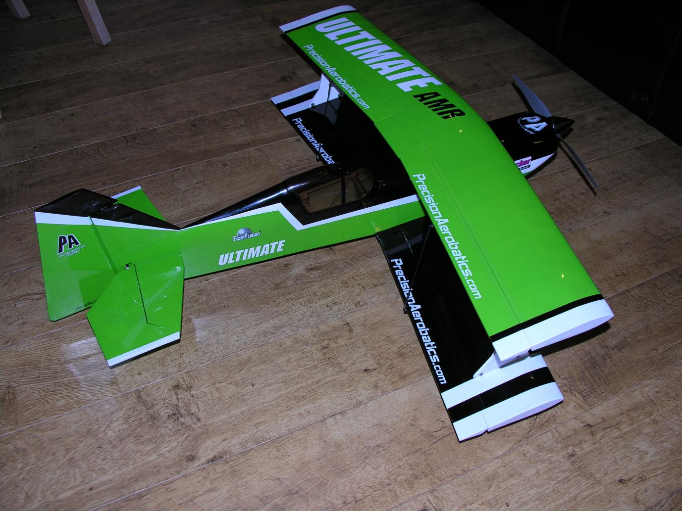

Here's mine when it was first build nearly two years back, it's been patched up a bit since but still looks just as good:

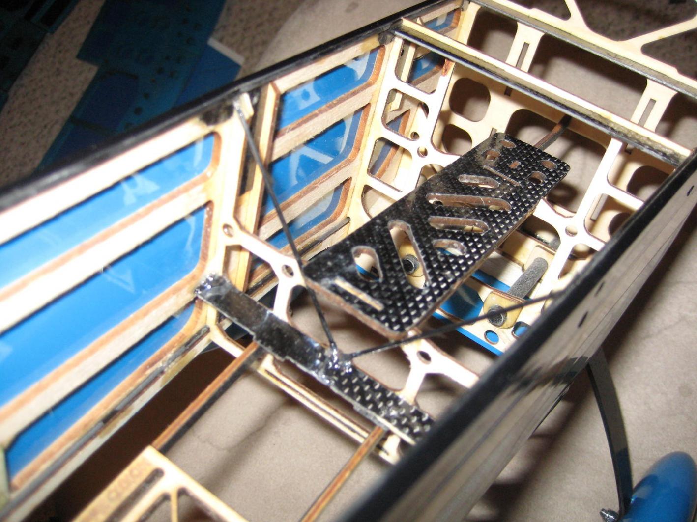

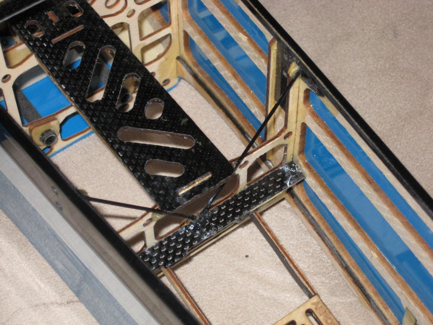

Next, I made some mods, so first, I modified the battery tray for easier access:bipe 9.jpgbipe 10.jpg

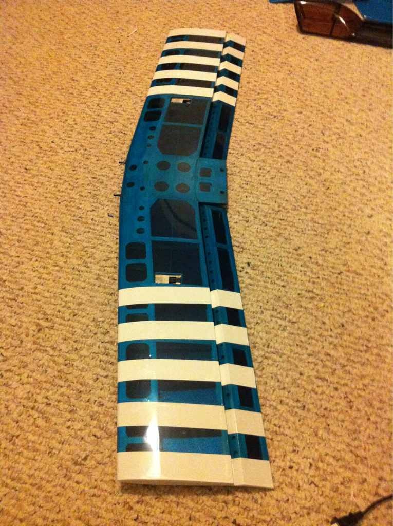

Then, I added more strips to the bottom for better visibility and orientation: bipe 7.jpg

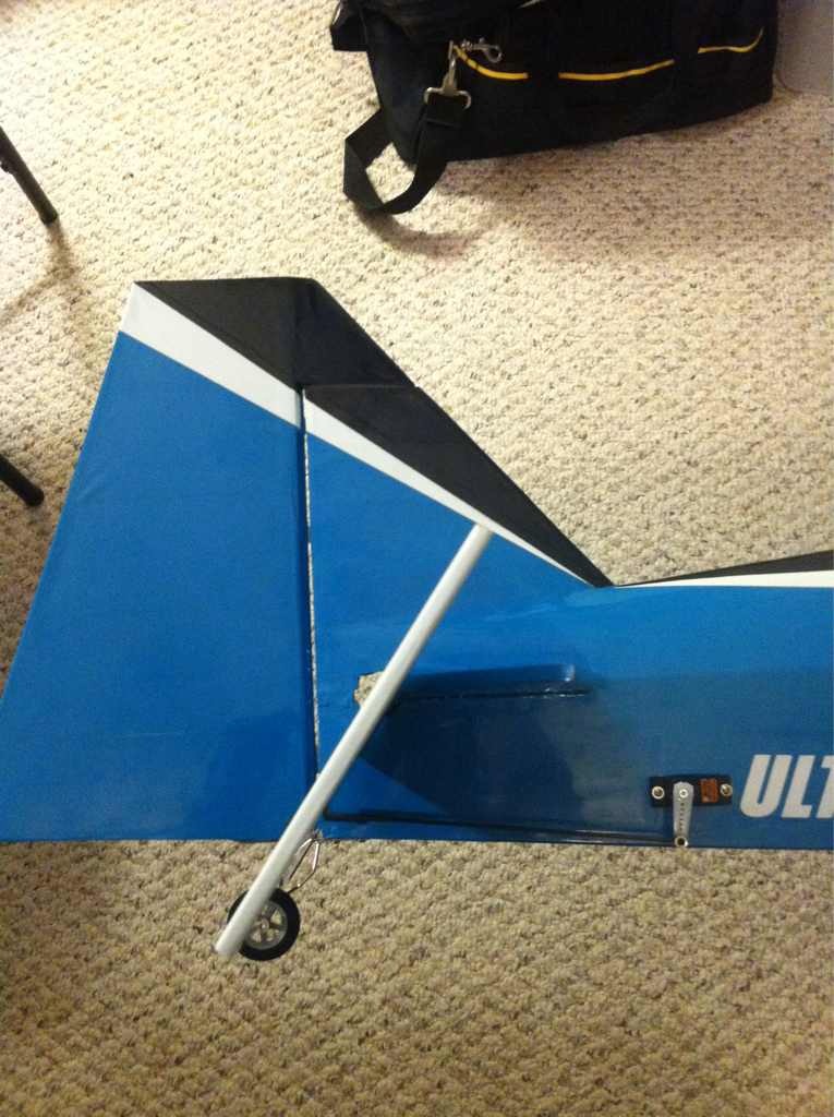

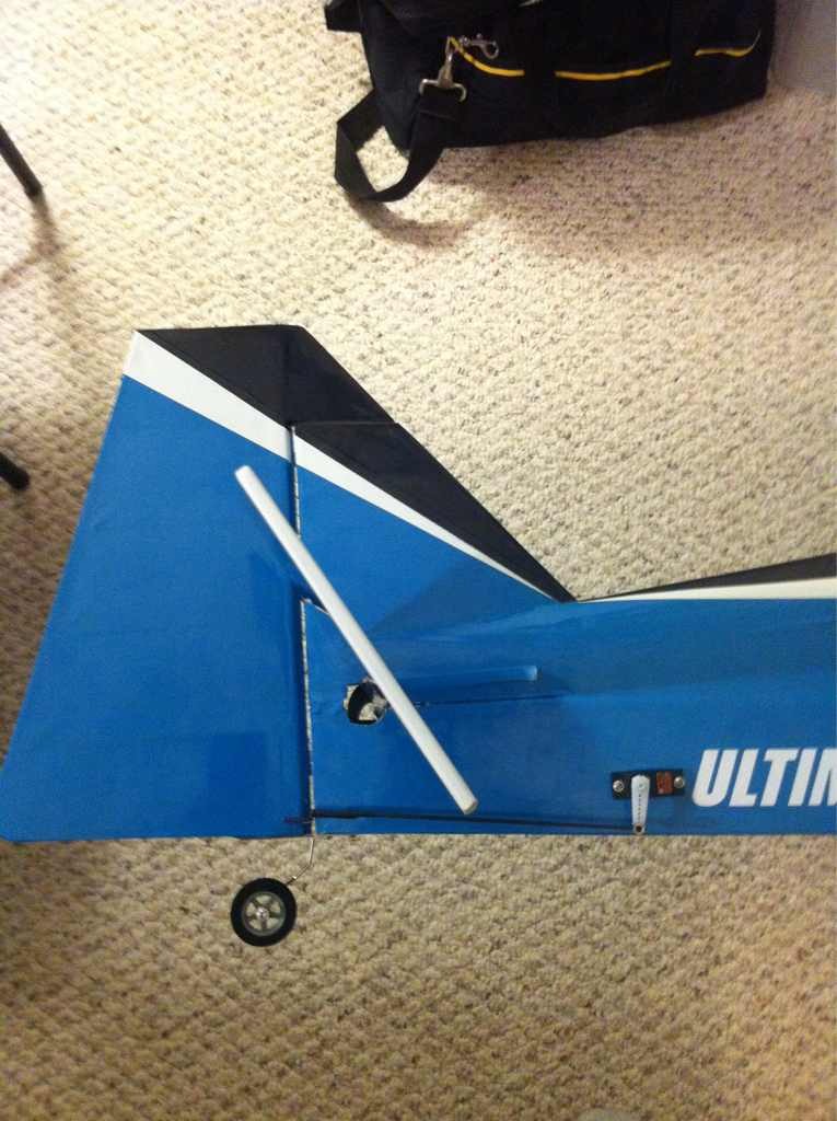

I also backed out my elevator a tiny bit, and shaved a little of the fuse around the elevator so I could get max deflection for tumbles: bipe 1.jpgbipe 3.jpg

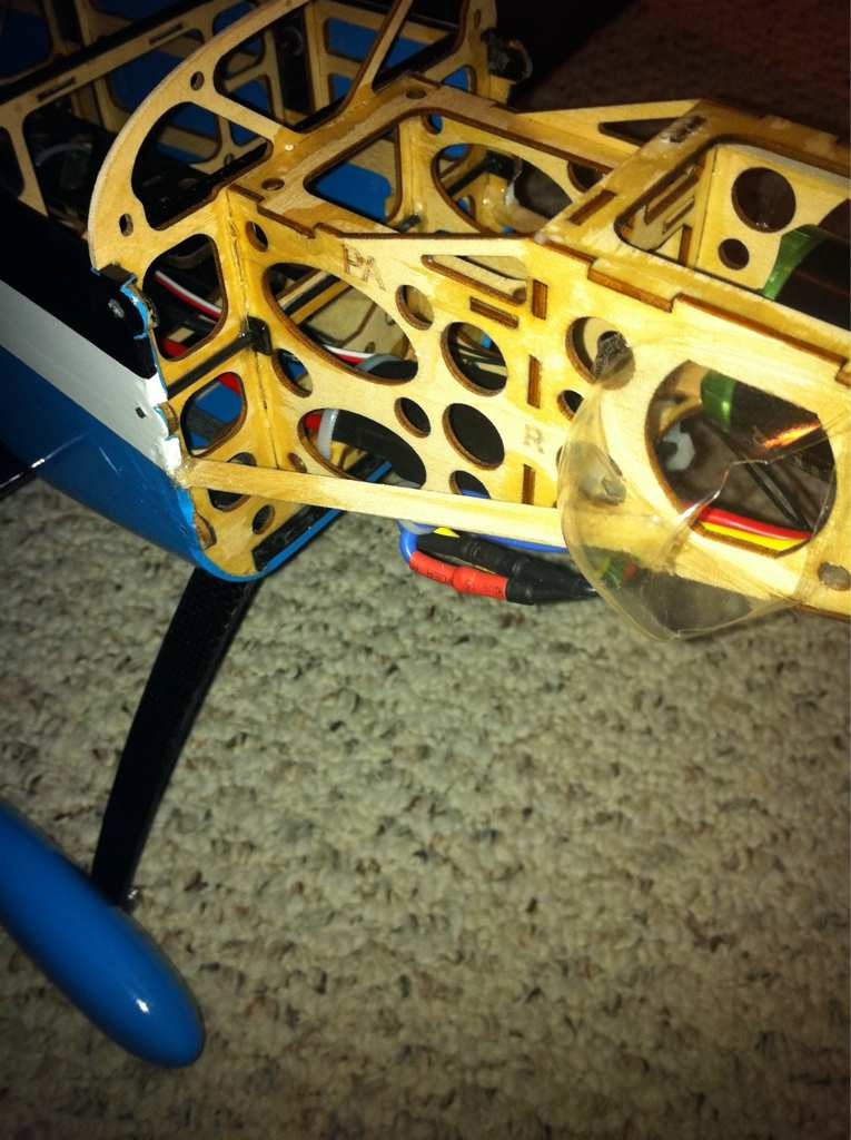

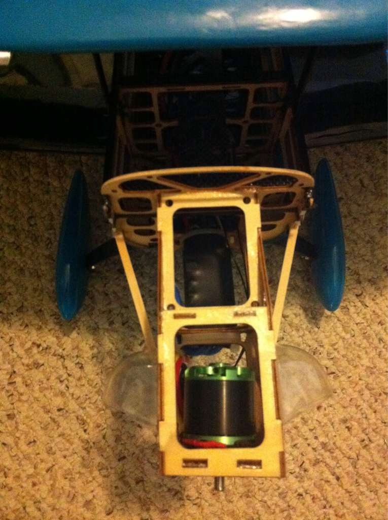

And finally, I attached some reinforcements to the motor box as I used a slightly more powerful motor than the recommended thrust motor bipe 4.jpgbipe 5.jpg

Regarding the battery access... It's not really the top wing that is the main problem. It's the braces across the top of the formers that run directly over the battery leaving only a few mm clearance. The battery needs to be slid in under the cross braces meaning you cant use velcro. The fix is to cut out the top brace and either reinforce the former like Gyro did on his or make the cross brace removable like i did on mine. It's a reasonably easy fix.
