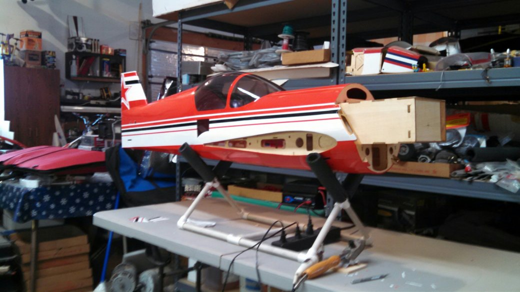

You guy were not kidding about the landing gear being a PITA to install. I just opened the holes up a bunch, was going to cover over them anyhow. So a bigger piece of covering is no big deal.---Smitty

I have a whole roll of flame red if you want a piece.

It's pretty simple really. Install the bolts onto the head of a screwdriver / allen wrench, put some masking tape around it to hold it together. Cut the hole, install the bolt with a little blue lock-tite. Done. Actually takes less time than most. Ultracote true red is an exact match as well to cover the holes.
