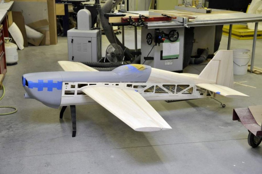

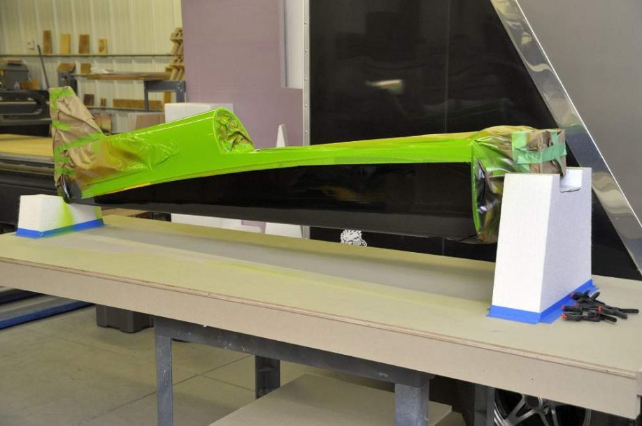

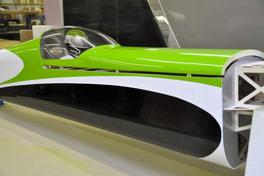

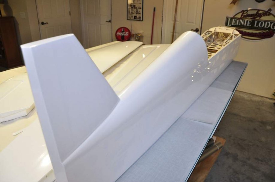

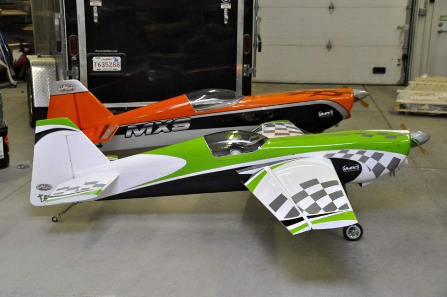

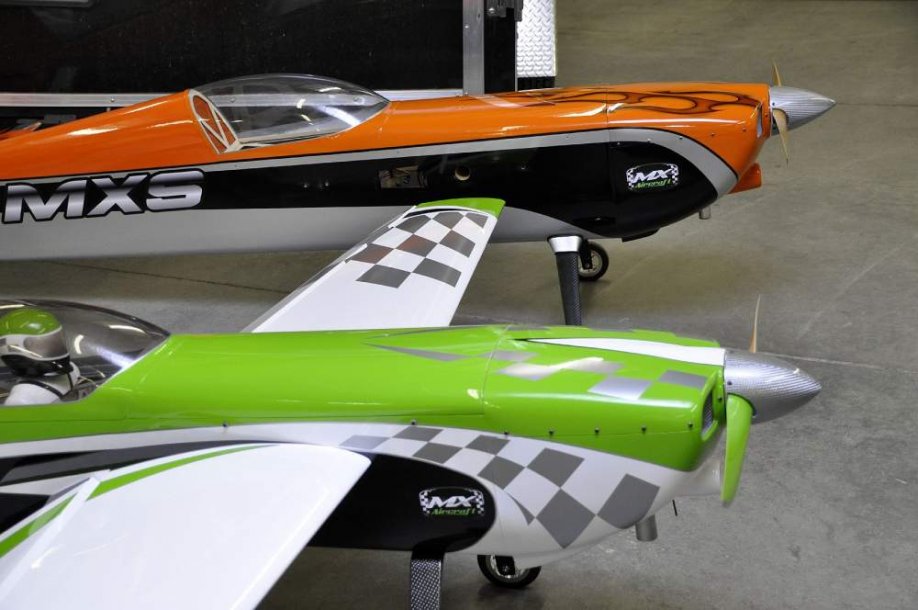

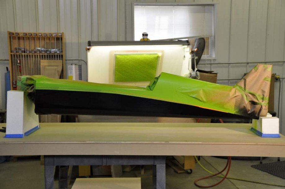

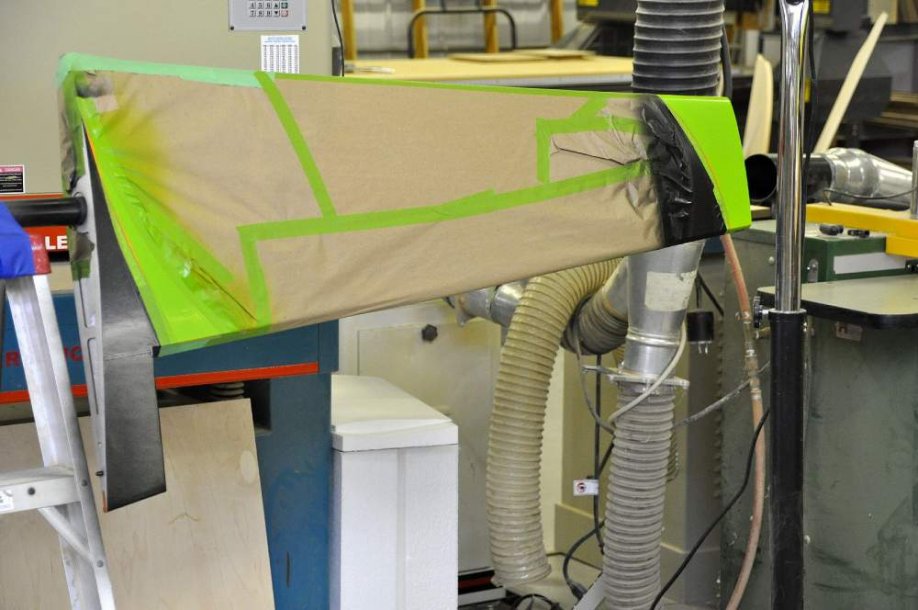

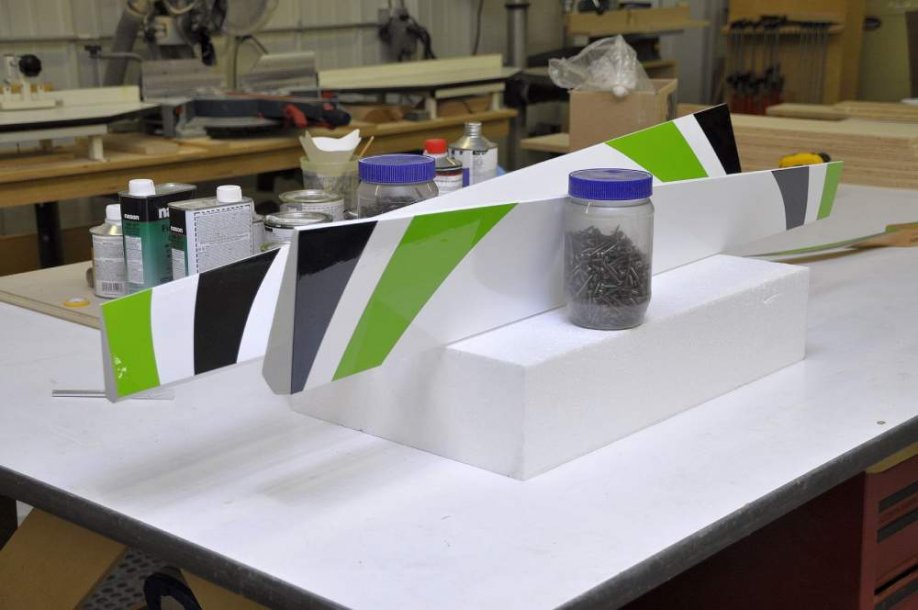

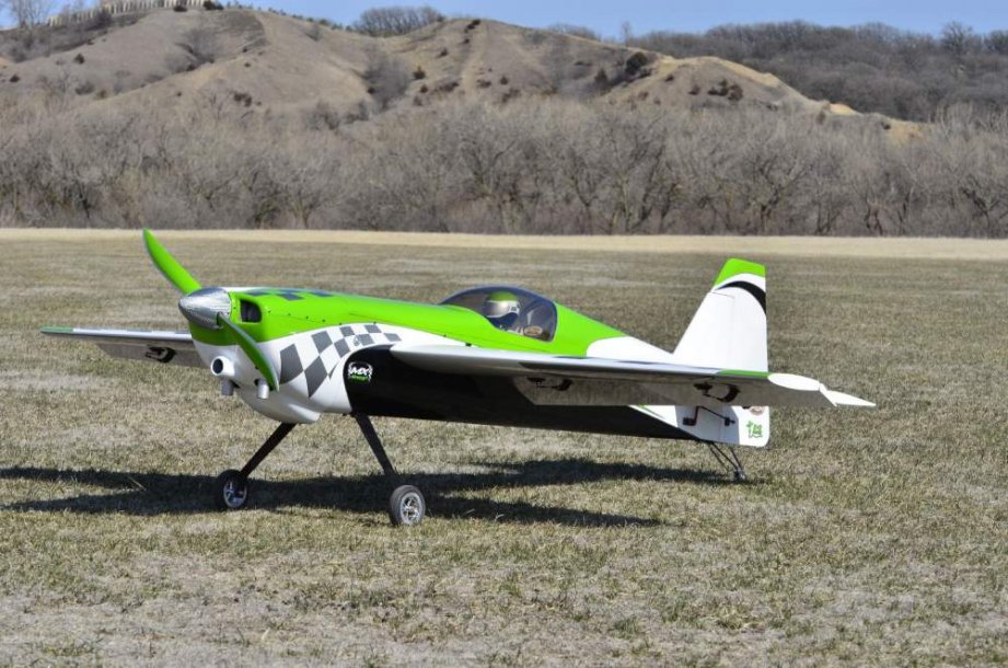

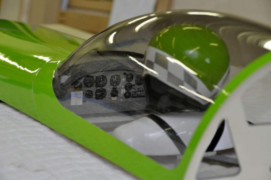

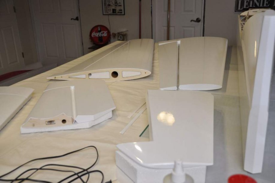

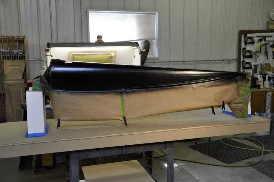

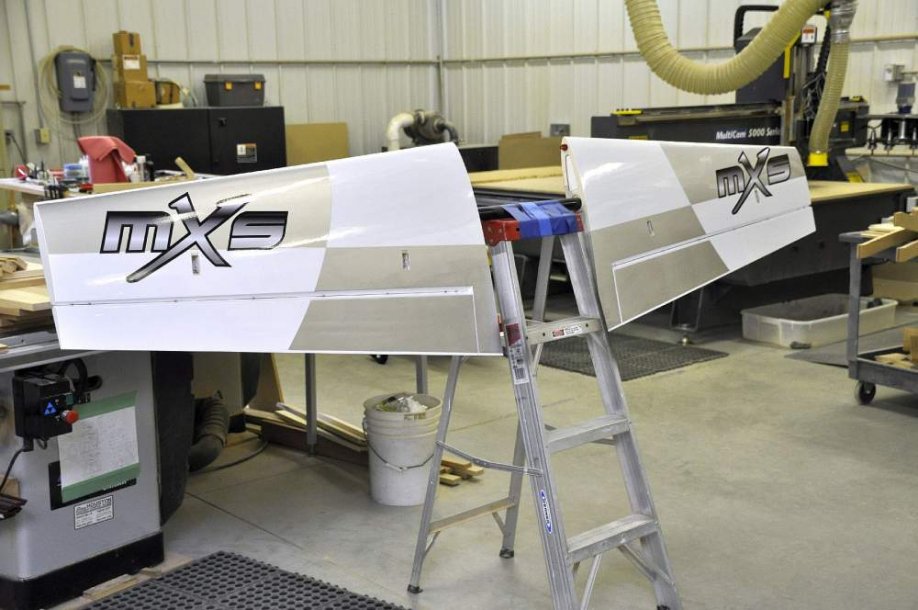

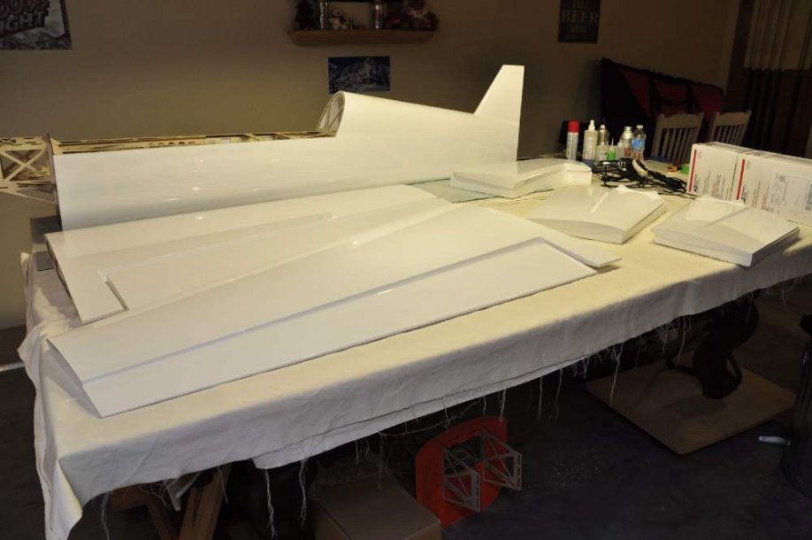

Here are a few pics of the one I did. Does it work.....YES. Does it look badass.......YES. Will I do it again.......HHHHHHHHHHELL NO.
I spent twice as long to paint this plane than I did to cover the plane all in white. It took crazy amounts of paper, taping.....then the tape lifes the covering so you have to iron it, repeat. Once it was done and cured it was badass. I did a match to apple green and black with white ice diamonds (AKA stripper sparkles) from Kustom Shop. It is all base coat / clear coat with Nason spot panel clear.
Once the clear had cured for a couple of weeks I was able to iron out wrinkles right over the covering justing a low heat in the 220 range without issues. The only places that had issues when I had it was the edges where I stopped the paint and could not use pin-stripe to cover. It wanted to chip a bit there.
