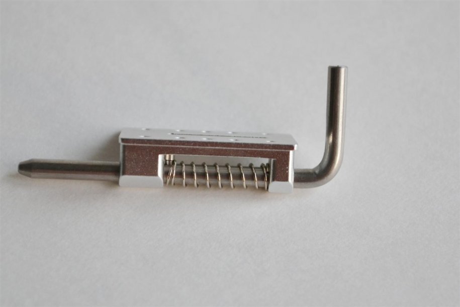

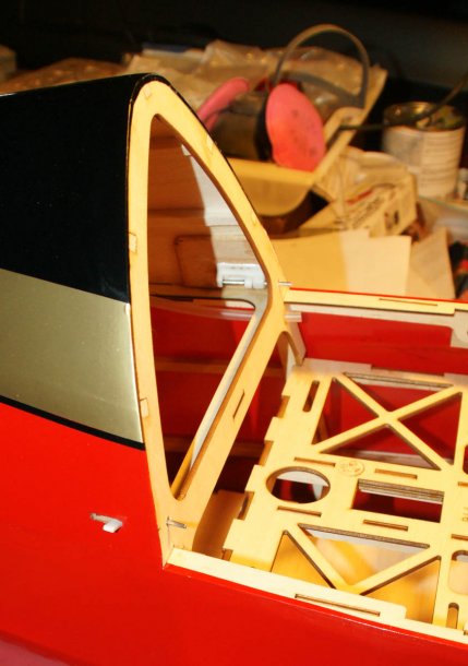

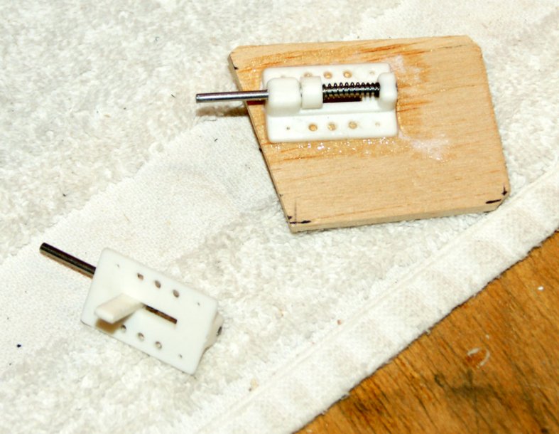

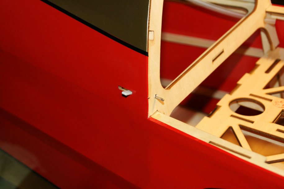

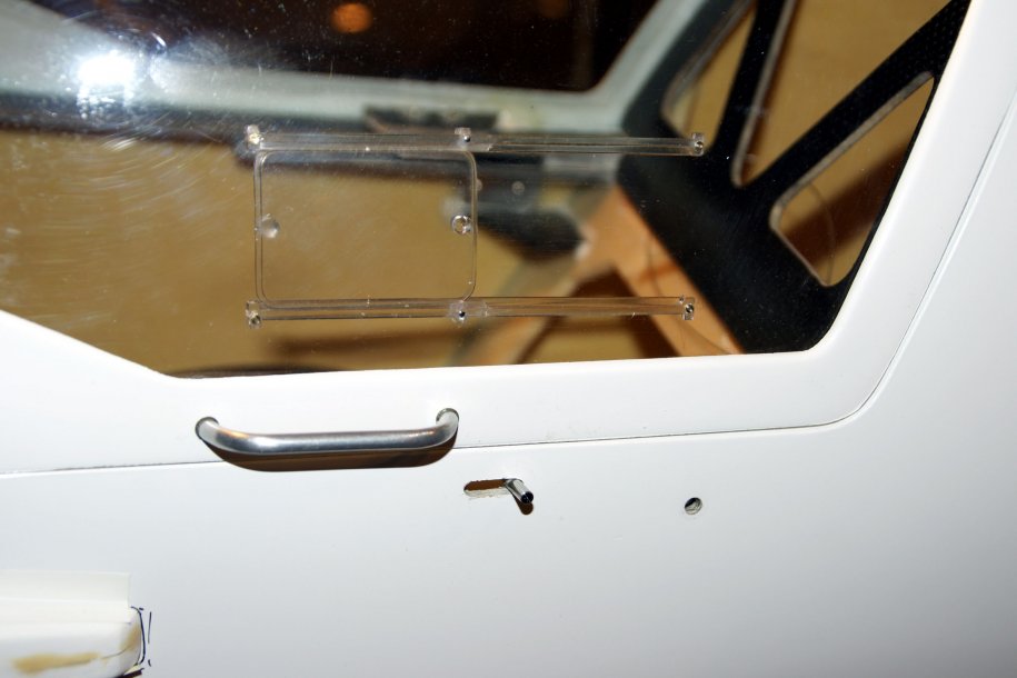

David....the easiest solution is with good quality spring-loaded pins going into hard points at the rear of the canopy. I did that on my Beast (although I used plastic-housed pins) and never had any problem. HOWEVER....the Beast is a much shorter canopy, so probably doesn't have as much torsional/twisting loads during flight....so, i would approach it with some caution. There are some very nice aluminum and stainless pins available, which are stronger. I used them to secure the hinged canopy on my Krill.
