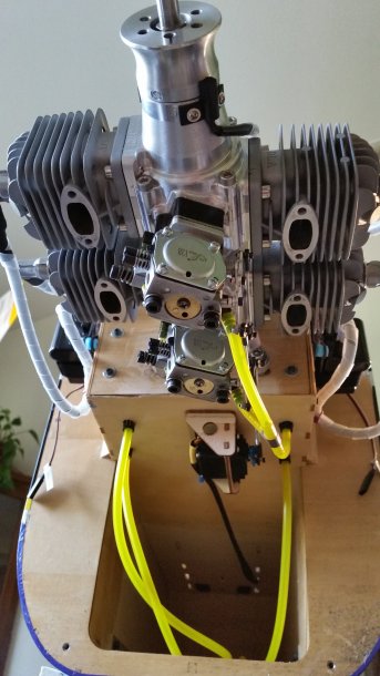

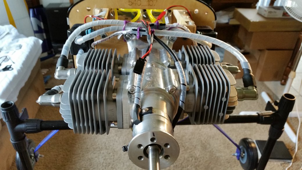

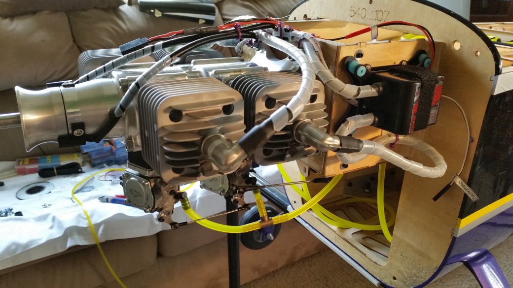

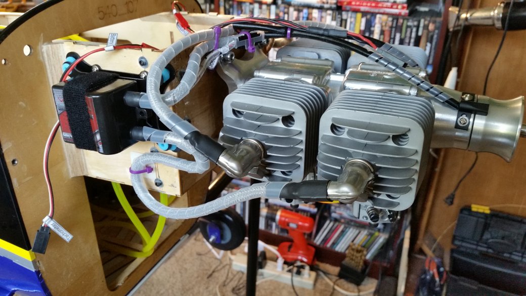

Mounting the 128 proved to be a bit of a frustration. I had forgotten to take into consideration the length of the motor verses the thrust alignment. But after remembering (with a little reminder from @Shayne Epley) I got the 128 mounted and ready for the next step. I mounted the ignition modules on the sides of the motor box as the spark plug leads were just not long enough to make the stretch from the top of the motor box. That, and the fact the top cowl half didn't allow room for the modules. @Taildraggerrc ignition module anti vibration mounts proved to be just the ticket. Not that the little four banger is going to develop much vibration, but I like them and the one on my 260 is doing a superb job so, what the heck. They are extremely lite and add a nice little touch. Wires loomed, fuel and smoke lines ran. One thing for certain, it is pretty busy happenings going on under the hood where that little Ferrari is mounted.

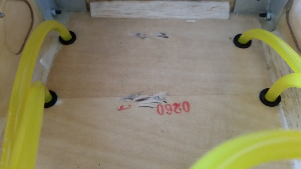

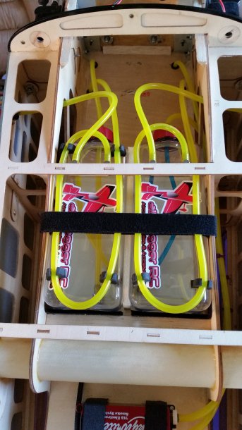

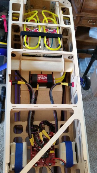

Next I set out to get the fuel and smoke tanks in place. @Taildraggerrc fuel tanks for both. These dudes are really cool and heck, they look like they had me in mind when they made them. PERFECT fit. I also got two fuel dots from @Taildraggerrc. One for the go-go juice and one for the smoke-'em juice. I also picked up some really cool little nylon bushings to route my fuel and smoke lines through. Neat and clean.

Looking good stang! If I may make one suggestion on that throttle servo setup, I know there will not be much vibration but they use a paper thin plywood for the engine box bottom and if it does flex at all it will cause your servo to vibrate forward and back. This could cause a slight erratic throttle trim or engine sound if it does happen. If it does, a simple plywood doubler 1" wide and longer than the servo, even better some balsa tri stock with the widest side gluded down running forward and back will cure it for you. Also hoping you have epoxied the plywood servo mount to the bottom and the screws are just for clamps.

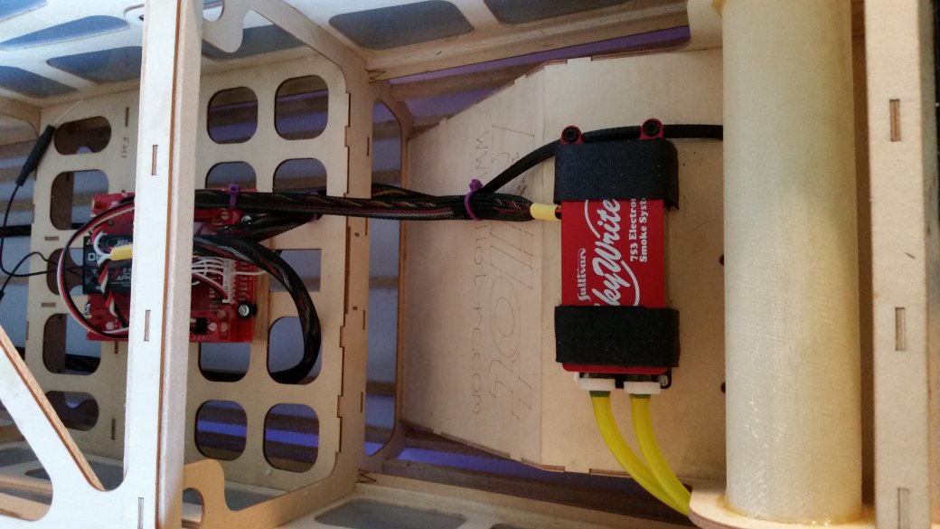

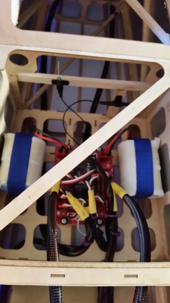

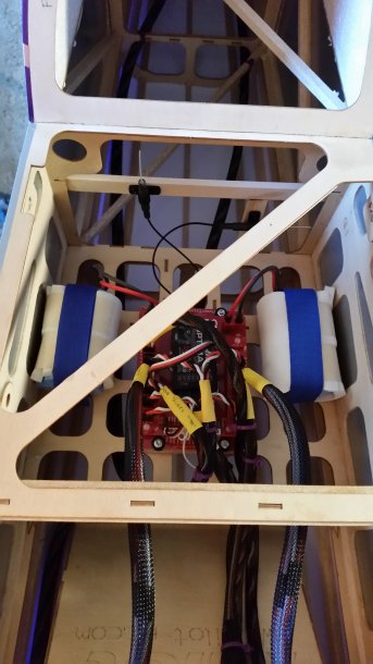

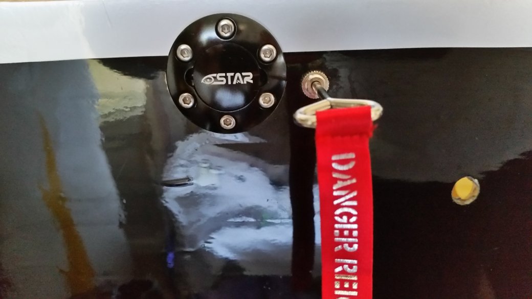

I've got the fuse completely wired now. @Taildraggerrc 20awg wiring and wing harnesses throughout. I've never trusted nor had more faith in wiring than what I do with the TDRC. Sullivan Skywriter smoke pump in place, strapped down and wired/plumbed in. Smart Fly Power Expander Pro and Pin and Flag Fail Safe switch in place. Most everything "snake" skinned and looking pretty nice. The Pilot 37% doesn't offer a lot of room for choices. That is about the only short comings of this airframe I can find. But a little planning and a little luck in execution on placement and everything is tucked nicely inside.

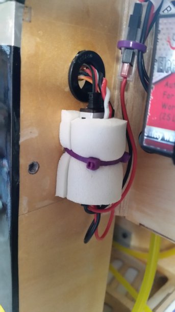

Since I am focusing on keeping this as lite as possible, I chose to do a little different wiring process. I am using two Fromeco Li-Ion Relion 7.4 5200 mah packs to support the entire airframe. From my experience with my other gassers, I feel very confidant that 10,400 mah's on board should provide me with a good 4 to 5 flights comfortably. I also had my son make me up a special "splitter" harness for the ignition system. Supplying direct power from the SF to "ONE" RCEXCL Opto-Kill Switch feeding both ignition modules. No IBEC, no second ignition kill and no extra weight from ignition batteries. So far, the test runs we've done have proved to be absolutely flawless. The 128 starts usually one to two flips and runs like a scalded dog every time.

Ah thanks for the input Terry. I actually took that into consideration. Not only is the servo mount epoxied in place, but I have also drilled and set four wood screws to help hold it into place on the bottom of the motor box. With the sides of the motor box being bolted in 14 places, the tri-stock on the inside of the box to the firewall, I am confidant it will be good to go. I will however, keep a watchful eye/ear to the plane for awhile. I had one servo mount come loose on me two years ago. It really sucked. Motor died, dead stick landing, ejected landing gear from plate. Lesson learned...screw them babies in place. LOL. Thank you again....:way_to_go:

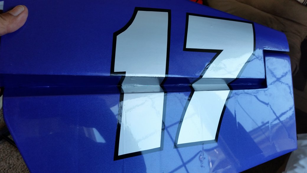

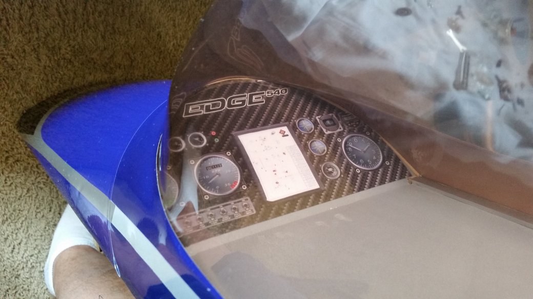

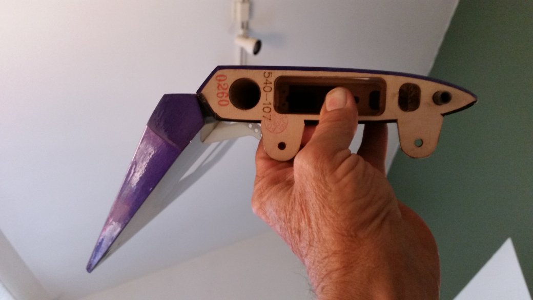

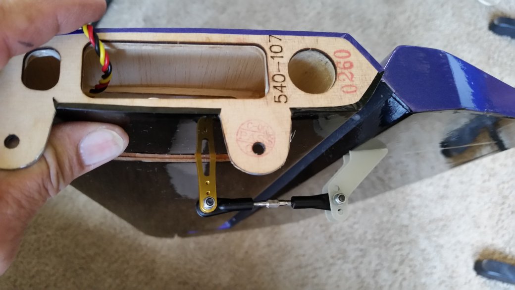

I accomplished getting the elevator servos installed and pretty much tuned in. Good throws and smooth movement. I like. I took a little time to seal the hinge lines as I do with all my other gassers. I think it just adds to the appeal of an airframe when the hinge lines are sealed up all nice and neat. I still have not completely for certain decided on a pilot dude. But my original plan was to do a really cool "Batman" scheme with some really awesome graphics to match. I wanted to put a "HUGE" golden bat emblem on the bottom of the plane, however I am having trouble finding just the right sized bust, so I may have to hold off on the planned scheme. But in the meantime, I did get a really "AWESOME" dash graphic from B and E graphics. About all I have left now is aileron servos...and then the real pain. Baffling that four banger. Doah!!!
