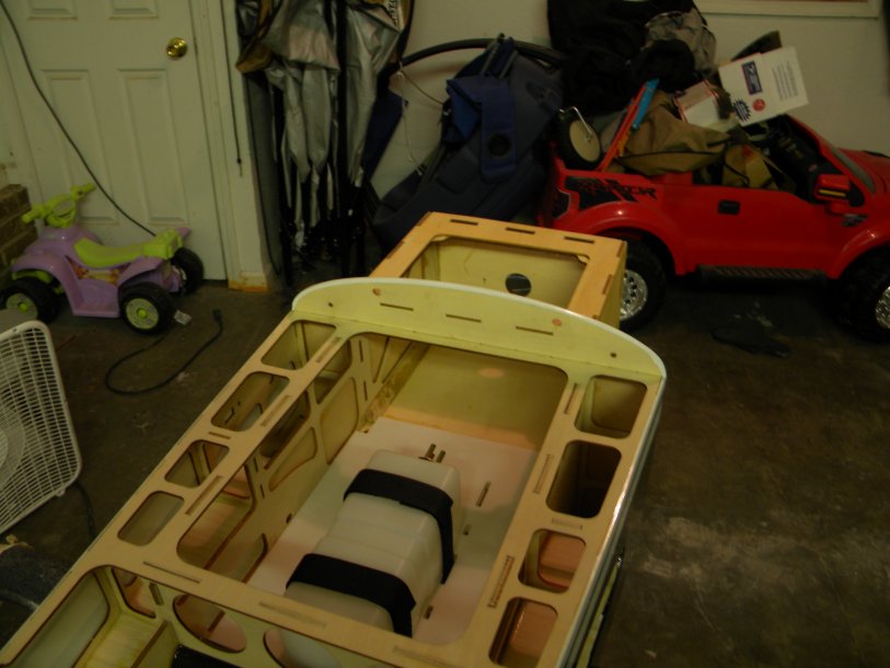

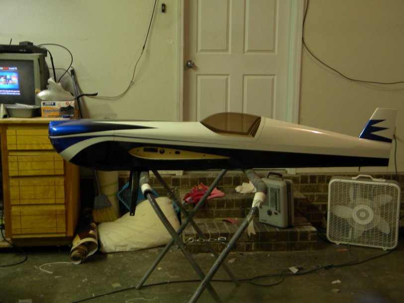

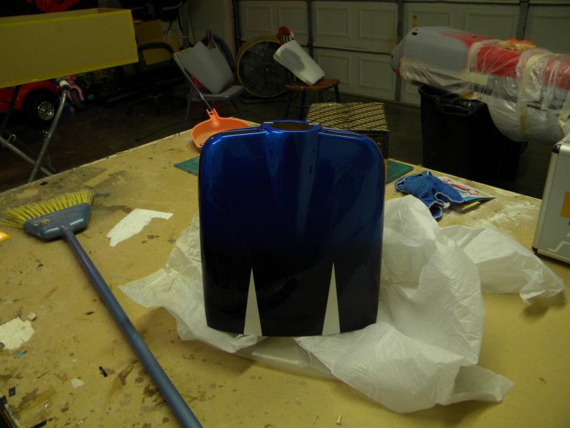

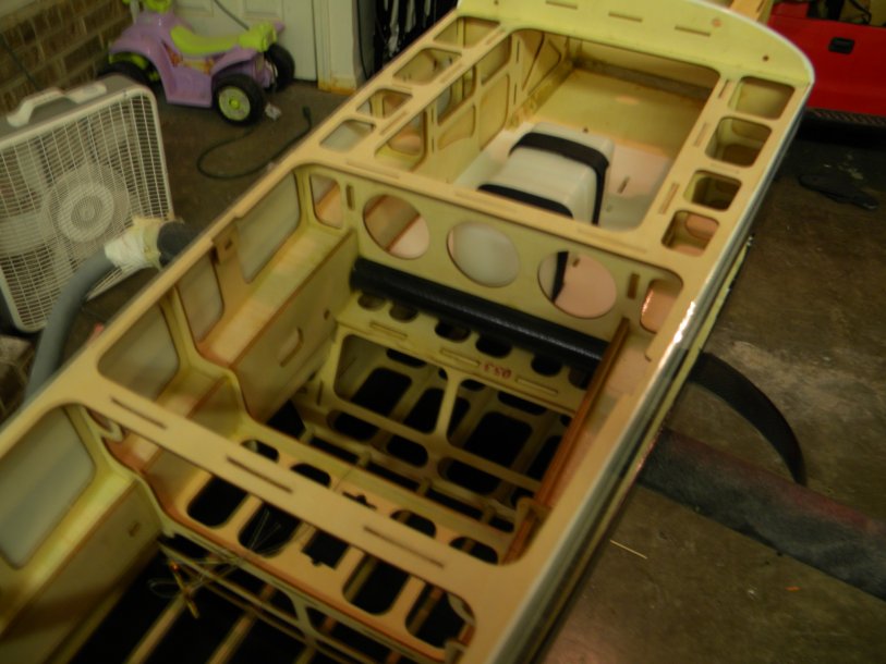

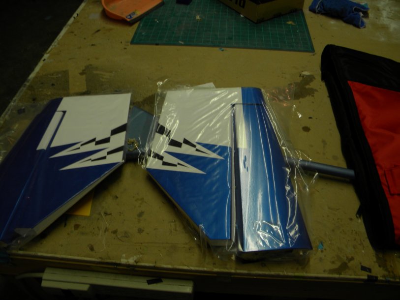

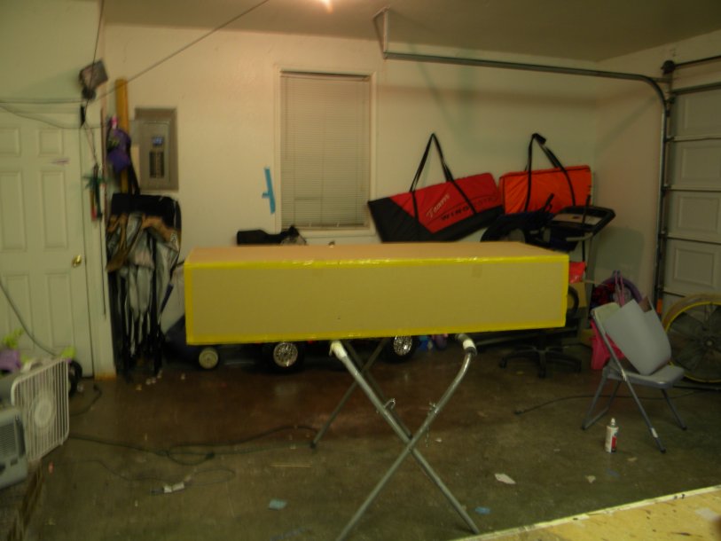

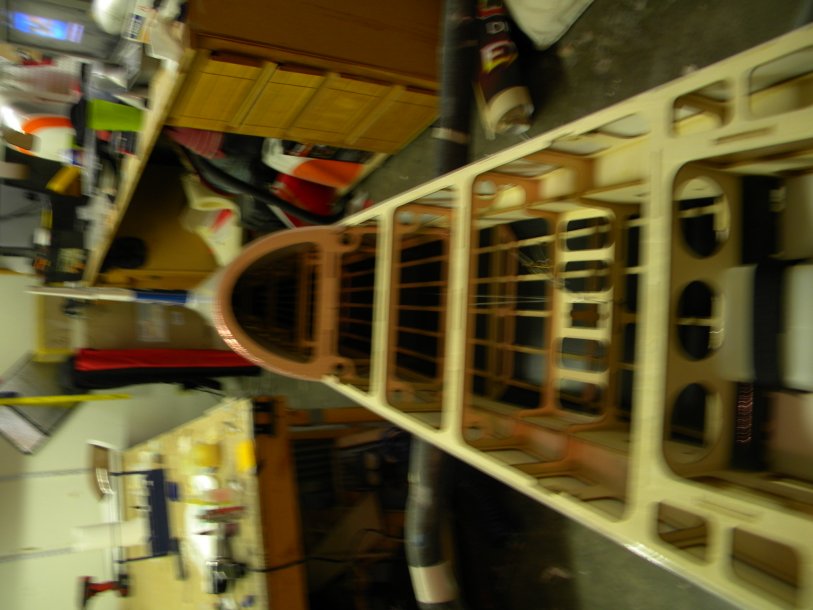

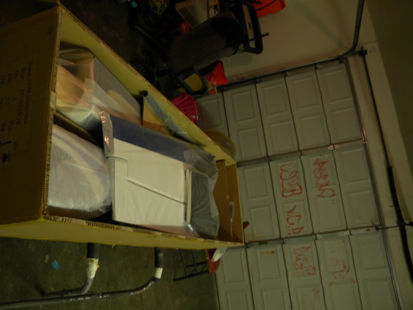

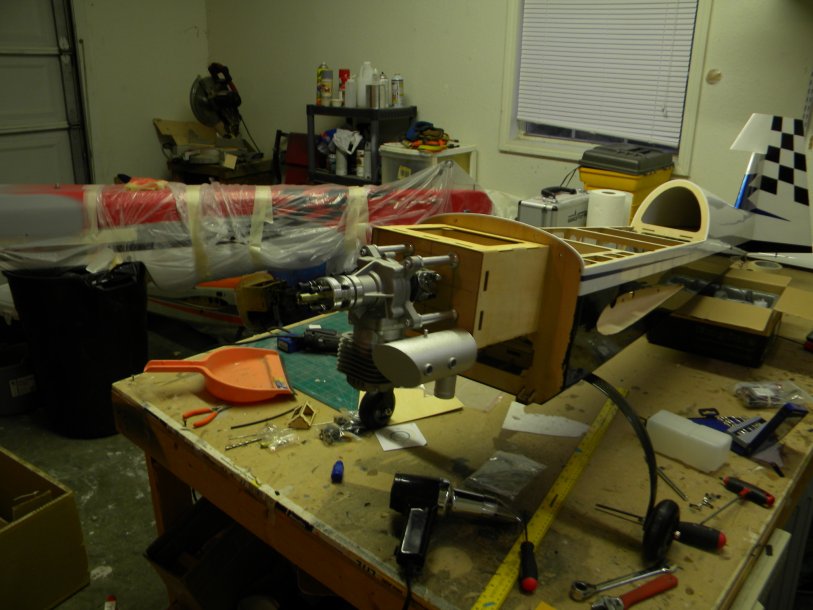

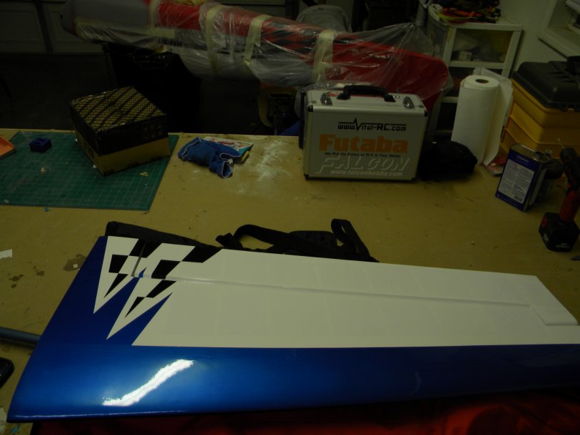

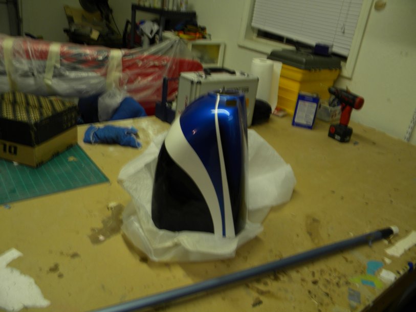

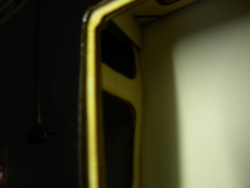

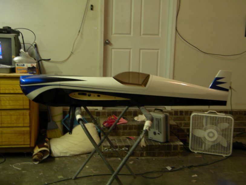

So i got started last night here is some pics
First of all i have to say, Redwing really packs these planes good, I think you could stand on the box and still not get any damage lol that might be a little to far but they sure are strong. As I was unpacking this plane. I couldnt help to notice how big the alerions and the Elevators are, this sure should make for some extreme 3d. The paint on the cowling is unreal, I have never seen a paint job like this on a rc airplane, Tim and his Staff have really went out of their way, to make there stuff stand out. Well I got her up on her feel,, Tailwheel mounted and Rudder Hinged, and the dle 61 on the front of her. but that will be enough for tonight I got to hit the sack time for some shut eye.
DSCN9118.JPG DSCN9120.JPG DSCN9120.JPG DSCN9122.JPG DSCN9124.JPG DSCN9125.JPG DSCN9127.JPG DSCN9128.JPG DSCN9129.JPG DSCN9130.JPG DSCN9131.JPG DSCN9132.JPG DSCN9133.JPG DSCN9134.JPG DSCN9135.JPG

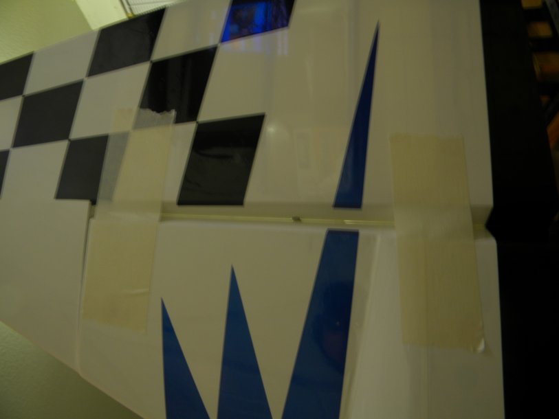

I am going to get a few things done to the extra today... so far I have started the hinging process of tge elevators.. I ran our of epoxy. So I opted for
you have to be care with this stuff!!!! It expands up to 3x of what you use. so it can definitely make a mess.. if you don't wipe out the excess while it's expanding. Also make sure that you dampen the wood.. it helps the glue dry and adhere...
also make sure to sand your hinges, to give the glue something to bite too
