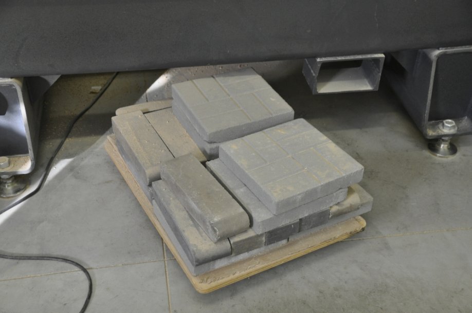

I'm going to do a video on vacuum bagging next week as long as work cooperates. For weights I went to the big box lumber yard and got some landscaping blocks. The smaller ones are about 10 lbs. each and the larger ones are about 18 lbs. each.
I would distribute the blocks evenly which gave me a few hundred pounds of weight. Even with a plywood caul you will want to distribute the weight evenly.
Other than that, I'm not much help. I really suck at doing poly sheeting and always get them too heavy.
