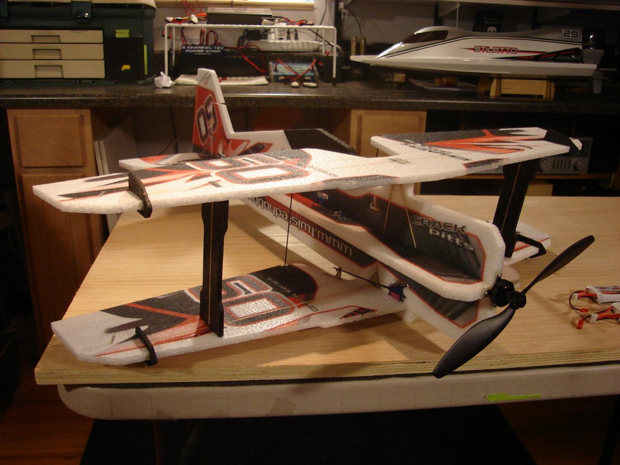

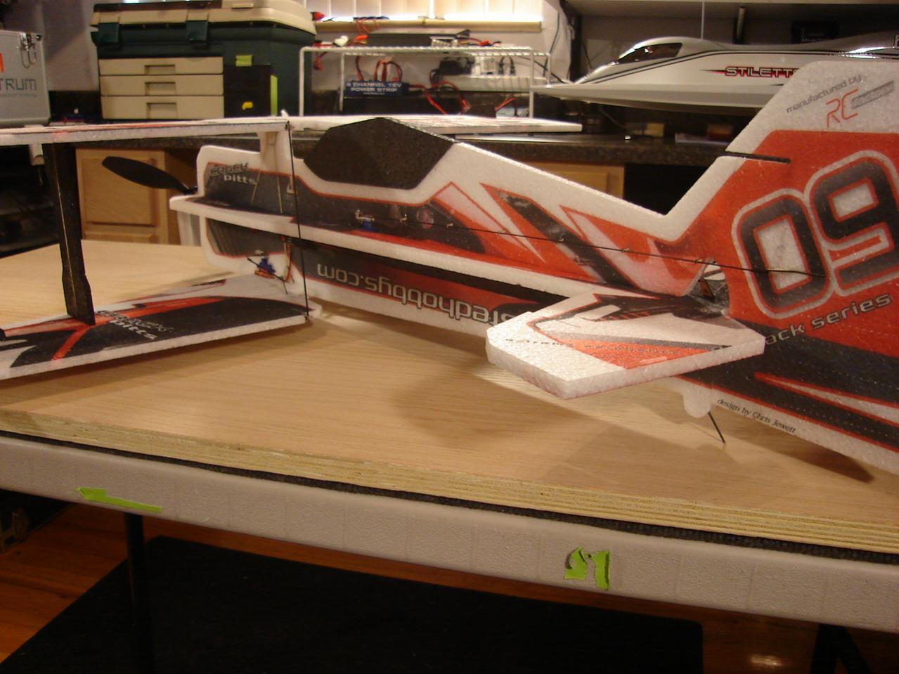

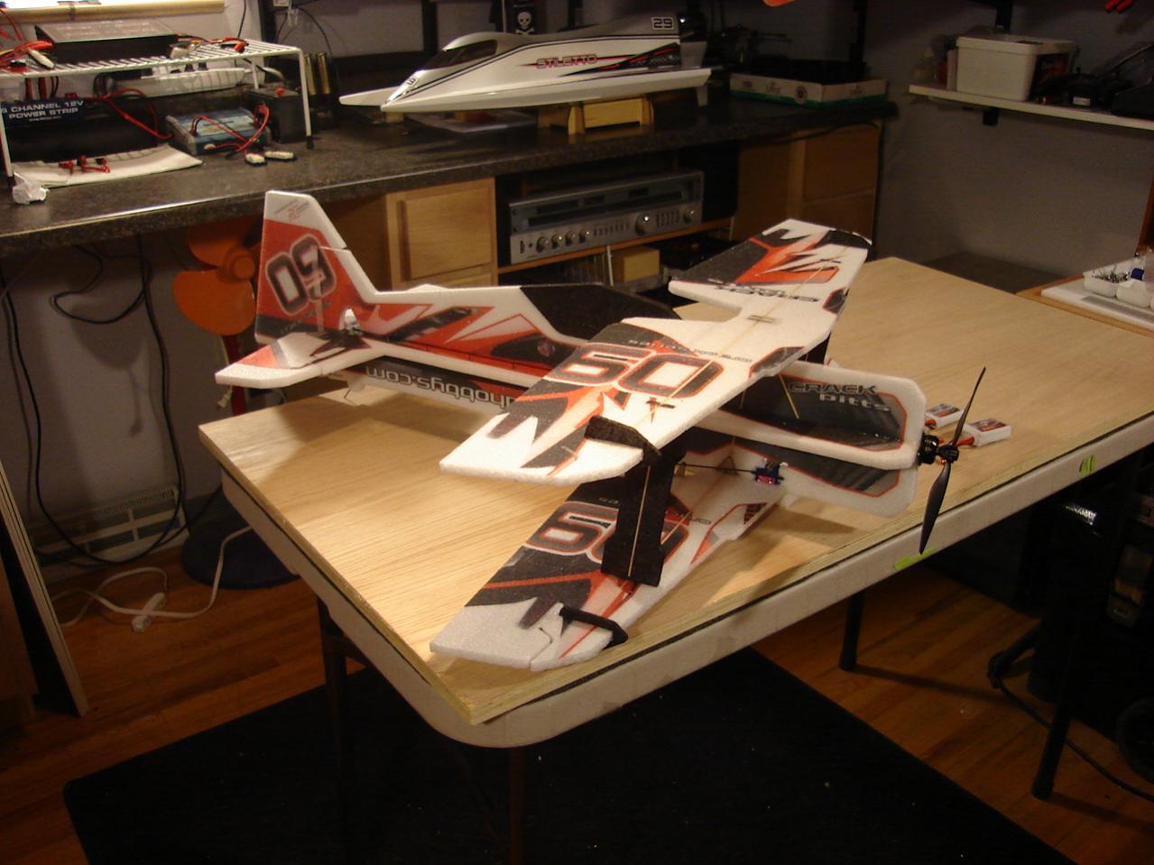

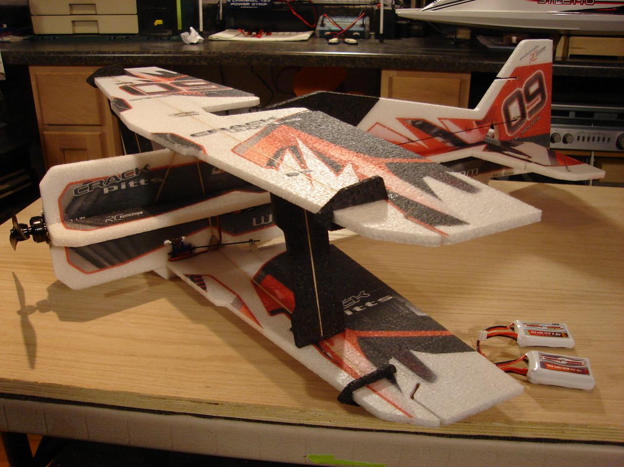

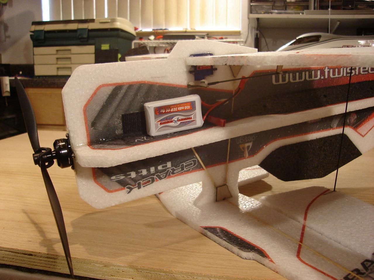

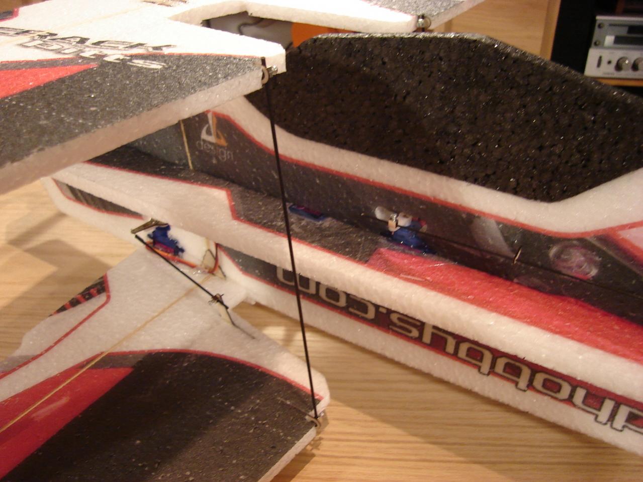

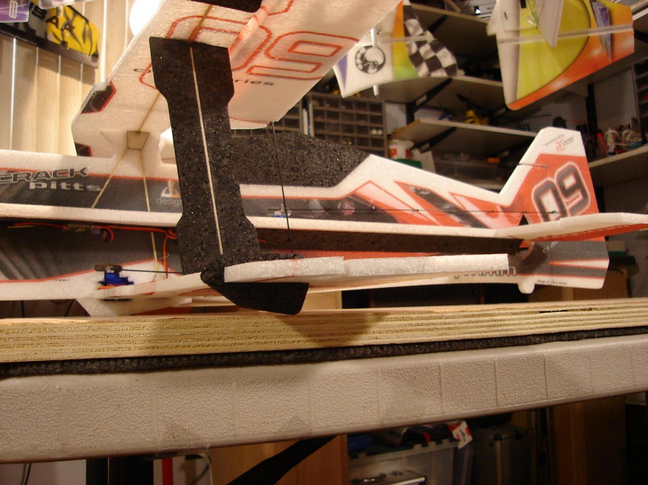

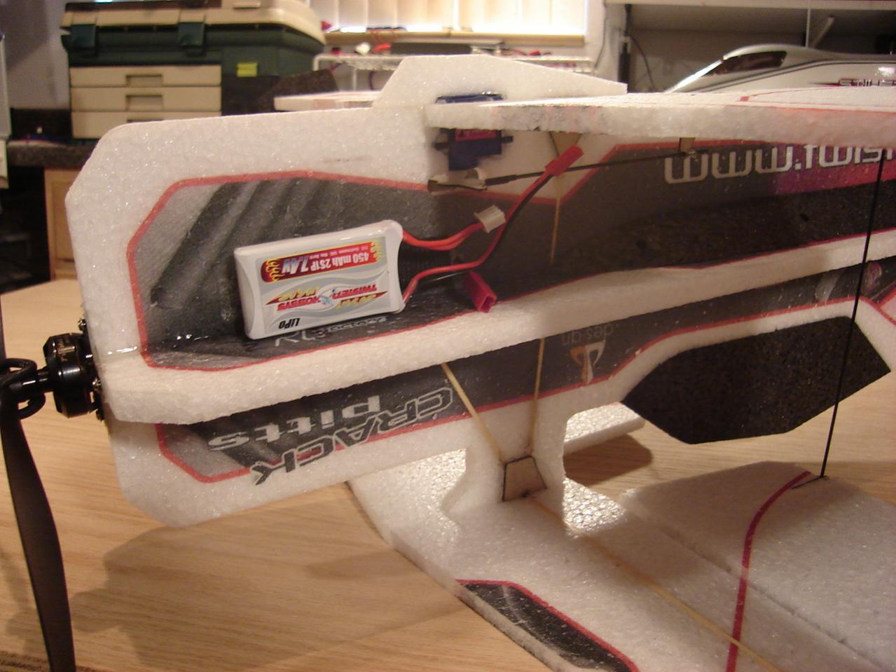

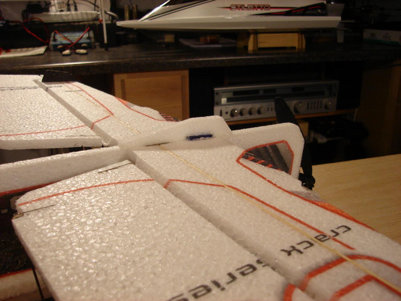

Some Stills from my Achrive.
Pictures with the batteries are showing 2s and 3s location. Also of interest, if not using the landing gear a small center skid can be added as shown right near the aileron servo, make it just the right height to match the SGF's so the plane will set flat. Detail of the quick links use for the ailerons also shown..... Enjoy!
.... not sure yet how to get all the pics to line up... : ) Gyro?
