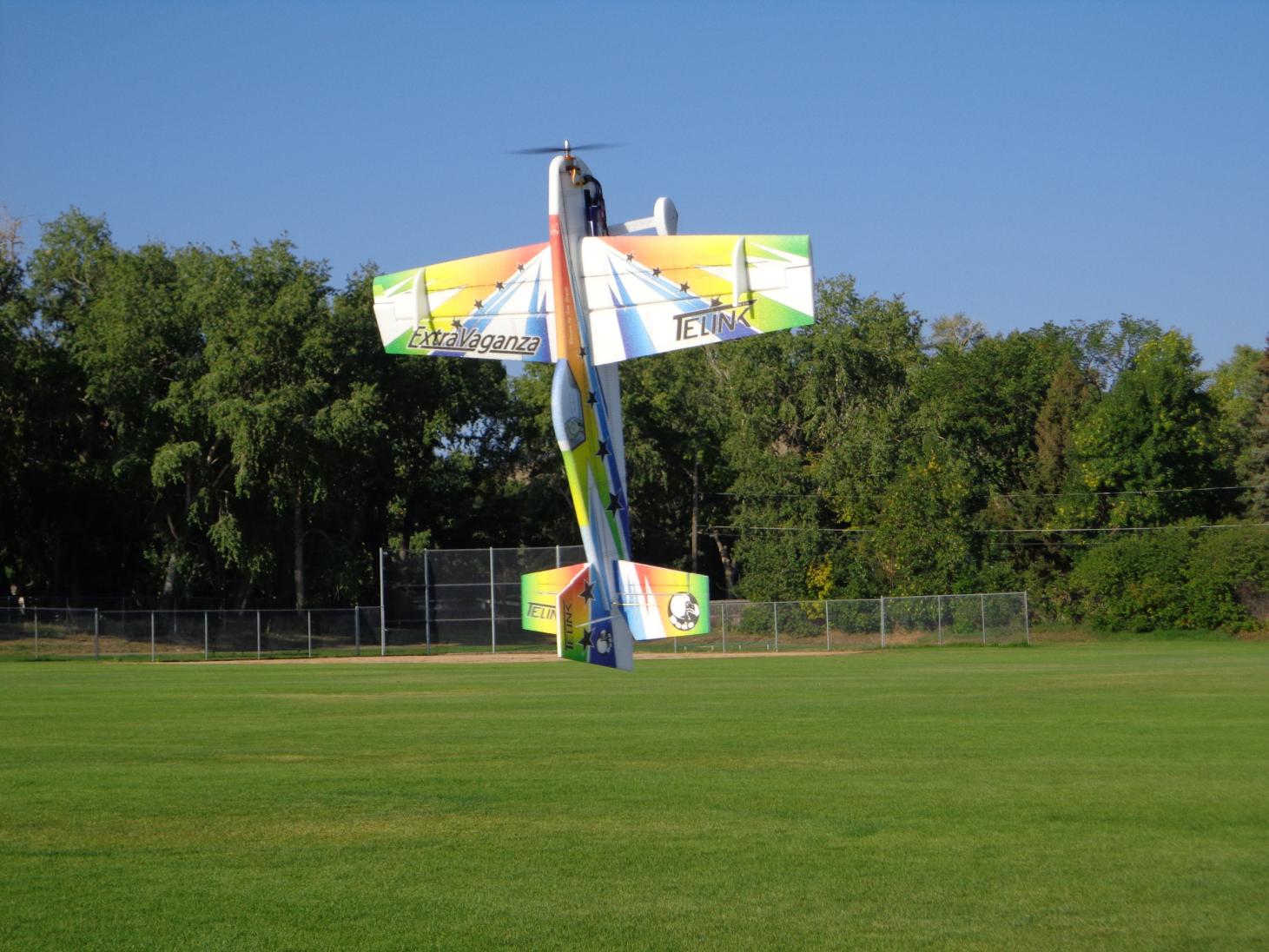

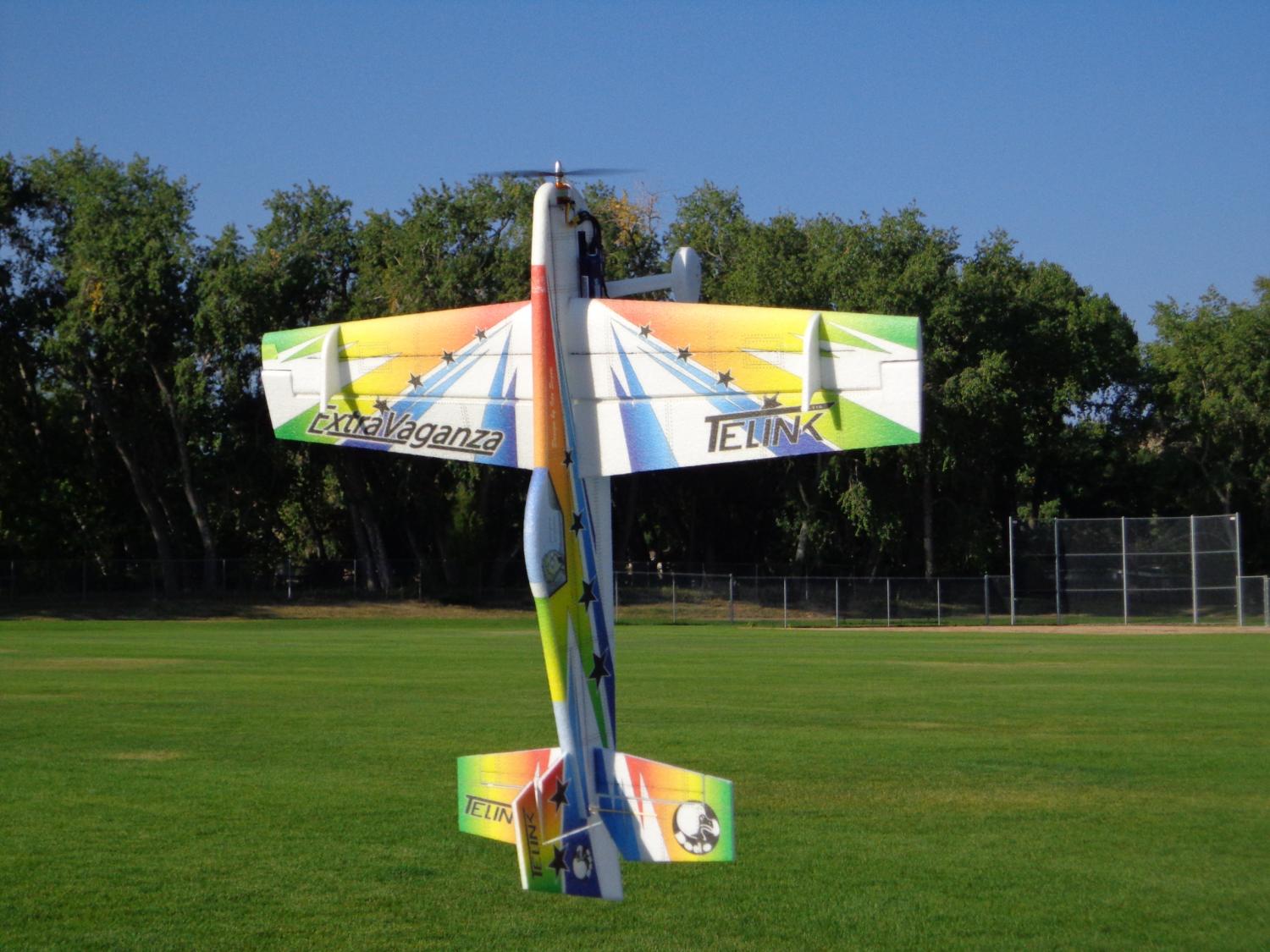

Some still from this morning flying session.... Added the SFGs, very nice addition, will keep them

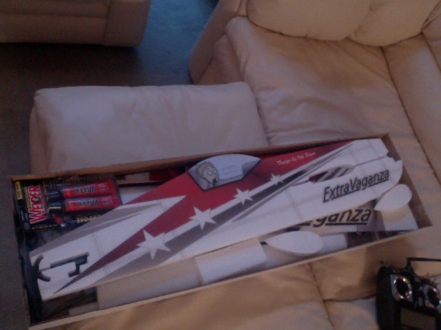

First of all everything came double boxed, was well packed, and arrived undamaged.

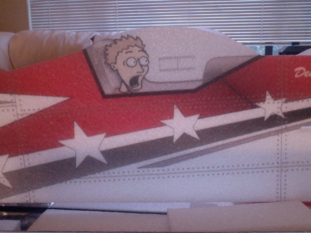

It looks great right out of the box! I especially love the pilots facial expression!

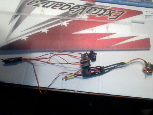

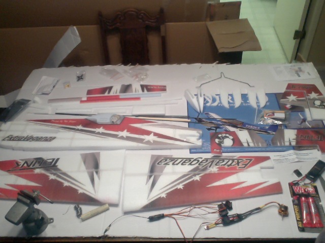

I got everything laid out on the table for inspection and all looks great. I also hooked up all electronics to test and everything is working as it should.

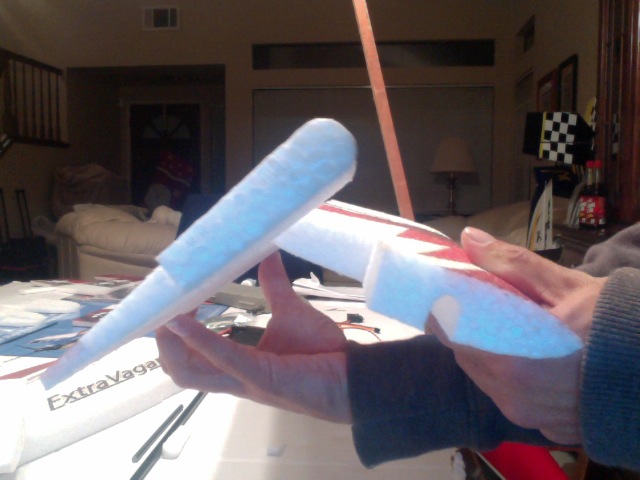

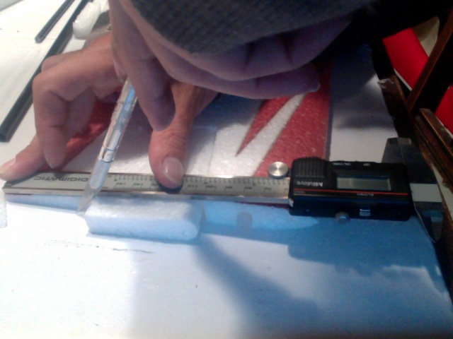

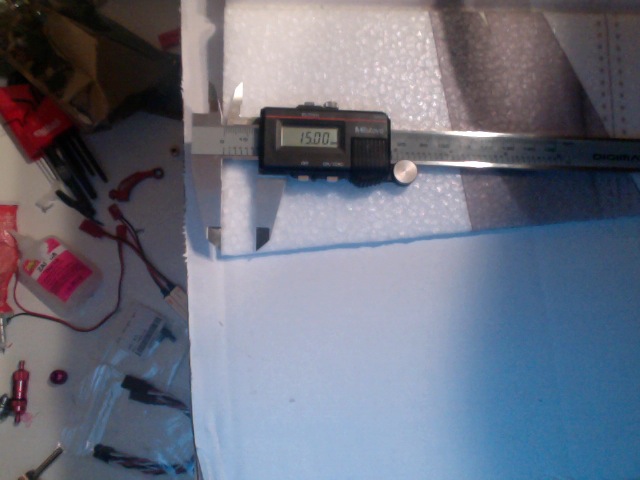

I started the build by measuring 15mm from the inboard side of the aileron and cutting it off to make clearance between the aileron and fuselage.

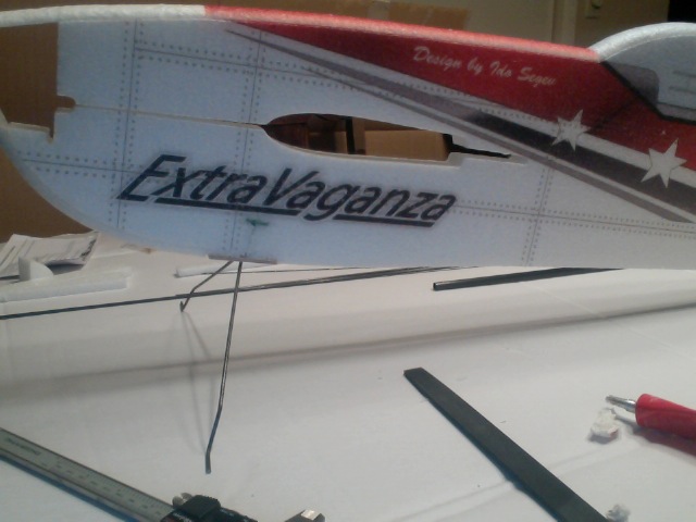

I hinged the ailerons, glued the counter balances, and removed the excess EPP from the counter balances. I also installed the landing gear tonight. Tomorrow i'm off work so i can hopefully knock the build out by the end of the day. I'll have to go to the LHS to get more blades, the EPP dulls the blades SUPER QUICK. I have to change the blade every 2 or 3 cuts if i want it to be clean.
