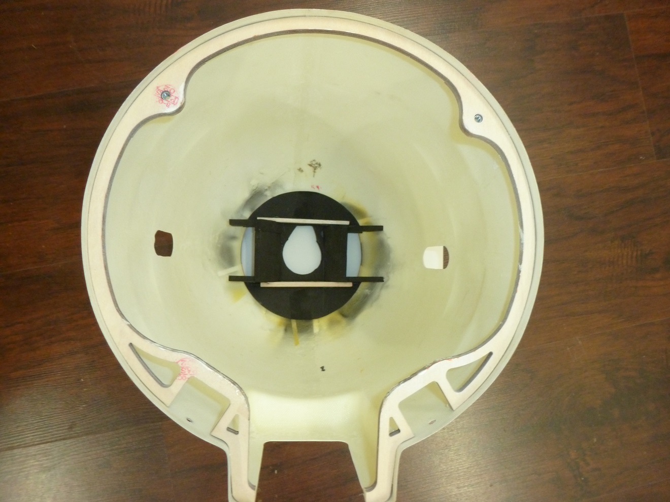

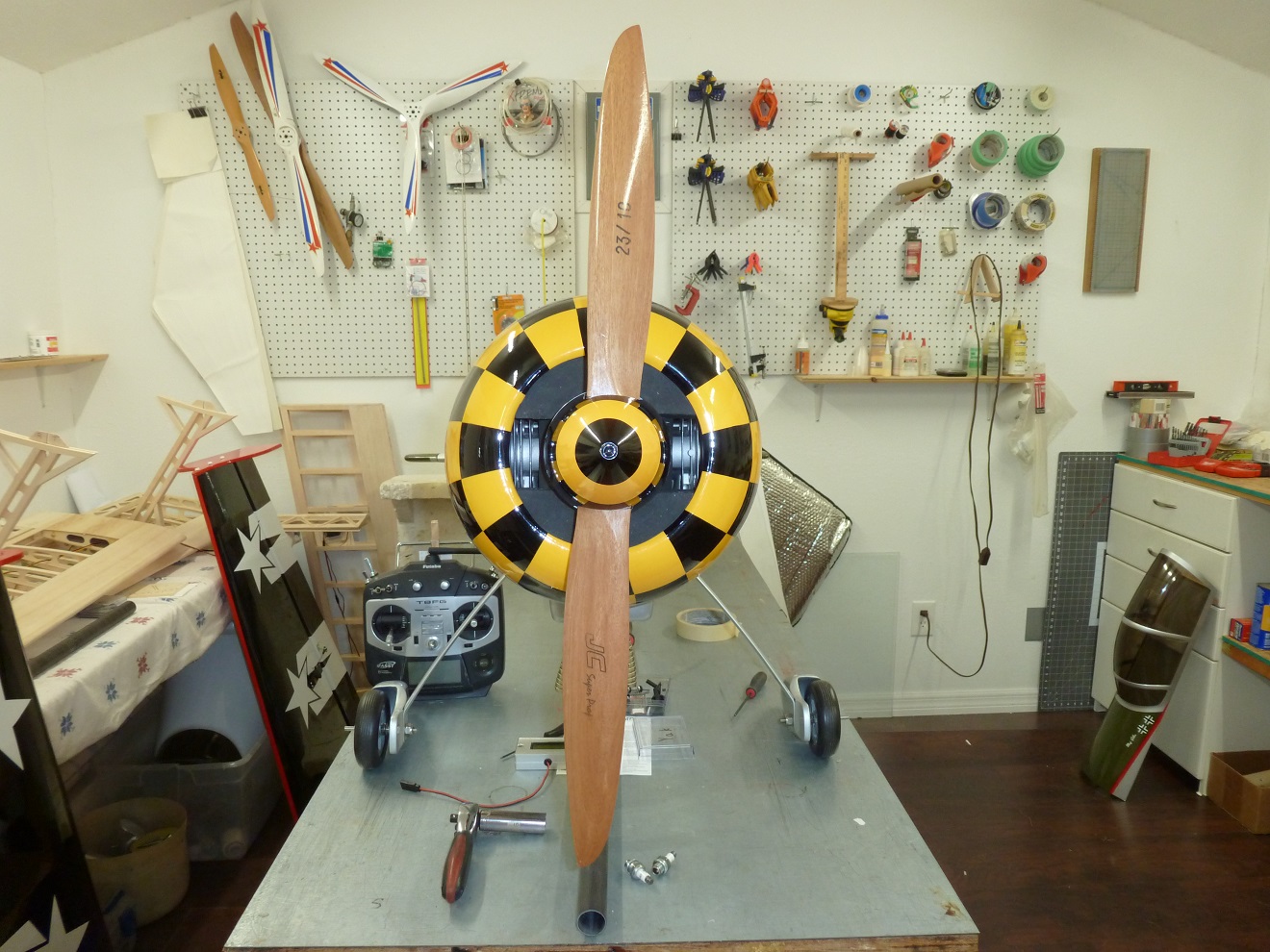

acerc
The above mentioned Creatology foam is where I ended up, 9"x12"x6mm. It worked real well and was easy to do.
