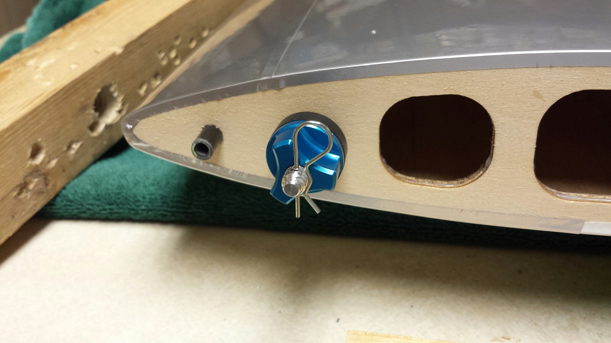

I've used the Secraft ones from Aztech, there pretty nice. I drilled a hole in mine for a hitch pin after a buddy of mine had a couple come off. The stud is aluminum so drilling is easy.
