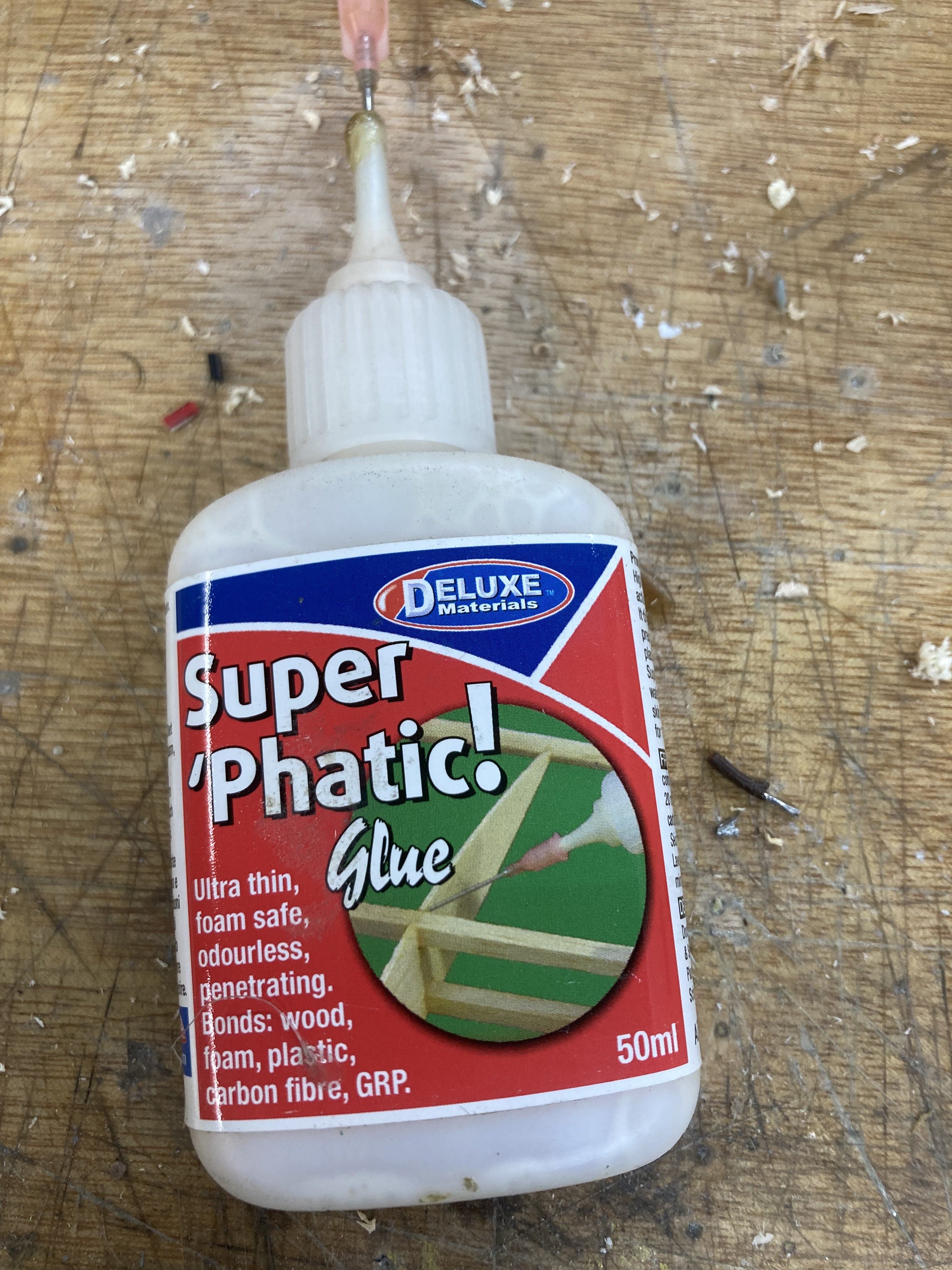

Never tried that but I understand what you’re saying about the CA. The fumes bother me too sometimes if I use a lot of it. I think the last time I needed to use a lot at once I moved the project outside. Then it didn’t seem to bother me. And wear rubber gloves and maybe a mask too.
Have you ever tried Super Phatic?

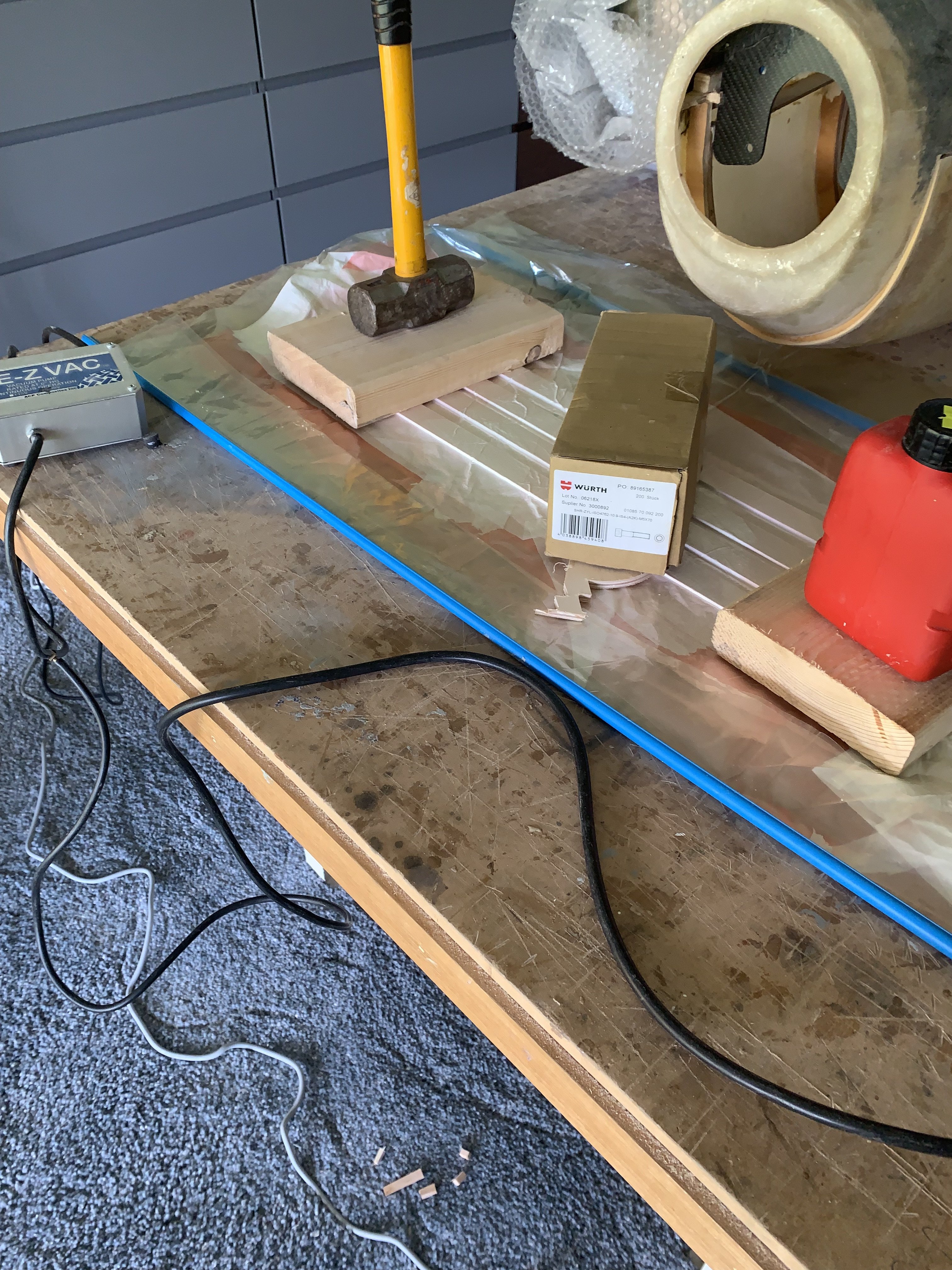

Vacuum bagging the trailing edges of the ailerons and flaps with basswood of 1/16" inside. This will leave a nice hard edge not easily damaged...

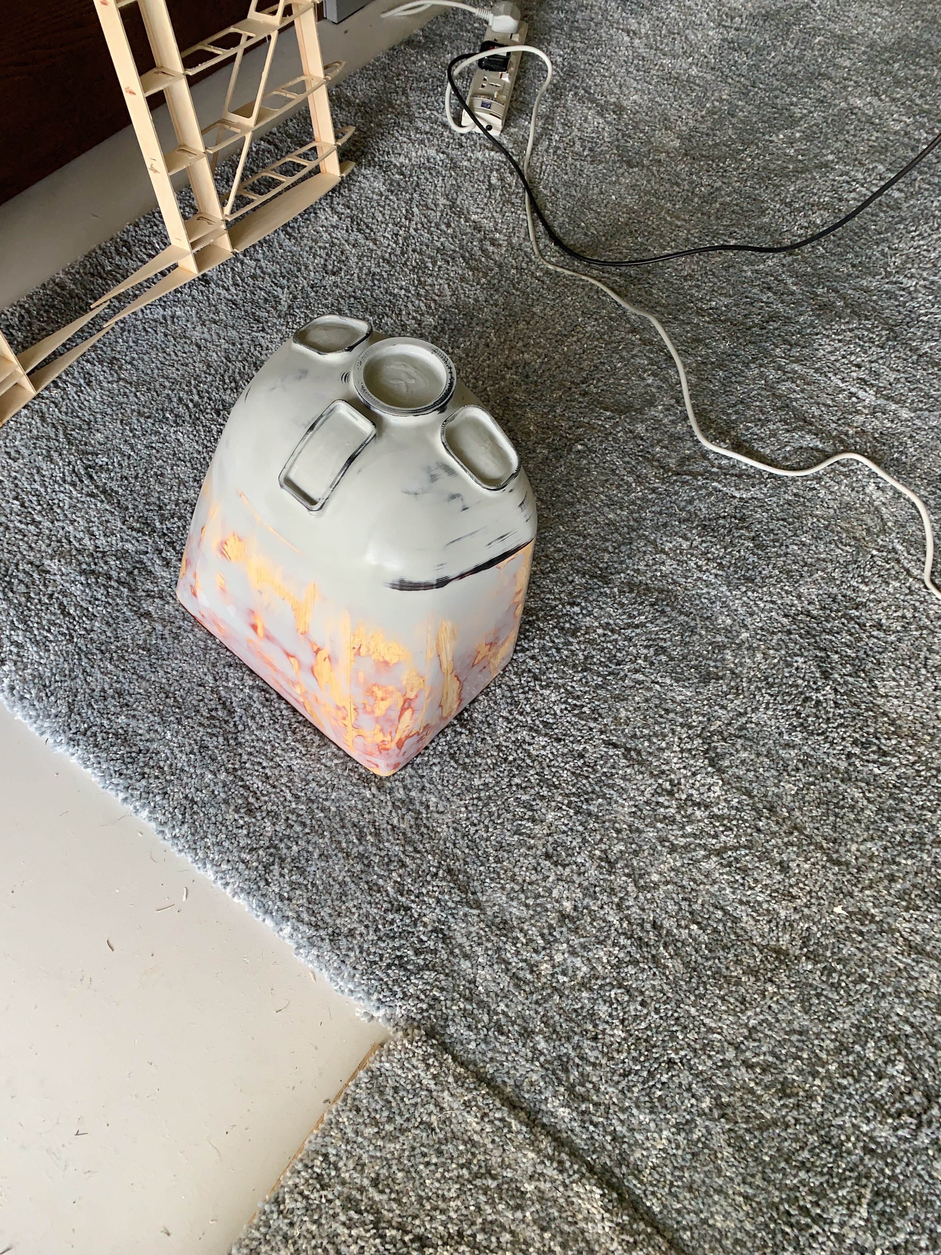

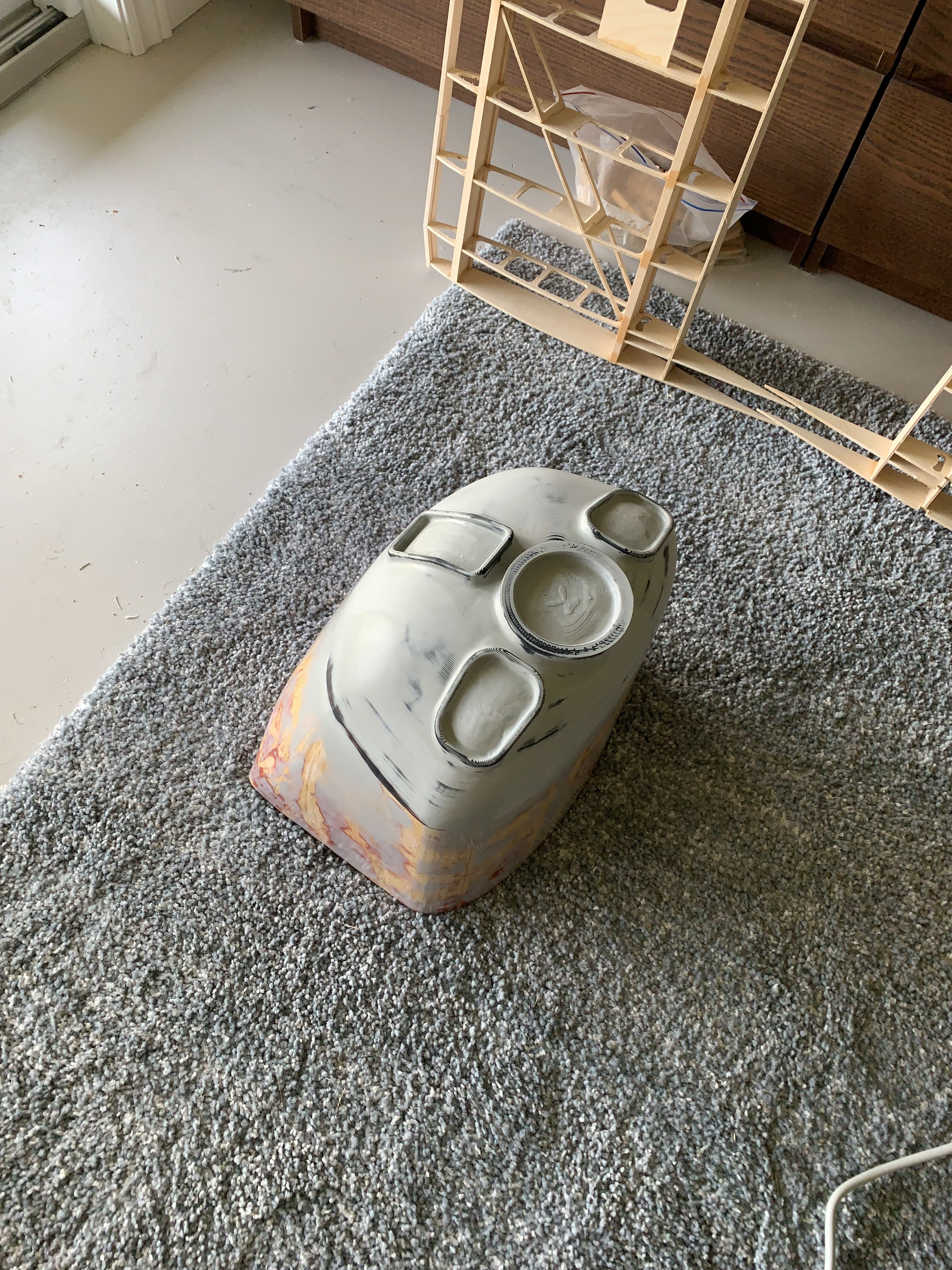

Spent some time on the cowl plug, it will take more time to get it nice and smooth before we can pull the mold.
