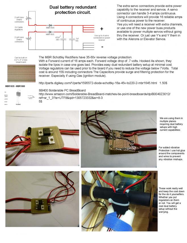

I just use the Wolverine switch for my battery share circuit. I went with the option of 3 power leads to power my RX to share the amp load of the digital servos.

dual batterysetup-b.jpgI agree
