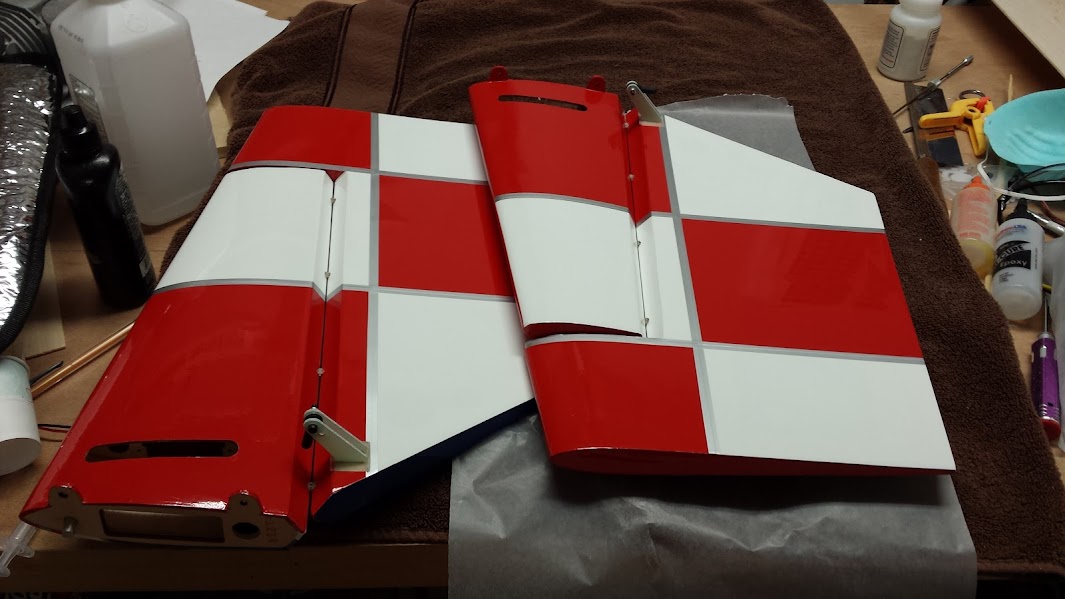

Little more progress last night. I got the elevators hinged. I'm using the Pacer Hinge Glue which is no longer available and you can see how I tested to see if it was still good. Just a Robart hinge in a scrap piece of 1/2" balsa. I will also do a pull test.

To prep the hinges for installation, I placed a drop of Tri-Flow on each pivot point and then set them on a paper towel. I used 91% alcohol to clean the hinges with the exception of the knuckles to remove any oil to ensure good adhesion.

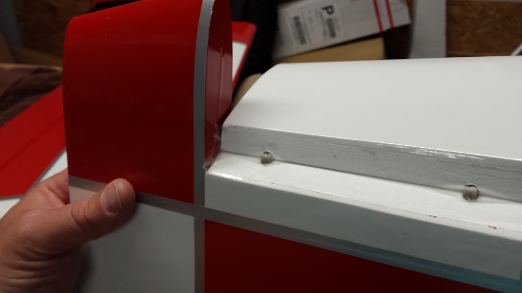

Little more progress tonight. I got the right aileron hinges glued and sealed the gaps on the elevators. I like to use Blenderm for sealing the hinge gaps. The two things I found that help is to not stretch the tape (should still be tight when applying though) and to have a fresh knife blade for cutting extra bit off of the edges.

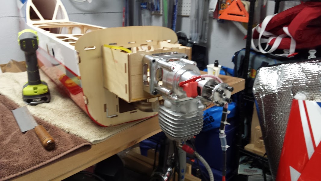

Little more progress tonight. I got the left aileron hinges glued and worked on the getting the firewall set up for the motor. I had to remove a bit of material but it's close. I need to get a little more clearance for the fuel inlet on the carb and remove some material for the throttle linkage.
