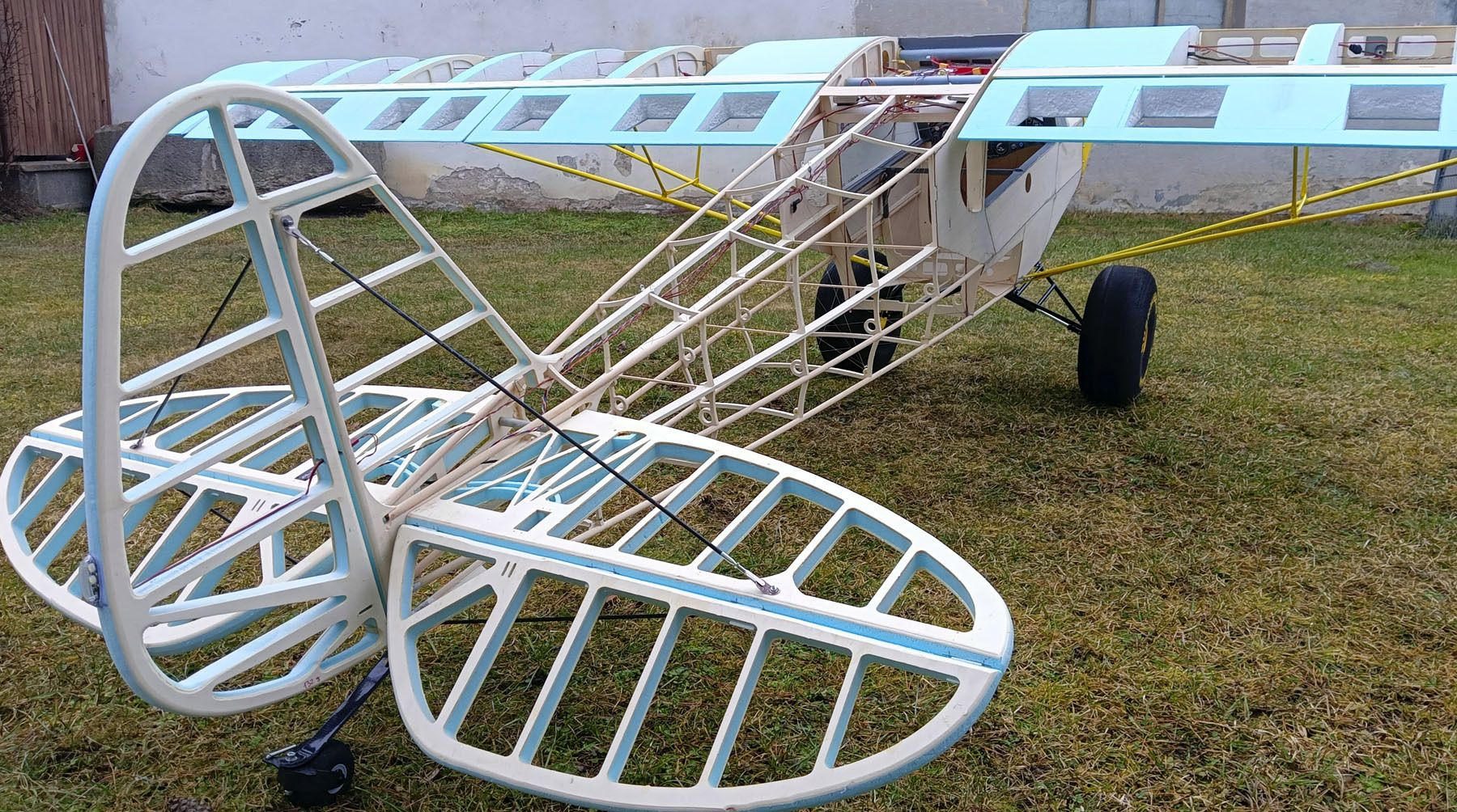

Is that 2 pound extruded foam you are using on the tail parts?
"milled parts from plywood 6mm and 3mm, plywood 0.8mm - parts for fuselage coating burned by laser, polystyrene parts for wings, elevator and rudder with negatives, white engine cover, all windows made of plexiglass, duralumin connecting tubes with case, rudder levers and hinges - fiberglass, leading arch - laminate, ceconite for covering the whole model"
