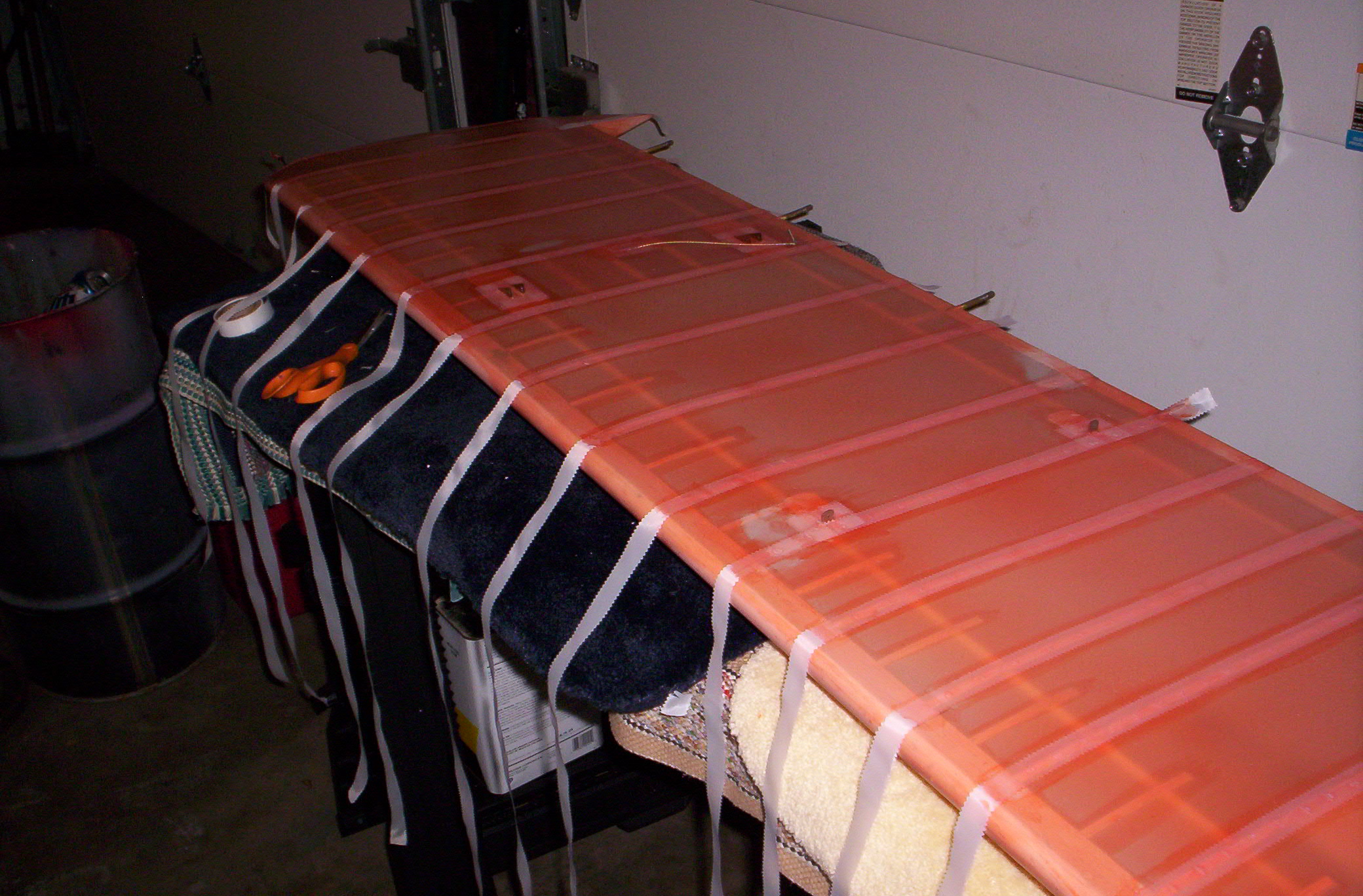

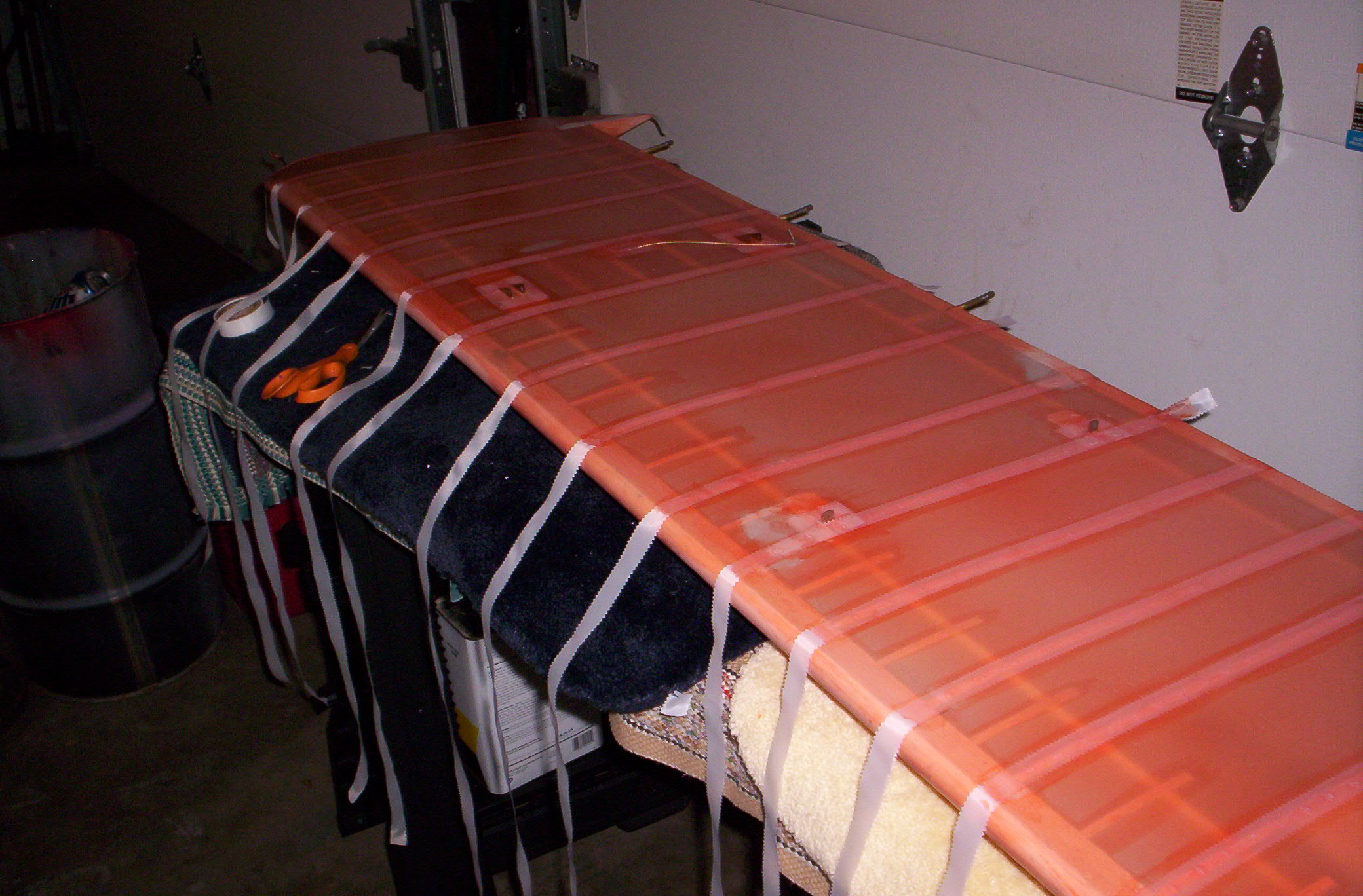

I would cover the wings, it will break up the monotony of doing the finish tapes. I find I get better tapes if I blot the excess off the top of the tape rather than wipe it. What are you planning for the stitches?
