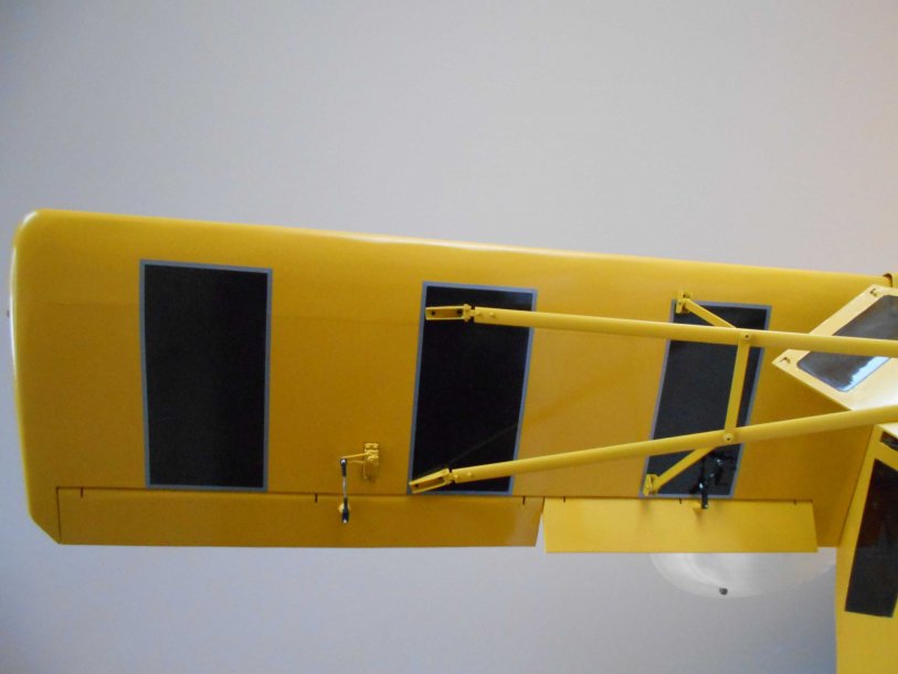

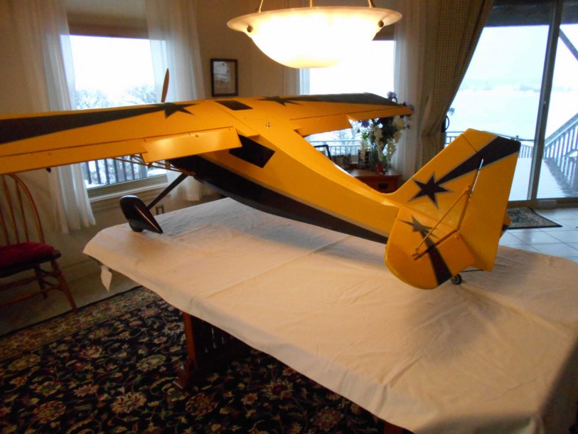

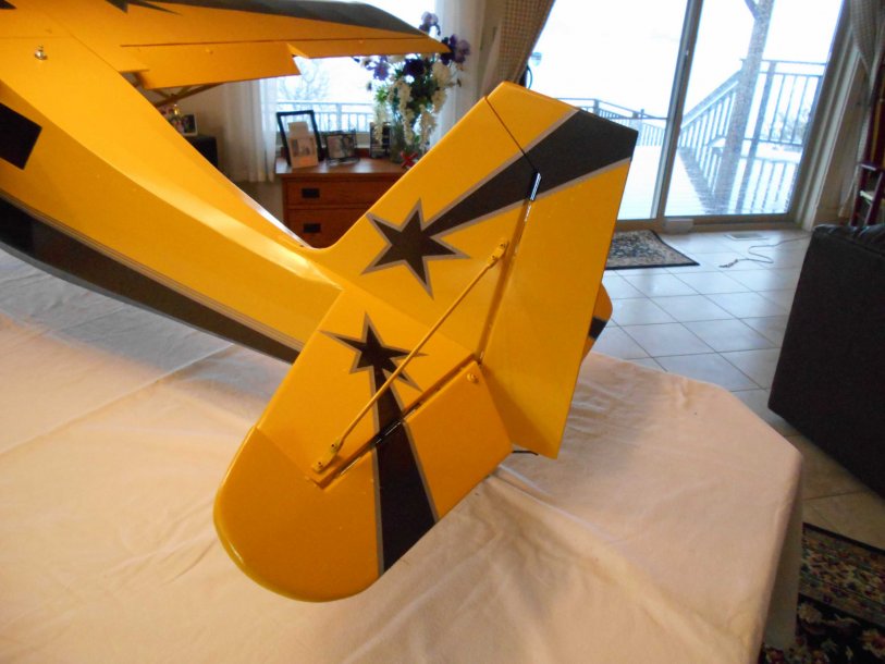

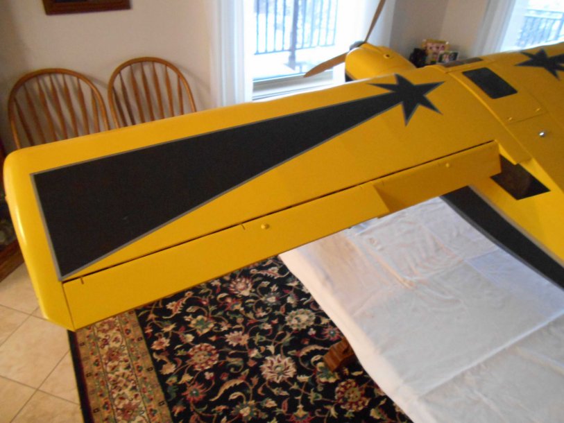

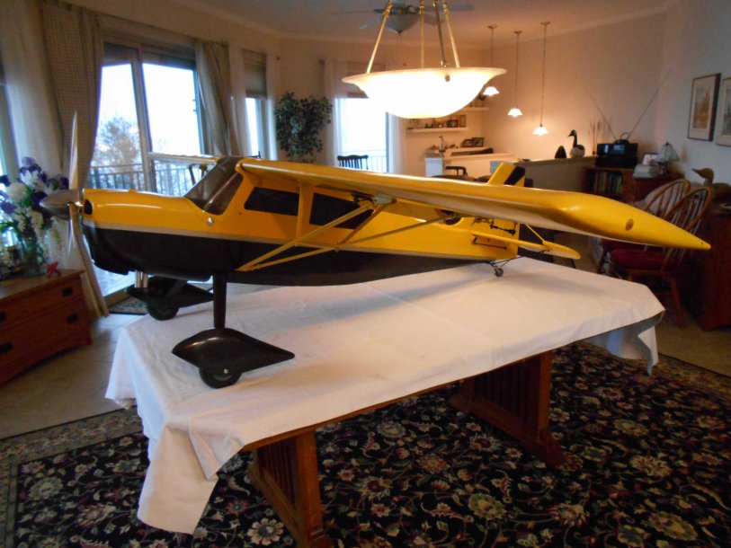

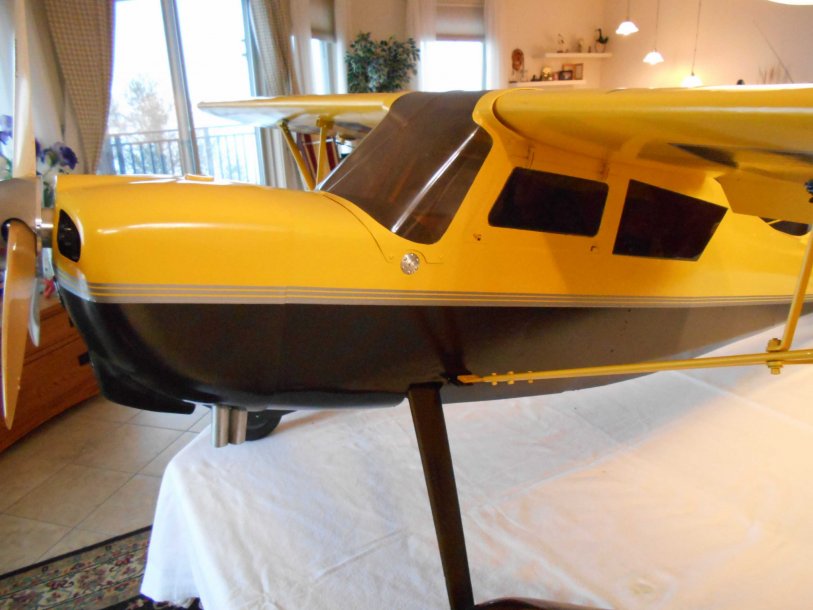

Here are more pictures of the colour scheme I chose.
Unfortunately the yellow colour doesn't come out well when the pictures are taken from inside using a flash.

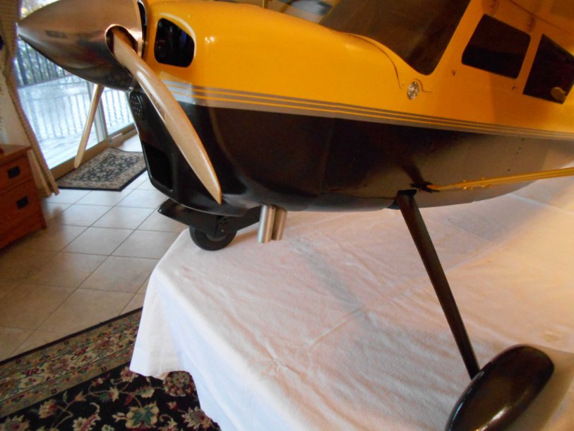

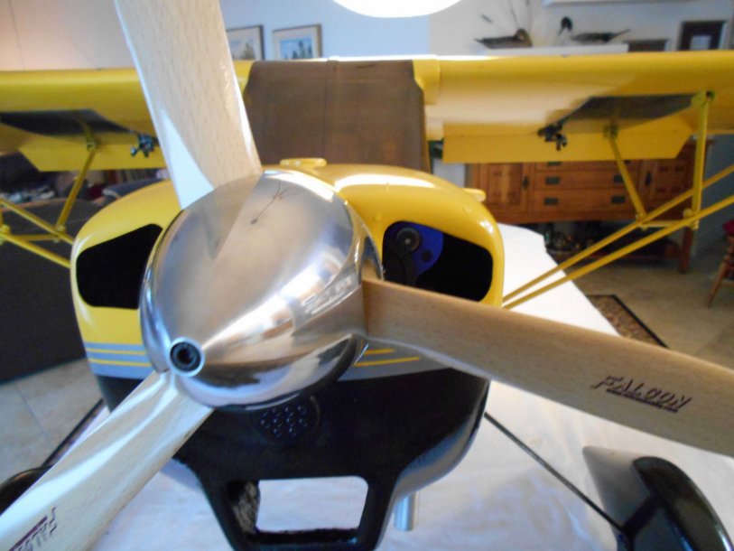

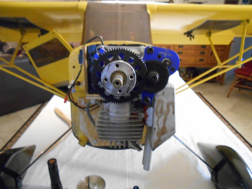

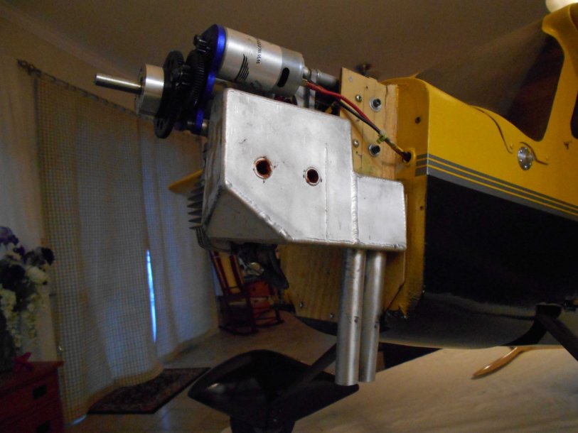

To make it "Noise Friendly" I'm using a Custom made muffler made for me by Lance at Bisson Mufflers. I made a blue foam block to get the "EXACT" fit and he made the extra baffled muffler to the blue foam dimensions. It has a low purring sound.

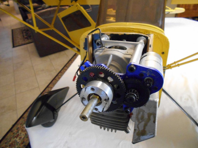

This plane has a EME 60 with Auto Start. It's a blast to nonchalantly stand behind your stabs and have the engine suddenly start up. Wakes up those who are not in the "know".

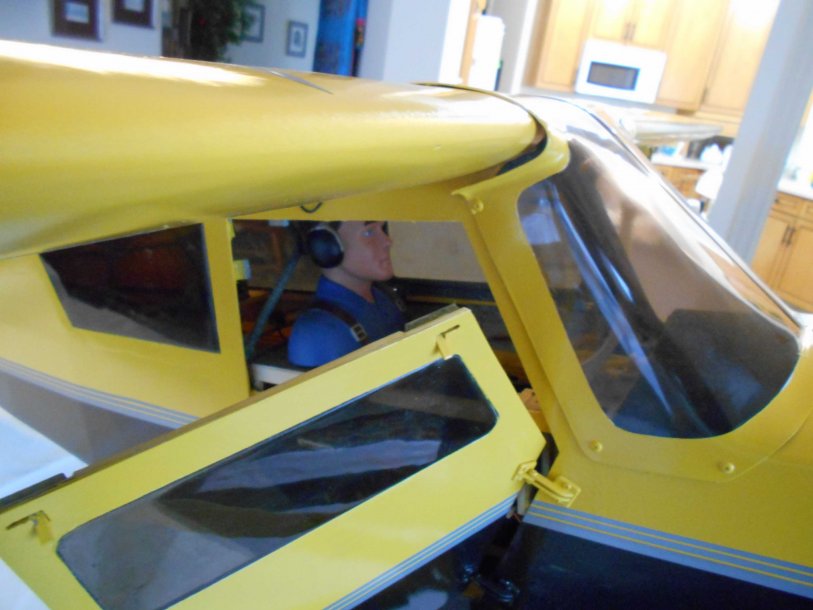

The pilot is mounted on a sub floor that is held in place with small super strong magnets. It's a breeze to remove the pilot to get at the batteries.

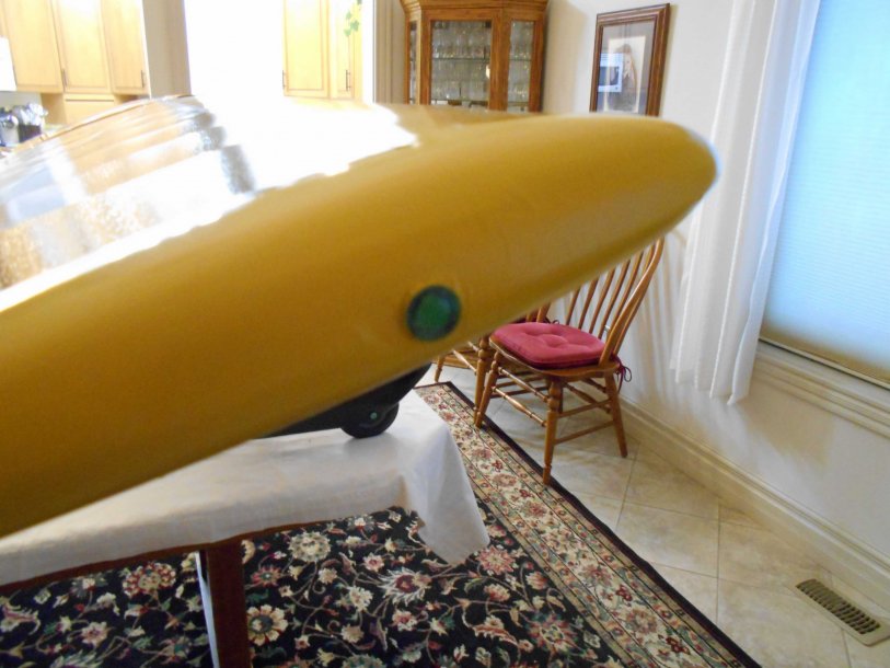

For fun I added a Towing - Banner Hook that uses a small servo mounted behind the pilot for the release mechanism.

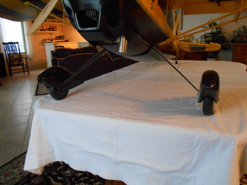

Lastly I upgraded the landing gear to one from SDS Hobbies. It's an inch taller and 2 1/2 inches wider so that it will do my touch and goes a little easier. I also increased the wheel size by an inch for the rough strips that we sometimes fly off of.
I was asked what the muffler looks like.
There was not much room width wise but more than ample for the length.
The front corner was angled to fit the cowl.
I also forgot to mention that I installed lights in the wing and a landing light in the cowl.

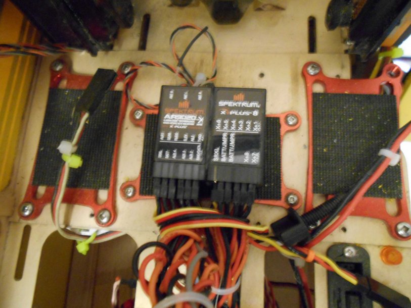

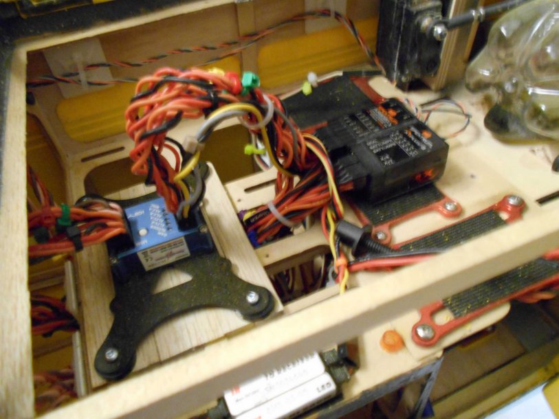

I was asked how do I attach the aerilons and flaps. "Was I using Y connectors".
I run each servo on its own separate channel.
This plane uses a lot of channels. Here is the list
1:- Throttle
2:- Right Aerilon
3:- Left Aerilon
4:- Right Flap
5:- Left Flap
6:- Right Elevator
7:- Left Elevator
8:- Rudder
9:- Engine Choke
10:- Engine Cut Off
11:- Auto Start for the Engine
12:- Banner Release
13:- Gyro Rate Control Input
14:- Lights
To help me on in my wiring, I colour code each lead with a unique coloured wire tie. Red= Right Aerilon, Dark Blue=Choke, Black=Rudder, Lime Green= Ignition and so on----
