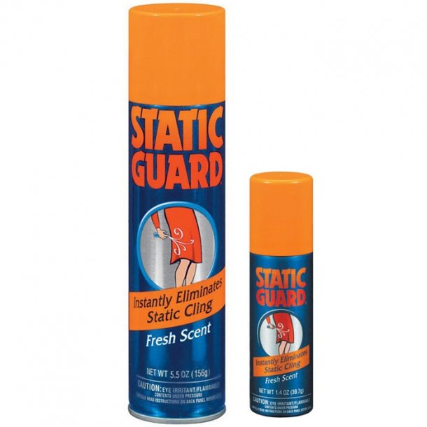

Maybe try a light dusting with Static Guard?
