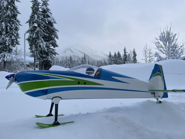

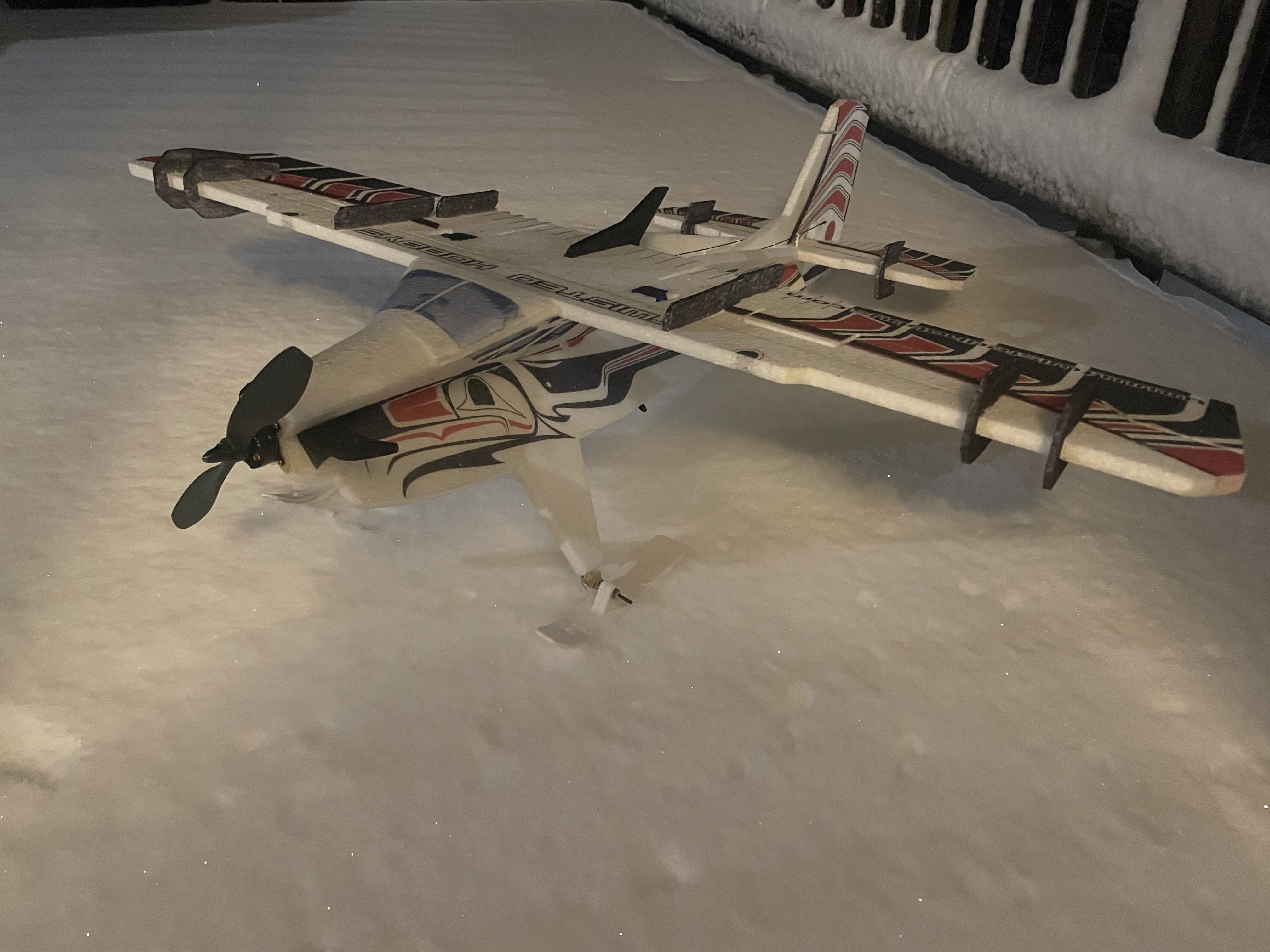

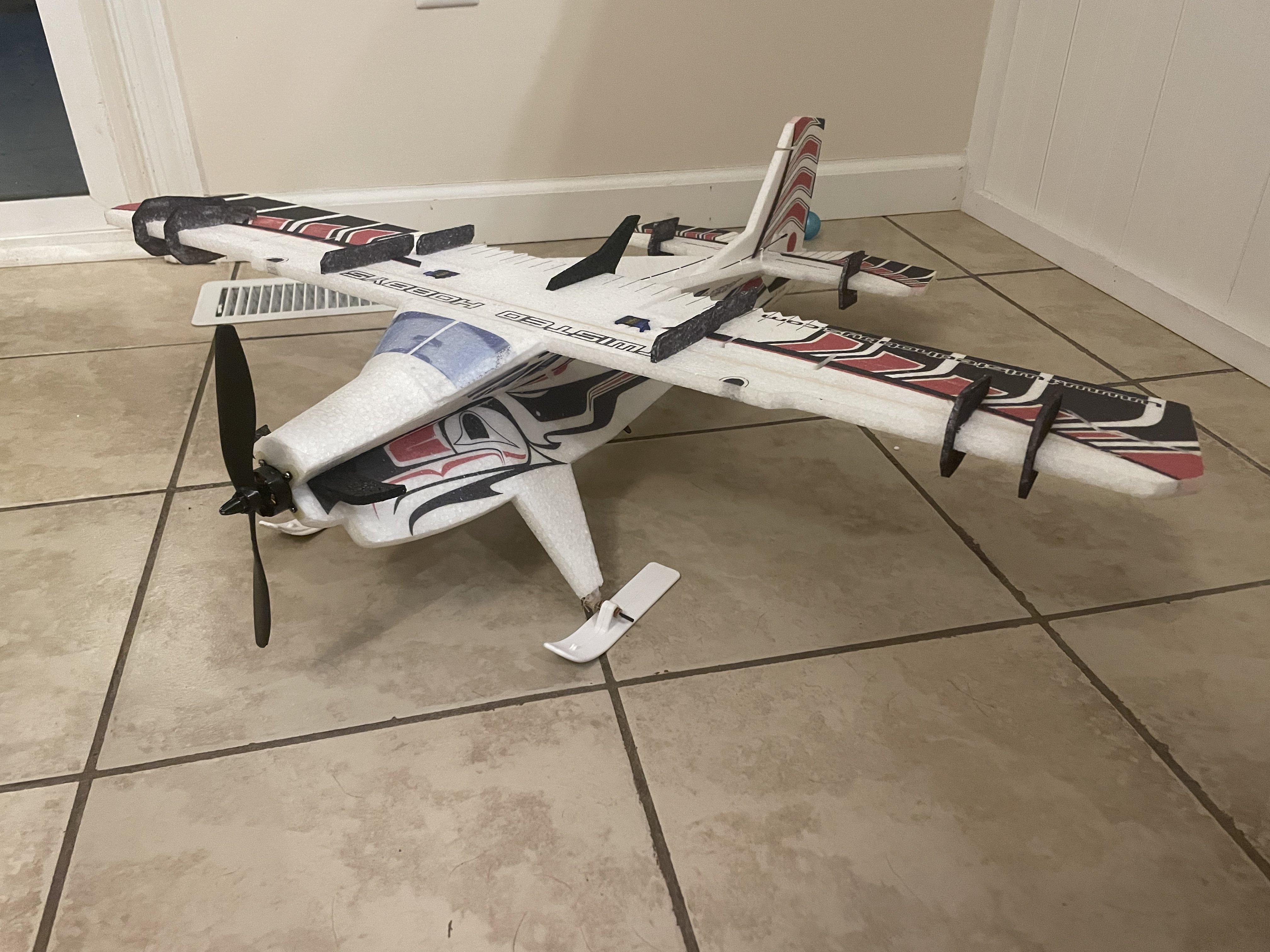

Decided to design and print some snow skis for the Crack Beaver since we just had 4" of snow dropped on us.

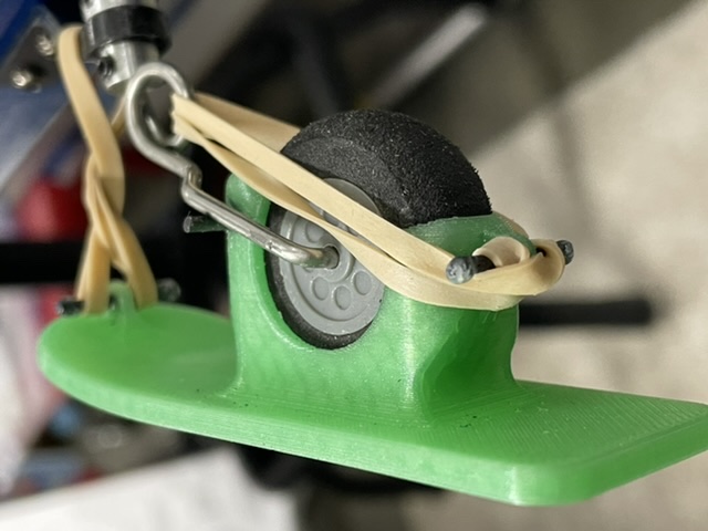

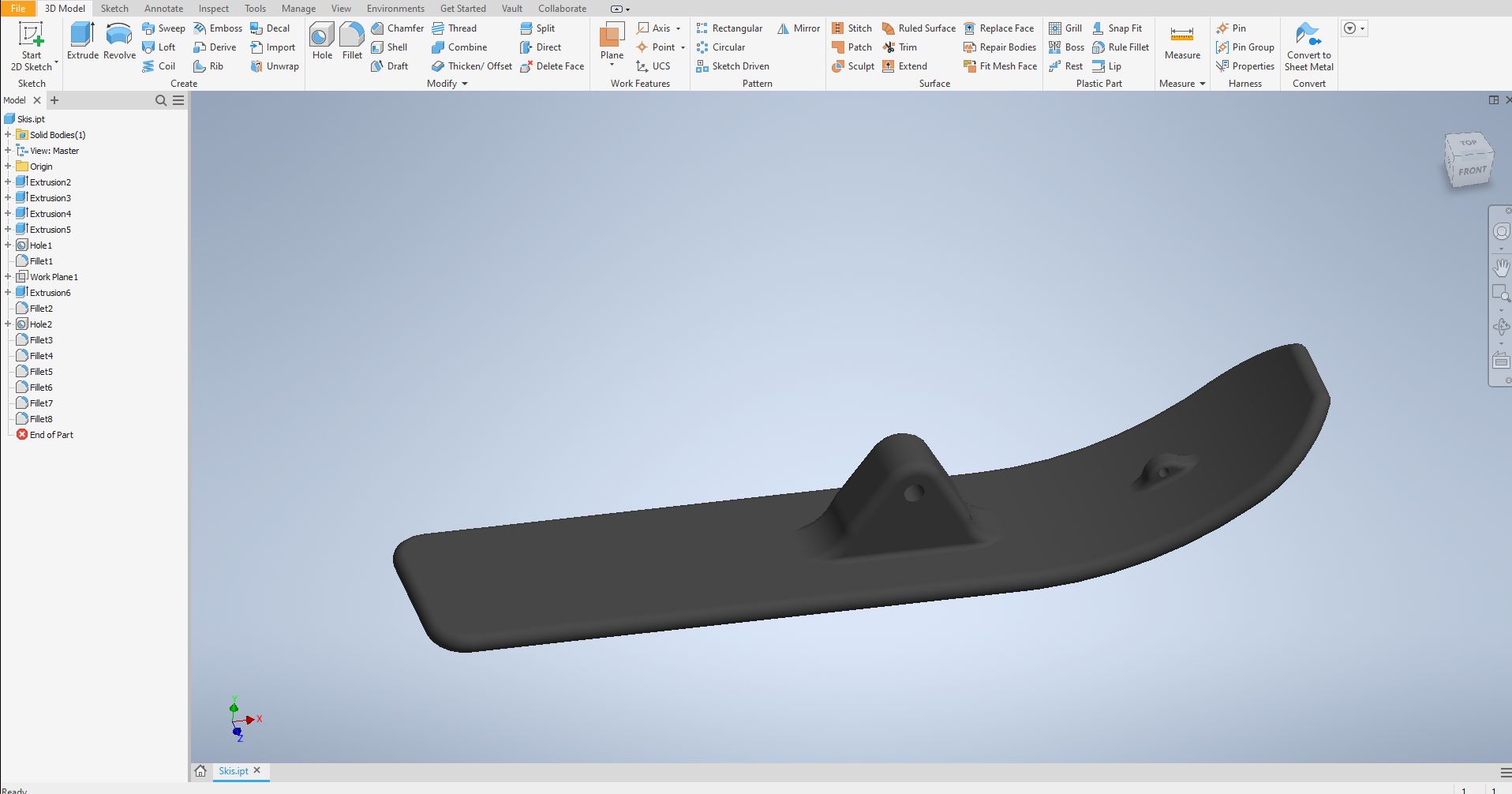

Got up at 7am to design a tailwheel ski that slips onto the stock tailwheel of most 60” planes. Pretty proud of myself that it turned out functional on the first attempt! I dipped the tip in some boiler water and formed it. Used carbon rod with CA for the rubber bands.
