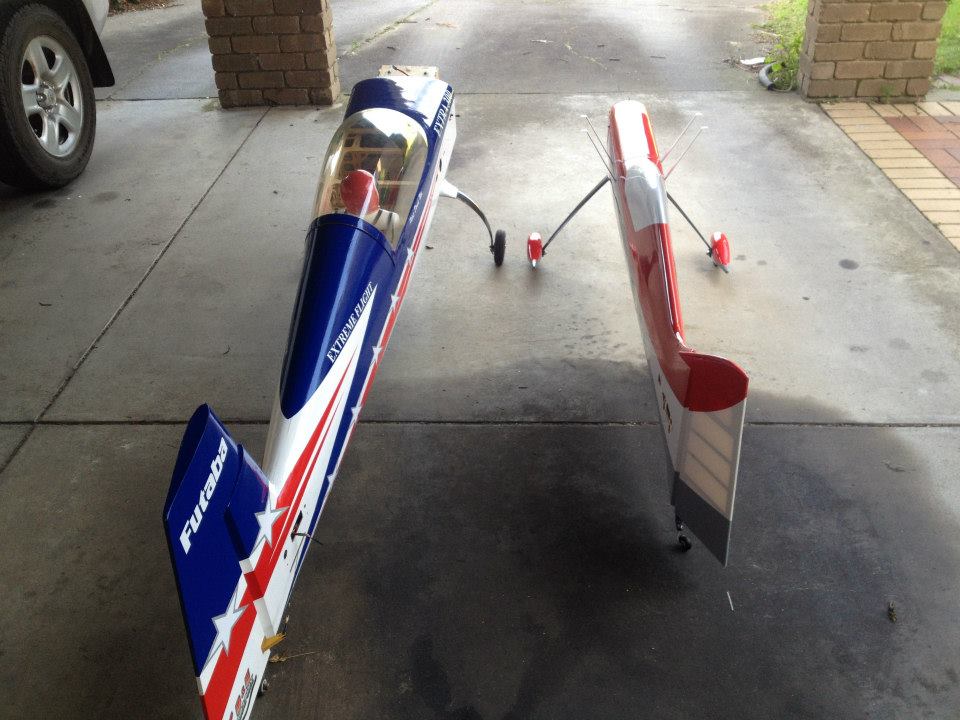

pic angle makes it look bigger cos it's in front. Here's from a diff angle.
