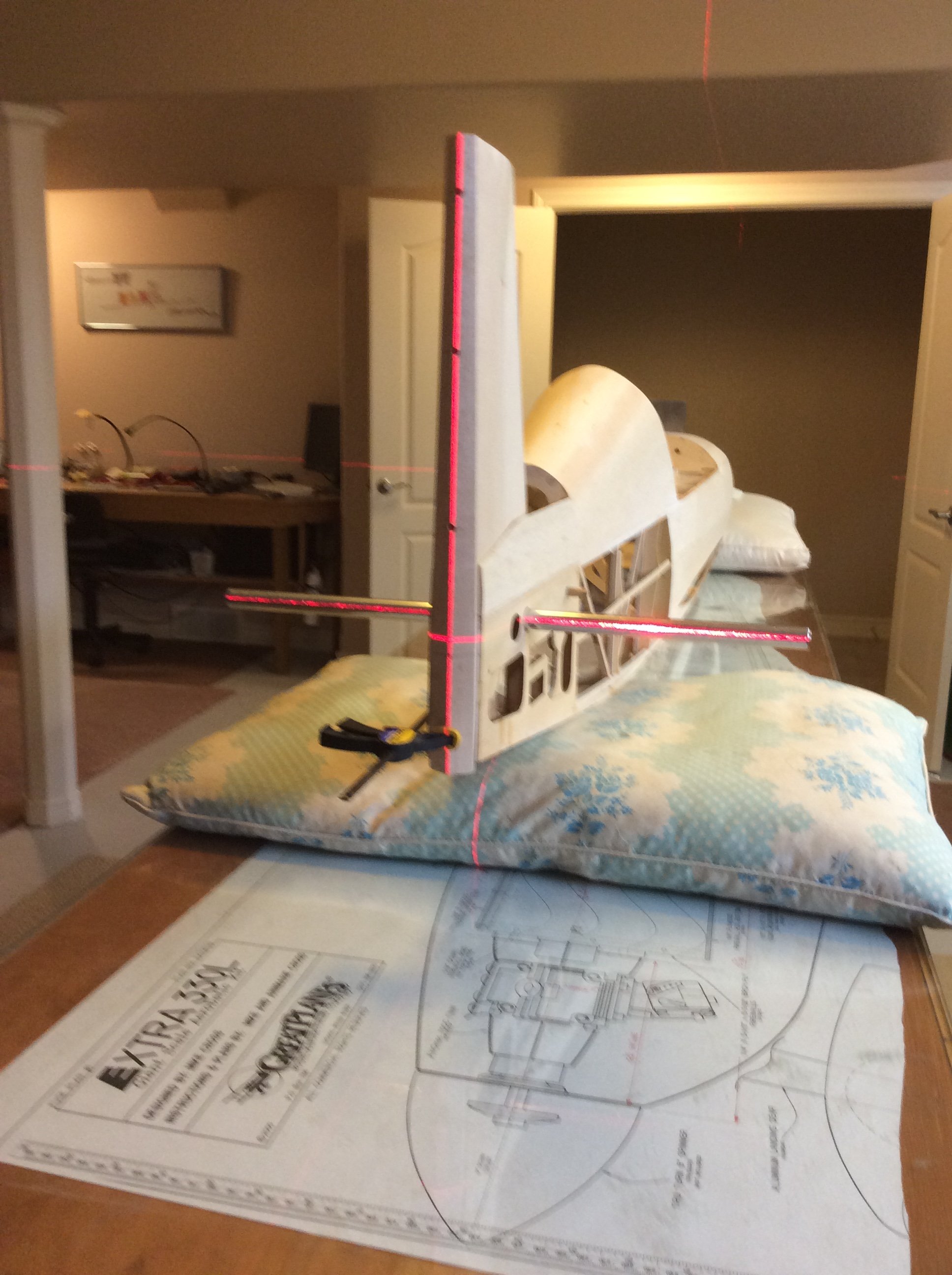

Just had to do something over thinking things so I just went ahead and epoxied the rudder in it is in square and straight. Just have leave it alone for 6 hours. Then we can continue. Thanks guys for all the support sometimes it is nice to bounce things of fellow builders for some help, THANKS.

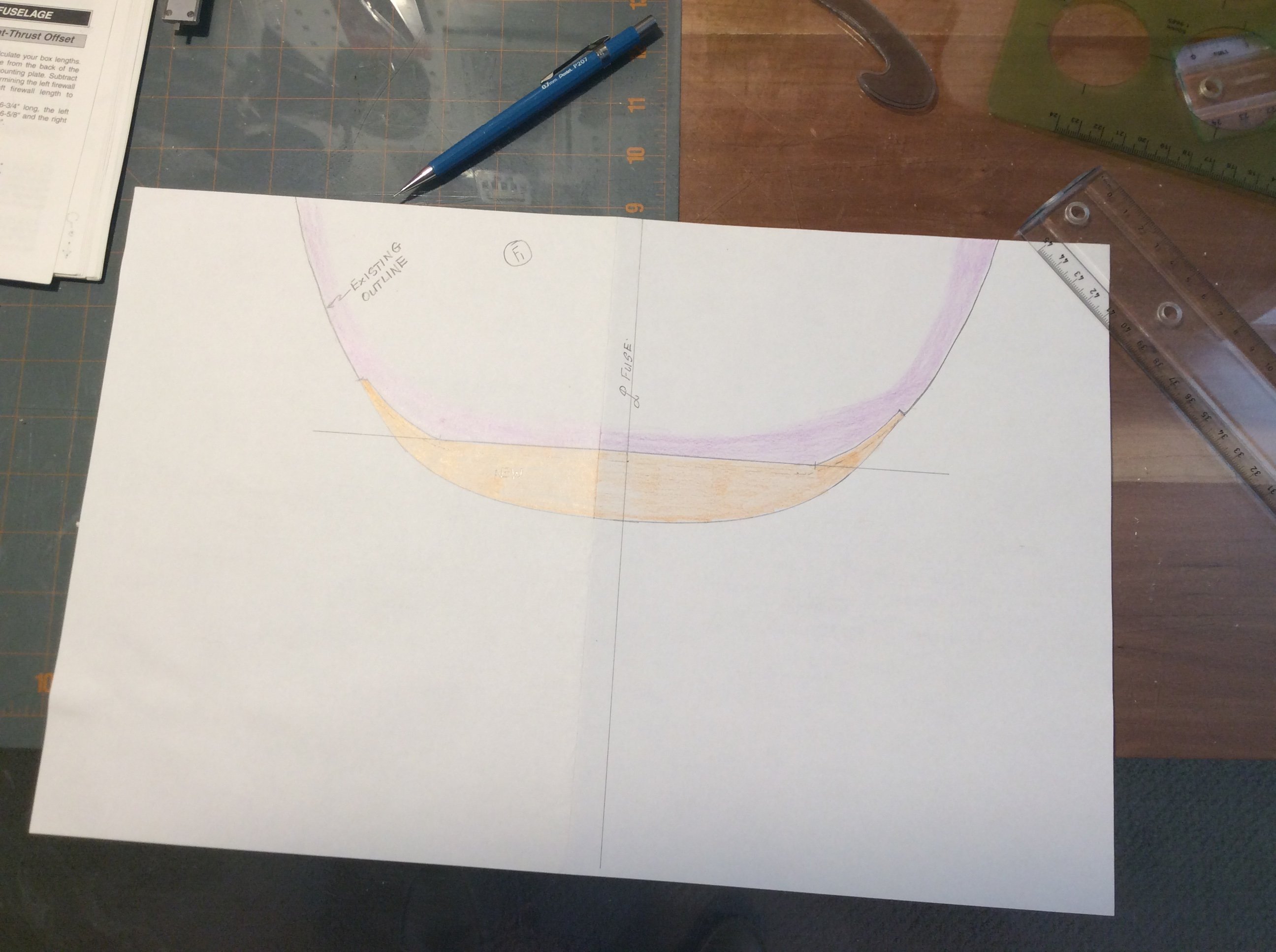

Ok as you gentlemen know my cowl is considerably bigger than the F1 bulkhead when I fit the cowl to the bulkhead there is about 3/16 of an inch clearance all the way around or there about. So been thinking about that because it has been bothering me because it really takes away from the lines of the plane and the finished product would look like hell.
So if you look at the picture of the drawing I made of the bottom of bulkhead F1. The out line of the bottom of the bulk is in purple. There is a added section in orange added to the bottom of F1 and the shape is blended in to F1. If I do this and add that piece to the bottom of F1 it will take up the excess cowl material. Will have to do some shaping to blend that backwards into the fuselage but that can be done once the extra piece is added and the cowl fitted. What do think.
I’m guessing the gap between the cowl and the bulkhead is for airflow to cool the engine.
